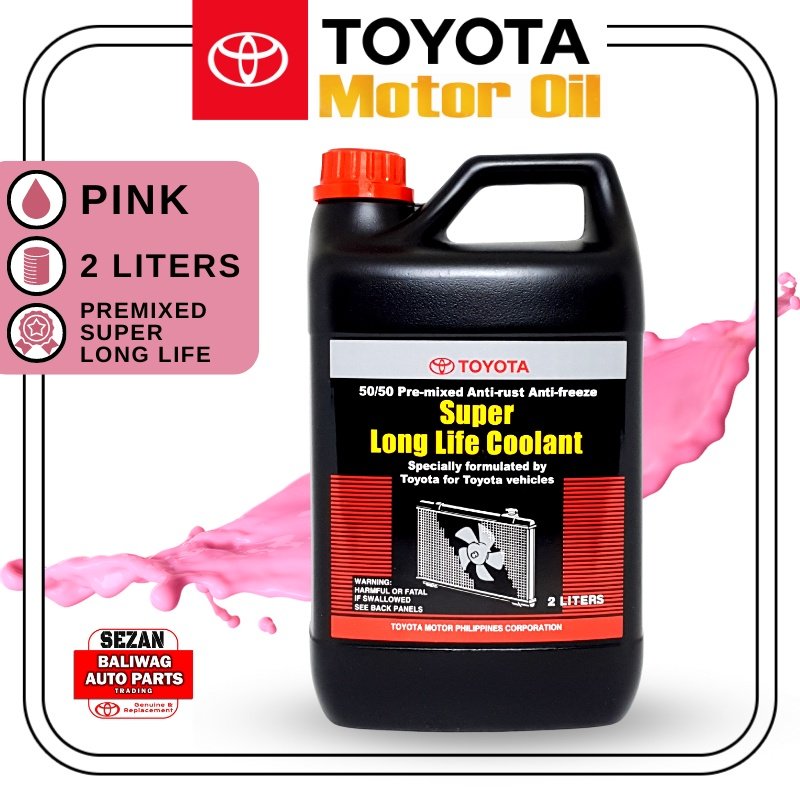

    In toyota versions it doesn't matter ......personal choice......just need to flush old out well....
    Coolant Types
    • Toyota Genuine Long Life Antifreeze/Coolant: This coolant works for most Toyota models. It features a pink color and is meant to last up to 100,000 miles or five years.
    • Toyota Super Long Life Antifreeze/Coolant: Designed for newer models, this coolant is typically red and offers even longer service intervals, lasting up to 150,000 miles or ten years in some circumstances.
    because of internal rubber stuff and the metal head gasket you need to use one of the toyotas....any HOAT knockoff...
    or the basic Prestone or Peak........any others may damage
    says you can mix prestone/peak with anything.......but I wouldnt do it.....
    always flush it well
    I would change the long life every 36mos...
    the red I would do it 5yrs or less
    pretty important stuff
    I use the old fashion Prestone from wally world....36mos.....

    Only the Toyota "Long Life" comes undiluted.
    Honestly, just get Toyota compatible coolant thats pre-mixed, or switch to "Super Long Life" which is premixed. It saves a lot of hassle.
    But for reference, Long Life is red, Super Long Life is Pink. You can use Pink with red, but should flush system first which you plan on doing.
