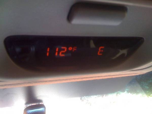

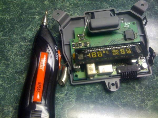

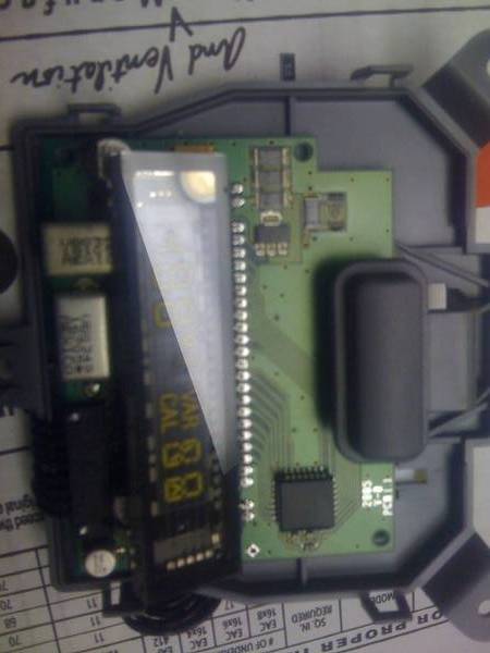

    this was my first time soldering it was not fun due to the 510 part being about 1/10 the size that i thought it was.
    removed and ready for the repair
    right after it was soldered on.
    With it working again... it was a bit hot today.
    it was challenging to teach myself how to solder but all in all well worth the 900$ or so savings.

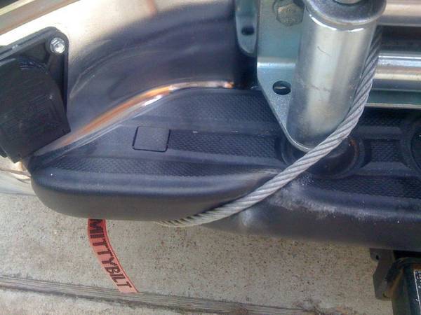

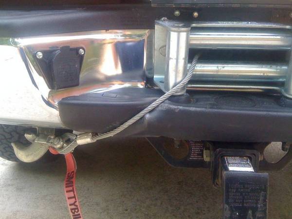

    i also noticed that my rear bumper has been tilted by the winch getting stuck in the on position. im thinking that this can be fixed by loosening and adjusting bolts but if not im really not that worried about it.

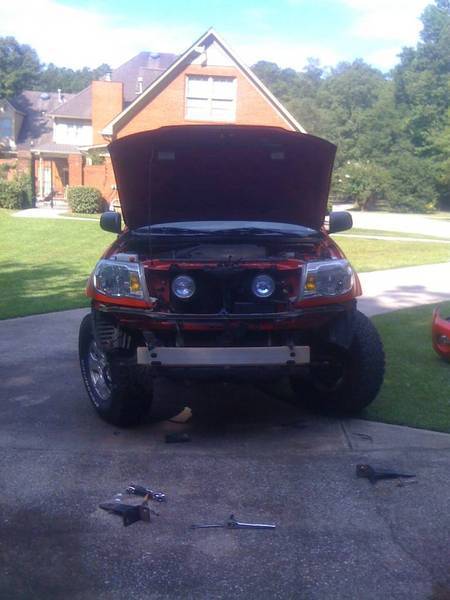

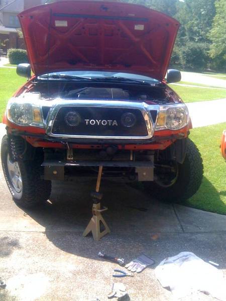

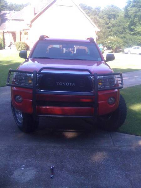

    how she started today off

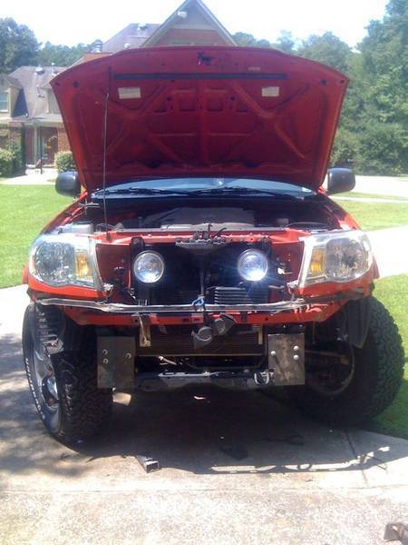

    with the brush guard removed, driving the truck without seeing it at the front is really weird. and i think that it looks really good without it, with it gone it really brings to the front the grill.
    Grill and bumper cover gone.

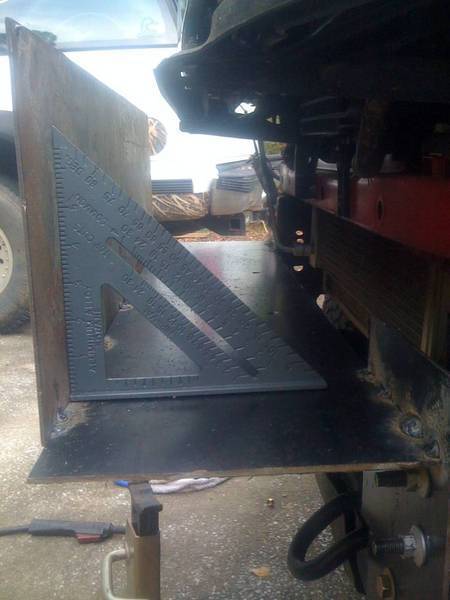

    here is the actual mounts to the truck, 6 bolts per.
    here is the winch plate being mocked into place.
    Would have gotten more done today but i had to go in this afternoon for a while. ill be back at it tomorrow. just entered the slow time at work. so i should have most of this week to get it done.

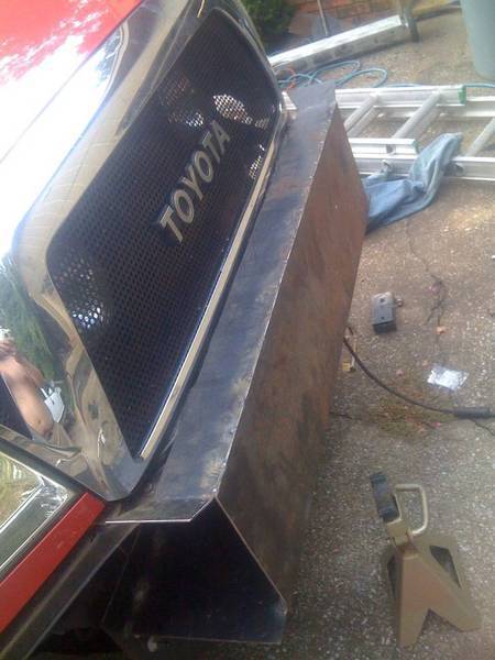

    Only got about 2 hours worth of work done on the bumper today. but here it is. started today out by drilling the 4 holes in the winch mount plate, i know you are super jealous of my ultra high end equipment.
    here it is with the front part tacked into place, starting to look like something.

    i failed to mention that i am totally obsessed with square and plumb and identical on both sides.
    next was the top piece and no i don't have a break so that bend was done with the bench top vice and a hammer after scoring the back, and an angle finder was used to insure that they are both identical
