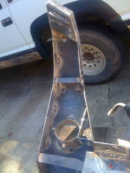

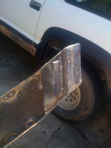

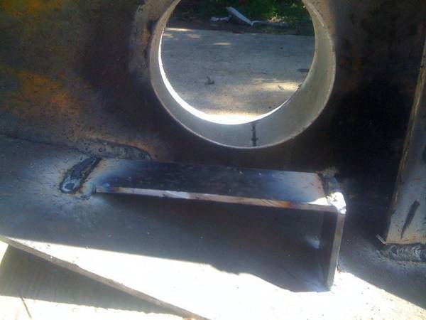

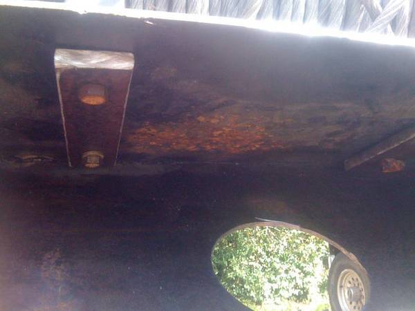

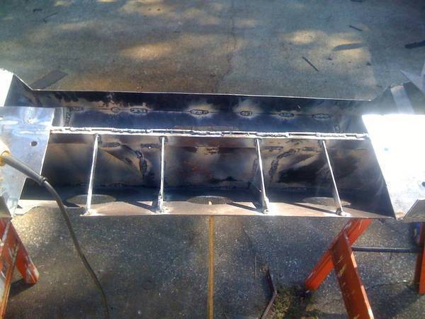

    here is 2 views the entire point of that little boxed portion was to hold this tab, this tab will hold the inner fender hopefuly this will keep the mud off the bumper and keep everything looking nice and stockish.

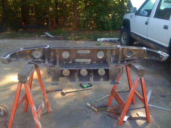

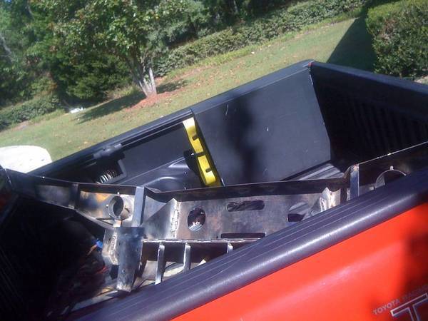

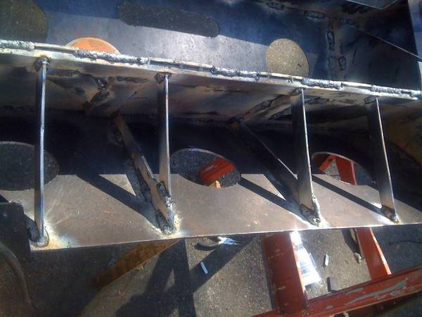

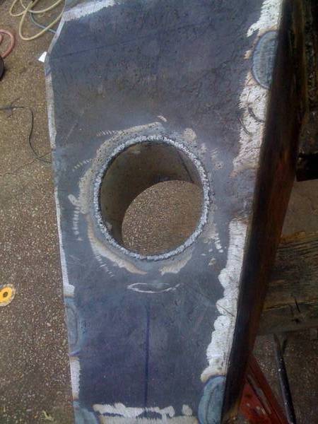

    up next i finished welding the mounting brackets just connected the welds i don't think that i will be grinding these welds down, the front and easily visible welds have all been ground down, i am not inclined to risk grinding down these critical welds that i can not really access so easily on the inside to get a great weld on them. and they are hard to see once painted.
    What do yall think?

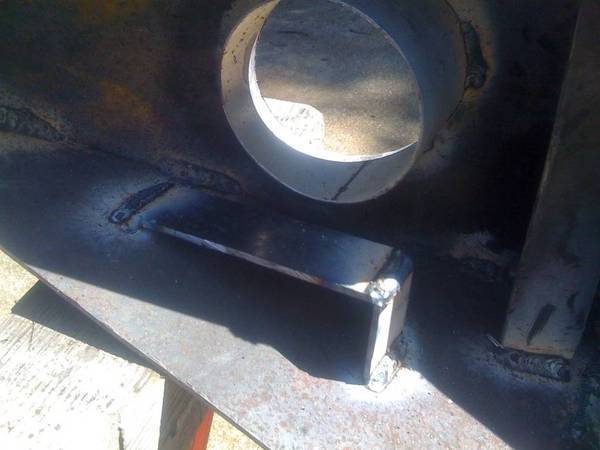

    next the light brackets are fabed in, i fabed these in but i think that my new plan is to weld some tabs on that i can use something to hold the stock lights in, my birthday is tomorrow and i think that my girlfriend has gotten me HID lights so i think that i will try to use to stock fogs and order an hid kit to go with that.

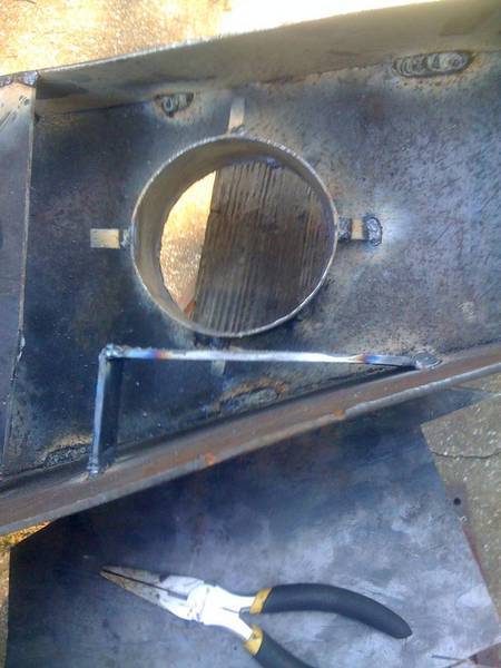

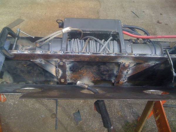

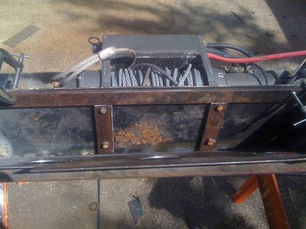

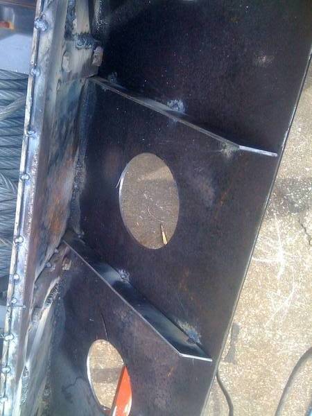

    next was to finish the winch mount, this is what i was talking about earlier in the build. its 1/4 inch thick. This is where i ran into a big problem, my step drill bit broke 1/2 way through this so i had to drive 20 min to harbor freight tools when i got there i realized that i had forgoten my wallet, i had $8.25 in my change compartment. i had to flirt with the heavy manager girl for 15 min to get what i needed for that price.

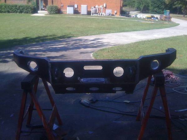

    and here she is with the rear 1/4 bar installed had to do a lot of grinding for this to fit over the weld that held the winch plate. it sucked.

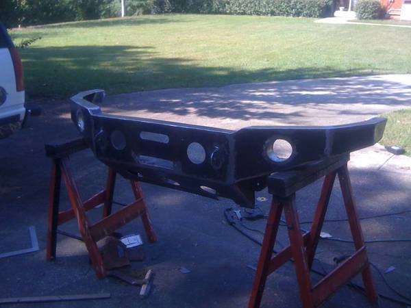

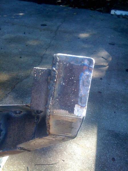

    and here is the final thing i got done today, i think that this spot is the most likly to take a serious hit offroad. so I am trying to brace it up, the bumper has gotten a lot heavier 10 lbs of welding wire, i couldn't believe that.
    this will have 2 more supports running down from the 1/4 inch bar stock to the bottom edge of the bumper, i think this will make it much much stronger to hits.

    Today my gf gave me my HID headlights. which means that i may run the stock fogs so that i can HID them as well so i welded on some little tabs so that i could maybe ziptie the lights in.

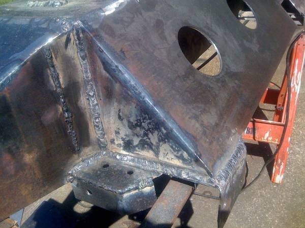

    i completed the lower braceing here is 2 pictures of it i was going to put a conneting brace between the vertical ones but after setting it in it was clear that it was going to be a mud trap and i couldn't get the angle right for it not to be.

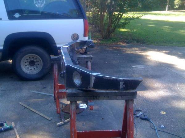

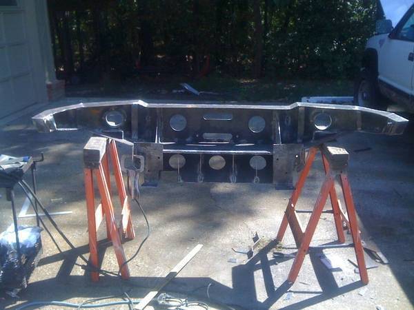

    then i spent a bunch of time grinding everything and took a 360 degree shot.
