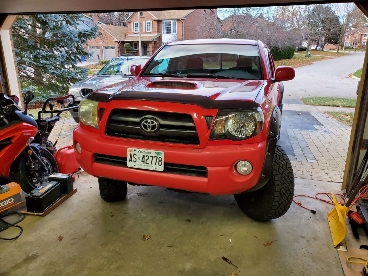

    November 2019
    Time to get real with the build!
    Depo headlights.

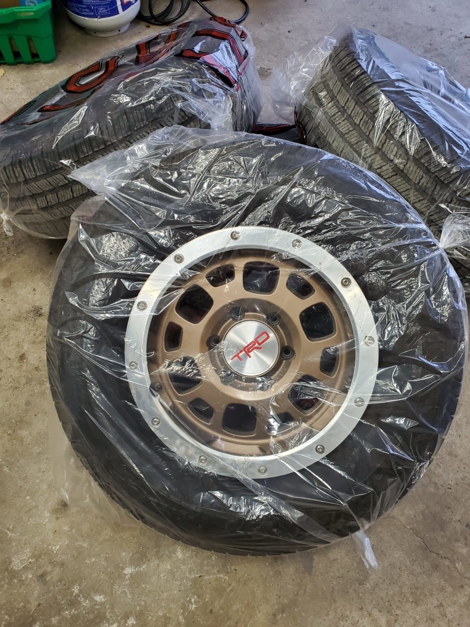

    Bought some new wheels. Came with trash tires.

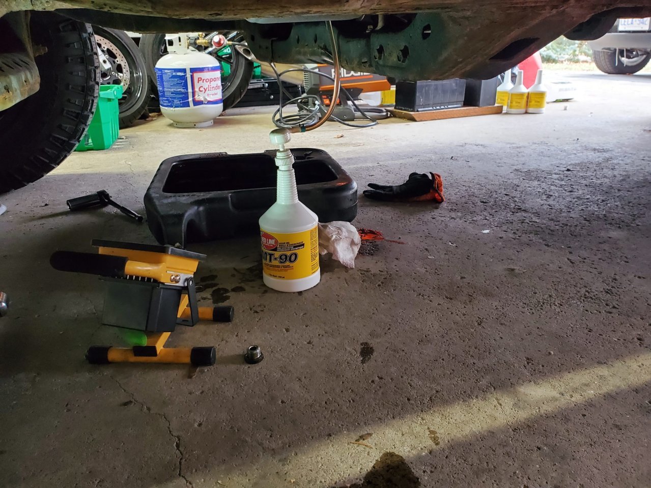

    MT fluid change, I think i also did front and rear diff that day.

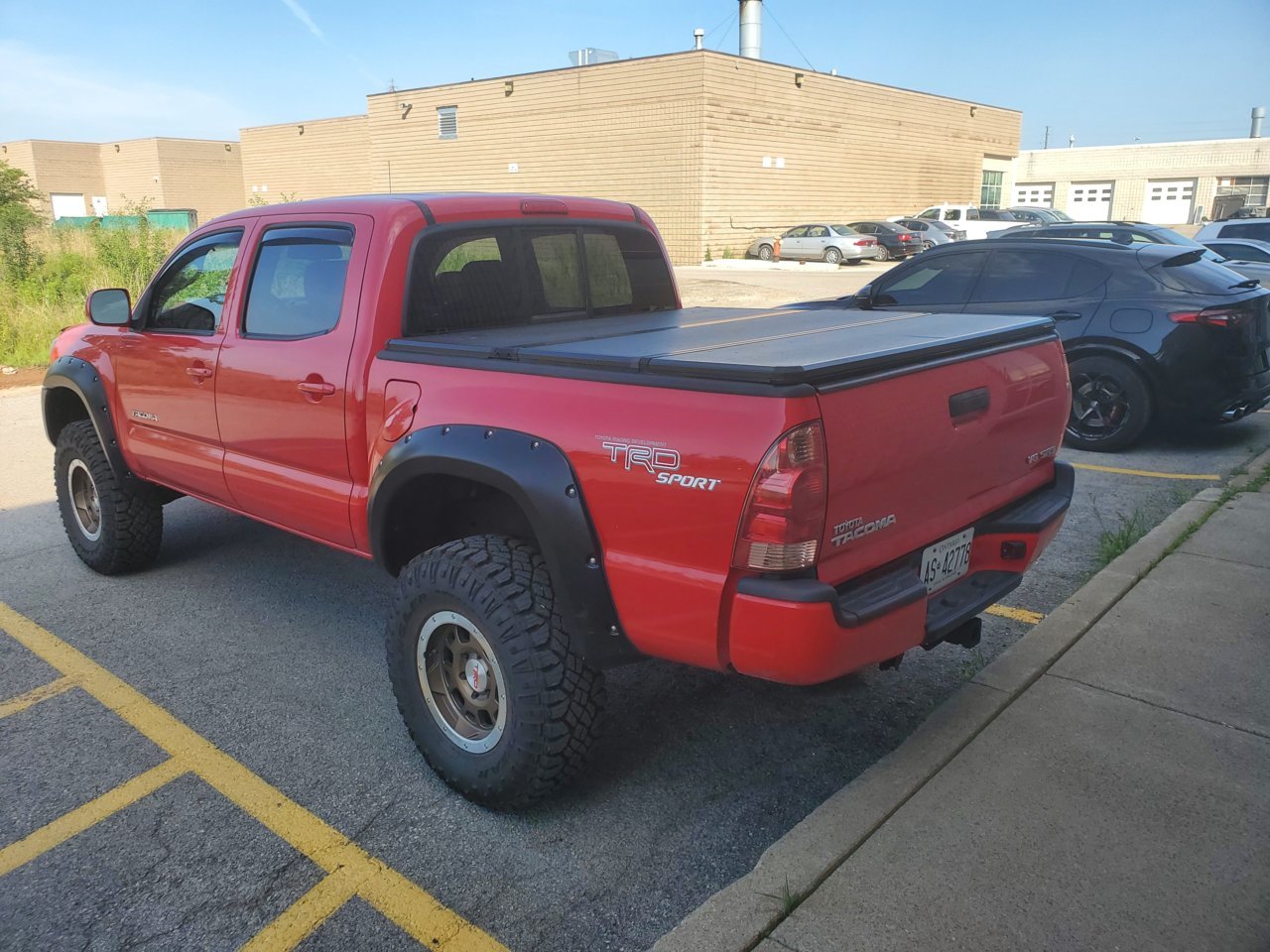

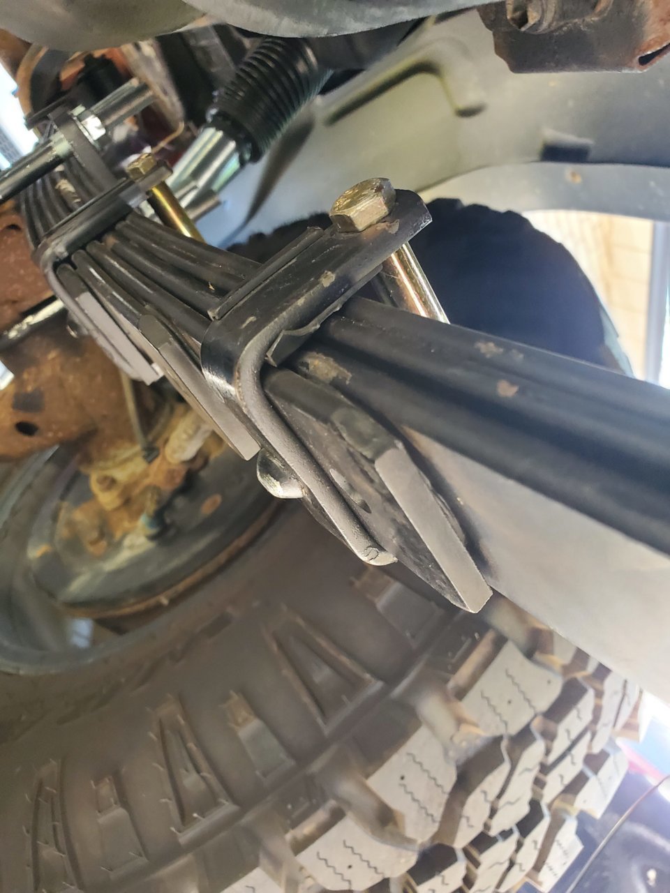

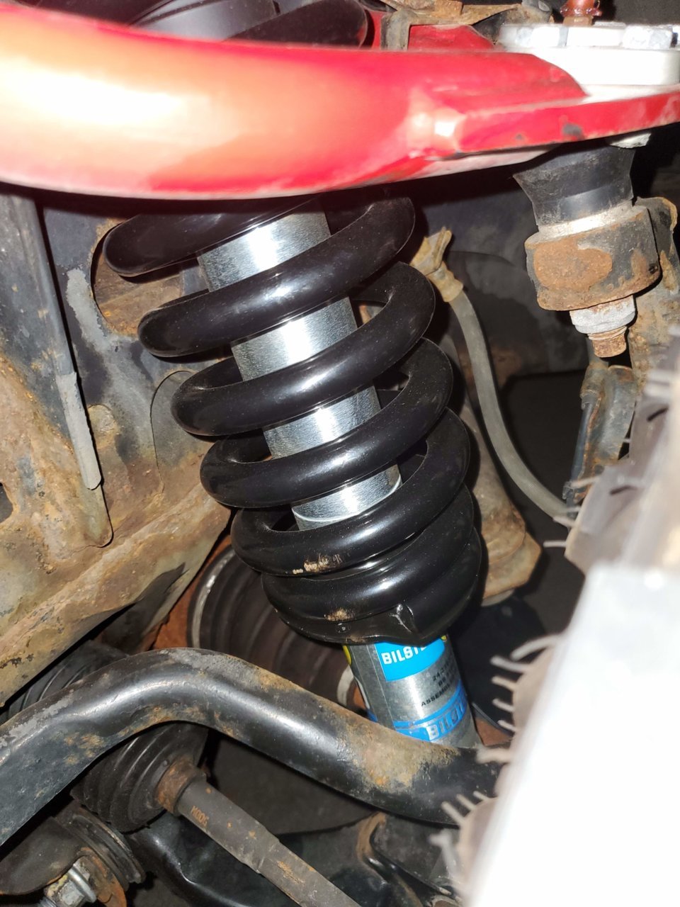

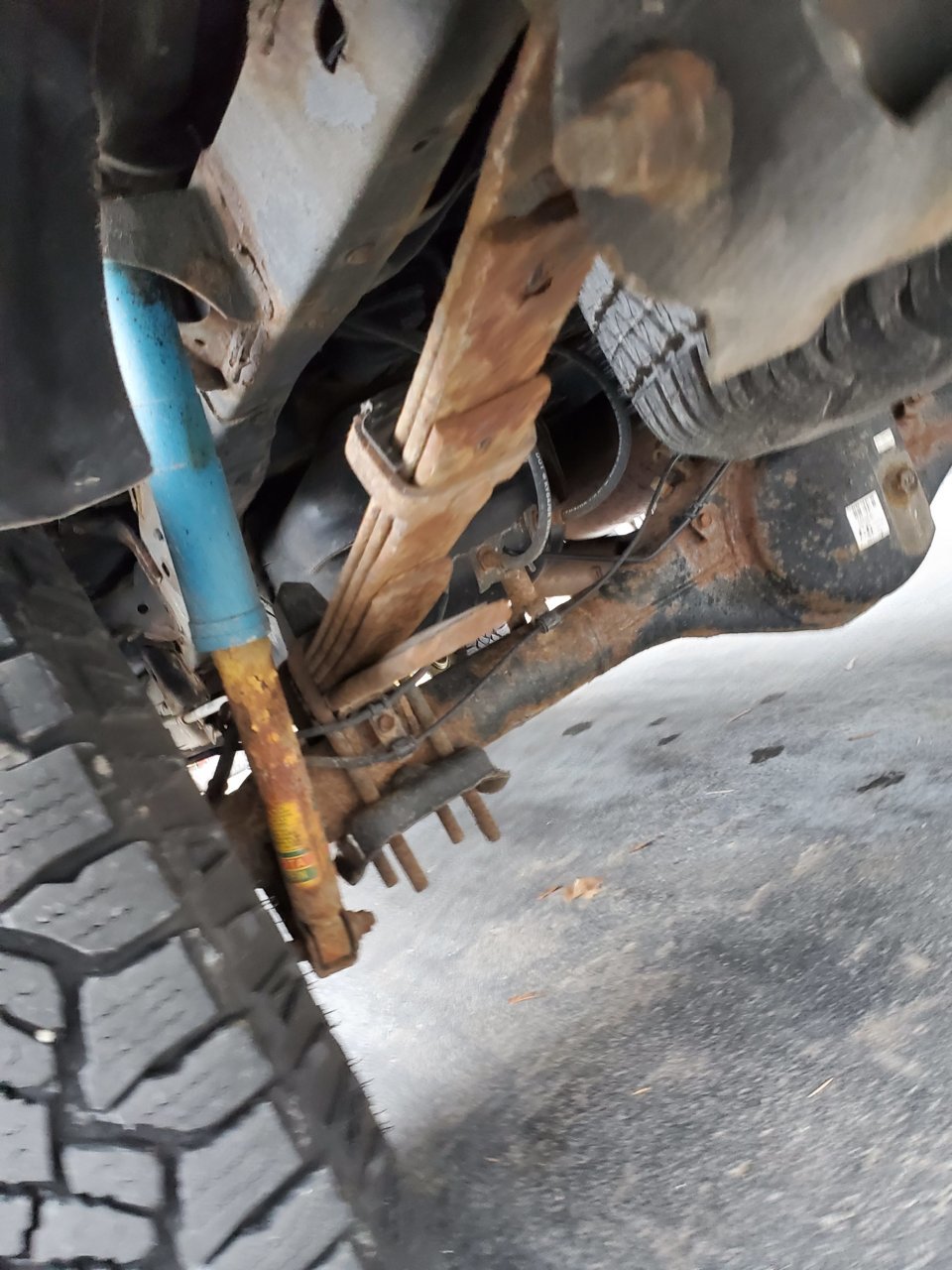

    Time to upgrade the lift
    FRONT:
    Bilstein 24-239370 - 5100
    ARB 2885 Coils
    1/4 spacer from old suspension setup.
    New top hats
    REAR:
    Icon 51101 Multi-Rate RXT Leaf Spring Kit
    Bilstein 24-185417 Shocks (These are for F150s)
    All pro Ubolt flip kit 4400T-AP-05
    Driveshaft spacer
    1.25 inch wheel spacer

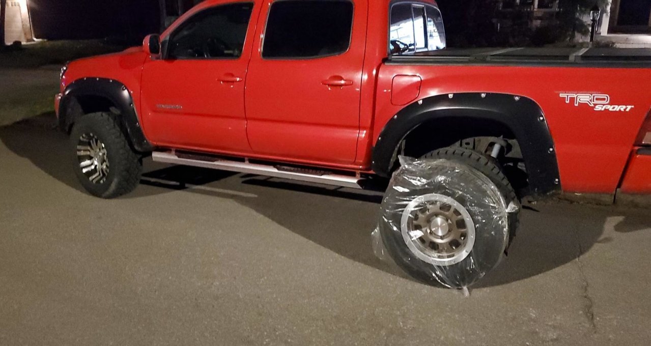

    Removed the side steps. Installed 1.25" wheel spacer front and rear.

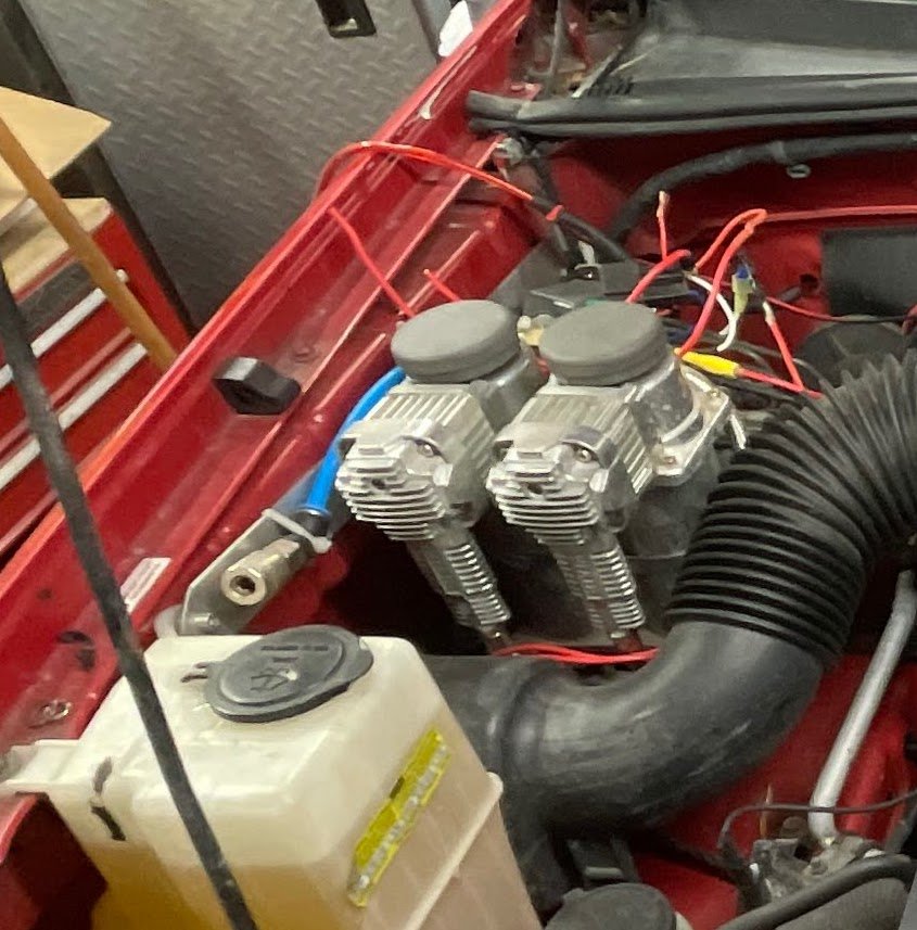

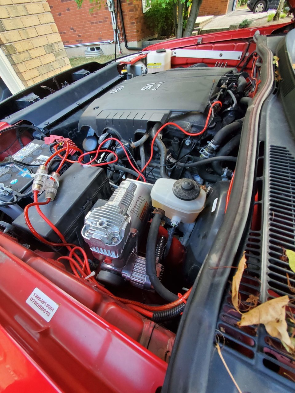

    Where to mount the DUAL Viair 400C compressors?
    Decided to mount them on the passenger side.

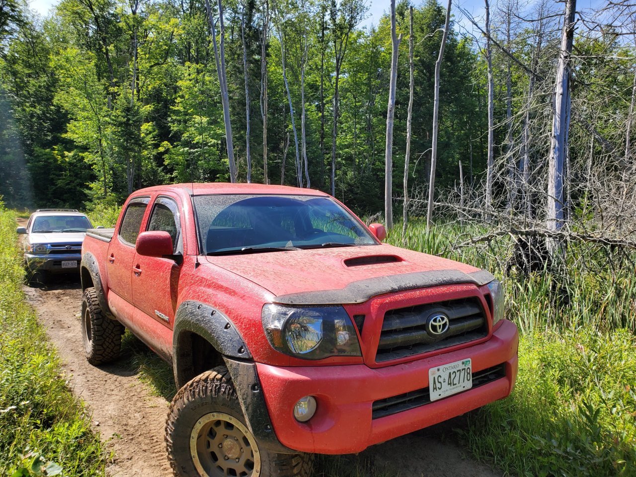

    Doing a little shakedown with @Drifter2090 and his 4runner.
    Suspension working well.
    Shveet likes this.

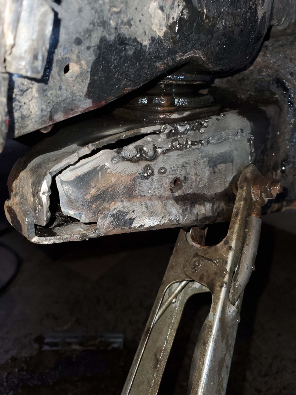

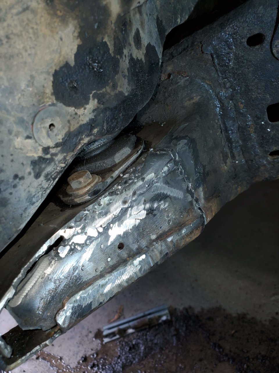

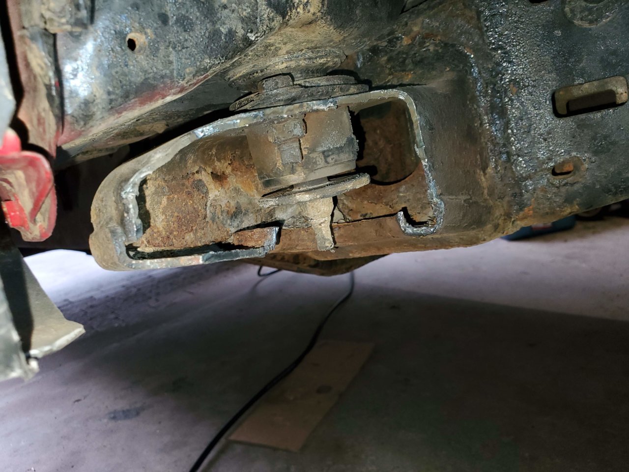

    DIY cab mount chop.
    I cut a chunk off and welded it back on basically in the same place. I really don't know what im doing, but i got a plasma cutter and a welder so going for it.
    Windigo and Shveet like this.

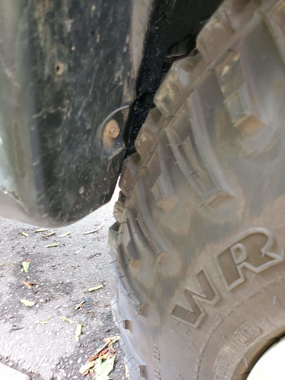

    Light bars, no lockers
    Still rubbing...

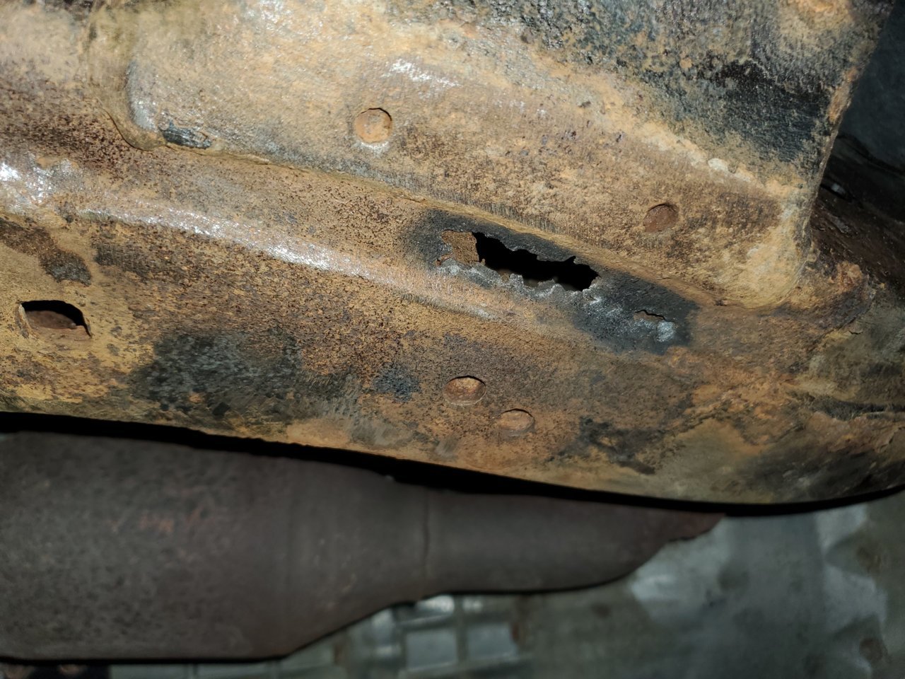

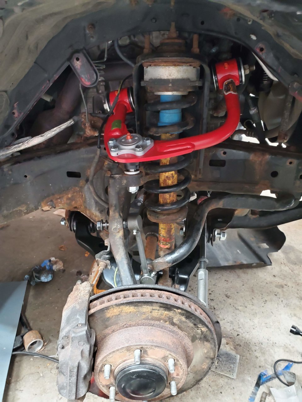

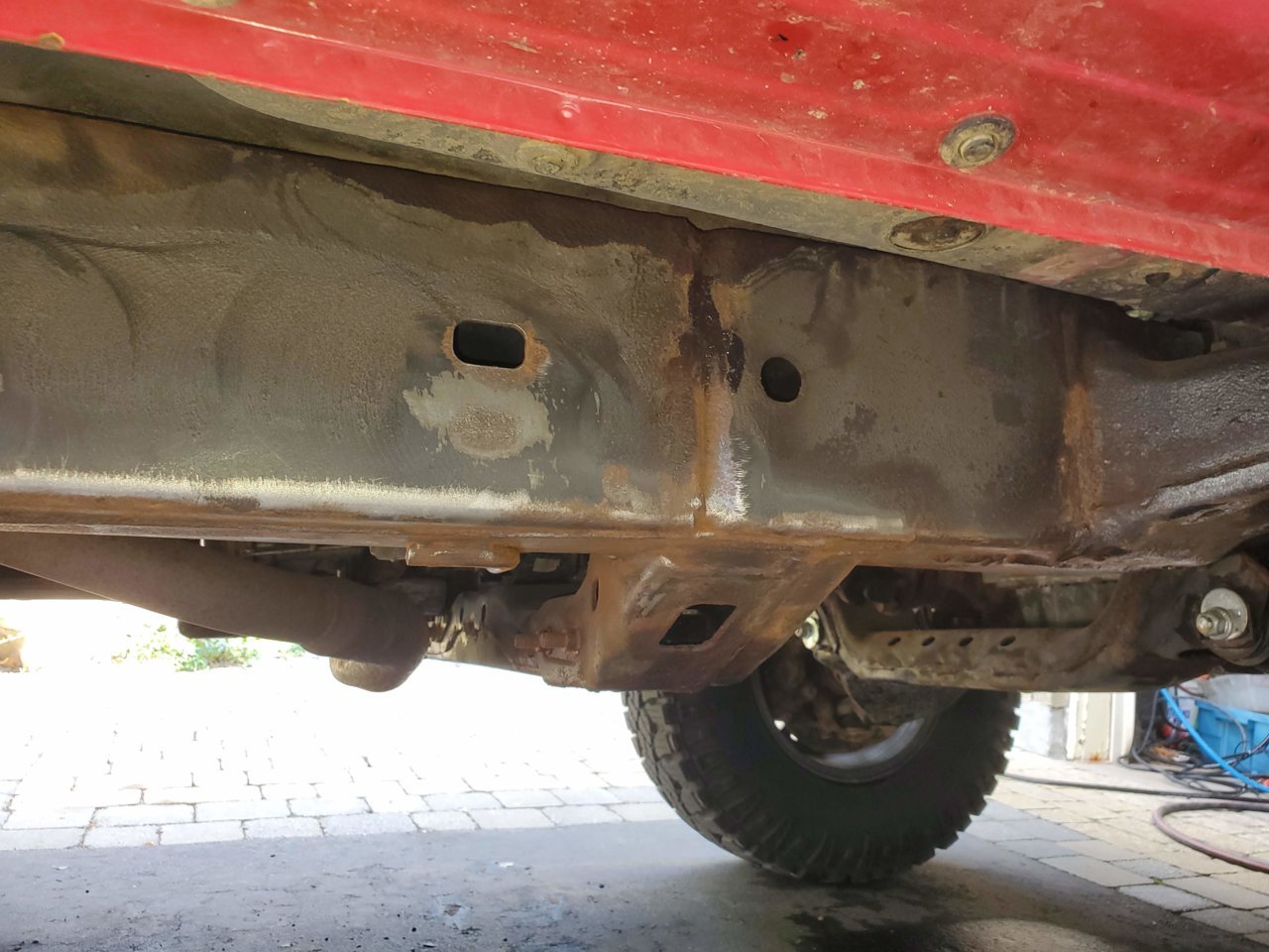

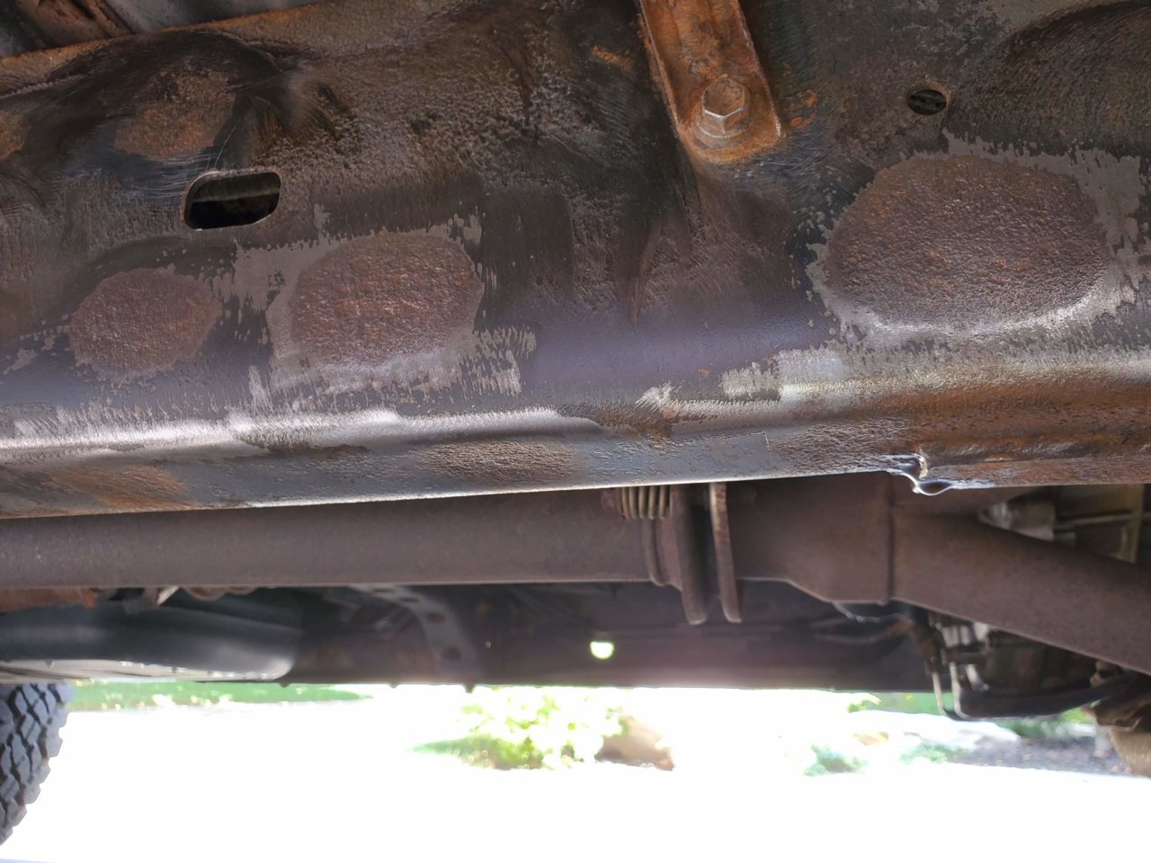

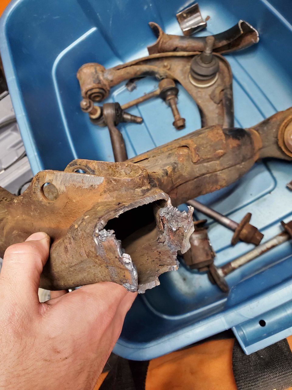

    Time to POR15 the frame.
    Not many pics, it was messy.
    Only one new little drain hole. OEM+
    Washing inside the frame i lost some material. #weightReduction #raceCar
    No pics of finished product... But It looked better.

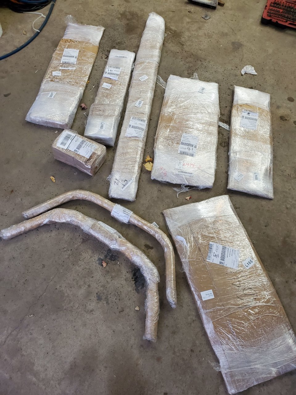

    Package arrived from Costal offroad!

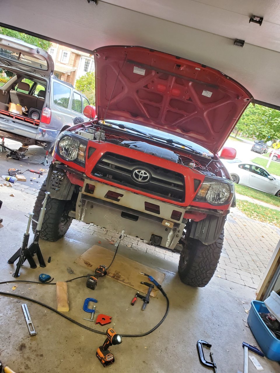

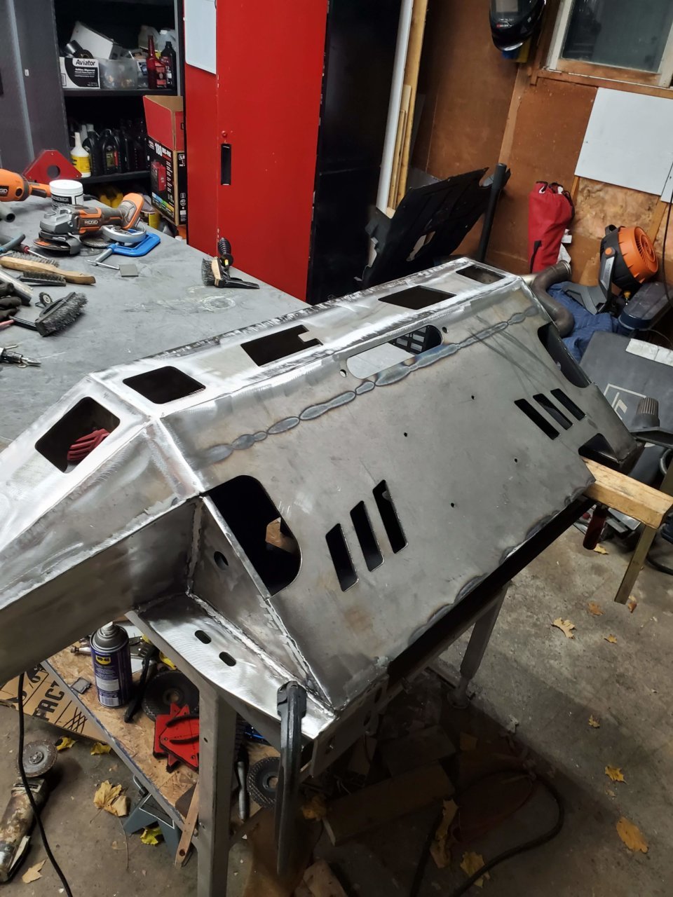

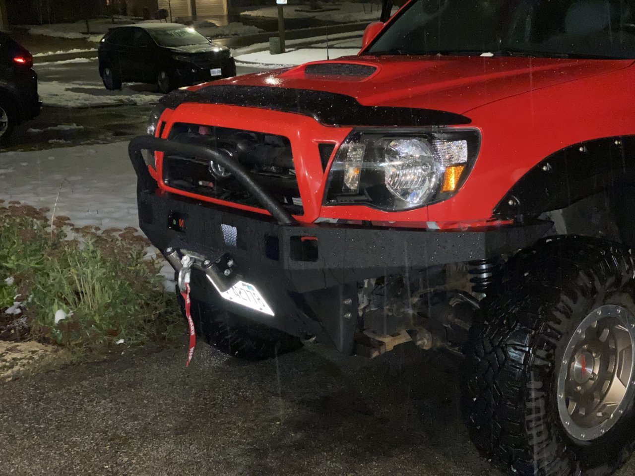

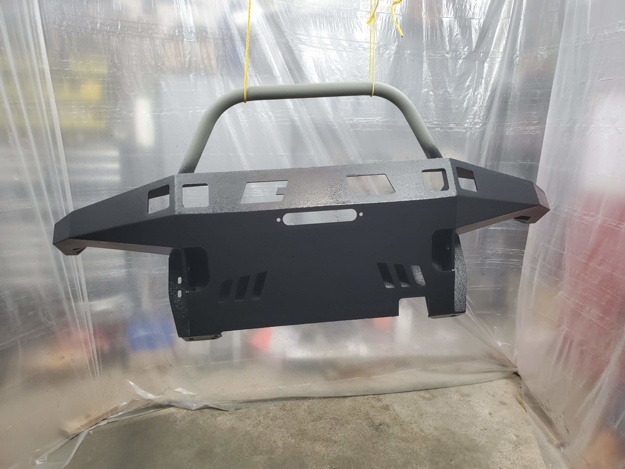

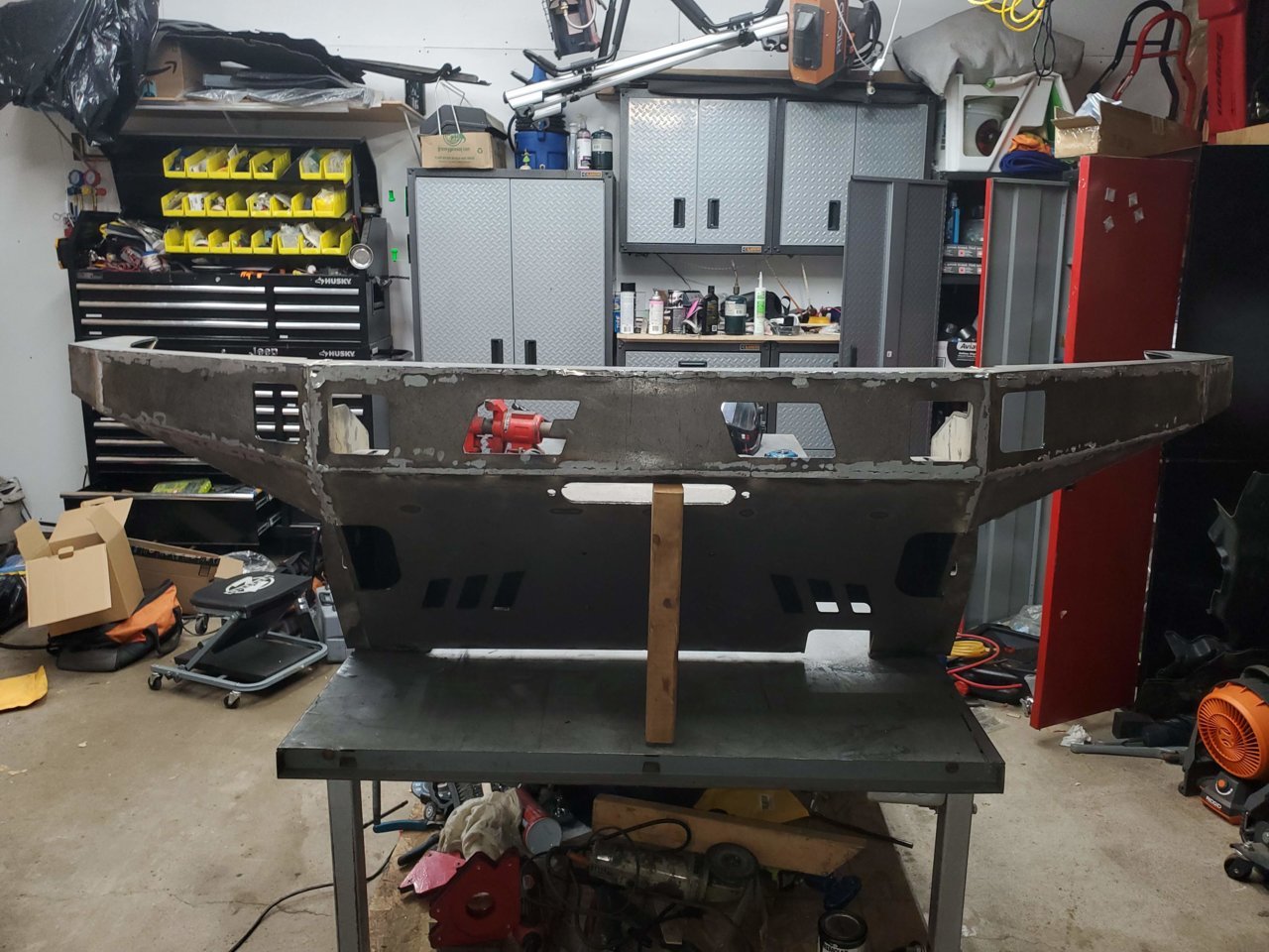

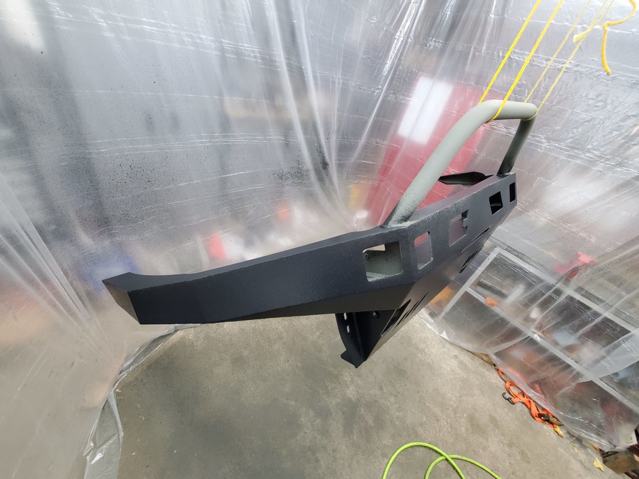

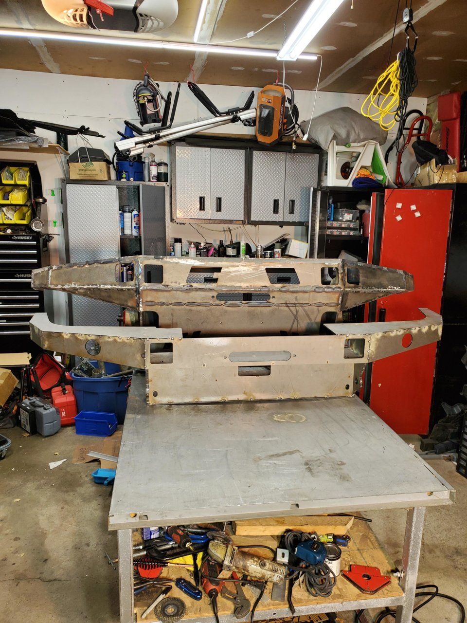

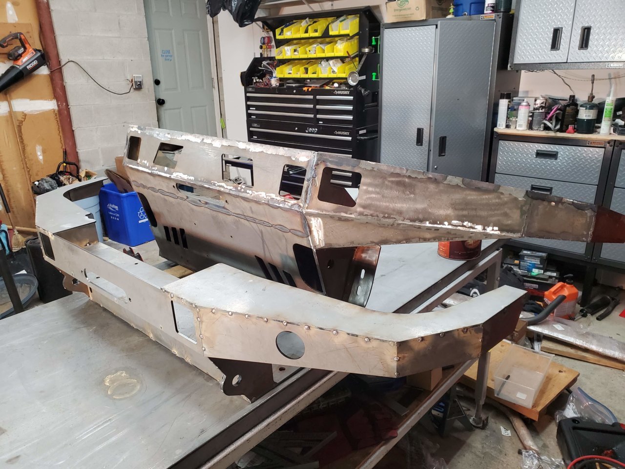

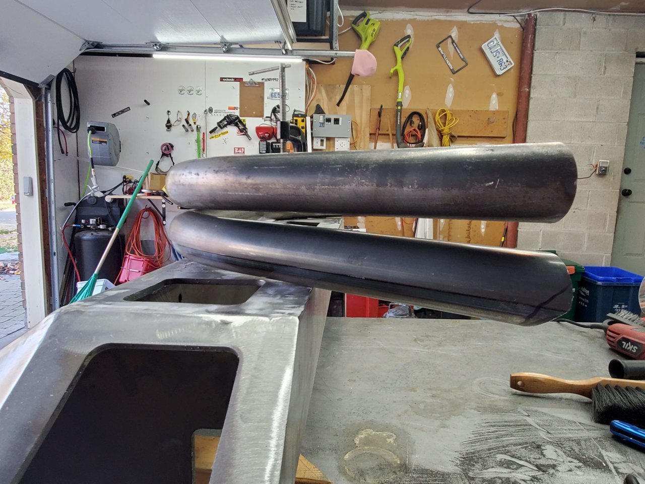

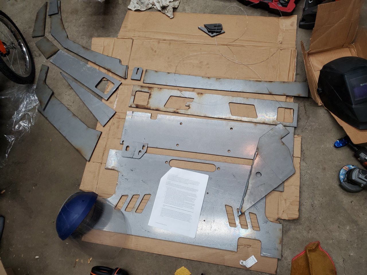

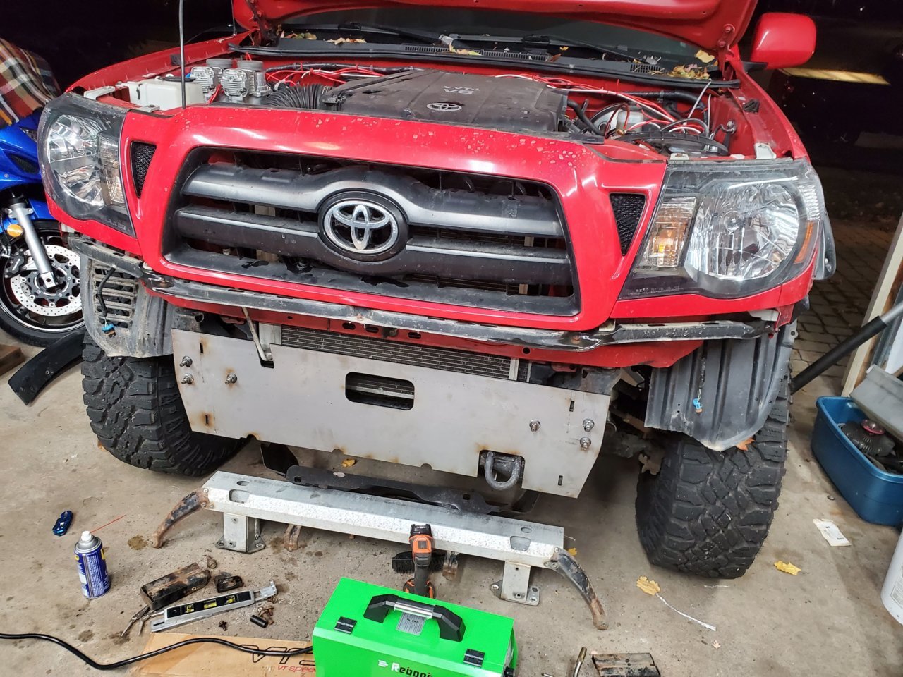

    Building Front Bumper
    Day 1
    - Remove OEM stuff and bolt up the first plate.
    Day 2
    Start to build the bumper
    Day 3

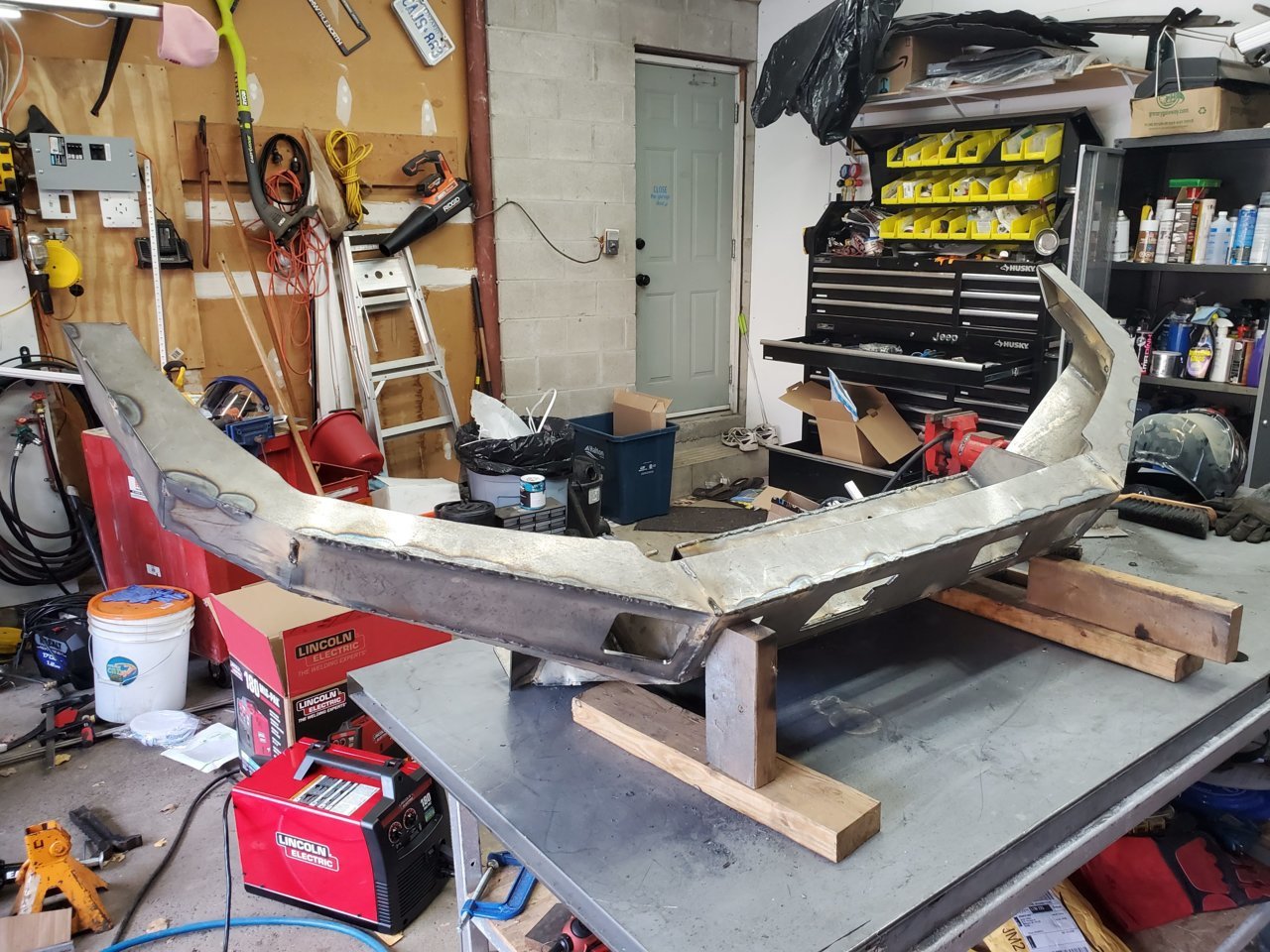

    -finish driver side wing
    Day 4
    -Final weld the bits that get hidden by the final plate.
    Day 5
    -Paint the hidden parts

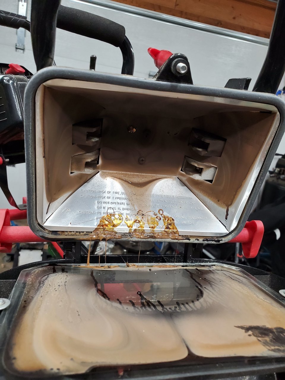

    -My heat lamp exploded
    Day 6

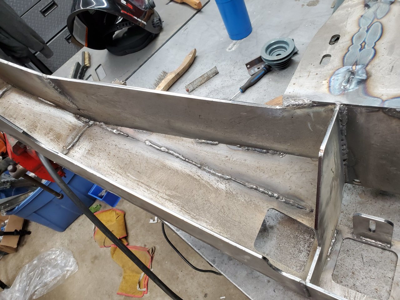

    -final welding the bumper going slow so I dont warp it
    Day 7
    - More welding
    - Some grinding
    - Realizing how much work this actually is going to be
    Day 8

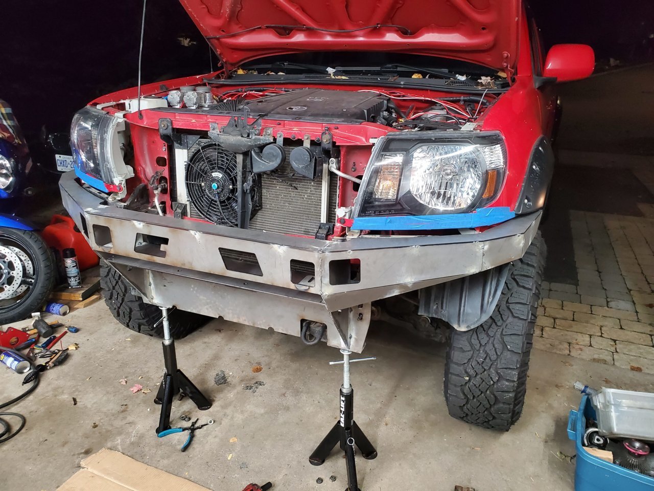

    - Test fitting, Needed some motivation

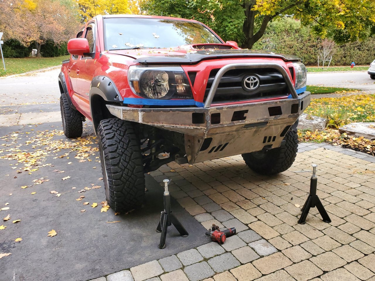

    Day 9

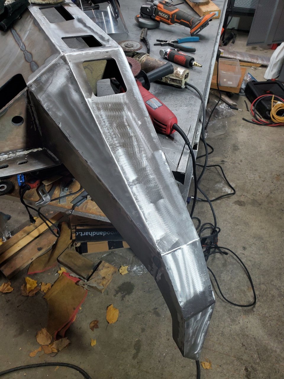

    - More grinding on the Tacoma bumper, also started a 4runner bumper.
    Day 10, 11, and 12
    - Grinding welding sanding
    Day 1020201105_180300.jpg Day 11 20201106_191913.jpg Day 1220201107_095731.jpg

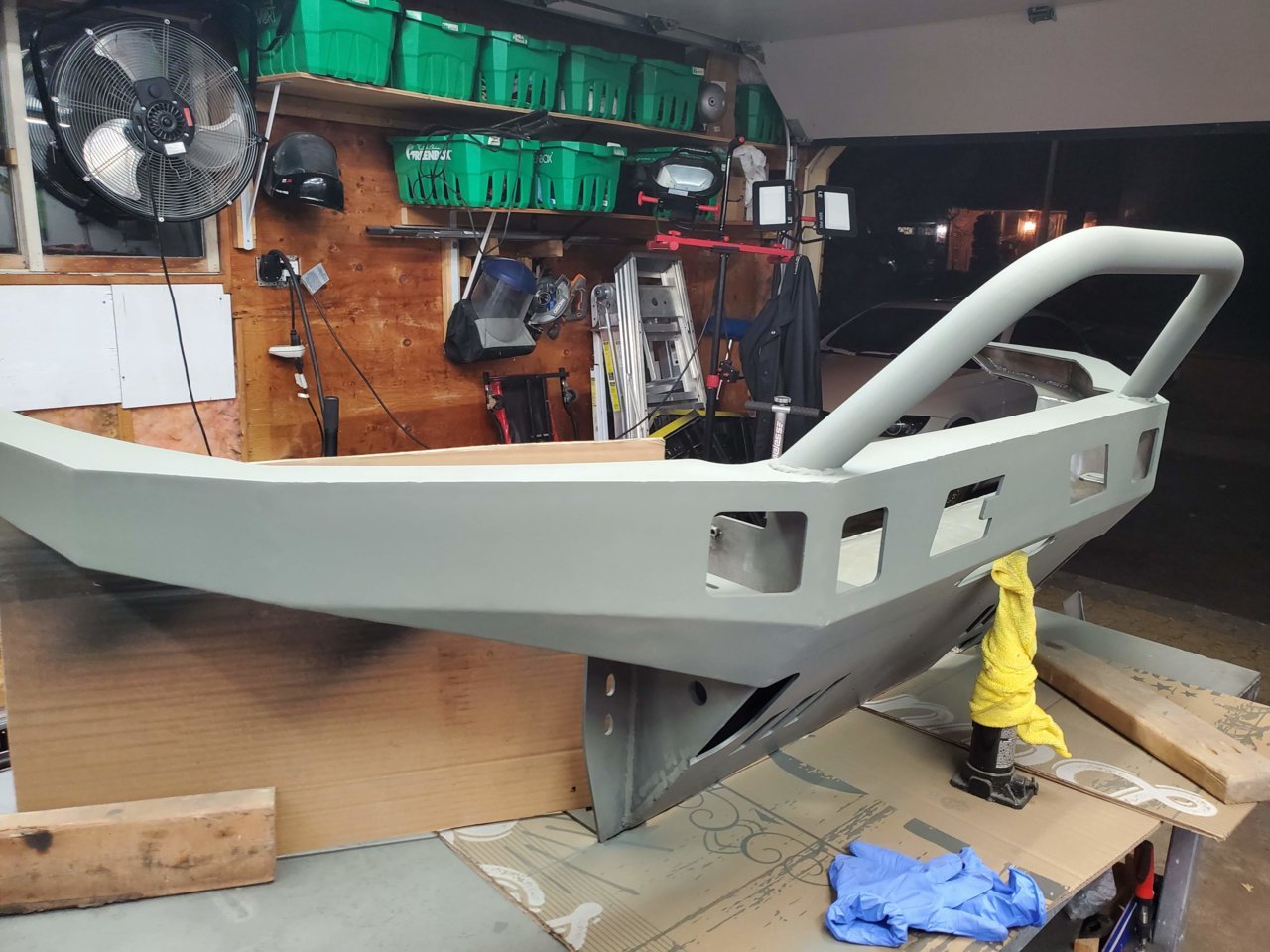

    Day 13

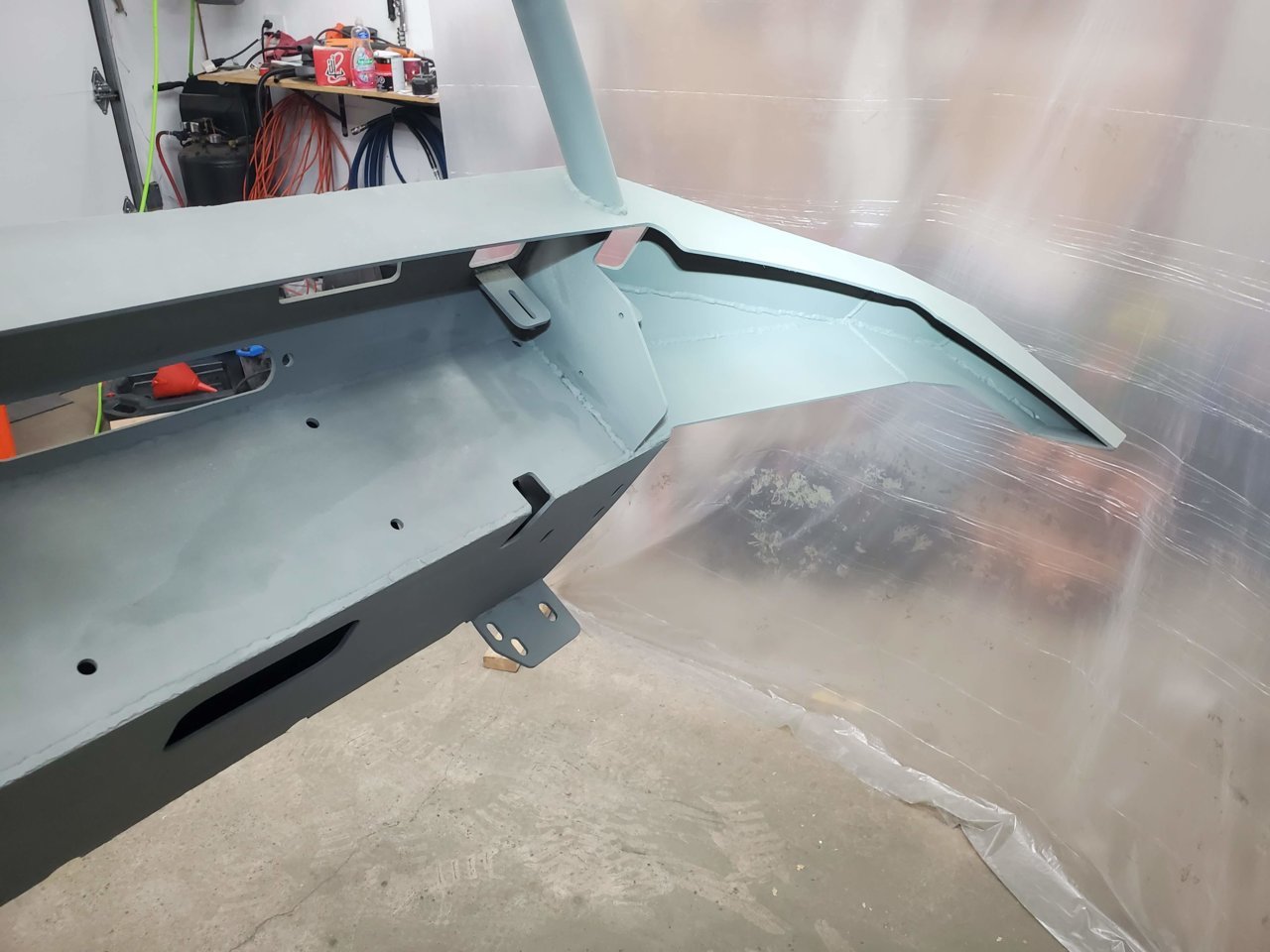

    - first coat primer
    Day 14

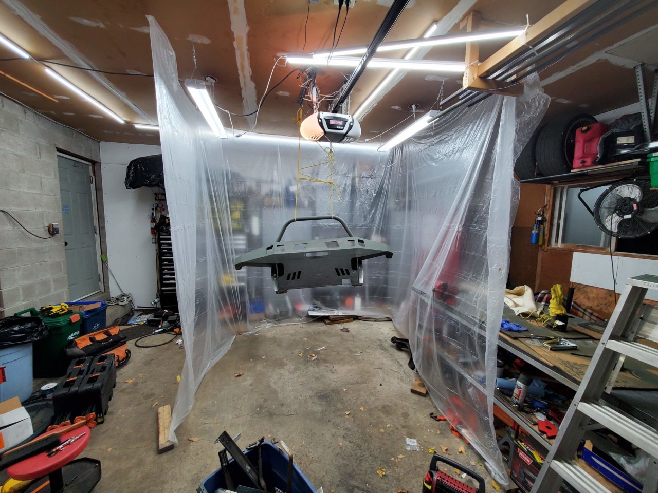

    - Build paint booth
    - Paint it all very fast not waiting long enough between coats
    Day 1420201119_200707.jpg Day 1420201119_214824.jpg Day 1420201119_220338.jpg Day 1420201119_220356.jpg
    Day 15

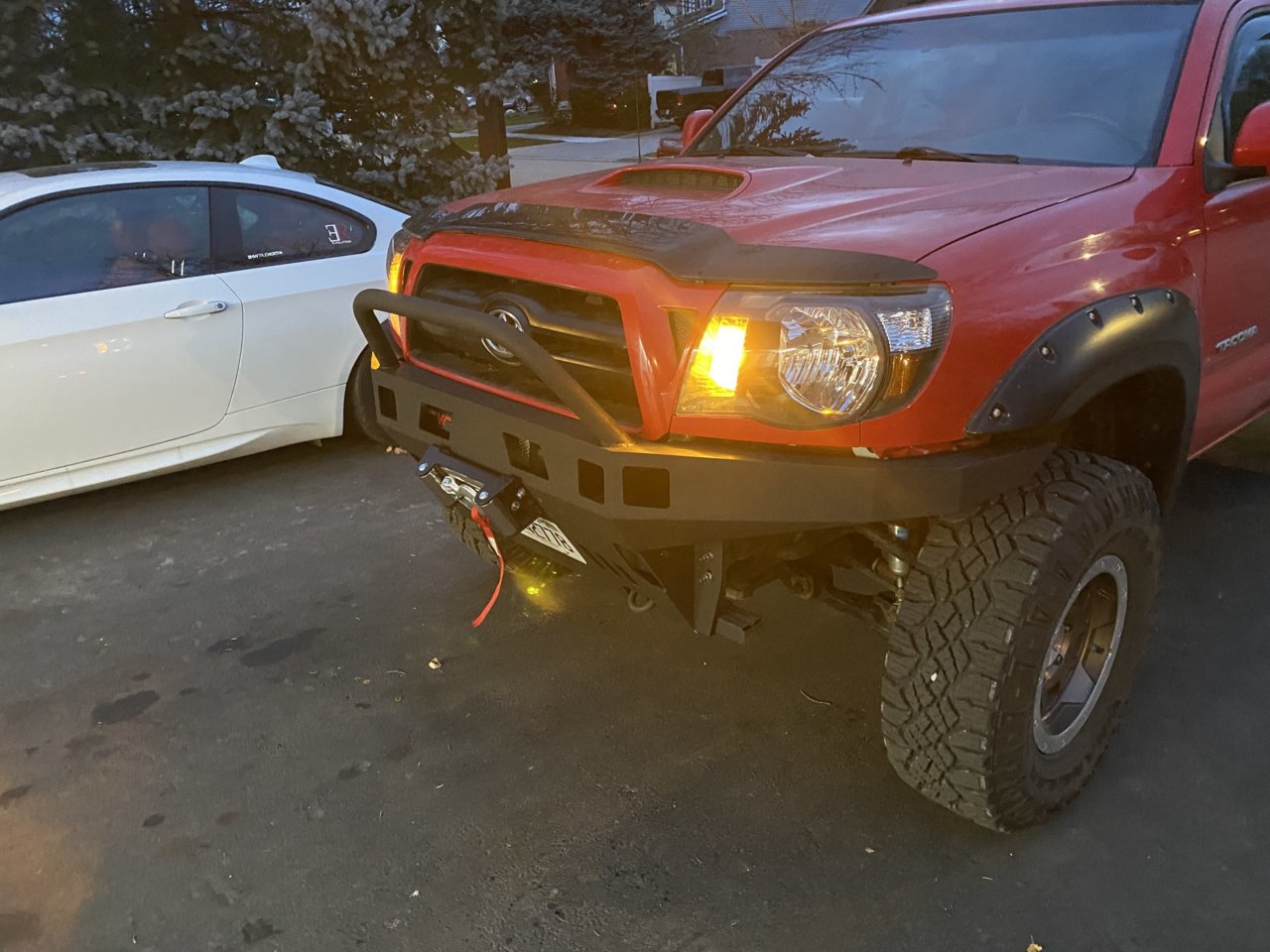

    Installed

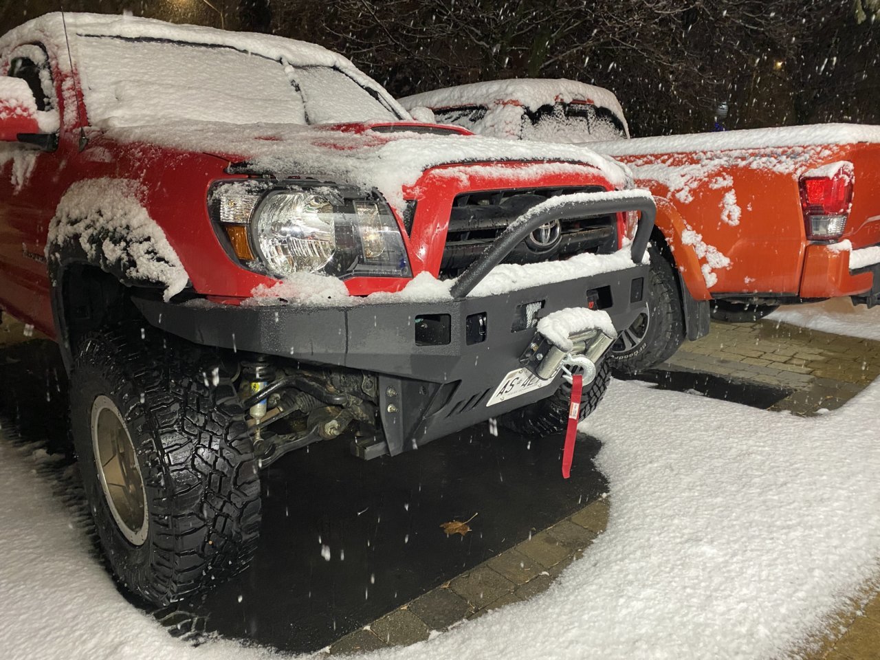

    Final product photos

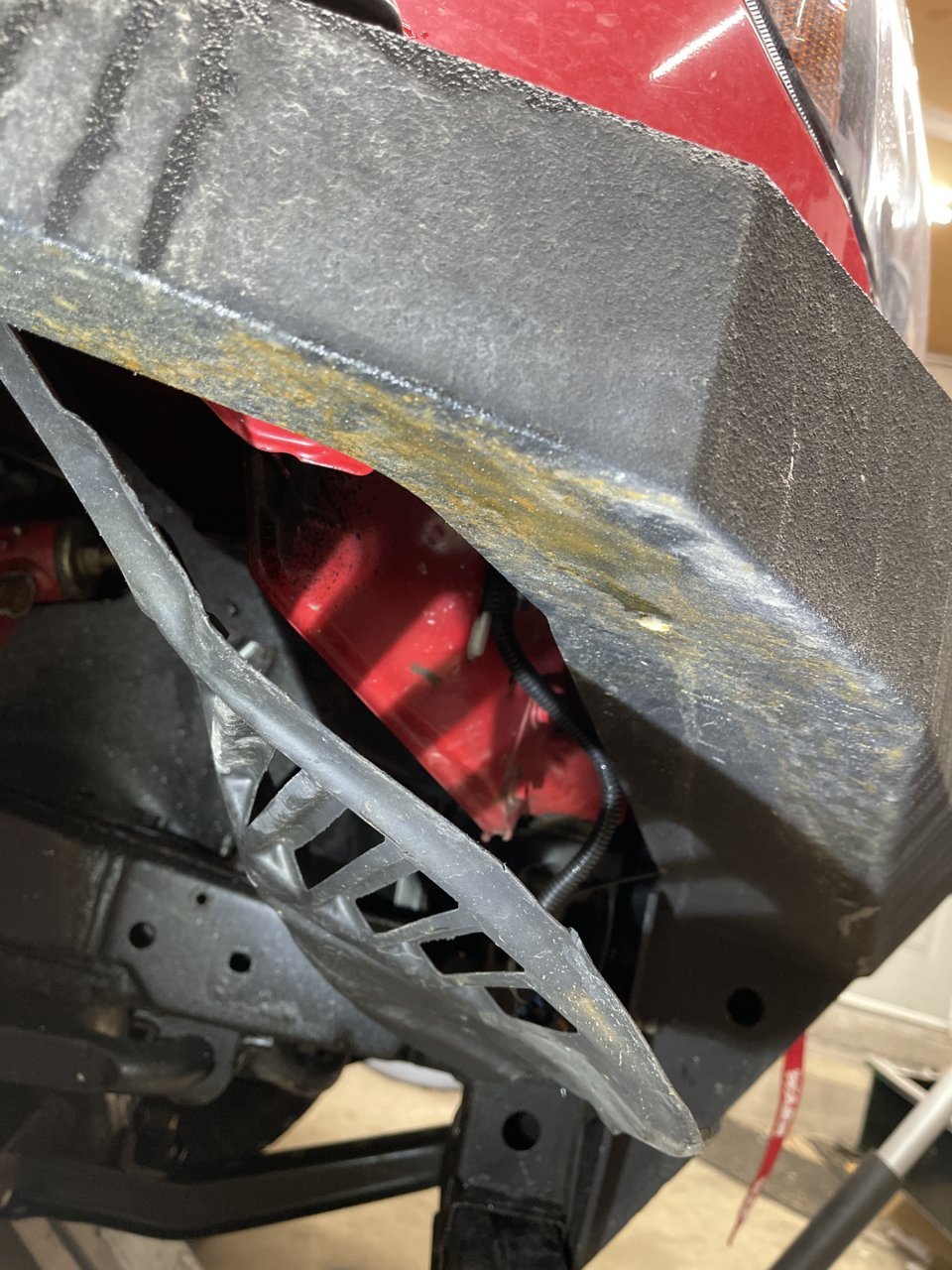

    About 3 weeks after it was installed i took a close look at the bumper. Its rusting through the paint in spots.
