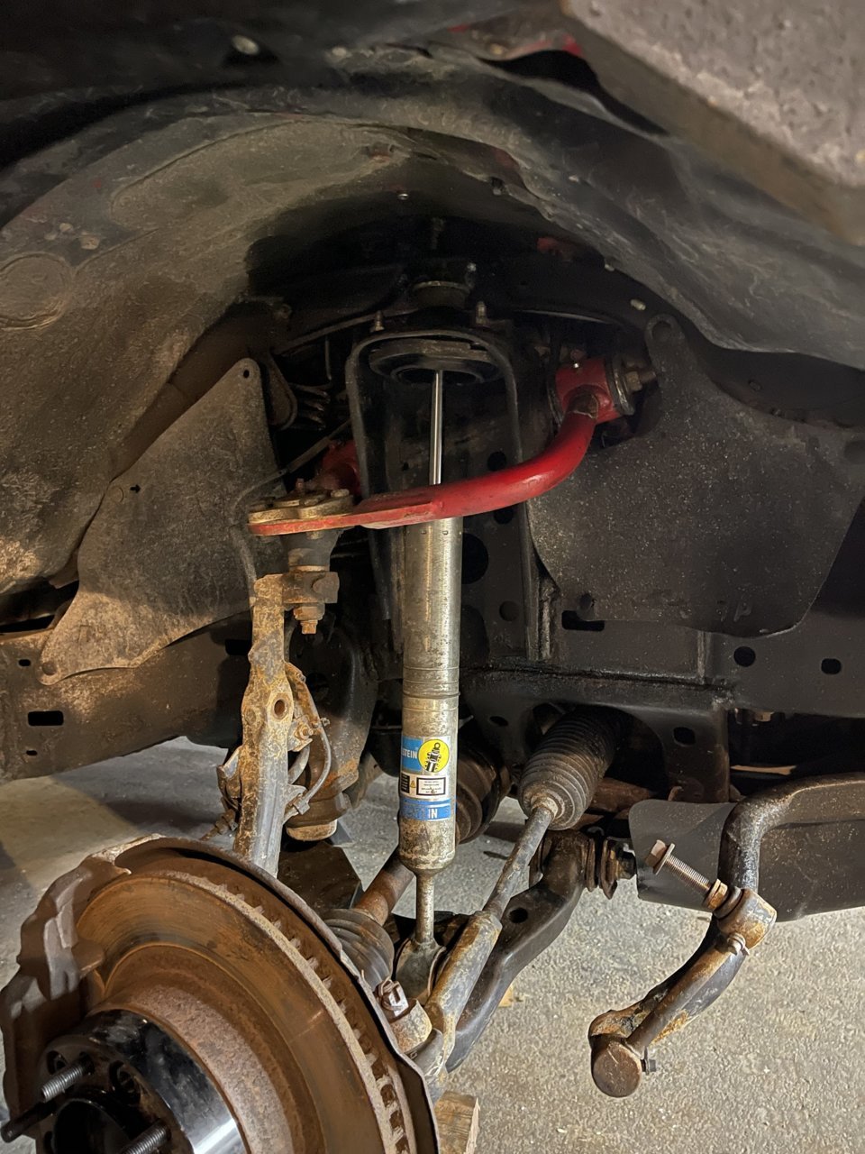

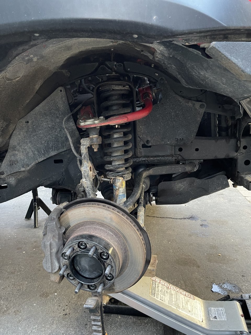

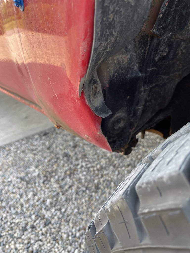

    I messed around with some suspensions setups, Decided on switching from 2885 to 2886 coils, and removing the spacer from the top of the shock strut. Also cut back more of the fender.

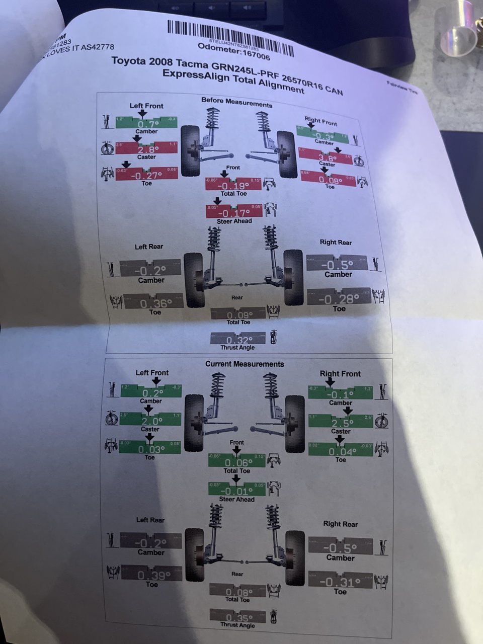

    Replaced both wheel bearings
    Replaced lower control arm bushings to whiteline bushings.
    Changed the 1.25 spacer for a 1" hub-centric spacer.
    Got an alignment

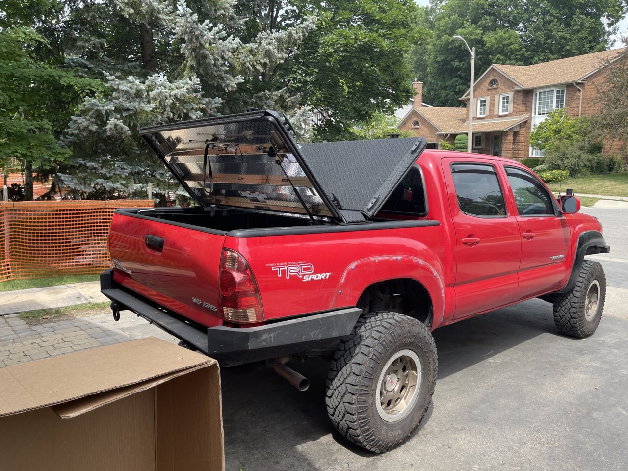

    1 year later Update
    - Added Diamond back cover
    - Added front runner roof rack
    - Added Midland Mobile GMRS radio
    - Added Renogy 100AH dual battery system
    - Rear seat delete
    - Removed Diff drop kit

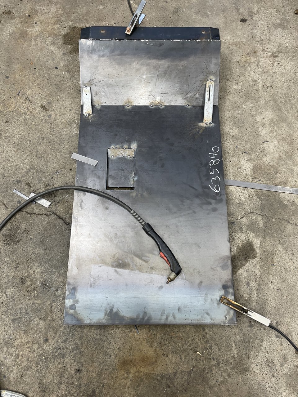

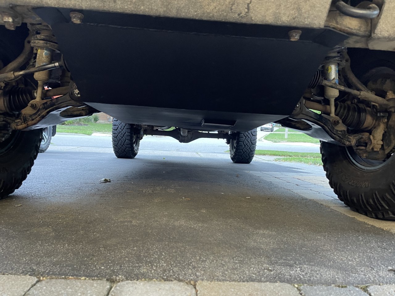

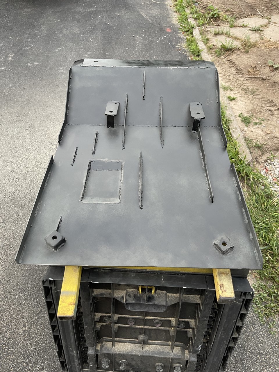

    - Built custom IFS skidplate (in progress right now)

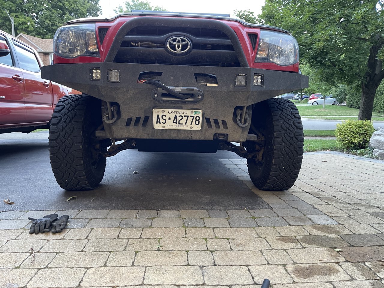

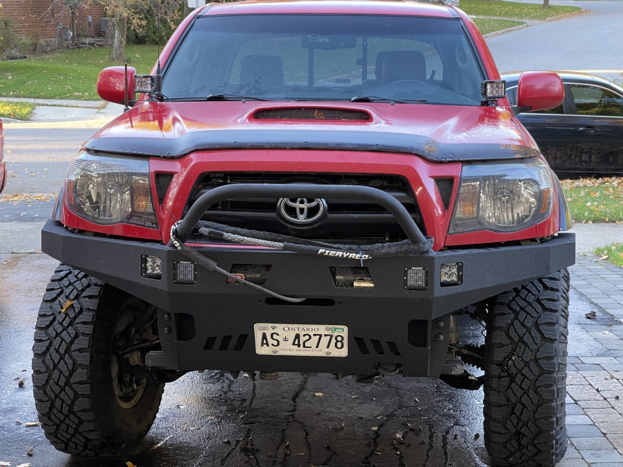

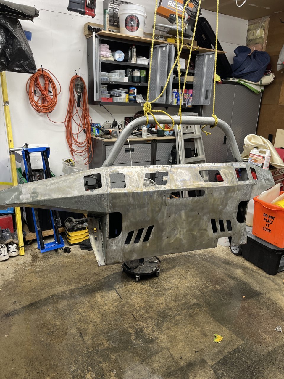

    July 14 2021

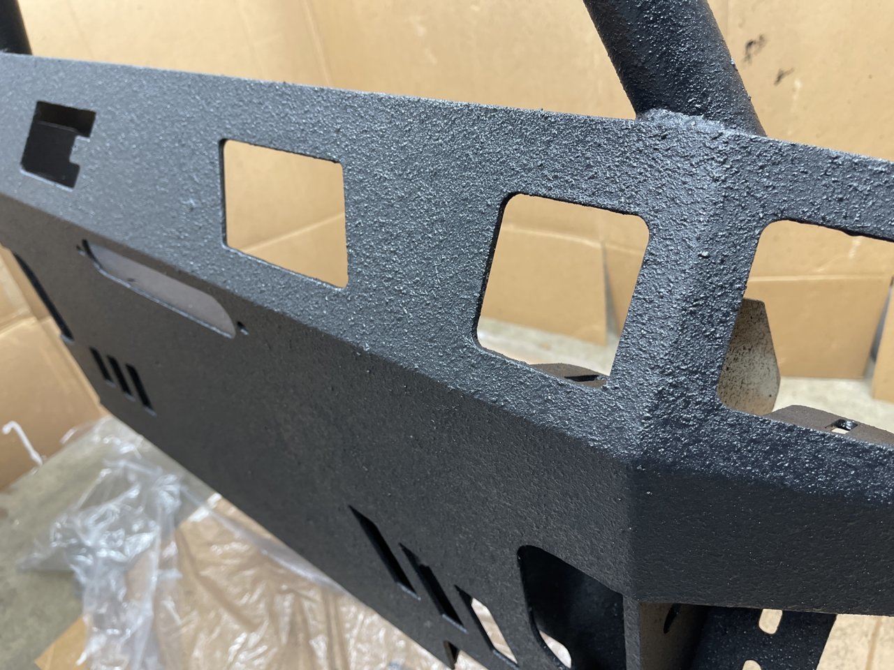

    Repaint front bumper

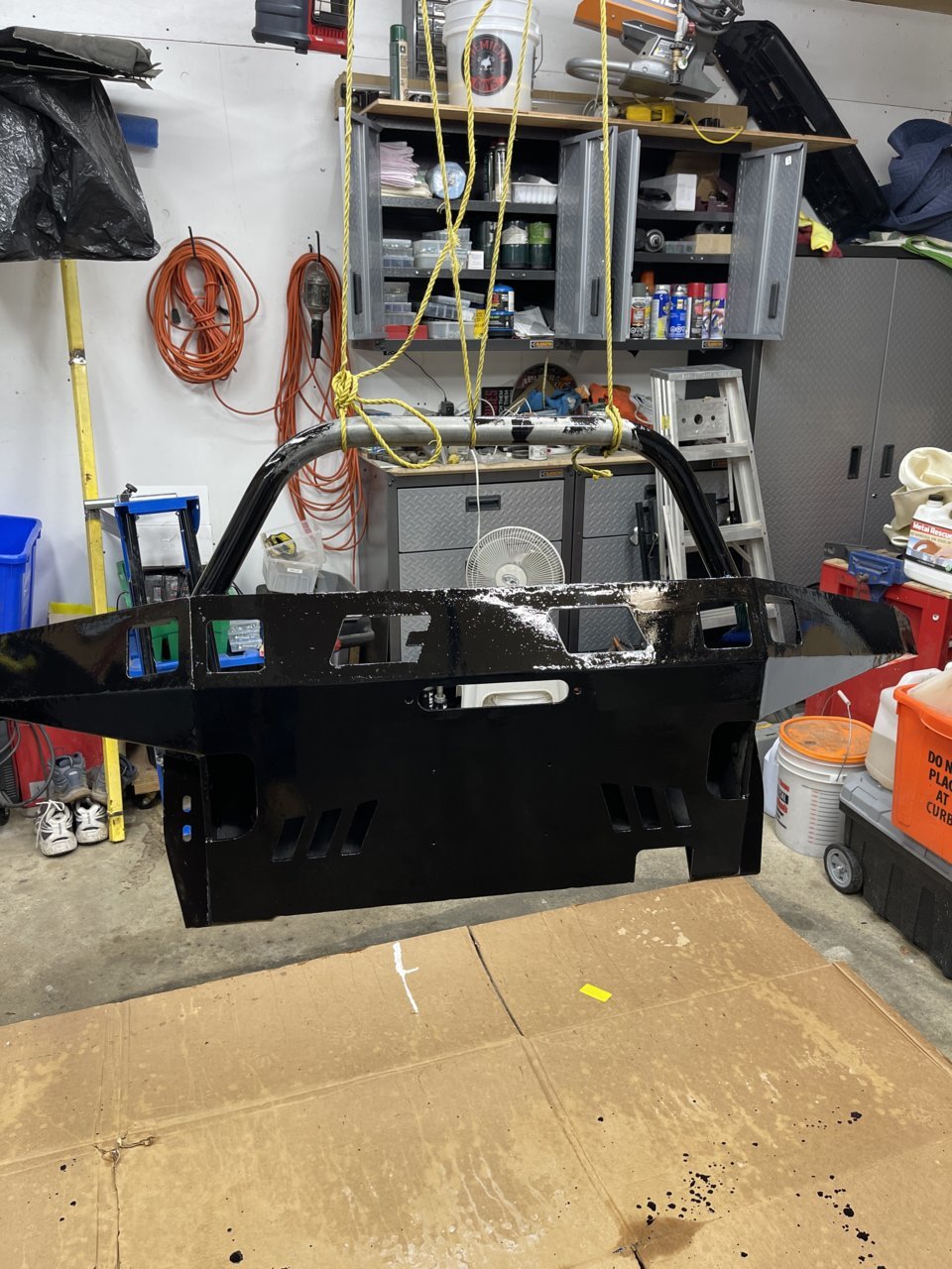

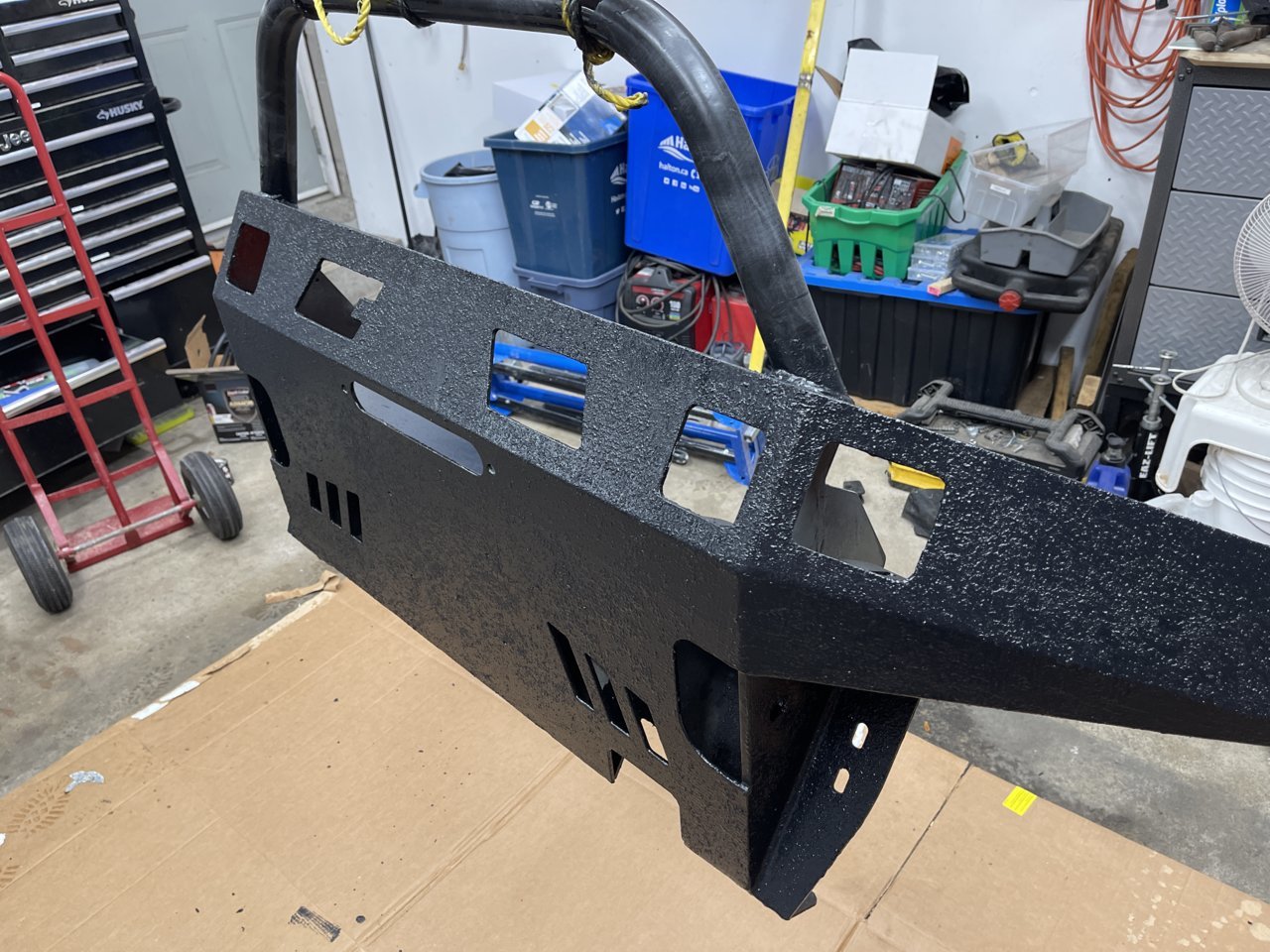

    Oct 8 2021
    Buy a house Delayed the bumper repaint project.
    Oct 24 2021
    Paint finally removed
    POR15 coat
    Bedliner spray

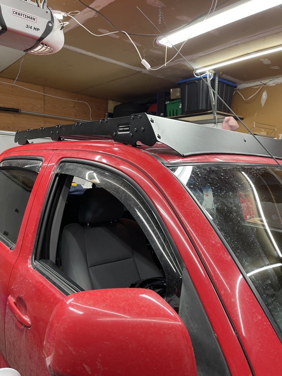

    Frontrunner slimsport roofrack installed

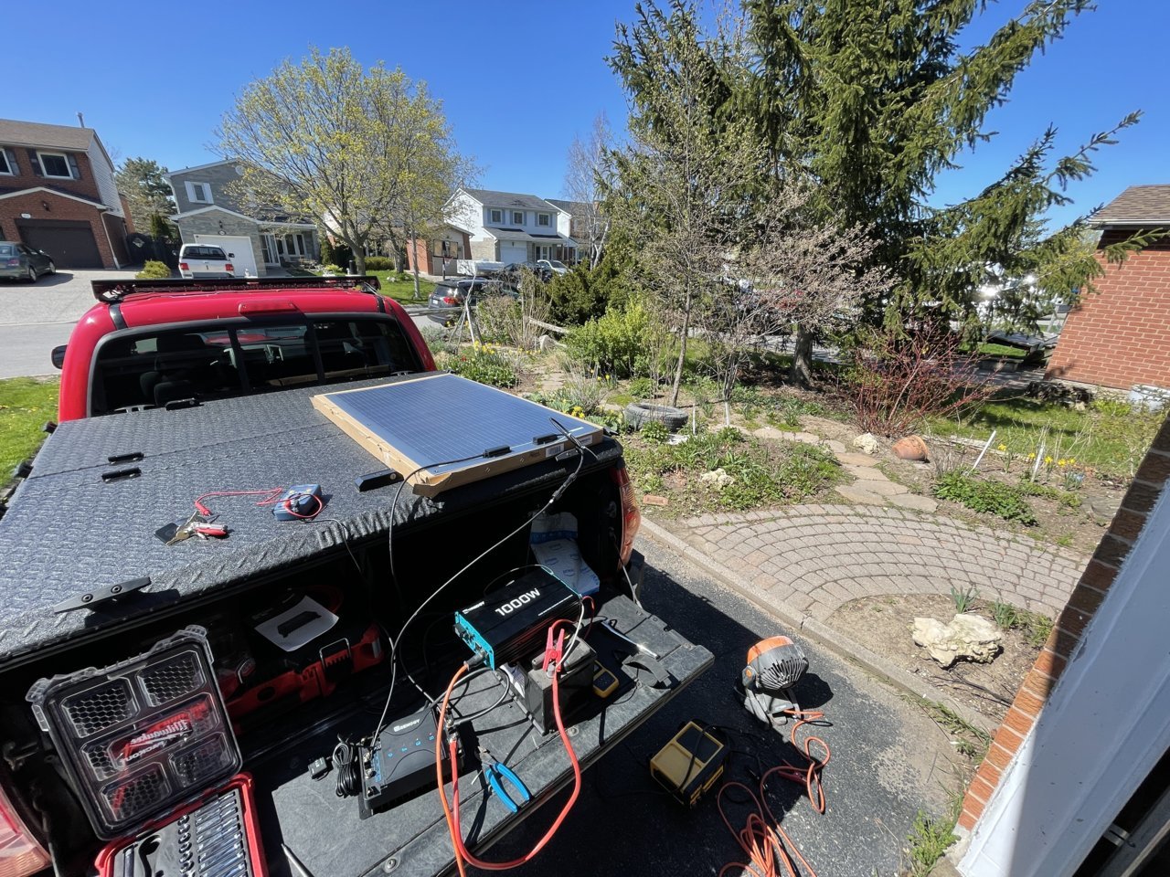

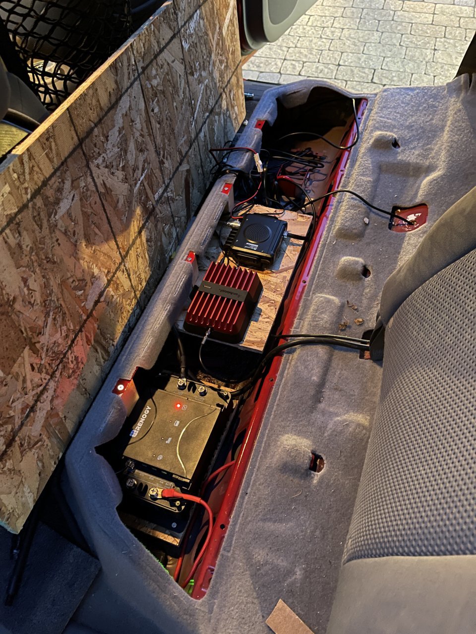

    Testing the New dual battery system. Still waiting on the battery.

    It’s holding up a lot better then my first paint job.
    so far no rust has come through except where the bolts go it it has a little starting.
    acetone
    por15 metal prep
    2 coats por15 paint rough sanding in between coats.
    Used a file to knock down my runs because.
    Rough sanded the entire thing.
    Canadian tire Bedliner through a spray gun.

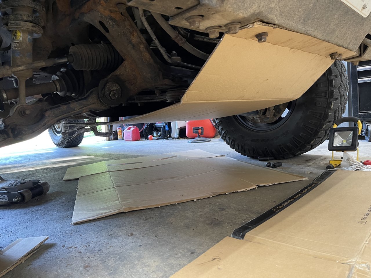

    Skid plate finished and installed

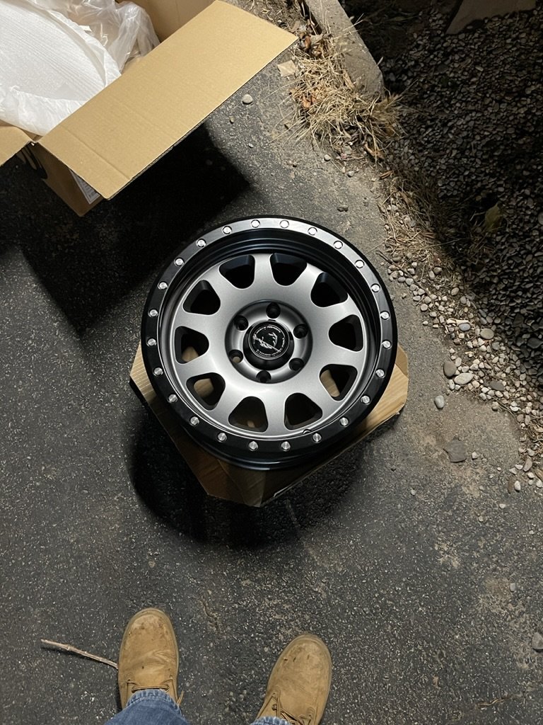

    Got some catchup to do.

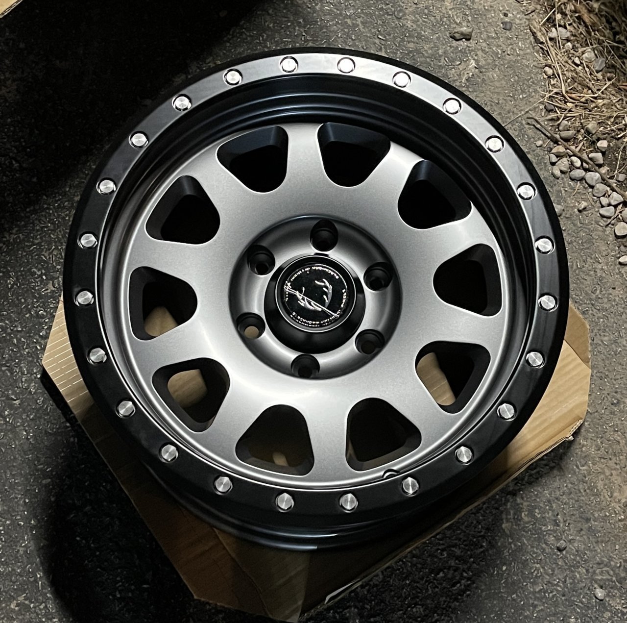

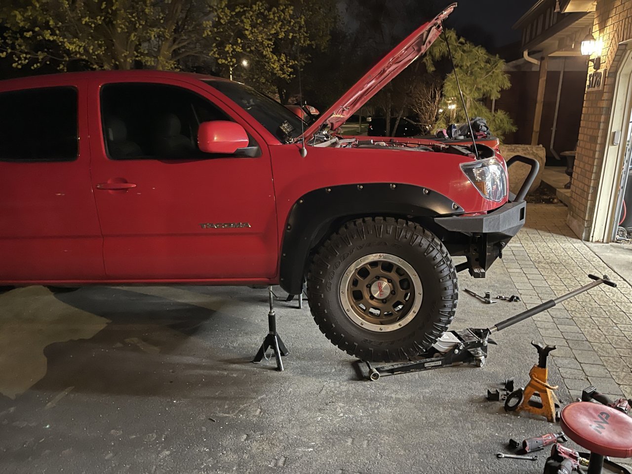

    Had a wheel rattle loose last year, damaged a rim looked expensive to fix so got new wheels and 35s.
    Toyo Open Country AT 11.5x35 r17
    Oval lug nut holes
    new wheels
    tires installed
    Weights already falling off. @1010 tires Oakville get better at sticky

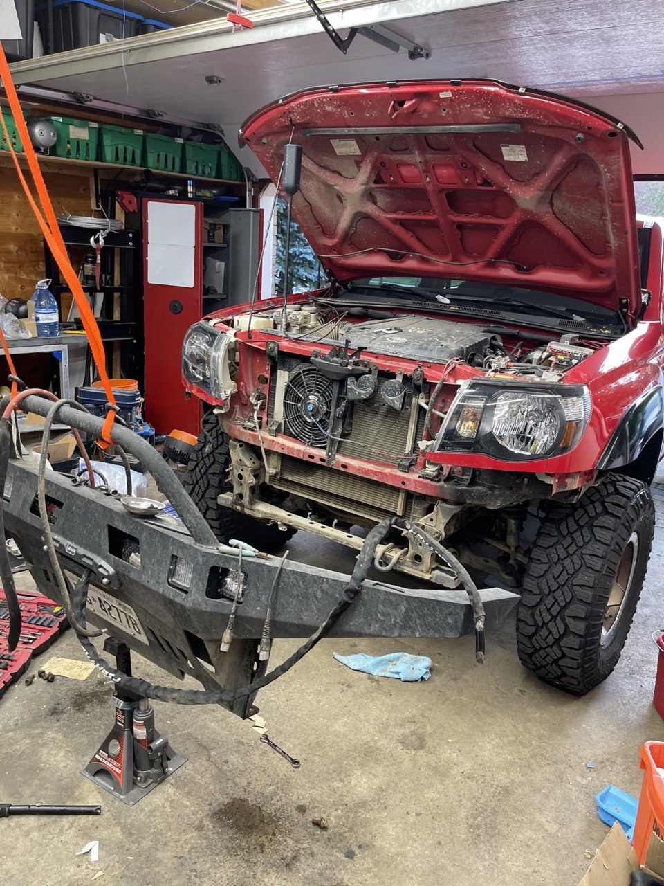

    More cutting
    Windigo likes this.

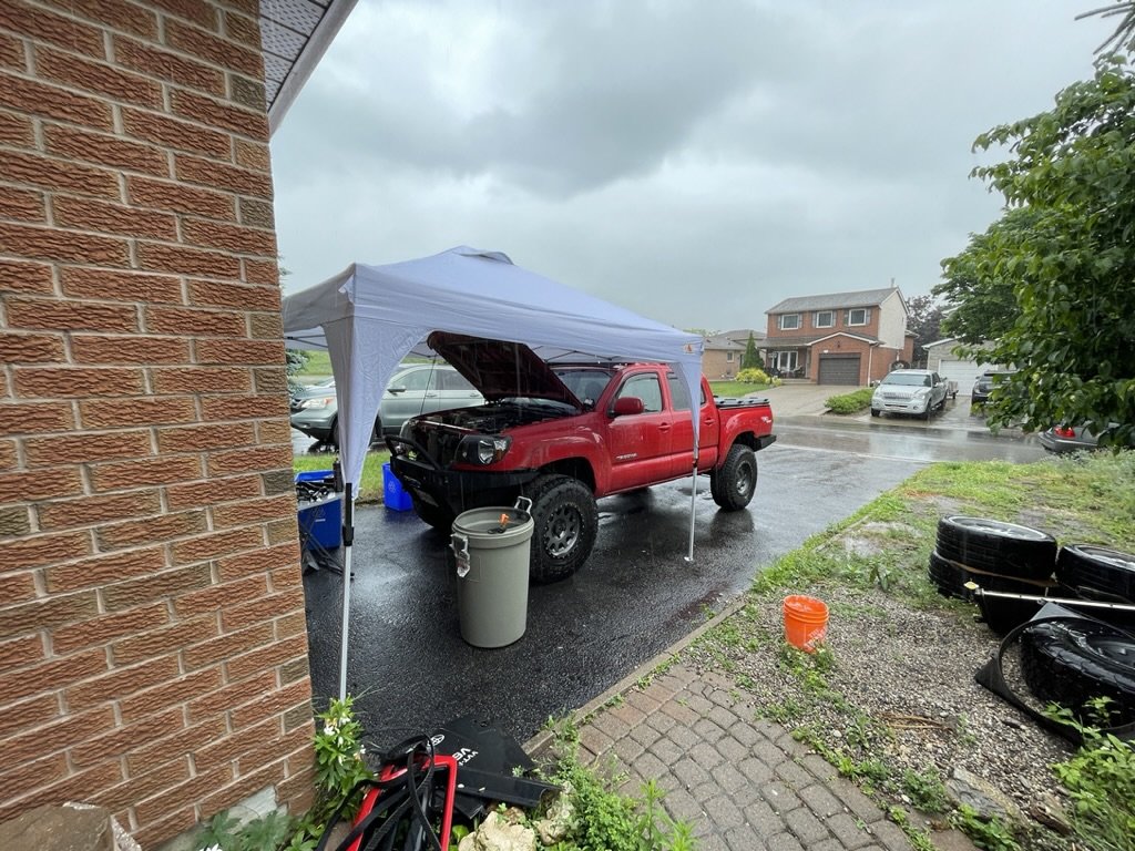

    Light bars, no lockers

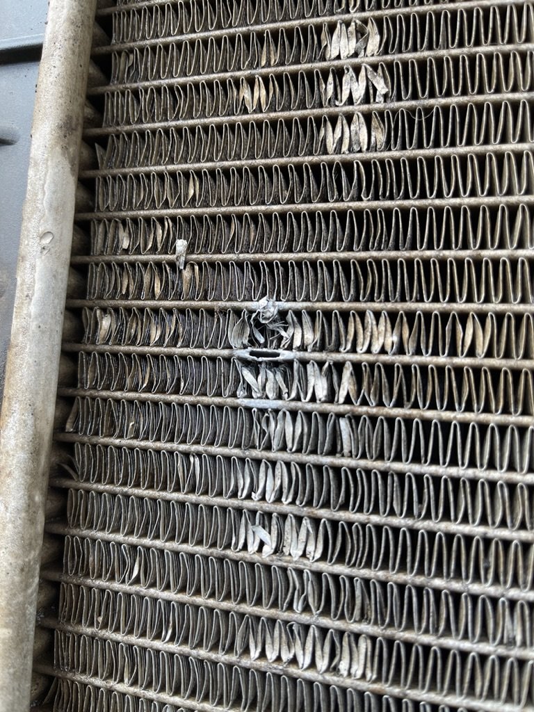

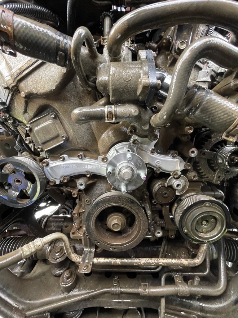

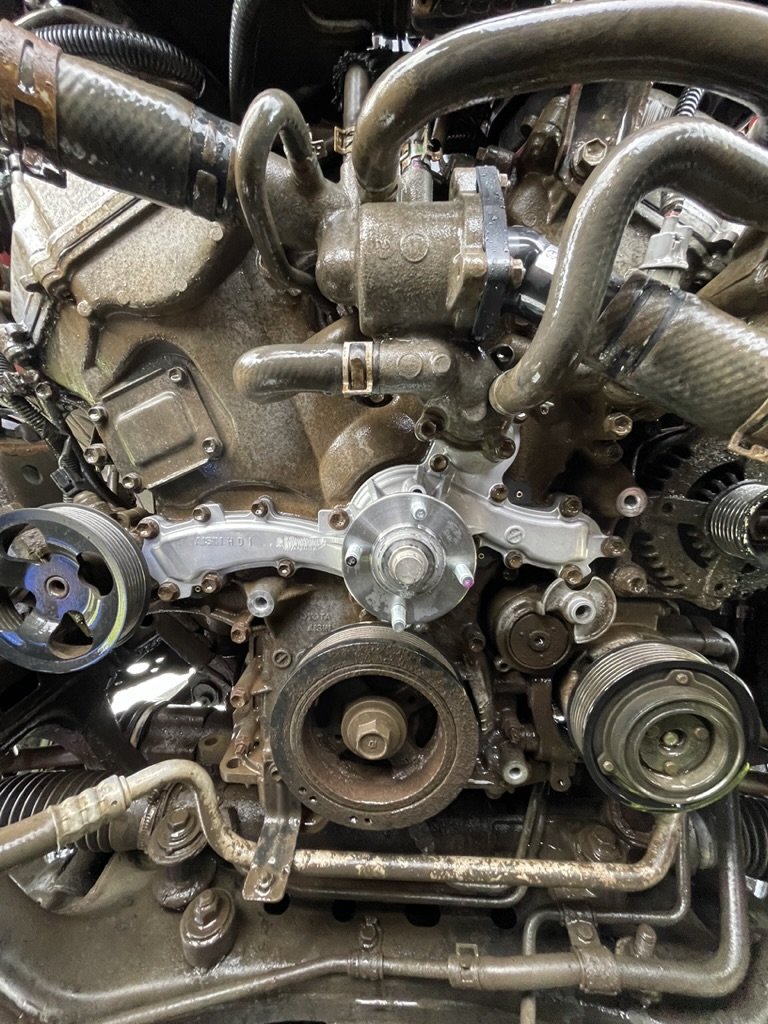

    New Thermostat, waterpump, radiator, and pulleys.
    Fixed air compressor electrical issue.
    Replaced the drum brakes.
    replaced blower motor, Old one was squeaky.
    Old radiator. Could be JB welded if i had to.
    Windigo likes this.

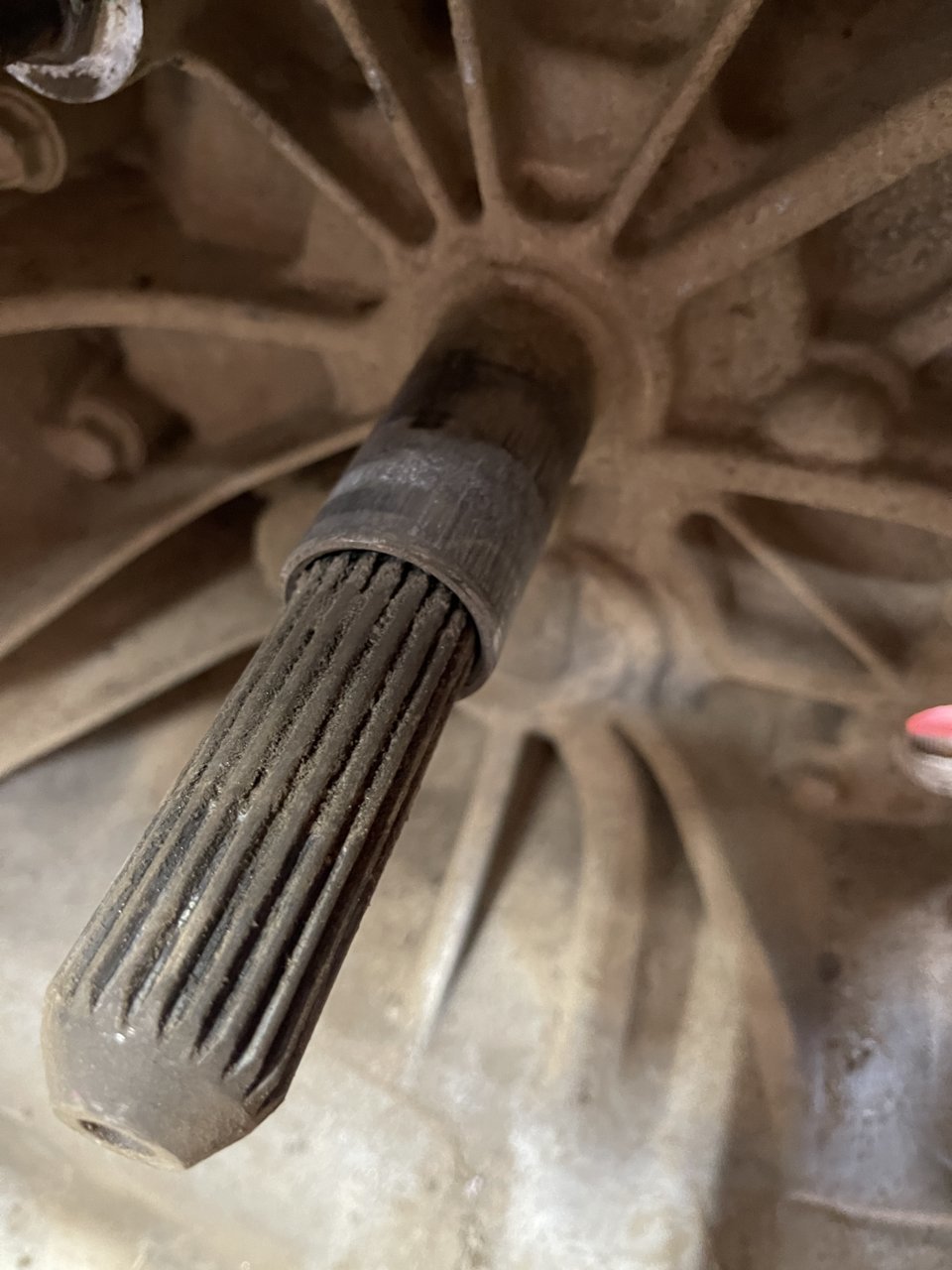

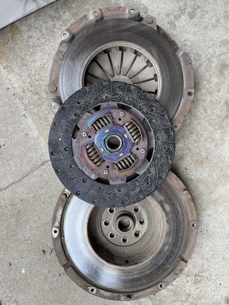

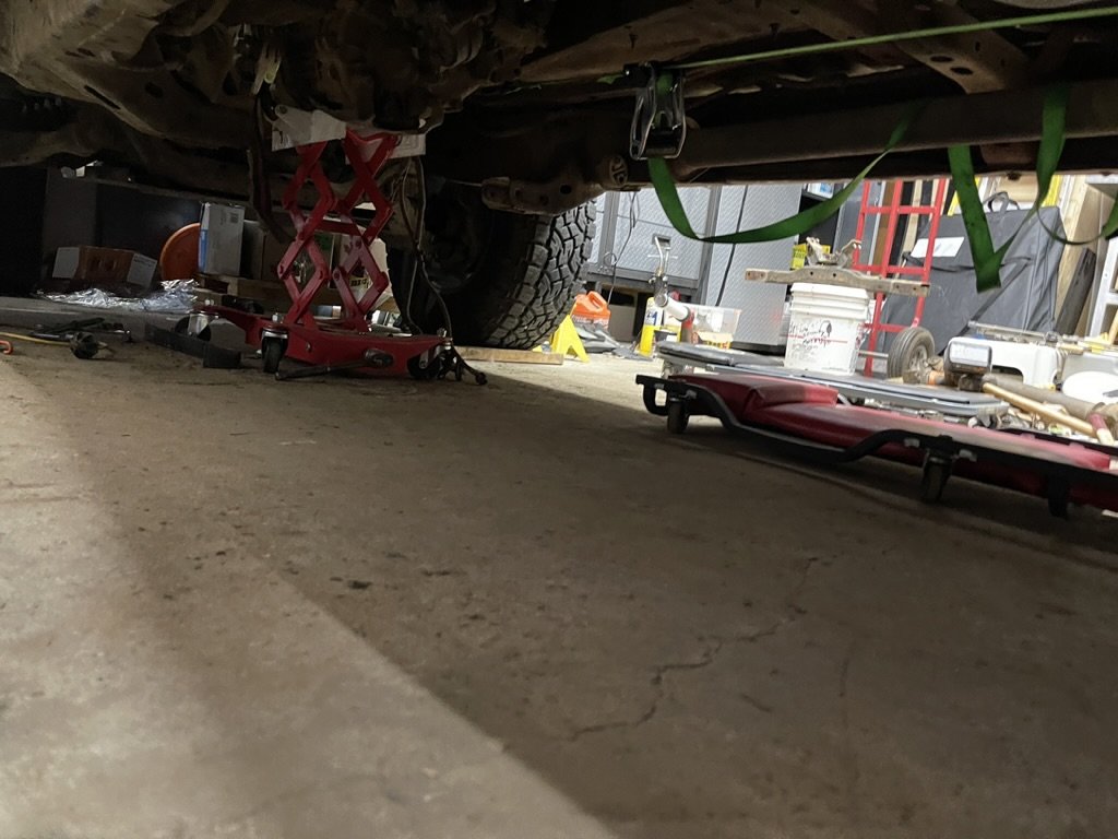

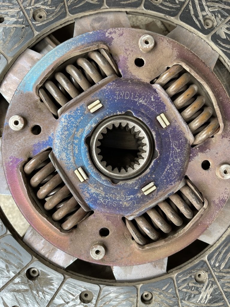

    And Replacing the clutch now.
    Looks like someone has been in here before. Dont think Exedy clutch is OEM. And one of the top transmission bolts was cross threaded.
    Quill looks fine.
