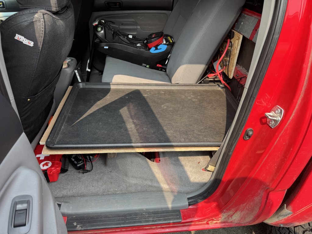

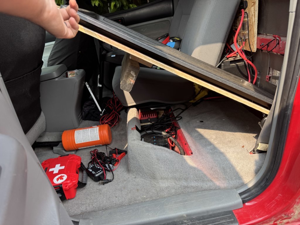

    Quick and dirty dog platform. Bolts to factory seat hinges. Should be good enough. And provide some airflow to the battery charger under there.

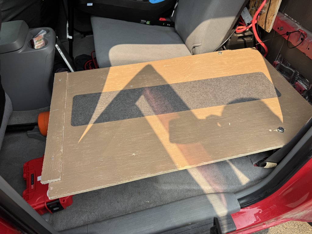

    Out this weekend testing the setup with the entire family, Wife, 3 month old, and dog.
    Good stuff.
    • Dog platform worked perfect. didnt slide around at all. Dog slept the entire way no throw up. Could be made 3-4" taller if i wanted more storage under it.

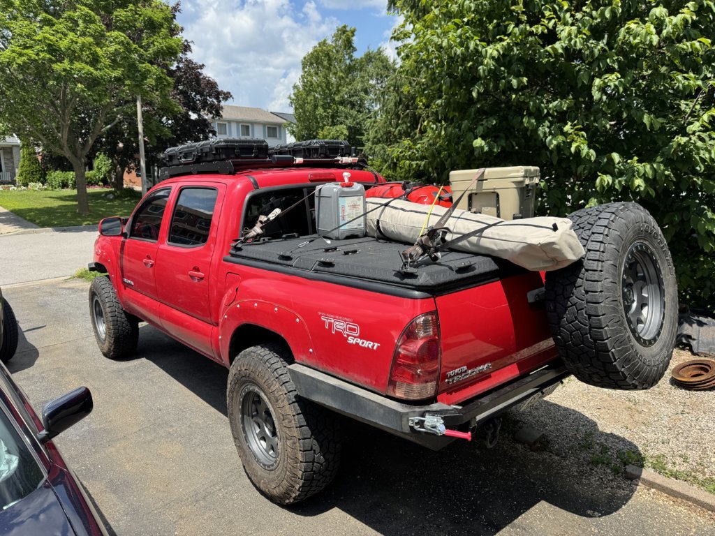

    All my tailgate supports broke off. might address that someday.
    https://youtube.com/shorts/RO6Gscclnqg

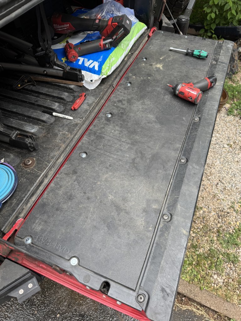

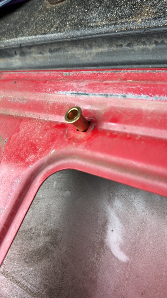

    Replaced the plastic screw plugs with some M6 rivnuts. Almost fit just needed a little die grinder action to oval out the square hole. used some m6 hex bolts to secure the tailgate pannel. much tighter now.

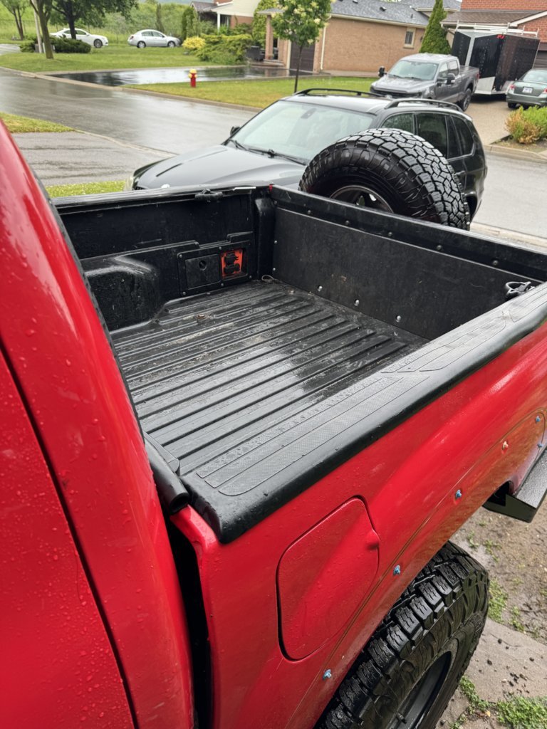

    Removed the diamond back to transport some tires. 5.29 gears in a empty truck + rain. Tires just slip allover truck needs the toolbox in the bed.

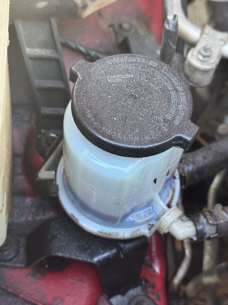

    Havent done much. Power steering started making noise today. for some reason it was low.

    That power steering fluid going somewhere.
    Still have my pump if you need it. Id be checking the rack

    It looked like it leaked out of the reservoir. I cleaned it all good so i can watch for. fresh leak.
    didnt see anything on the steering rack boots, but they can hold some before it shows.
    My rack only has a few thousand KM on it.

    Road trip this weekend with the truck. Power steering level did not change. maybe it was trapped air? idk

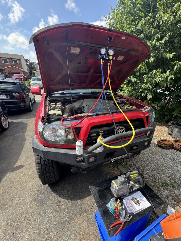

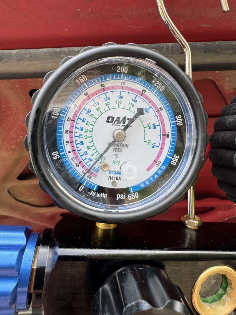

    AC has stopped working, Low side 5PSI when engine running, 90psi engine off. I noticed the high side schrader valve was not sealing correctly. Ordered a replacement. Then i will vacuum and recharged.

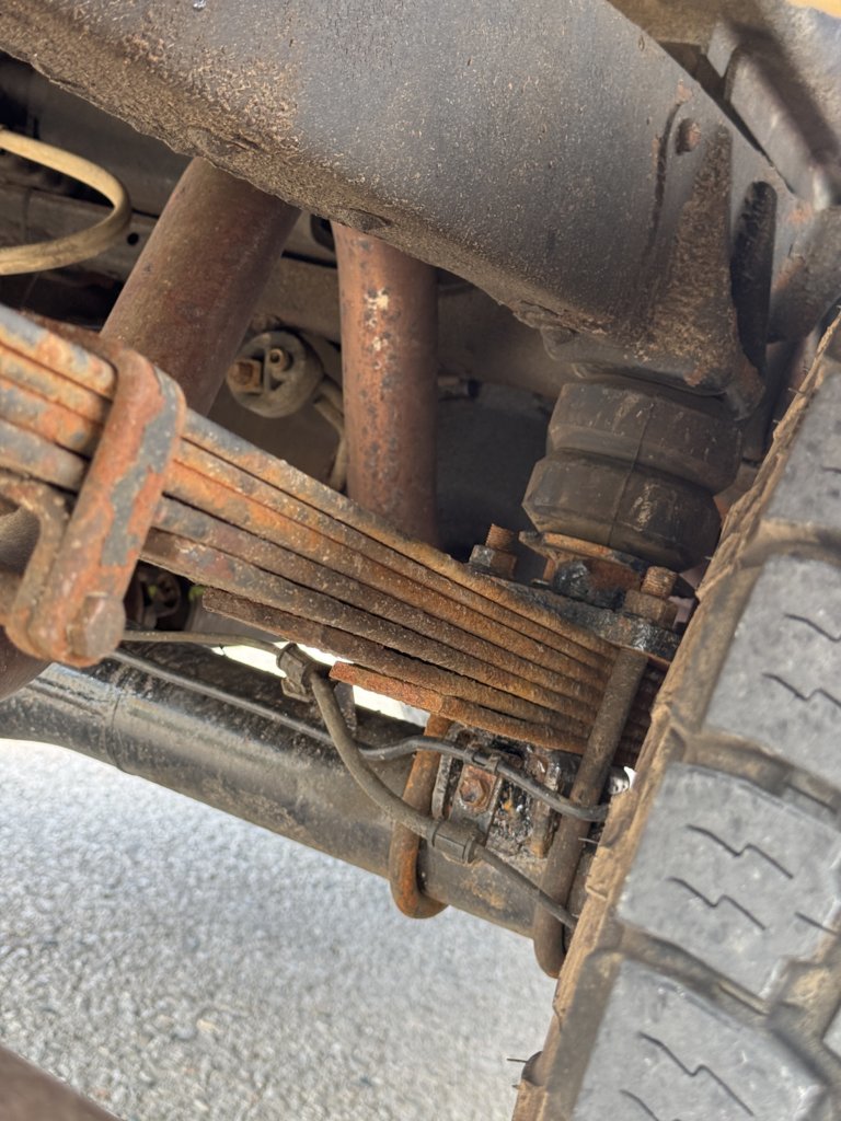

    Cottage gear is heavier then camping gear. resting on the bumps at ride height. I will add another leaf some day soon.

    I'd also make sure the condenser is free and clear of mud. That may effect something.

    it was leaking at the compressor line. I tightened it some and doesn't seem to be leaking anymore.
    Recharged, seems to be working while driving but doesn't work at idle.
    it looked like a heavy oily metalic residue inside the lines. Probably from a previous compressor failure.

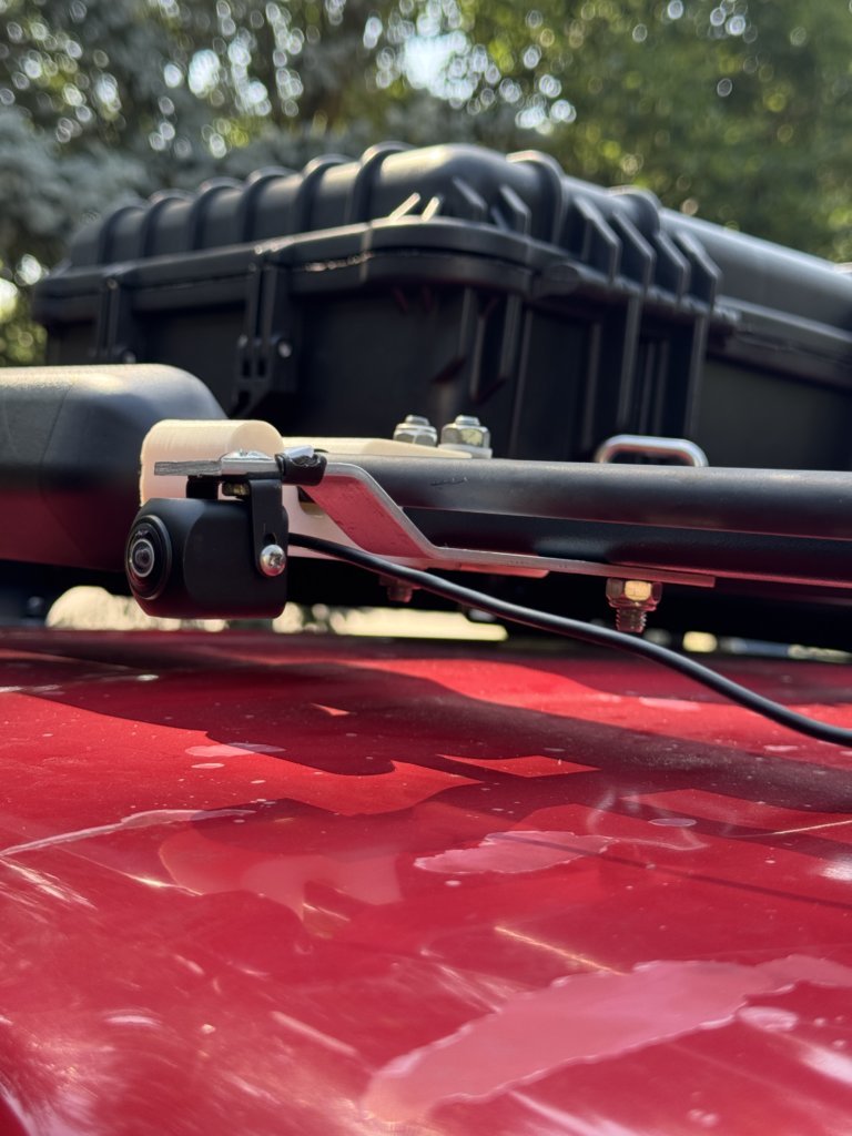

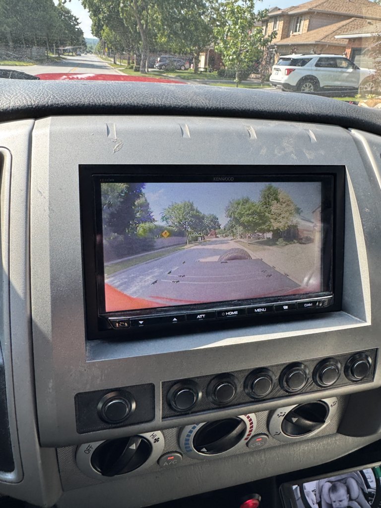

    Decided to install a backup camera on the roof rack, for simplicity of install, and I thought it might be helpful to see alittle more about whats going on behind the truck.
    Random scrap aluminum that already had holes drilled into it. Score.
    For future reference. I might want to cut orange wire if my headunit supports AHD.
    Not supported. good thing i didnt cut the wire.

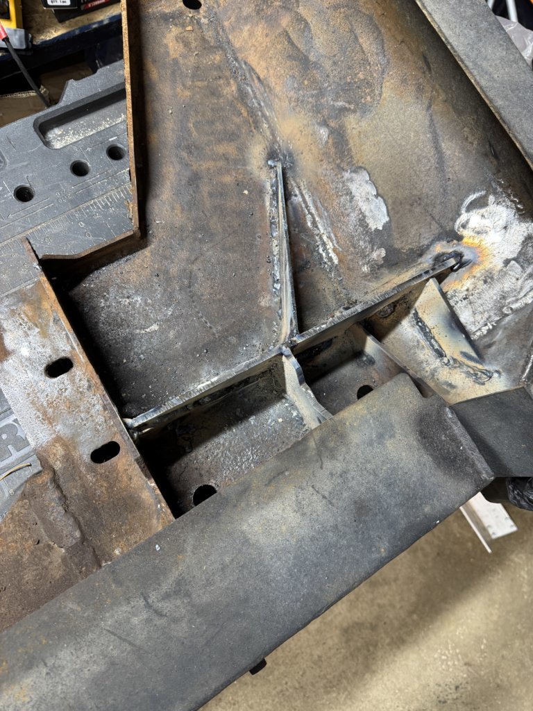

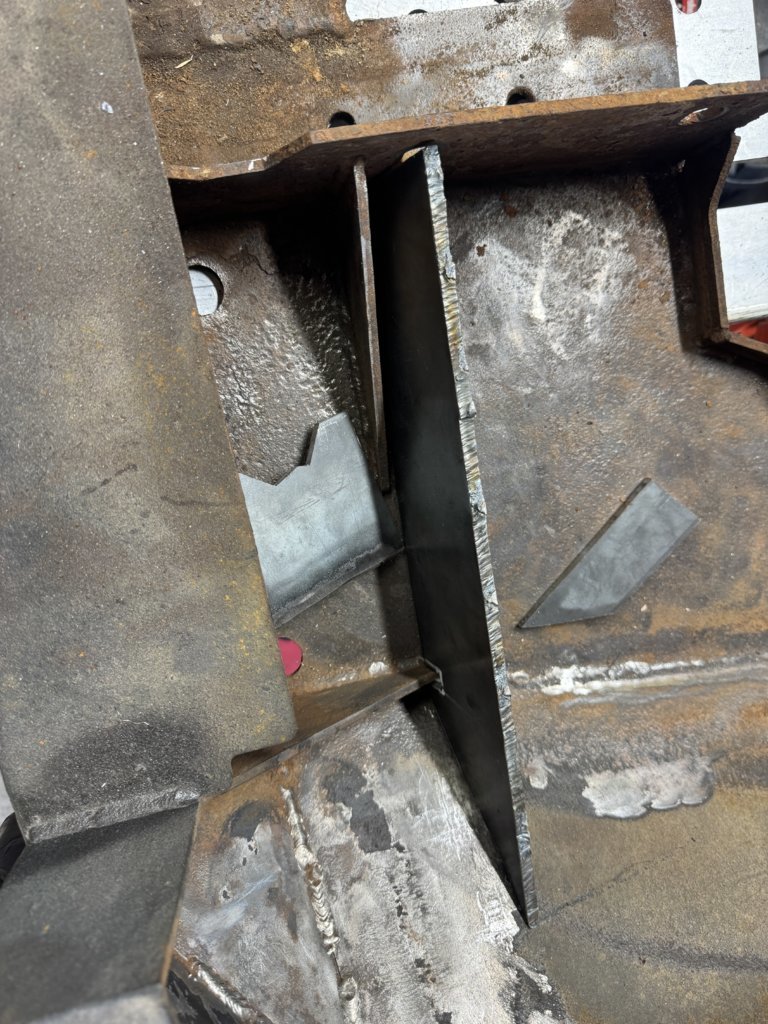

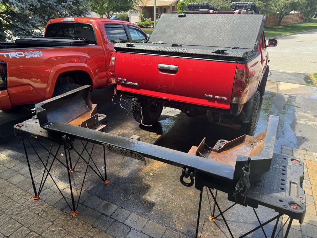

    Pulled the rear bumper off.
    Need to reinforce it a little, cut some 1/4 plate, not sure exactly if its going to be enough, but should be better then it was.
    Going to cut some bigger drain holes so mud and ardbeg can easily be washed out.
    Need to replace one of the bolts head was pretty stripped.
    The entire outside of the bumper will need a repaint.

  16. Jul 13, 2025 at 7:27 PM
    #136
    Windigo
    Windigo Well-Known Member
    Dec 21, 2019
    #313884
    4,232
    Farook
    Toronto Ontario Canada
    '14 Acess Cab
    I feel for you man. I know what its like working outside in this weather. yea that should stop some of the flex.
    jordi992[OP] likes this.

    Slow progress but burned in some supports. No doubt this is stronger.
    Thinking the frame might be the weak spot now.
