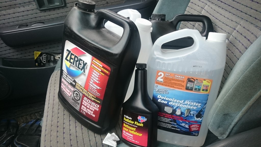

    What i used.

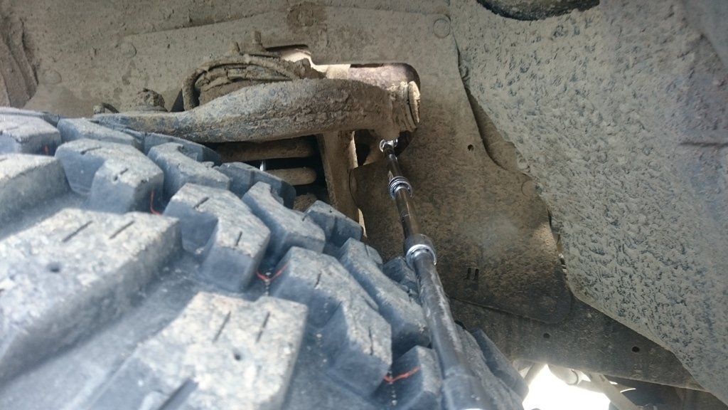

    How to get at the block drain.

    Did the flush/change yesterday. Ended up going with Toyota red and Distilled water. Everything went smooth. Glad I made this post though cause my book didn't have any info for the v6 engine block drain.
