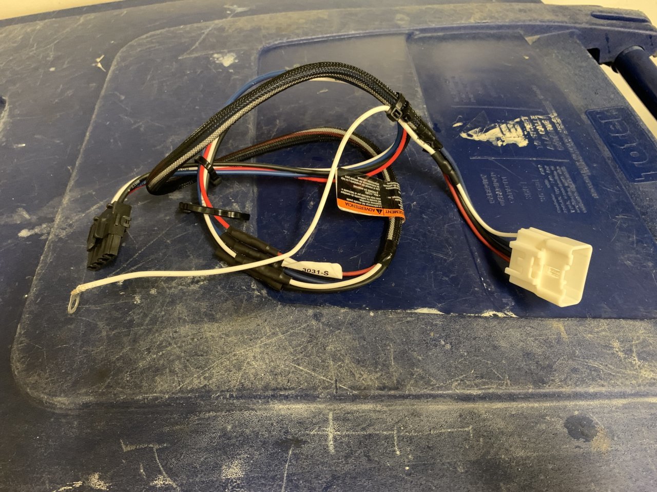

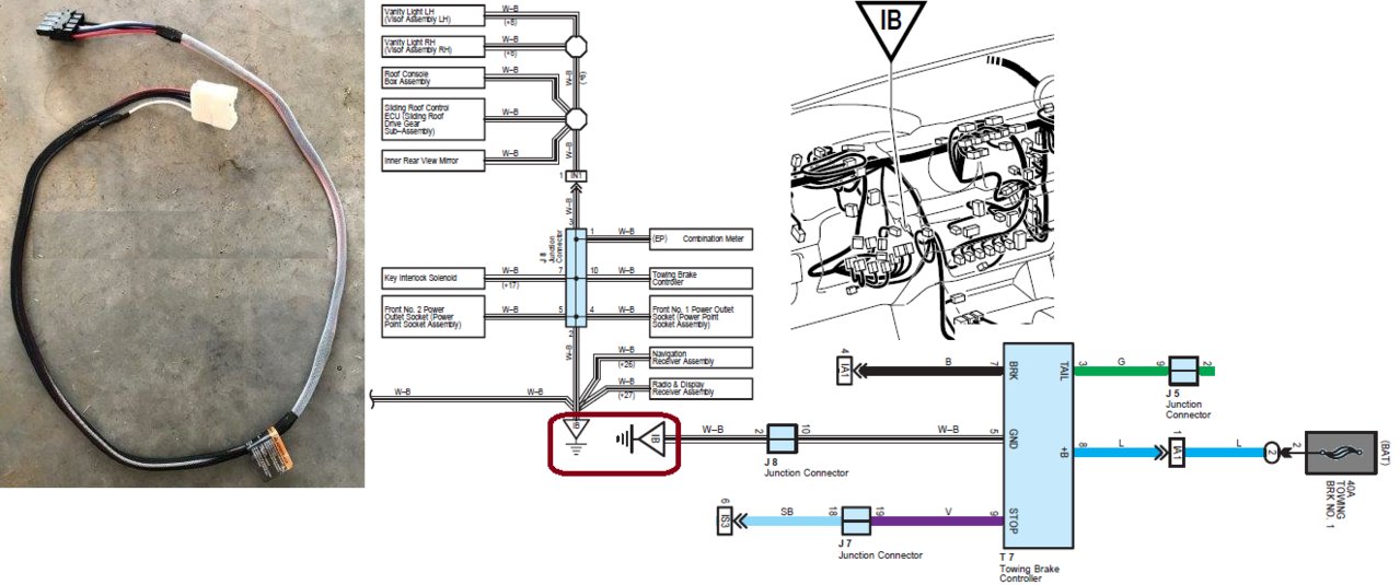

    I wouldn’t do that. The early versions of the plug in harness did not have that ground ring, and some of them had problems with melted wires and such, so they discontinued that version and switched to the newer one with the grounding ring. I was able to find plenty of other grounds under my dahs that went right to the body, so I put it under one of those bolts.

    So you're saying the vehicle has a faulty ground or the aftermarket pigtail?

    Maybe because it calls for a 25~30A and the vehicle has a 40A. If you notice the ground on the controller is for itself (control board).

    That’s fine, I’d rather take an extra 30 seconds and hookup that ground, better safe than sorry. You do as you wish.

    o_O...The post was to prevent scuffing a new vehicle, you used a bolt without scuffing:thumbsup: and the meltdown was a different brake controller.:burp: and the vehicle has a 40 amp fuse, no mention of anyone lowering it to the controller used requirements...:anonymous:

    Dual grounds don't hurt. Find the bolt @jwilson2899 used. :rofl:...ask him for a pic to enlighten all who read. And get a 30 amp cartridge fuse (pink)[Low Profile Jcase] to replace the vehicle 40 amp (green).

    I’m not following this later posting. The harness shown in the OP is I believe the latest version and comes with a ground wire. Why wouldn’t you ground it? Tie it into a bolt, scuff the sidewall behind the kick panel (as I did)... whatever. It’s an extra measure of safety and it works.
