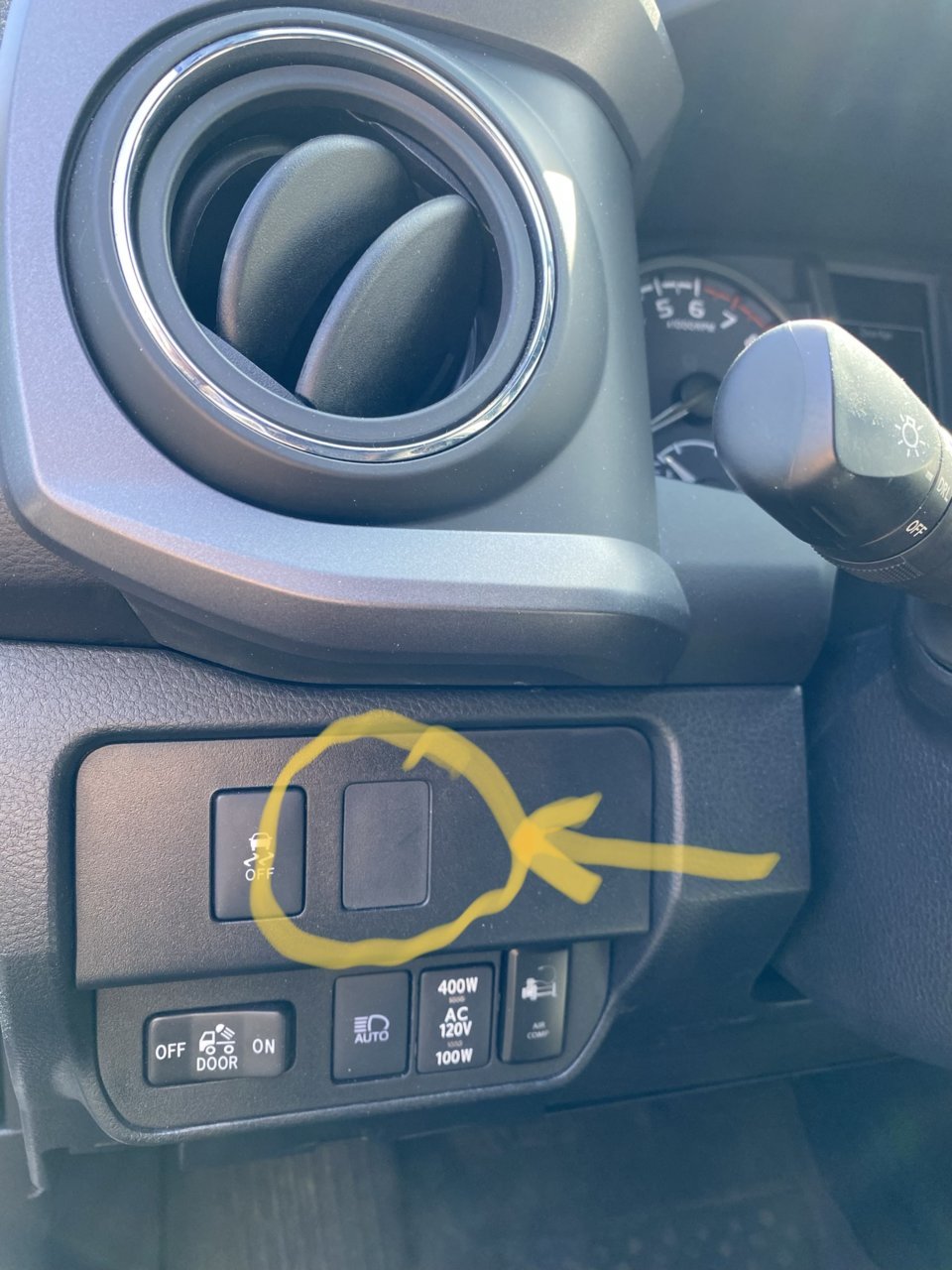

    I need to get a brake controller installed in my 2020 TRD OR and have a couple of question around install details. I’m planning to get a REDARC Tow-Pro Elite as it seem to be a good product and the cleanest install I’ve seen.
    Two questions:
    What wiring harness is required to interface with the tow-ready a 2020 TRD OR (I cannot find further info)?
    Is the TPSI-001 switch insert the one that fits in the below hole?

    I don't know about the wire harness, but fitting the switch should be easy. If the switch is too big, grab your deemed or even just sandpaper and carefully make the hole bigger.
    One of the switch’s Amazon reviews says that there is a YouTube tutorial as well.

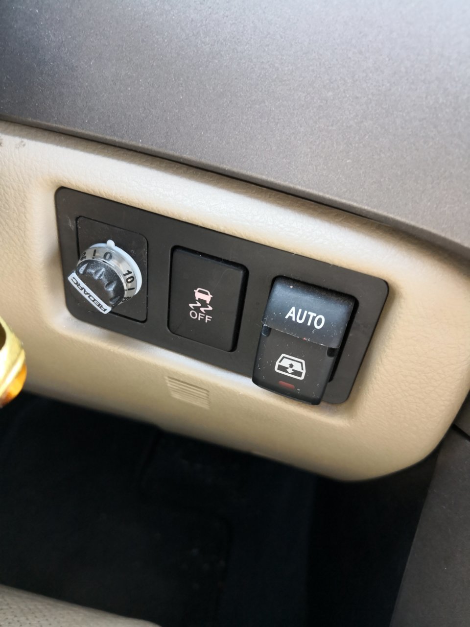

    Here's what i did in my sequoia. Easy and straightforward. As mentioned above there's not direct wire harness for redarc. You will have to create one.

    Love it. Did you use one of their inserts or did you just drill the blank?

    I drilled blank

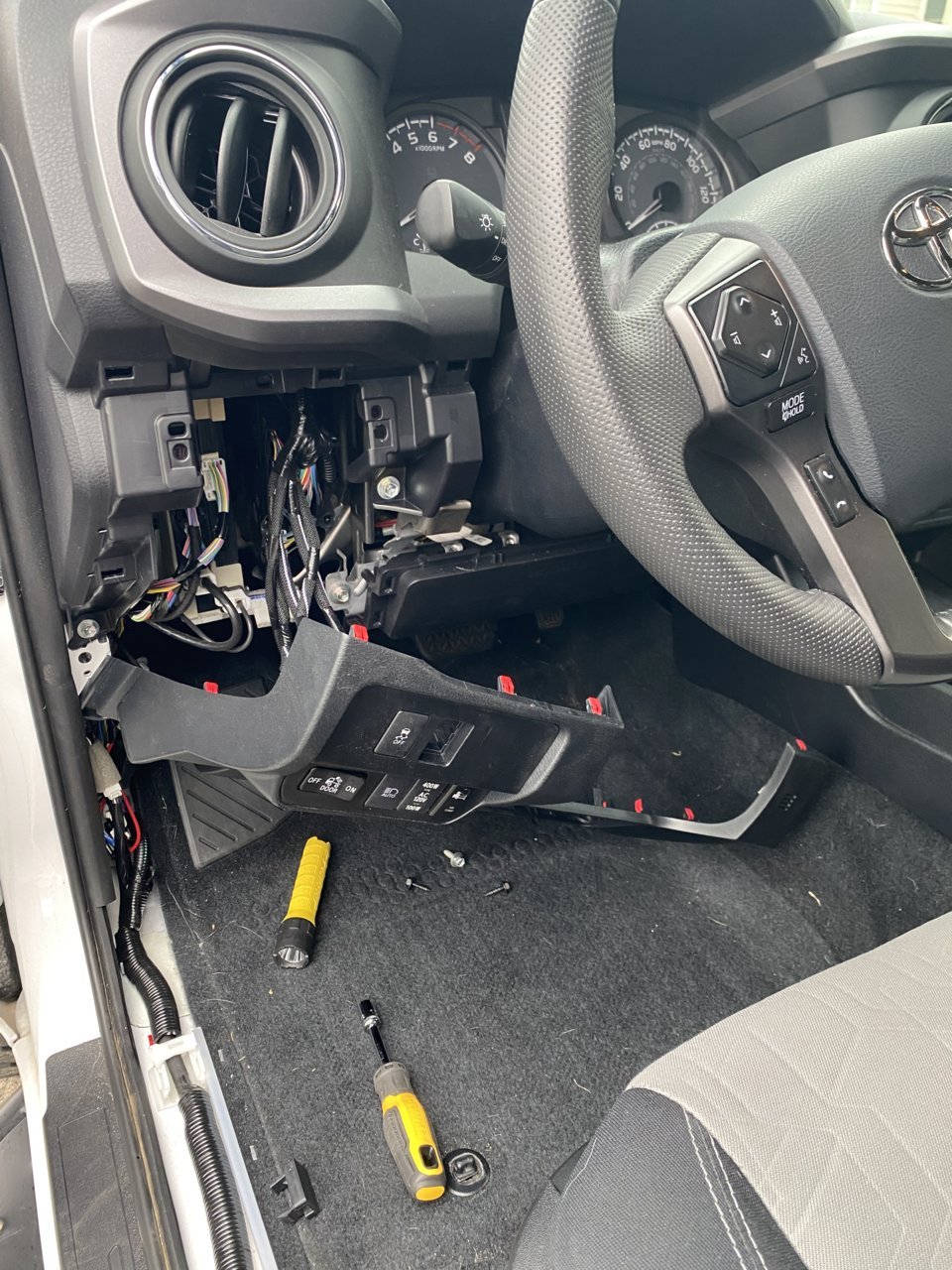

  11. May 11, 2020 at 8:20 PM
    HiterSixOne
    HiterSixOne Active Member
    May 5, 2020
    #326883
    39
    2020 Sport
    I just installed the Redarc today. Very nice install. I did notice however in my 2020 Sport that the factory brake control harness has the BLACK and BLUE wire swapped from the Tekonsha harness. Testing confirmed however that the factory BLUE is 12 volt positive and the BLACK is apparently the lead for the trailer brakes. Anyone else see this or can take a pic of their connection?

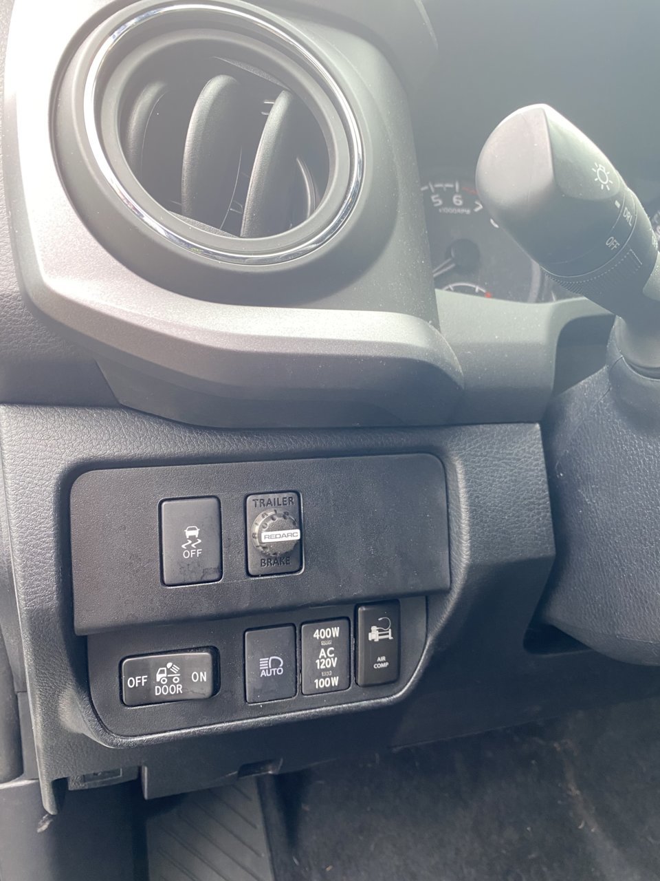

  17. May 21, 2020 at 4:19 PM
    #17
    EchoDeltaSierra
    EchoDeltaSierra [OP] Well-Known Member
    Apr 13, 2015
    #153078
    415
    Georgetown, TX
    2020 TRD Off-Road
    Nitro 4.88 gears OME suspension ST/Maxx 255/85R16s
    That was easy. What a clean install. Everything mounted and tucked in so nicely in the 2020.

    Is that the same size button adapter that would be needed for the size like the wireless charger?
