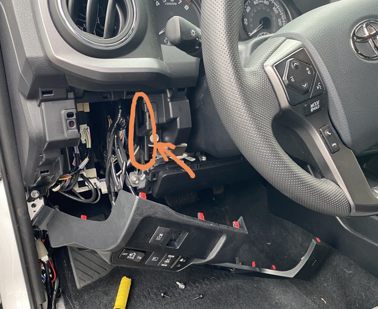

    I tucked mine up under the dash with some stickum tape and zip ties.
    Well, above the kick panel and behind the dash.

    There was a vertical piece on a metal bracket near the steering column. Pointed the controller port forward, the harness port reward and double sided taped the box there. Everything tucked up under the plastic wonderfully.
