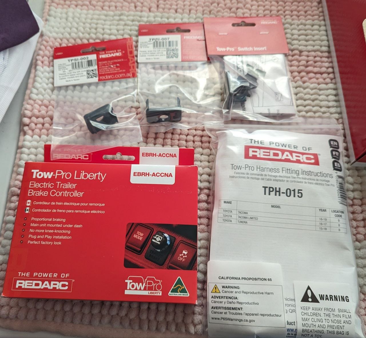

    I got the redarc liberty but have not installed it yet
    Also purchased the bracket made by a user here on tacomaworld.
    I read some old threads and they reference removing the airbag to install it. This makes me nervous. Is it necessary to remove the airbag to use this bracket? Is the brake controller mounted to the airbag? Is that safe if the airbag goes off?
    I am sure I am misunderstanding some stuff so thanks for any clarification
