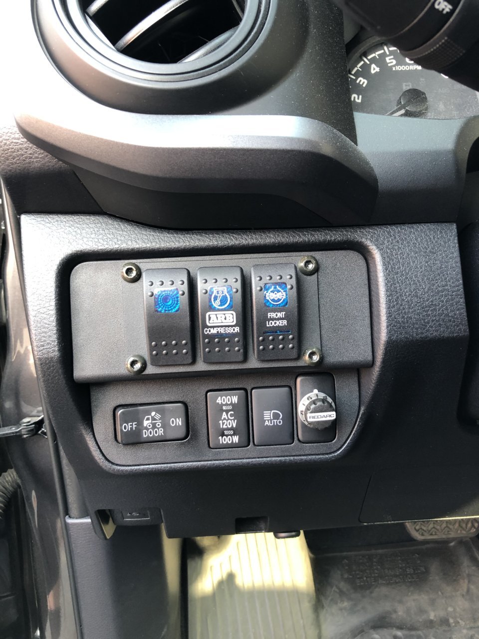

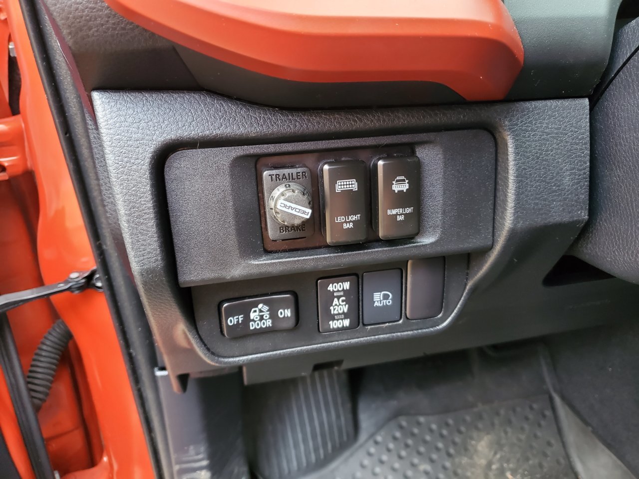

    Redarc brake controller in Caliraised panel with 2 extra switches, Accessorides remote start. Leer Topper w/ Rhino Rack
    Here is my install. I used a plate from Caliraised to mount it. Took a little trimmimg of the plate to mount the controller. Everything fit fine below the steering column. Works great!

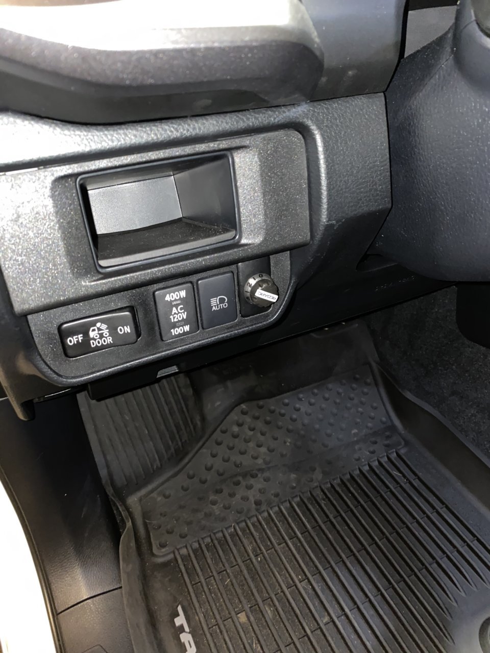

    I drilled a hole in the factory blank cover and slightly modified it to fit perfectly.

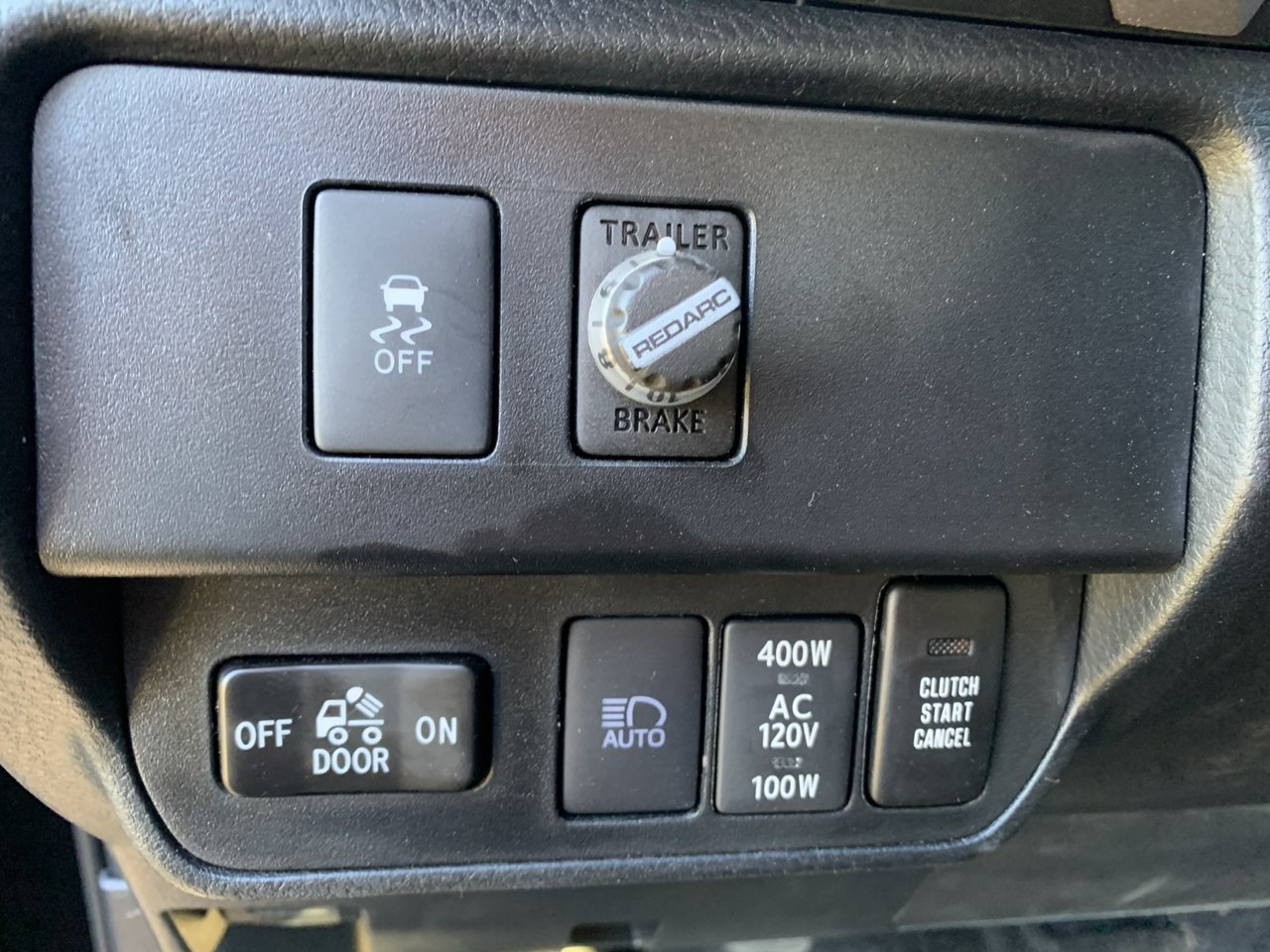

    Redarc sells a switch plate that looks like the oem with the holes already cut perfectly.

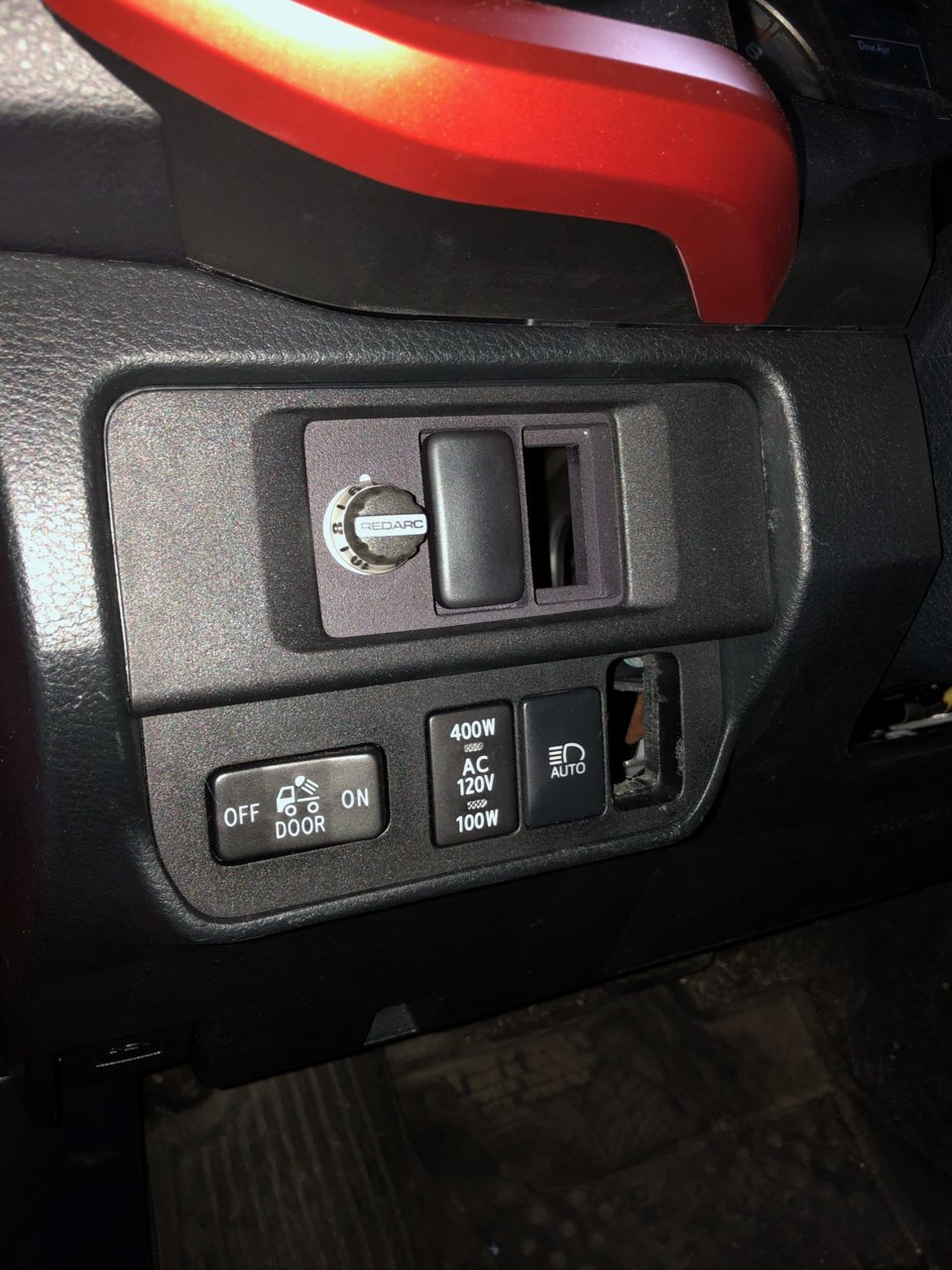

    There’s also this backing plate with a hole for the dial. Ignore my empty slots.... getting ready for additional lighting. I really like this brake controller.

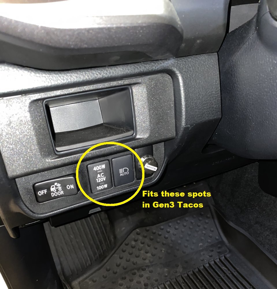

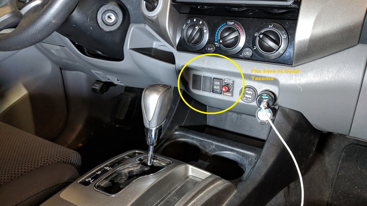

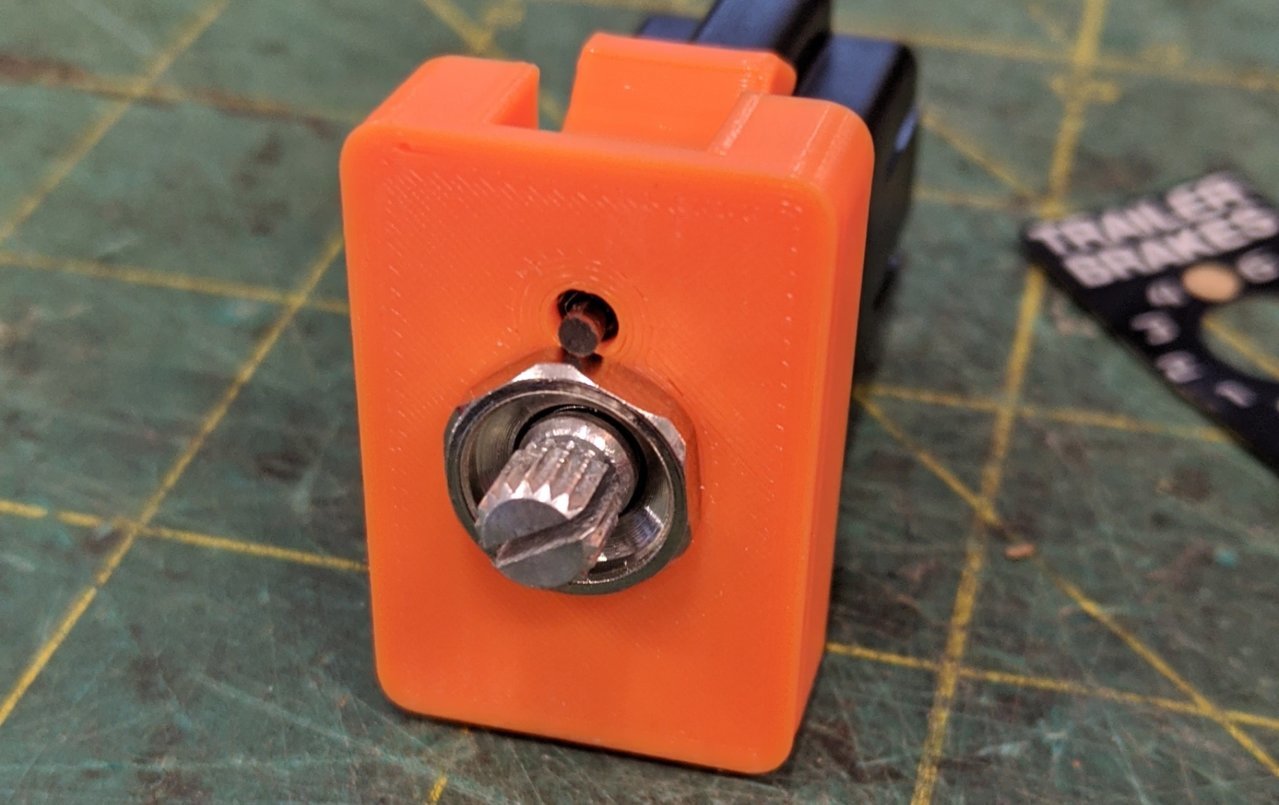

    When I installed my RedArc in my Gen2 I just cut up the back of one of the blank plates in the center console, under the HVAC stuff. I recently got a 3D printer and when my brother-in-law got a Gen3 and got a RedArc controller I designed and printed him a plate to fit the controller head better.
    I loaded it onto Thingiverse so if anyone else wants it then here it is https://www.thingiverse.com/thing:4202925
    In the Gen3 I know it fits here
    Here are pics of the v2 I designed, when fit checking it I realized the tabs out the back aren't needed.
