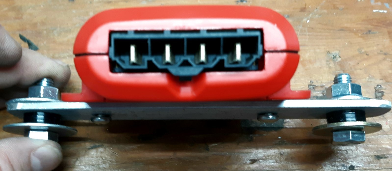

    I ordered one of Pgfitzgerald’s mount plates. It’s a very clean piece and includes all hardware needed to install

    The bracket is awesome, I'm sad that I couldn't use it because the glass breakage module wants to live in the same place if you install it the way Toyota wants you to. I might move the GBS module...

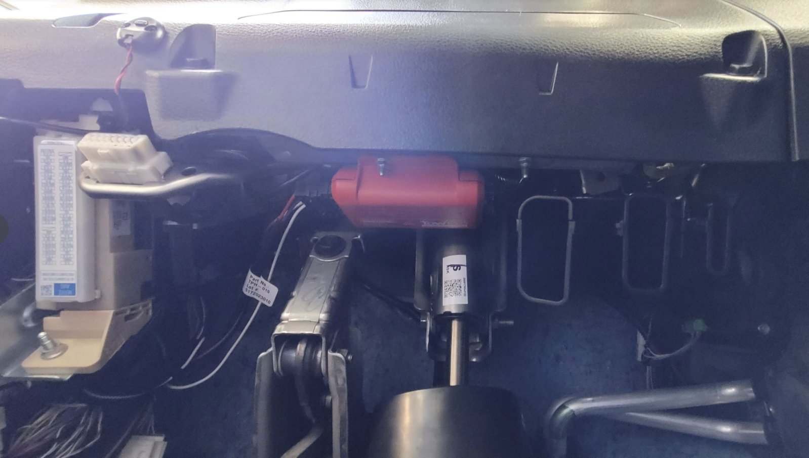

    I was in a bind. Had found new camper that ticked off all of wife's 'must-have' boxes. Arranged to go get it (600+mi 10.5hr drive, each way), etc., etc. Realized upon checking further that weight was 2800lbs, over a 1000 more than our old one, and being over 2500lbs, it had brakes(!). Wow, what're those?! So... had to do a shit ton of research and YouTube schooling over a weekend AND find a good, reliable, simple controller AND have it installed & ready for trip in 3 days(!). Settled on Redarc Liberty. Pretty much idiot-proof. No time for special order adapters, so fabbed my own mount out of scrap piece of 1x8 aluminum, cut down to 6.5" and rounded all corners & edges to eliminate risk of slicing, cutting, scratching or tearing up anything (including me) during install. Used steering/airbag brace location and went to work.
    Used plastic washers to space the mount off the brace to give room for the Redarc mounting screw heads so as not to put any stress on the Redarc's plastic housing when I tightened everything down. Put a strip of 3M double-sided tape between the Redarc and the aluminum piece. Used a handful of leftover stainless steel nuts & bolts to secure everything and - Presto
    Out of the way, functional and fairly easy to install for a total newb and boob like me. LOL. Secure, rugged location; it's not going ANYWHERE. For a thrown together at the last minute affair, I must say it worked out great. I mounted the control knob into the blank switch to the left side of the console, below the cubby. Might move it someday, but since everything's working as it should (and I don't intend to monkey with the settings now that it's all dialed in), I might just leave it as-is.

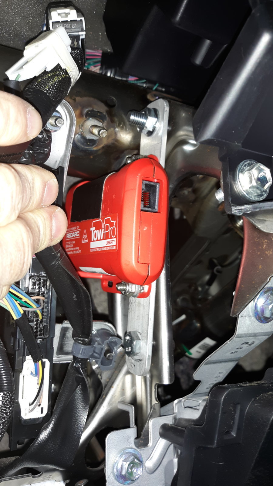

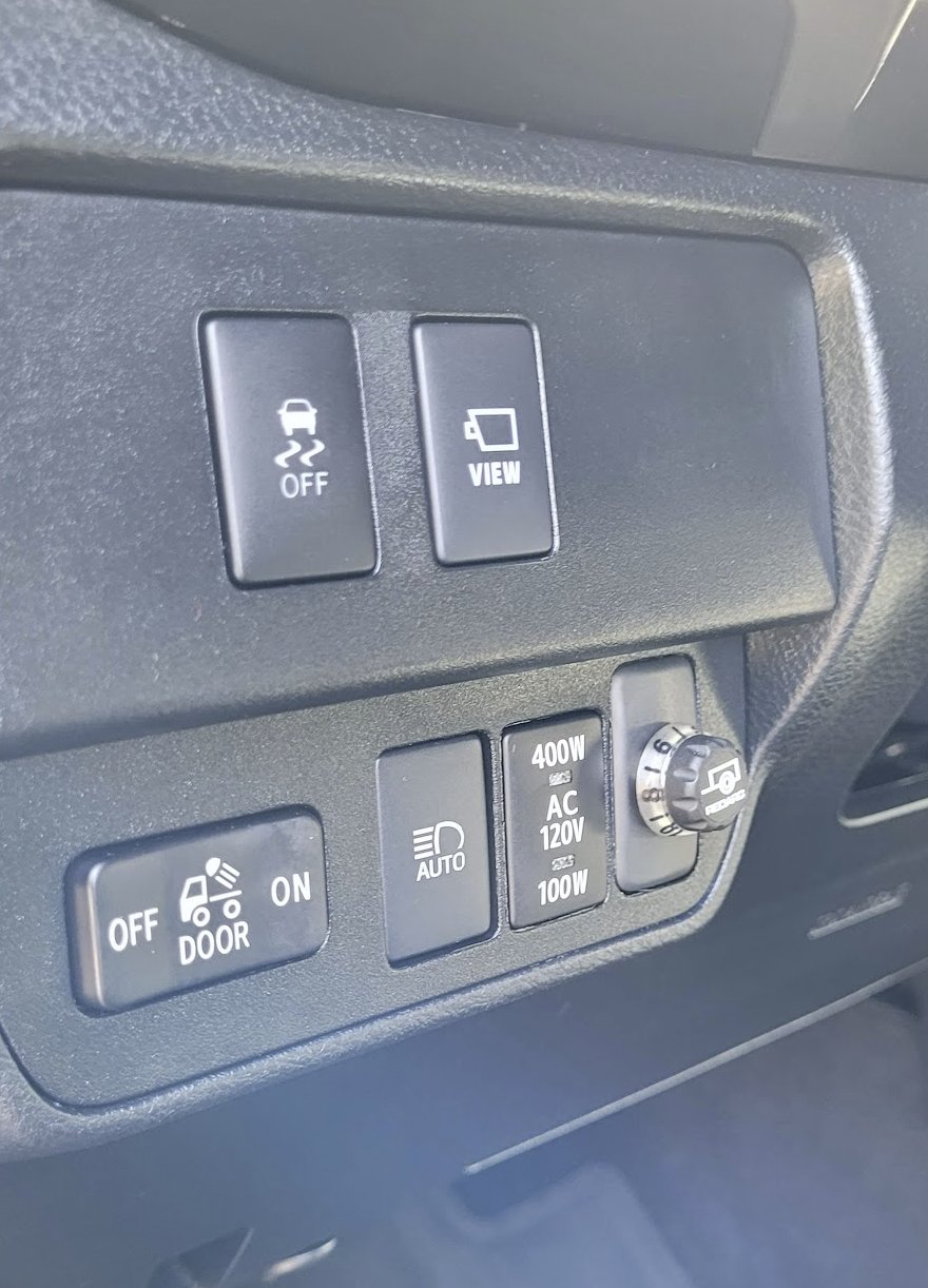

    I just installed a Redarc Liberty in my '20. Really like their brake controllers. I have one in my MDX too, which has worked flawlessly for 4 years towing an offroad-rigged pop-up trailer for lightweight offroading to get to the good campsites. I didn't purchase the Redarc dash switch cover for either one, partially because I'm cheap, and partially because I like to keep the look simple. I just basically removed most of the backing in the blank. Take slow and easy cuts with razor knife and needlenose to pull out chunks; make sure you only remove what you need to fit the switch and leave the parts on the end that clip it into the dash. (Make sure you drill two holes - the main knob and the tiny hole for the light to shine through on top.) You can see what the finished product looks like in the photos. It already has a picture of a trailer on the knob, so it doesn't really need to have "Trailer Brakes" stamped on the plastic insert, in my opinion.
    I also mounted it on a very secure stud with nut under the dash. I found this location via the web from someone else -- can't find or I'd give credit. I was going to use a bracket and span to the other stud nearby, but the thing is bolted in so tight I'm not going to even bother. It's just as secure as the install location and method on the Redarc site but is cleaner and less jammed in and doesn't require the $ mounting bracket that they sell.
    The mounting location is right in the middle above your knees, and is recessed under the dash lip by maybe 2 or 3 inches. Lay down and look up and you'll see the two studs, ready to use either for mounting.redarcswitch.png redarcswitchUnit.png
