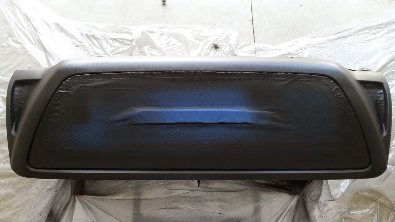

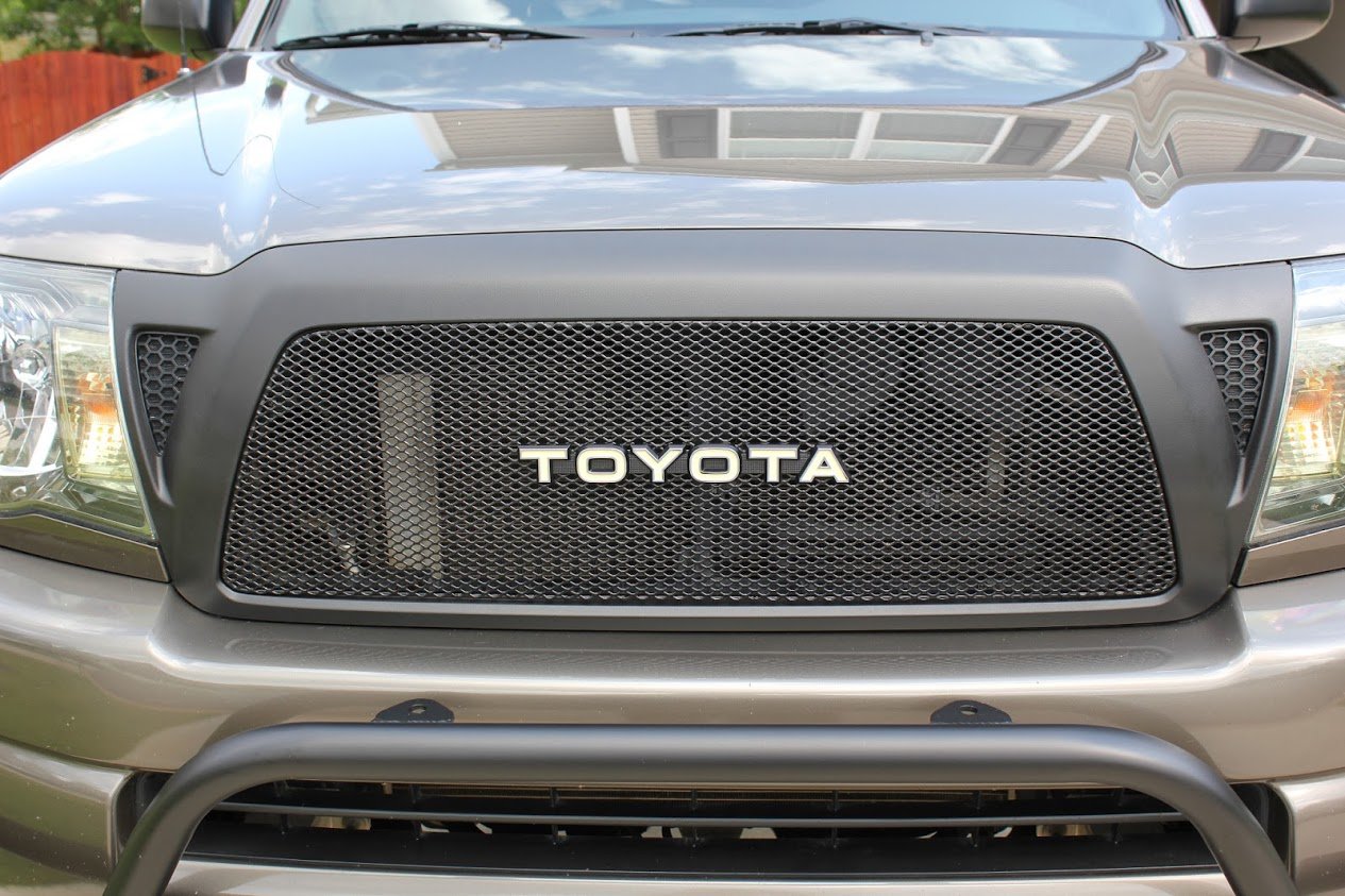

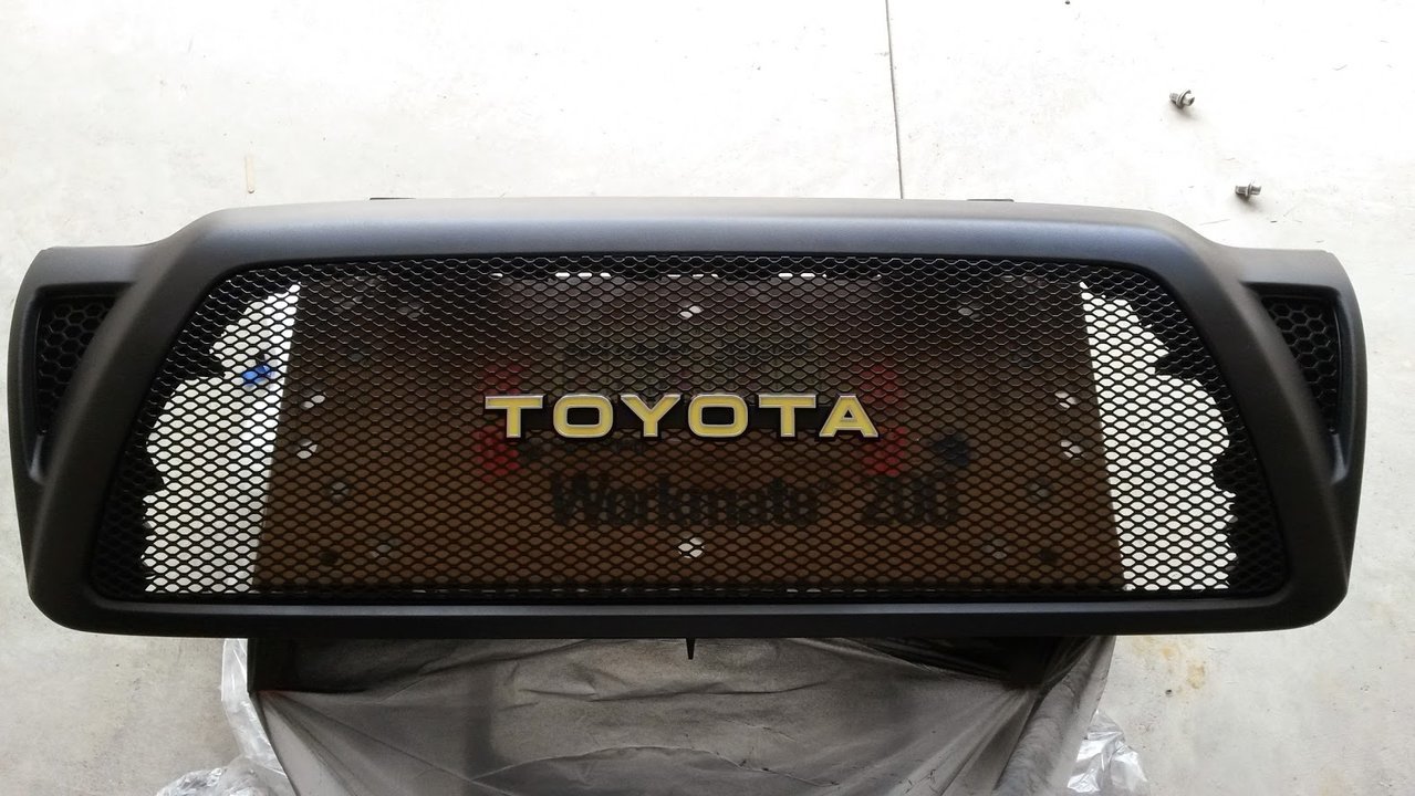

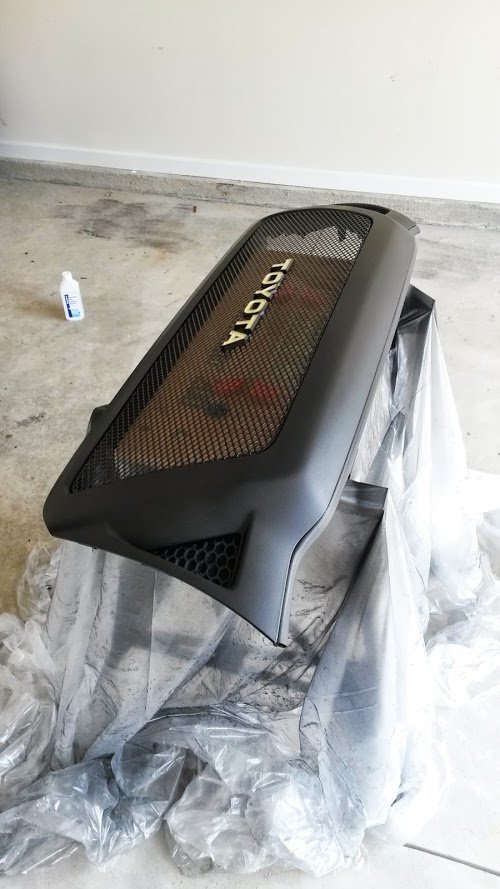

    Dipped the grill surround today. Happy with the dip but not sure how I feel about the color with the truck. Thoughts?

    Nice looking truck! The plasti dipped grill definitely looks better than the chrome, but I think color matching might look even better..

    looks good Bro!

    hell yeah that looks nice man
    the colors came together so good !!

    Thanks, and I'm torn on color-matching. I think I'm going to leave the black for a month and see how it grows on me.

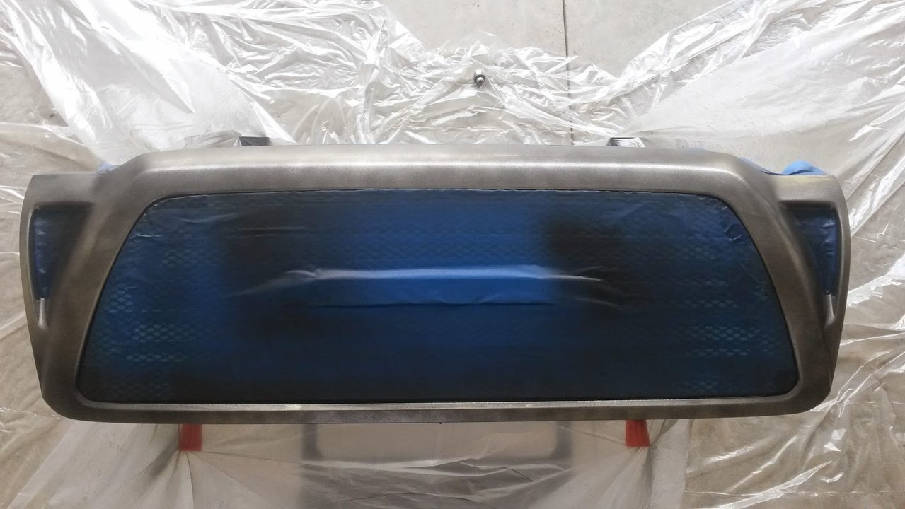

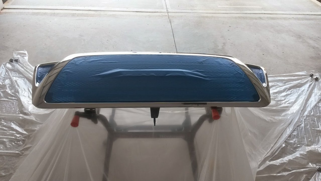

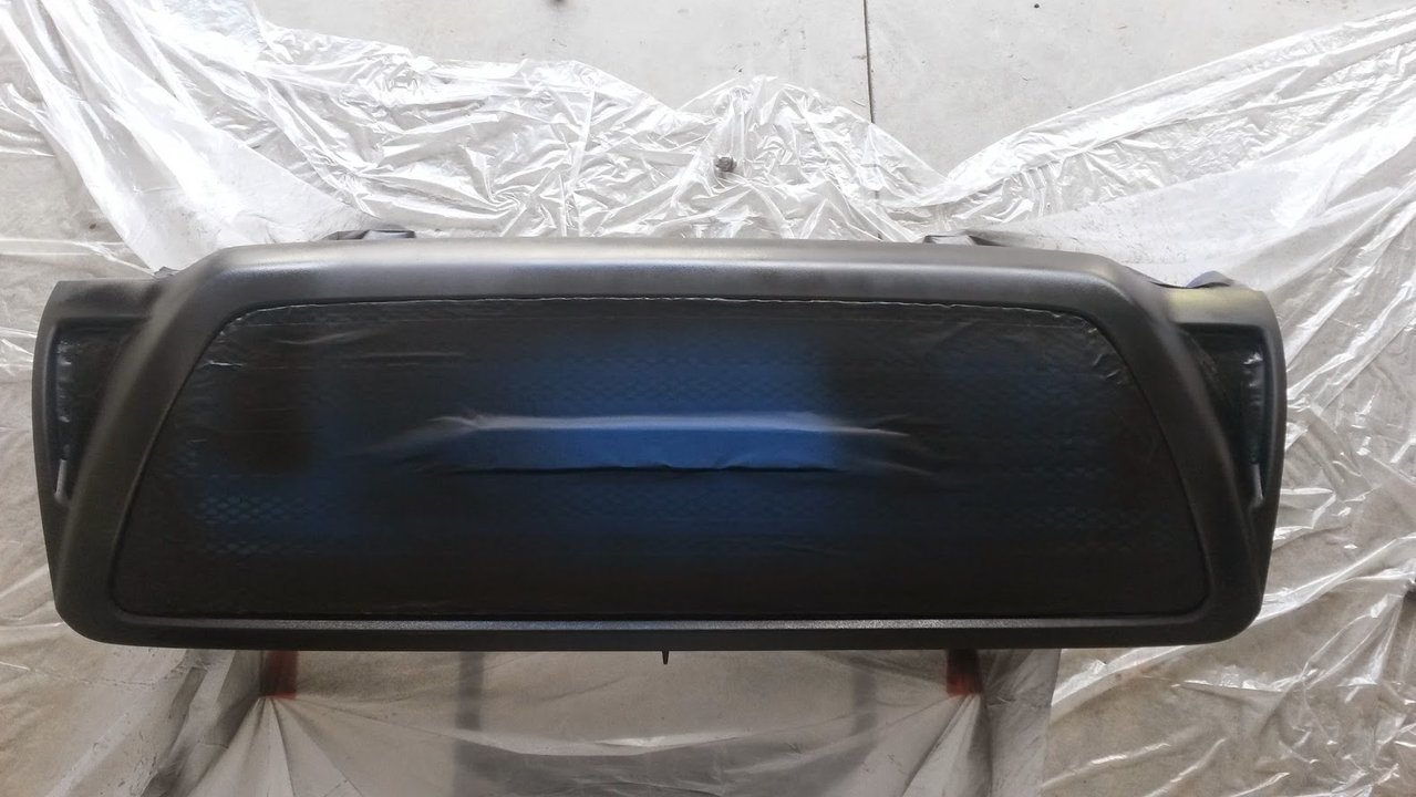

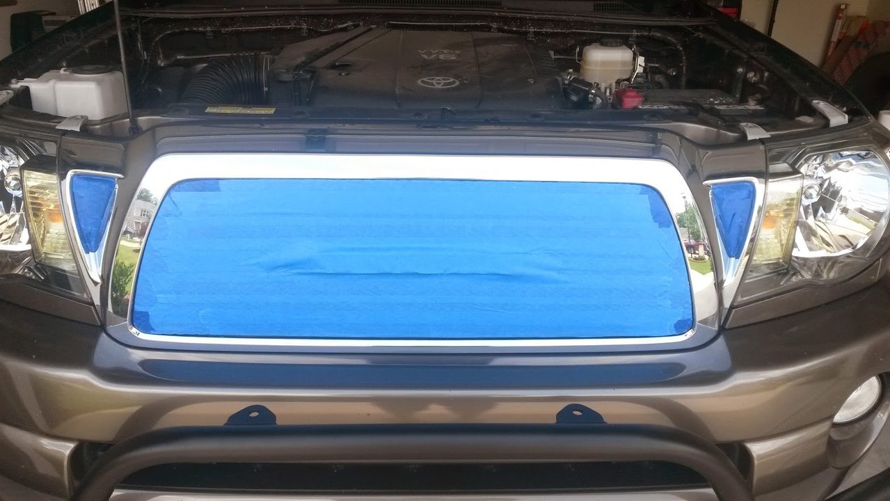

    How to plastidip your grille surround:
    Step 1: Tape off grille
    Step 2: Remove and clean grille (I used alcohol)
    Step 3: First coat, light dusting
    Step 4: Second thru fourth coats, progressively heavier, ensuring even coverage in nooks and crannies
    Step 5: Peel tape and enjoy

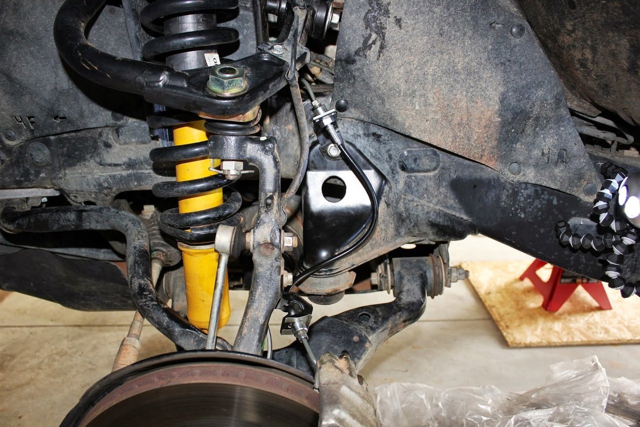

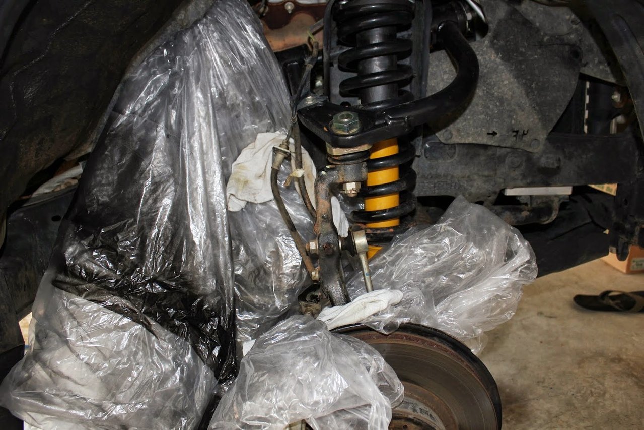

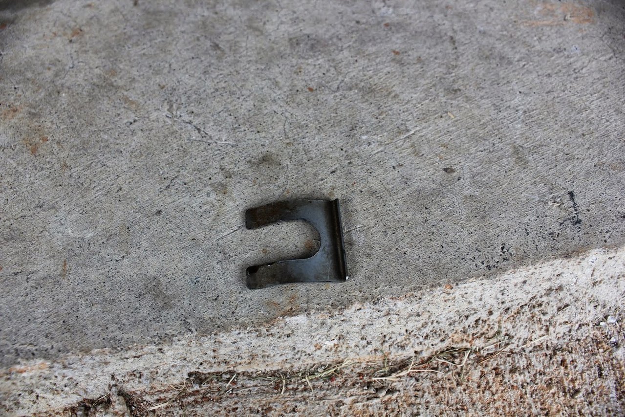

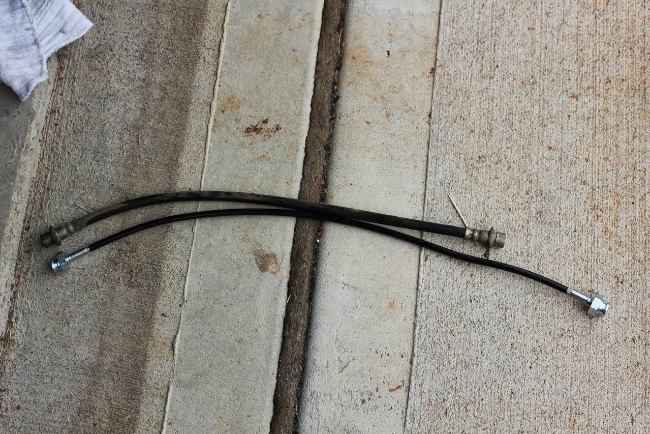

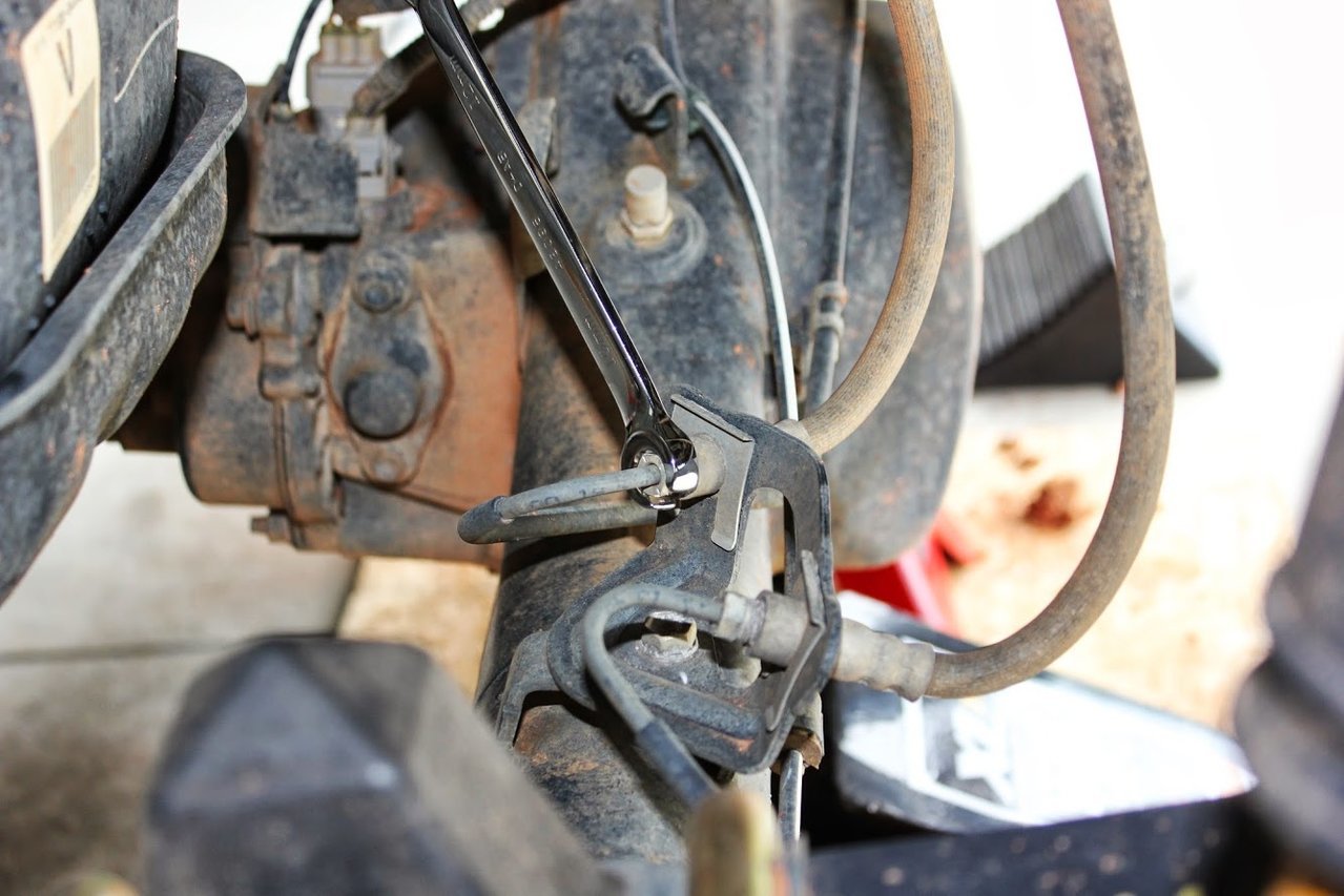

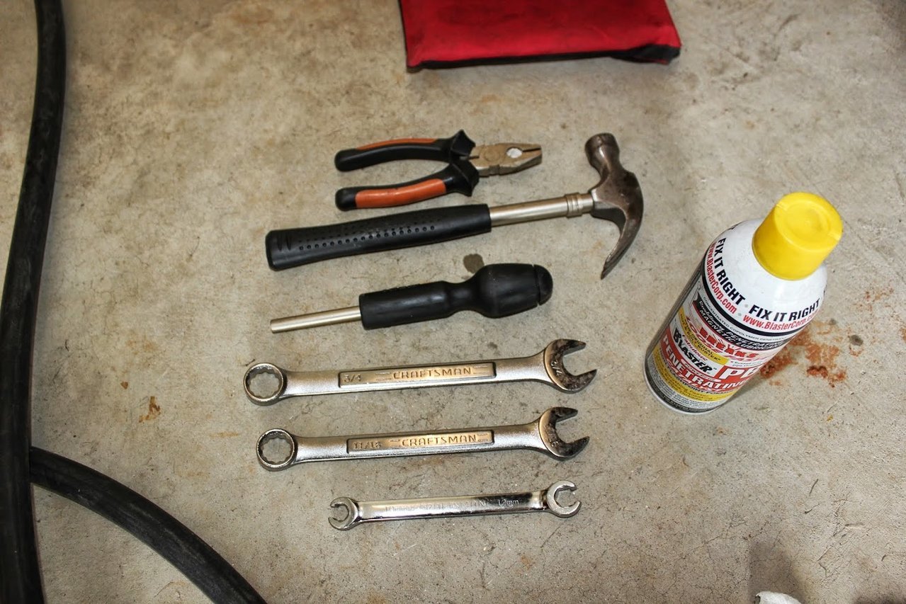

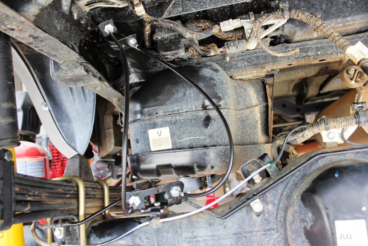

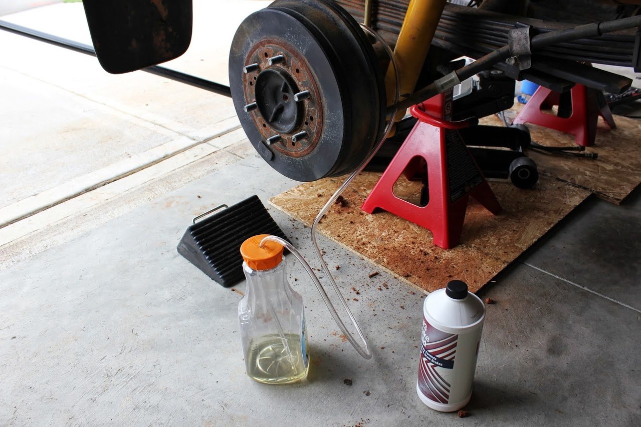

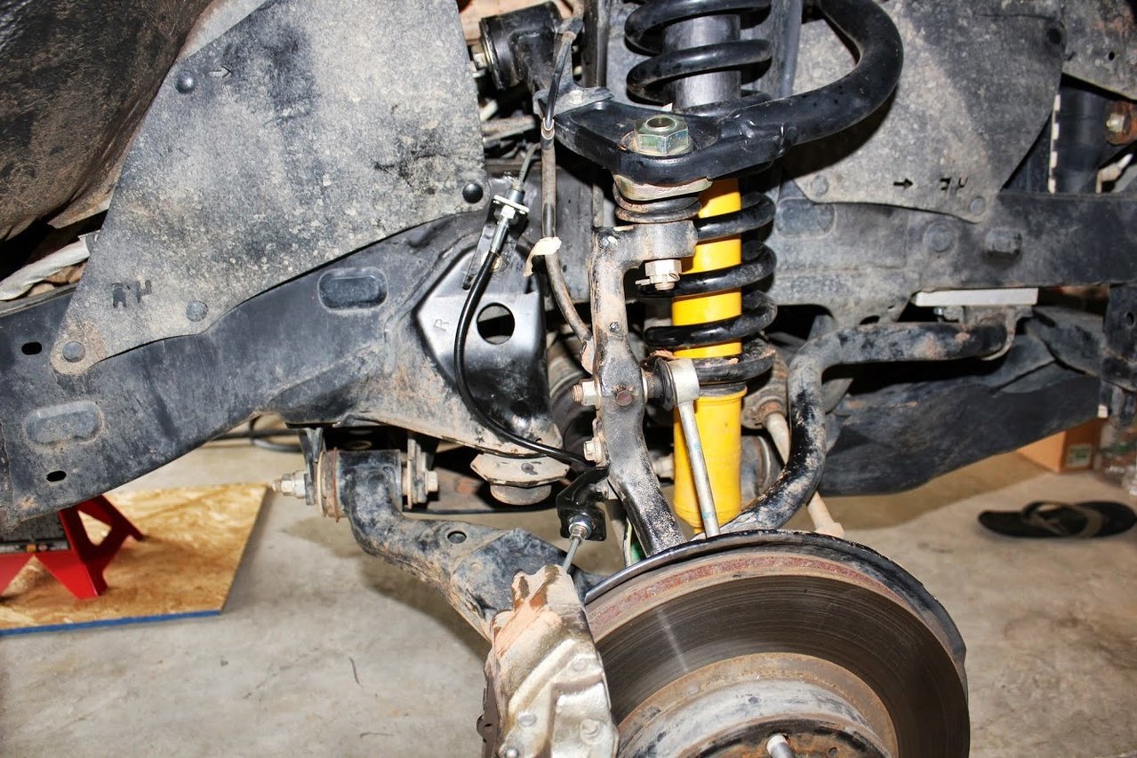

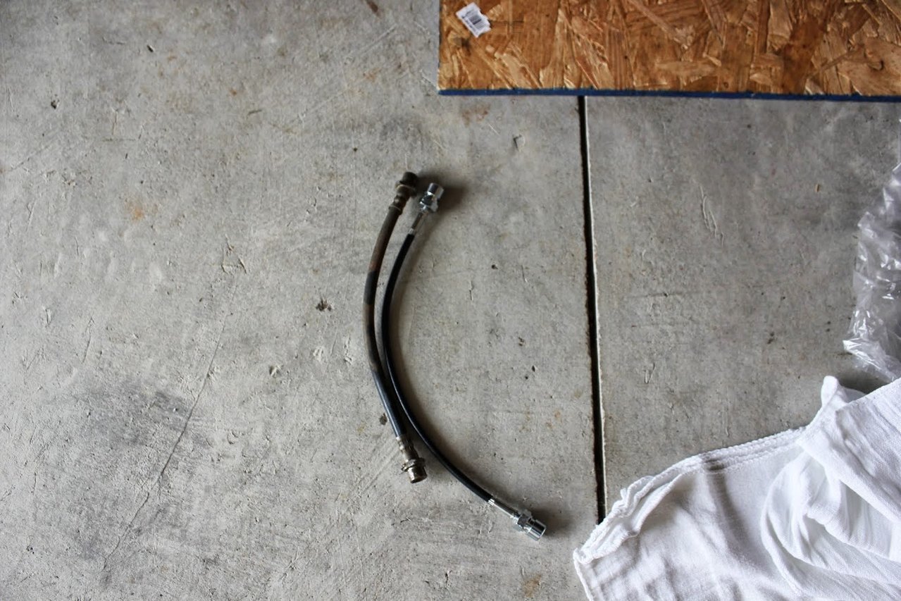

    Finally installed my extended brake lines from OCTaco. Pretty straight forward. Look and feel great.
    Truck ready to go:
    Tools I used:
    10mm Flare Wrench
    Make sure you take these suckers off before you undo the lines.
    Comparisons:
    Covering to prevent spillage on the other components:
    Finished product:
    Brake bleeding kit:

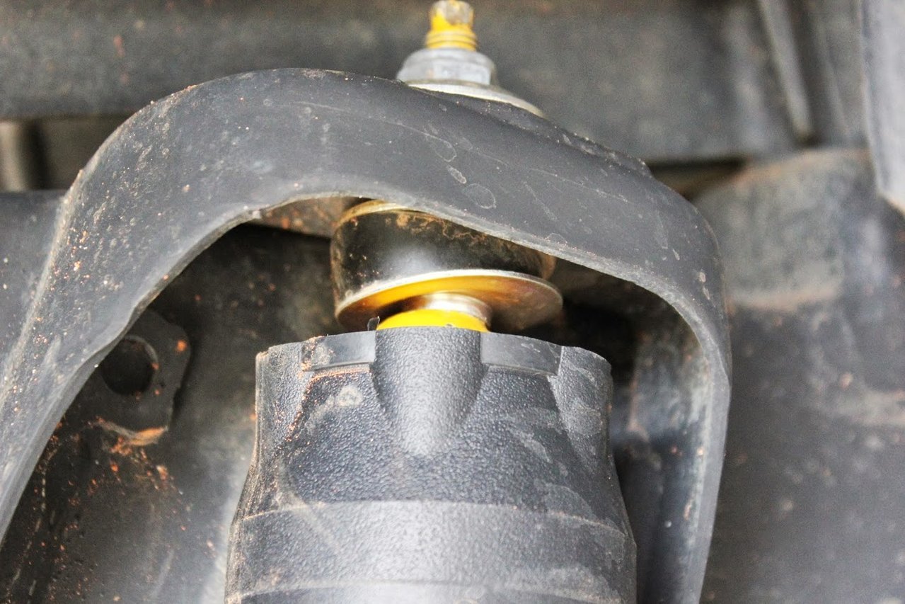

    Problem. Pretty annoyed. Anyone else encountered this?

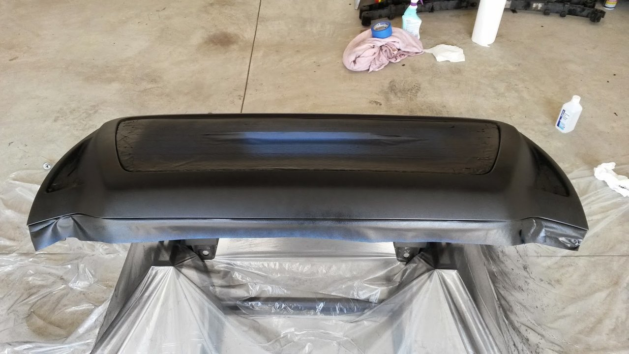

    Thanks. Yours looks good too. I like the color match. I'm dipping my rear bumper black probably this weekend or next. Too much rain this past one...
