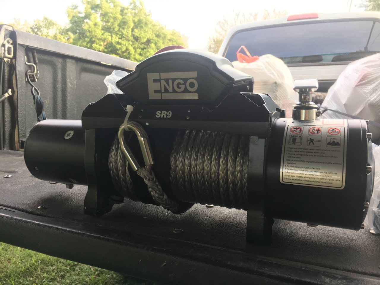

  6. Sep 13, 2018 at 4:31 PM

    I like this then unlinked it so I could like it twice...
    I like the new design as well

    I like it too! Haha.

    What does it do?

    Gets followers on insta, me thinks.

    Hopefully they waterproofed that control box. The old one takes on water like the titanic. I have so much corrosion and mud in mine I'm surprised it still works.

    Good to know. Maybe I should do a little preemptive silicon work.

    Carter, is the control box able to be re-positioned on the winch? Wondering how well it will fit inside the ebay bumper.

    I preemptively siliconed mine when I bought it.
    The old style ones you can for sure

    You mean removed and mounted in the engine bay or somewhere, or rotated on the winch itself?

    I know it can be moved somewhere else in the bay/bumper by extending the cables. I'm meaning moved over to the motor side of the winch housing. Like an offset.
    Worried it might end up too tall in it's current config.

    I’ll take a look
