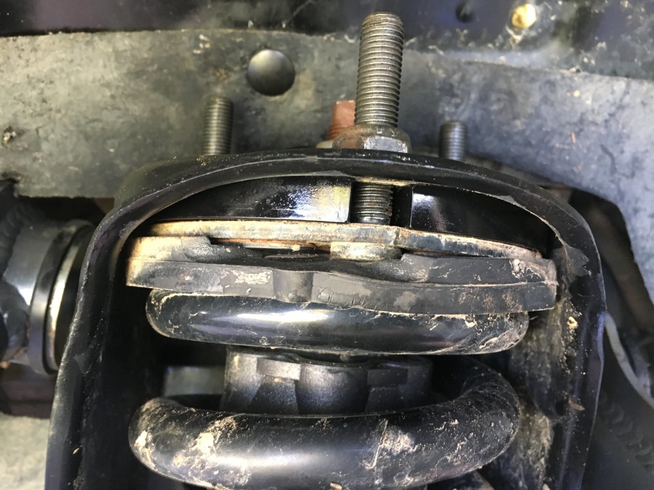

  8. Sep 19, 2018 at 8:45 PM
    #2168
    rngr
    rngr [OP] Aix sponsa
    Jan 13, 2015
    #146258
    9,244
    01 SR5 4x4 2.7L
    Remembered I bought and installed longer studs on my coilovers when they were new so that just in case one day, far far in the future, if my truck became a fatass, I could pick her back up a bit.
    Well, the future is here. Spent $25 on some 3/8” spacers to get a little lift back. Was going to swap coils, but meh...

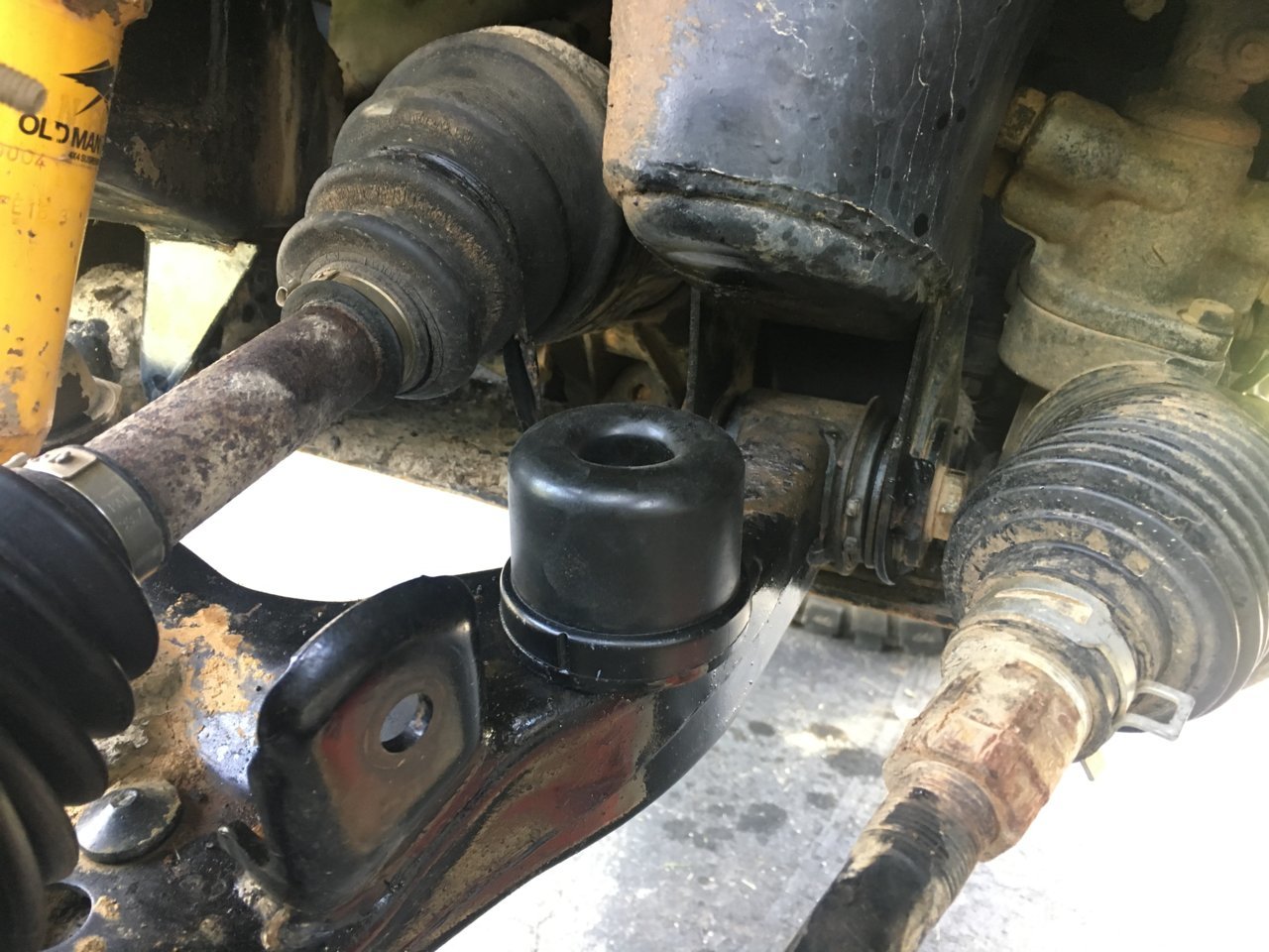

  10. Sep 29, 2018 at 4:06 PM
    #2170
    rngr
    Jan 13, 2015
    #146258
    9,244
    01 SR5 4x4 2.7L
    Put in the new bumps from @Plastics Guy. Really looking forward to not slamming the hard OEM ones anymore.
    Also threw in some 3/8” spacers to get some lift back.
    Just right.
