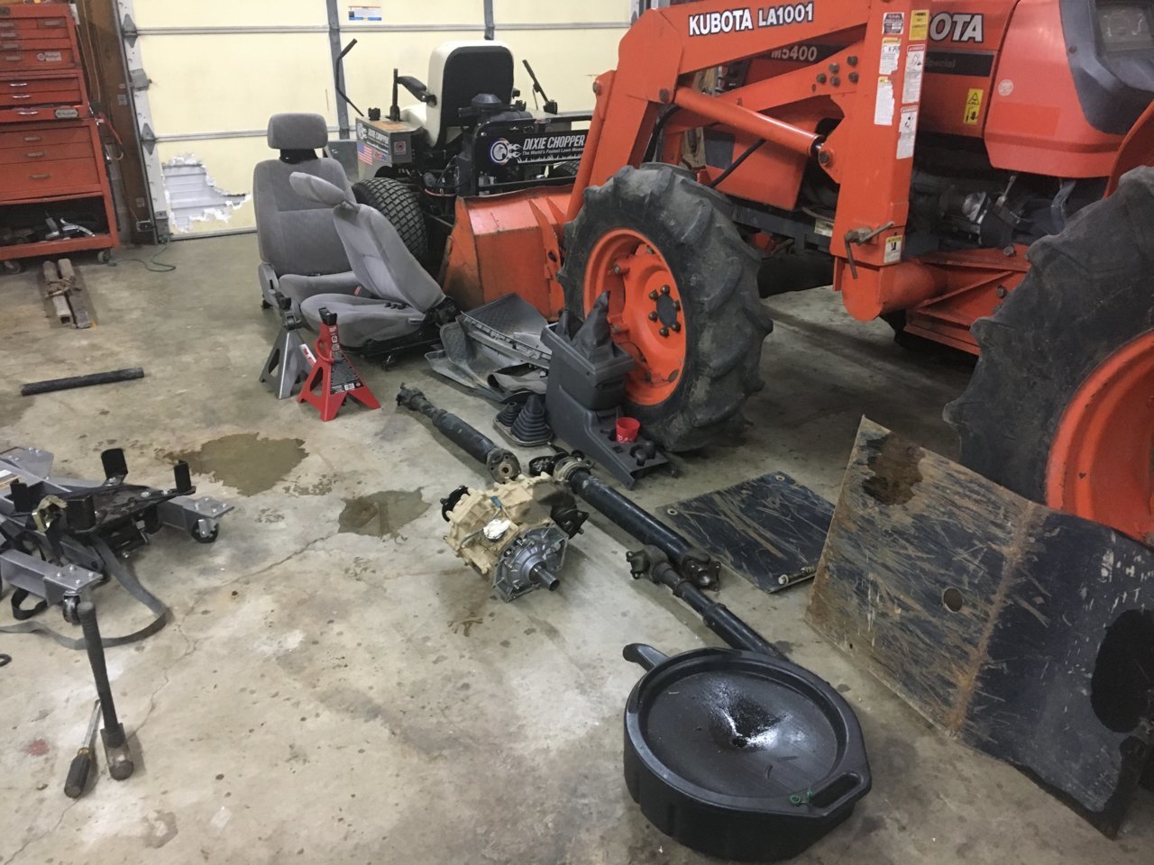

    Got quite a bit of demolition done today before I ran out of time. Pulling the interior, driveshafts, skids, and transfer case takes longer than you’d think. Hopefully I’ll have time to dig into the triple sticks tomorrow evening.

    The amount of suck pulling the interior and shifters is second only to dropping both driveshafts. The inability to impact or ratchet wrench them off is super annoying

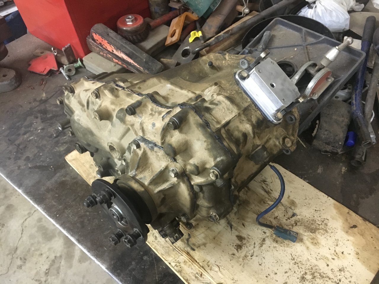

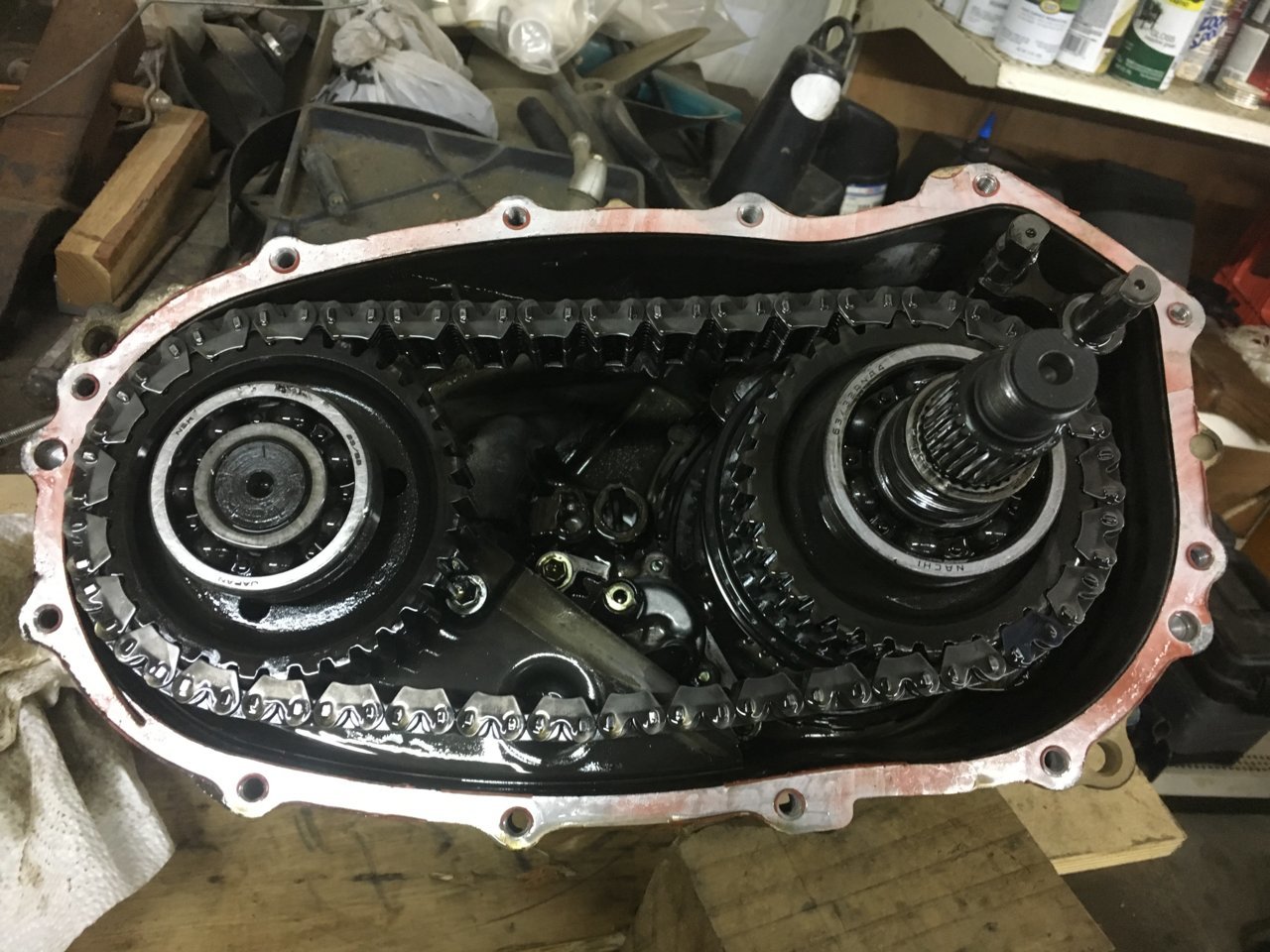

    A little progress today. Took the case apart to remove the interlock pin and grind the little tit off the driver side shift rail to allow them to move independently.
    All sealed up with the new shifter plate.
    Leave it to TG to come in clutch when I need them by sending me some broken shit. Haha. Will call them up tomorrow.
    Big thanks to my crawler A-team up in Illinois for answering all my questions.
    Getting there!

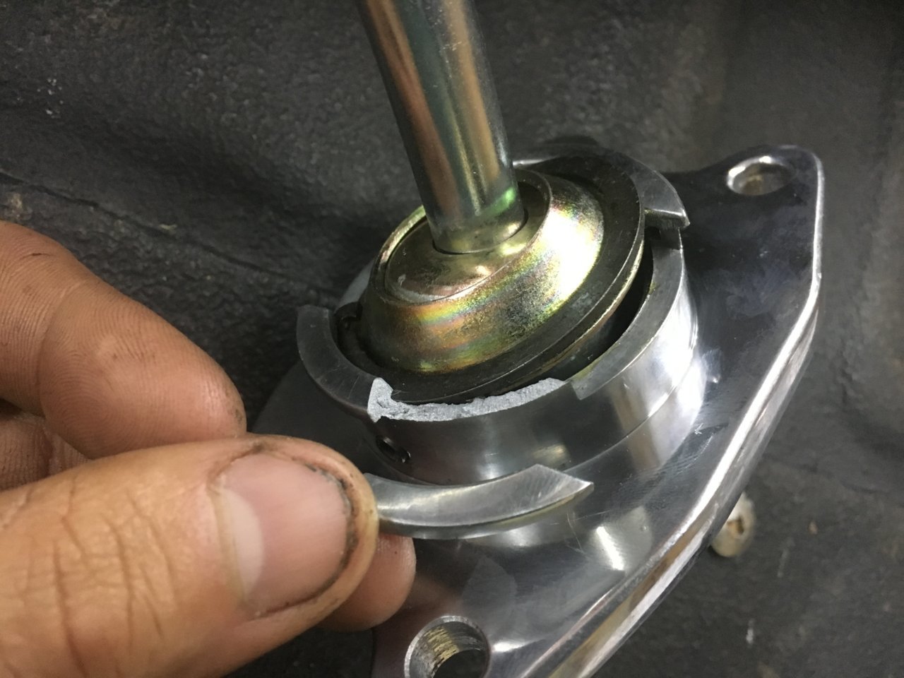

    Said broken shit

    Yikes!
    Will it still hold down in there?

    Is that a new shifter base? Is that for the crawl box? If so I may have one in my garage somewhere.
  17. Apr 14, 2019 at 7:07 PM
    #2337
    rngr
    rngr [OP] Aix sponsa
    Jan 13, 2015
    #146258
    9,244
    01 SR5 4x4 2.7L
    Nope. The broken lip is what retains the snap ring
    Yes and yes. I assume they’ll do right and send me a new one quickly. If not, might take you up on that.
    slander[QUOTED] likes this.

    How was the shift rail work? Pretty straightforward?
  19. Apr 14, 2019 at 8:39 PM
    #2339
    rngr
    Jan 13, 2015
    #146258
    9,244
    01 SR5 4x4 2.7L
    Yes. This is all pretty straightforward once you figure out what to do. It’s the figuring it out that’s tricky. There’s shit for instructions for all of this. You kind of have to read 1000 things and piece it all together the best you can.
    As for the shift rail, I trimmed it without removing it from the case. Just like you see in the pic above. I made a bed of oiled rags users it to catch filings and had a magnet positioned to catch the nub when it fell.
    Completely disassembling the case and removing the rail is probably the smart way to do it though.
