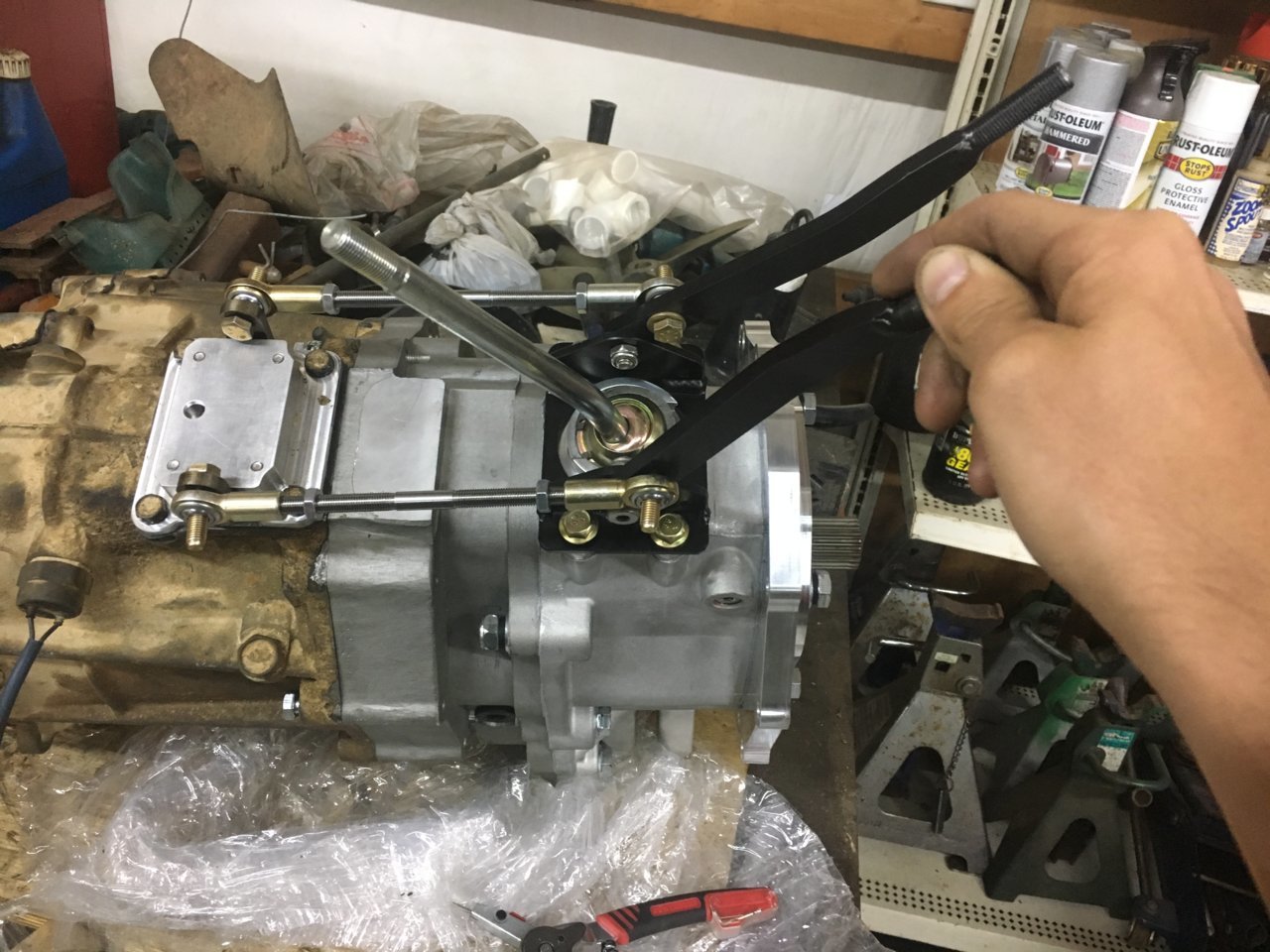

    Called TG and emailed them a pic of the broken shifter plate. Replacement is shipping out today. Can't ask for much more than that.

    Had a very unproductive evening. Looks like TG forgot the little dowels that align the cases. They’ll get another call tomorrow. :rolleyes:
    I did fit them together to test the triple sticks. The rear case shifts from 2wd/4wd and hi/lo so I guess my shift rail modification was a success.

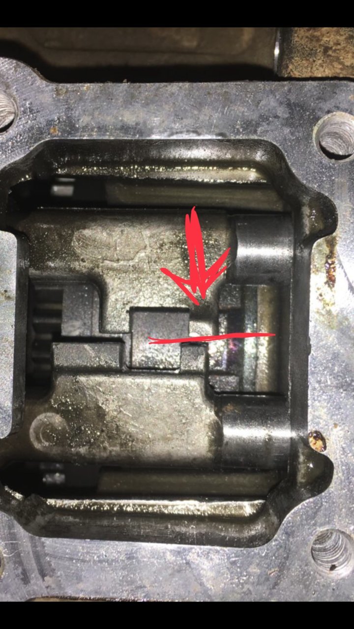

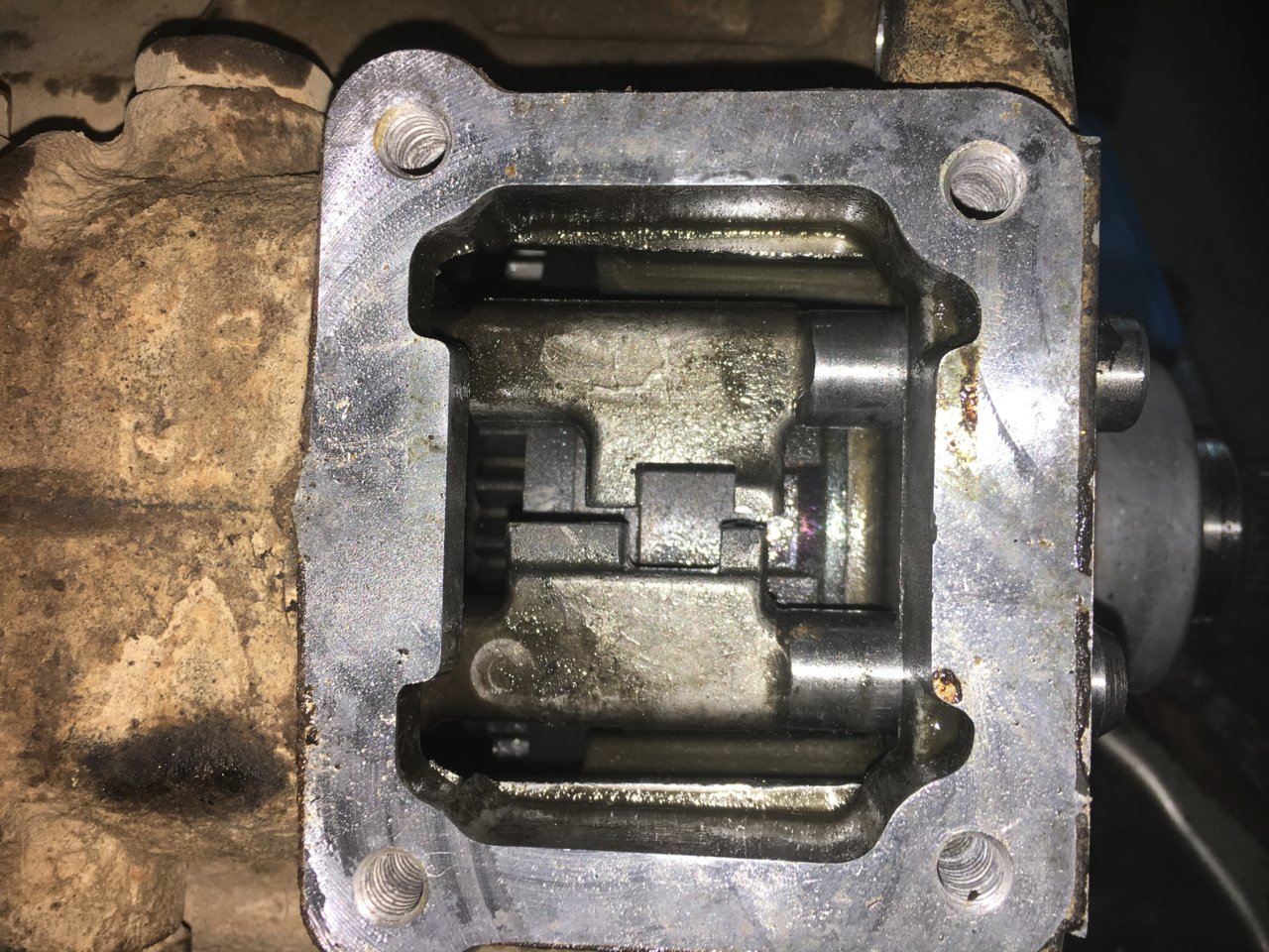

    where did you grind? I'm still confused about this part. Everything else seems easy (er).

    The tooth the arrow points to overlaps the tooth on the passenger side shifter. I cut it along the red line.
