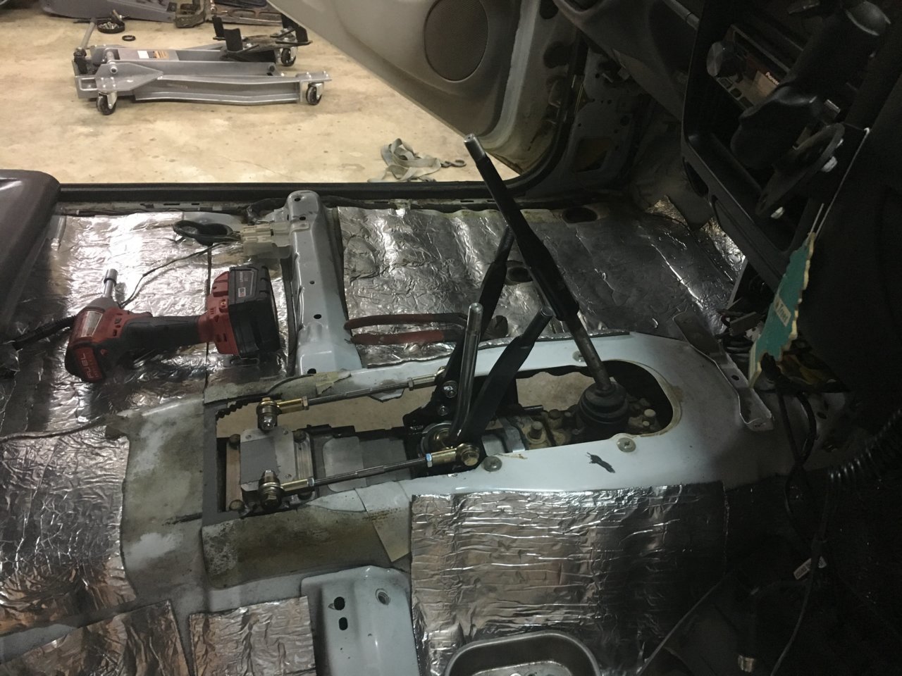

  19. Apr 27, 2019 at 8:30 PM
    #2459
    rngr
    rngr [OP] Aix sponsa
    Jan 13, 2015
    #146258
    9,244
    01 SR5 4x4 2.7L
    I have been playing with the shifters for waaaaaay longer than I’d like to admit. Rear case low and 2nd gear were not cooperating. Have everything clearing now. The shifter is going to touch my leg in high gear. Hopefully I’ll get used to it. Pretty annoying right now. Need to shorten the 2/4WD linkage so it looks a little better.
    Have you ever seen such a cluster of shifters? :p

    Could you hear and bend the top of the shifter inboard so it wouldn't touch your leg?
