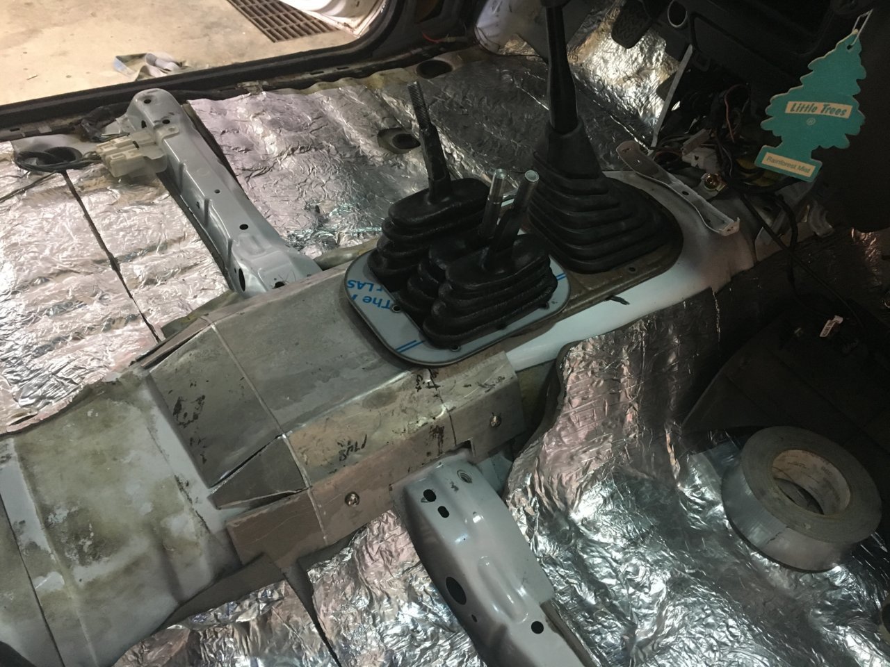

    I’m going to cut the shifter off so it’s not tall enough to touch my leg.

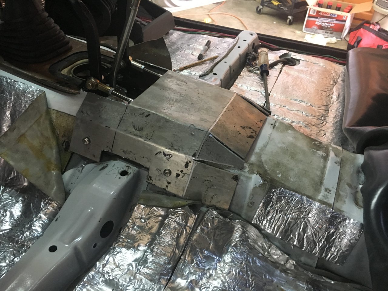

    Not sure how I made it 28 years without knowing what I rivnut is, but dang they’re handy.

    Had to drive an hour to harbor freight, but it was well worth it. $21 for the tool and 40 rivnuts of assorted sizes.

    Far from a fabricator, but I feel like I’m getting better at making things do things they weren’t meant to do, in places they shouldn’t be.
    Going to seal under and around it with the 3M stuff and go over the top with sound deadener.

    5 steps to installing a Crawlbox
    1. Do thing.
    2. Put everything together to check said thing.
    3. See where you messed up on thing.
    4. Take everything back apart to fix your mistake.
    5. Repeat at step one.

    Haven’t. It’s simply too long. Going to have to shortened a tad. No way around it.
    I recommend providing your driveshaft guy a flange to flange measurement, along with the length of the flange studs. This way he’ll know it has to be XYZ long but must be able to compress to ABC to fit over the studs.
    I was an idiot and trying to get ahead of the game by measuring the crawler and going off that. Directly against the advise of a couple people here. Don’t be like me.
