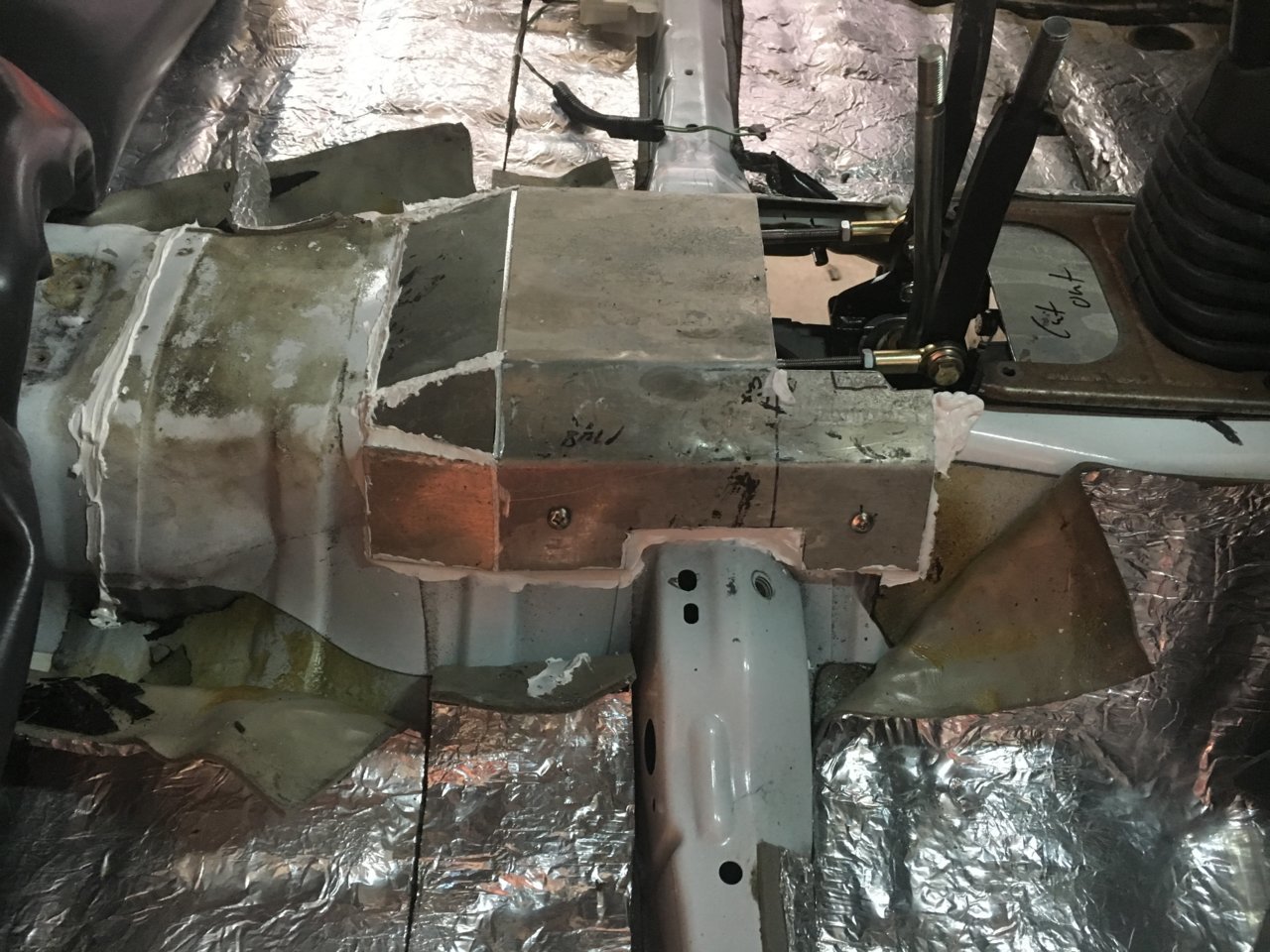

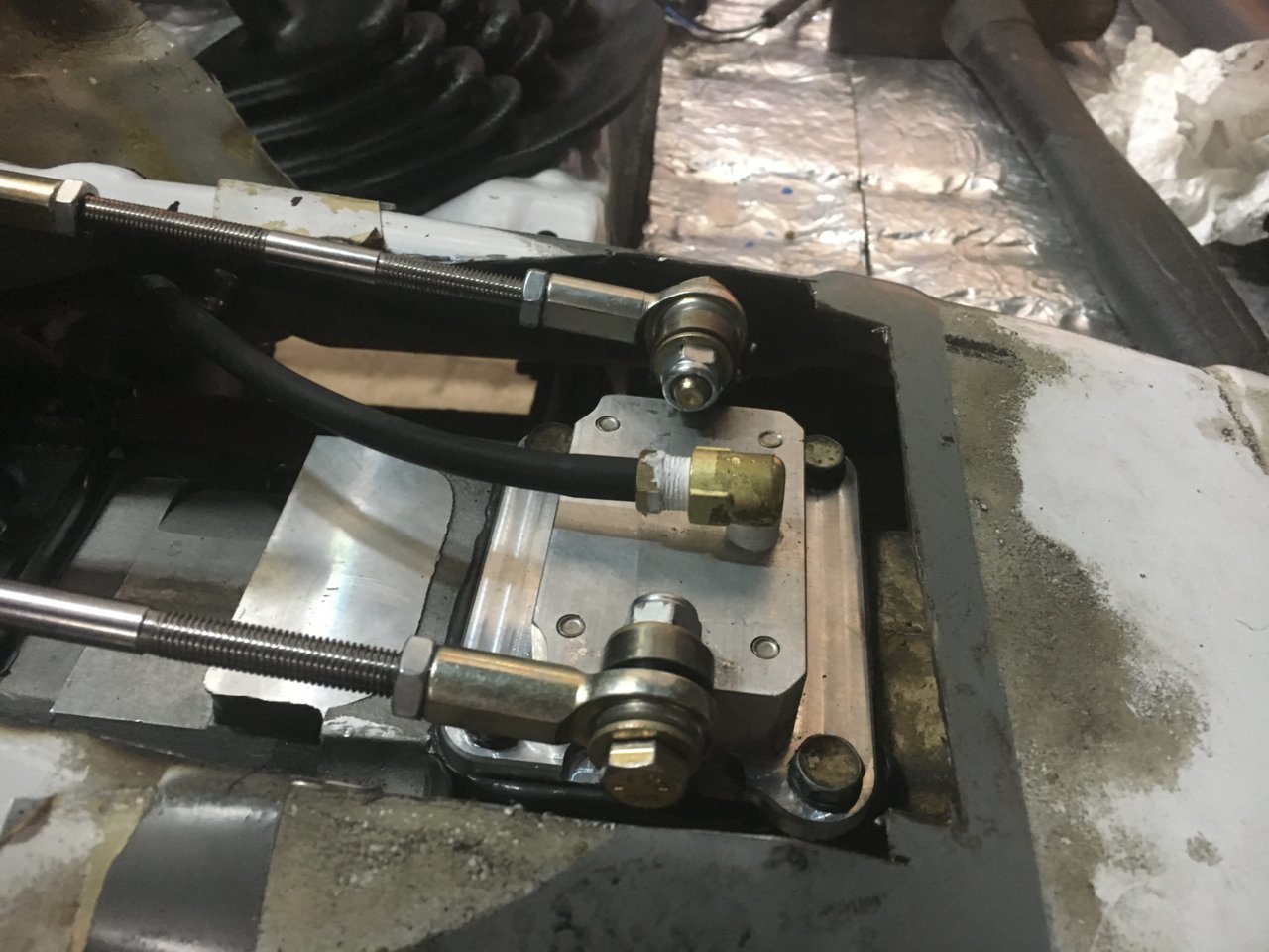

    90* fitting for the breather.

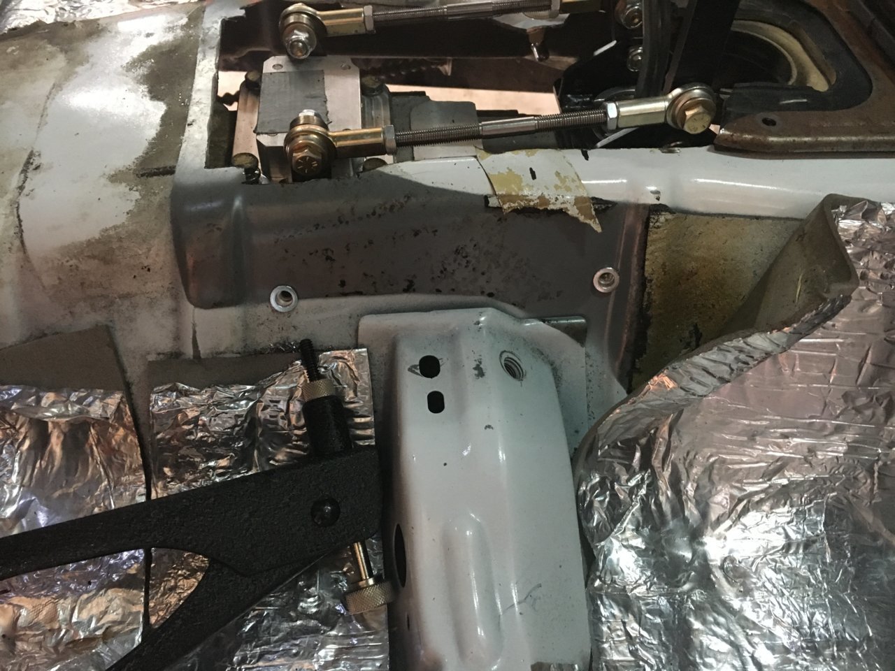

    Breathers are routed to the engine bay. Wiring is cleaned up. I was ready to seal the floor, but I broke my caulk gun. Try again tomorrow.
    After that, I just have to make my console fit again and put the cab back together.
    I can see the end.

    I almost erased that after I typed it. Haha. I can already see how it’s going to go.
    The console is going to be tricky because the new floor sits higher than the old one.
    My seat brackets probably won’t long up with their holes from all the trans tunnel smashing.
    I’m sure something else will go wrong.
    Also have a cv to reboot and replace.

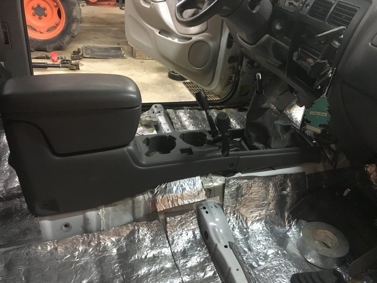

    It fits(ish)!!!!!!! Per the usual, a cut to fit affair.

    Cut the console?

    The things. Cut all the things.
    Yea, the front of the console has to be cut. The rear of the trim piece that goes around your shifters has to be cut off too.

    what're you cutting stuff with? Dremel? Jigsaw?

    Grinder and dremel. Grinder with cutoff wheels is absolutely necessary for this project. The dremel with EZ-lock cutoff wheels might not be a necessity, but it sure is handy.
