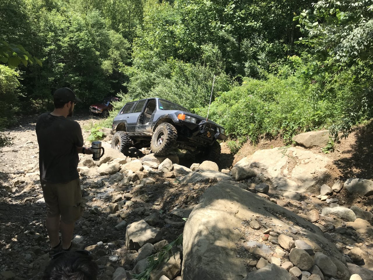

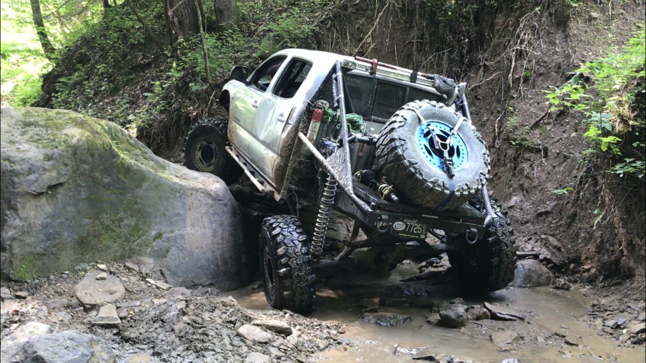

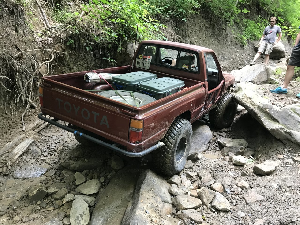

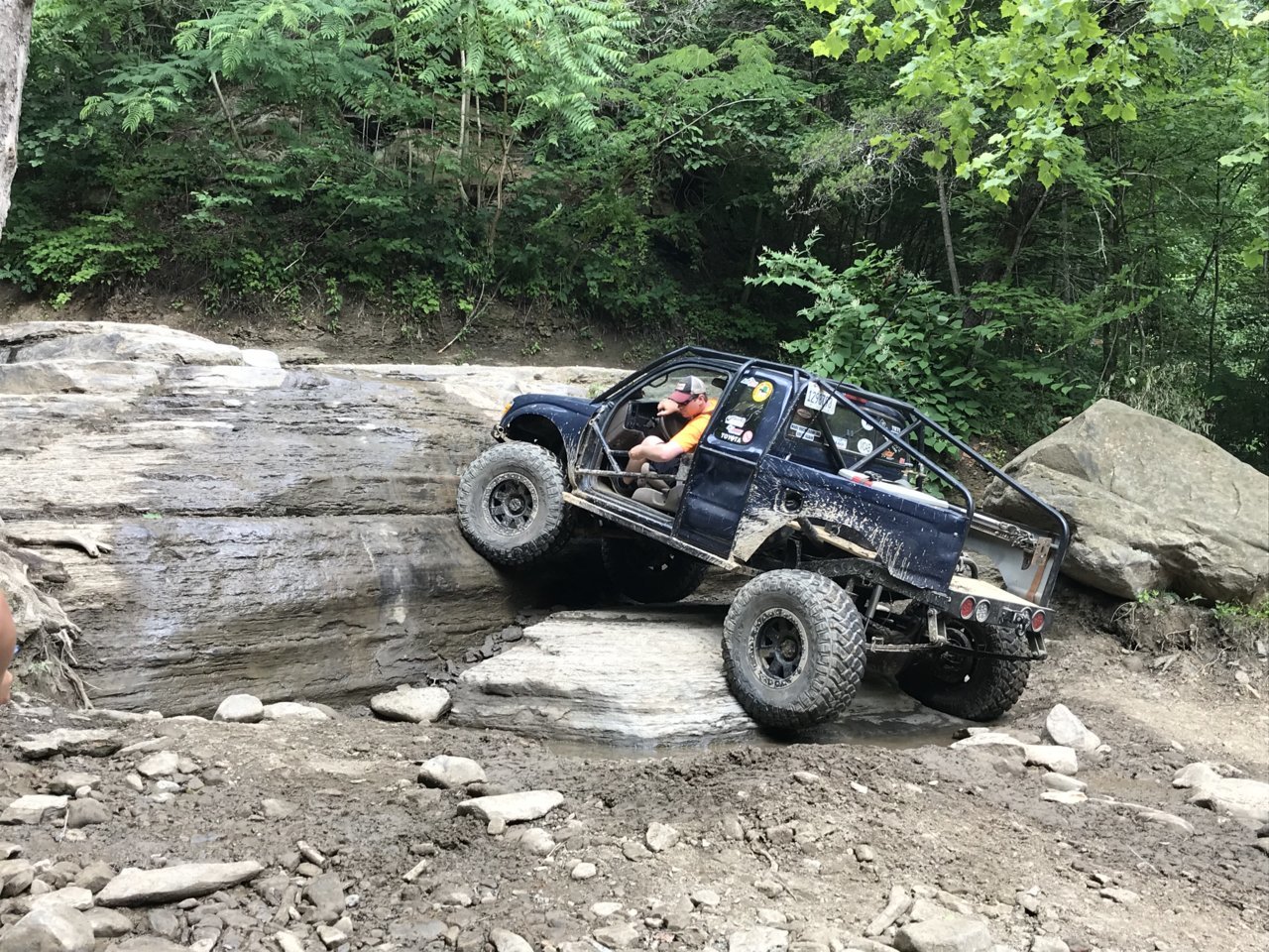

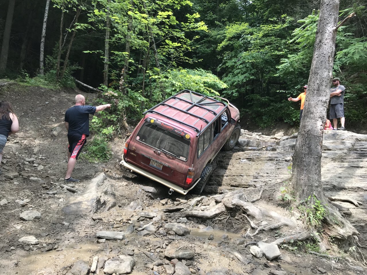

    I got to spend the weekend at black mountain wheeling. Here’s my completely unscientific crawlbox review / trip report / rambling about my truck.
    On the crawler... wow! I’m am mind boggled. It’s a whole new world. All the traction, all the control, none of the bashing and banging on your truck. I wouldn’t say that’s it’s something everyone needs by any means. It was a LOT of work and money. 11/10 would recommend if your goal is to play in the big rocks rather than ride easy to moderately difficult trails. I would do it again starting today now that I’ve experienced it.
    We ran white tail crawl, lower rock garden, rail bed, and fish fossil. The truck did awesome. Obviously, it struggled when belly height was key compared to the 37-40” tire clad monsters I was with. Being skinny paid off, as usual, in many places. The winch took care of the all the places I couldn’t make. I was very pumped to run the entirety of lower rock garden and all but about three feet of white tail winch free! Rail bed gave me fits because it was so wet, but I made it!
    I popped a cv winching out the exit of fish fossil. It was a bad spot and 100% preventable. I was trying to drive and winch with the truck laid over pretty hard. I felt it binding up, but Had so much going on I didn’t process it fast enough to make the decision to stop. Haha. Then boom. Turned out to be a good thing though because Levi taught me the super awesome and fast method of changing the axle without having to remove the inner from the diff. So fast and no diff oil lost!
    As far as the build goes, I feel like it’s where it needs to be for a good long while. I have a whole lot of wheeling to do! Will be needing tires soon. Kicking around a couple thoughts there. Have almost certainly decided against tubbing for 35s. I am curious about beadlocks and the 34ish” sizes. I think I could squeeze them in there. The 255 km2 has been so good for me though I’m not sure I could find something better.
