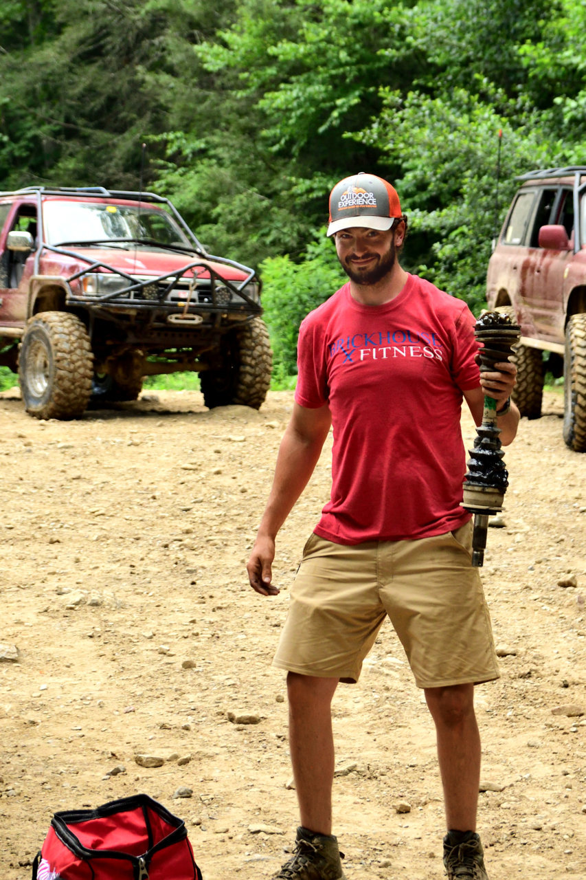

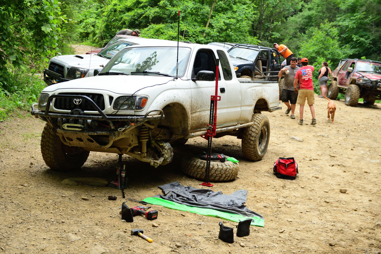

  17. Jun 21, 2019 at 5:25 AM
    #2697
    honda50r
    honda50r Not a Mallcrawler
    May 9, 2017
    #218593
    4,111
    East Tennessee
    2nd Gen Tacoma
    Not Stock
    My b, didn't take the time to look back in the thread.
    I've heard of not removing the inner but personally never had luck. Can you share a quick synopsis?
  18. Jun 21, 2019 at 5:38 AM
    #2698
    rngr
    rngr [OP] Aix sponsa
    Jan 13, 2015
    #146258
    9,244
    01 SR5 4x4 2.7L
    No worries. Was just easier to quote it than write it. Haha.
    For sure. You just cut the clamp that holds the inner boot on the cup rather than pulling the cv out of the diff. This prevents you from losing any gear oil. It's also hell trying to remove the cv from the diff without dropping my skids, so that's a big time saver too. You can see in Brent's pic how the inner part of the cv is missing in the pic. That's because it's still in the diff.
    Then, you do the same thing to your new cv, pack some grease in the cup that's in your diff, and slide the 3/4 of the new cv in. Run a new hose clamp around it and tighten it up.
    We had the truck rolling in probably 20-30 min with this method. I can't do it that fast in a garage. haha. Levi for the win!
