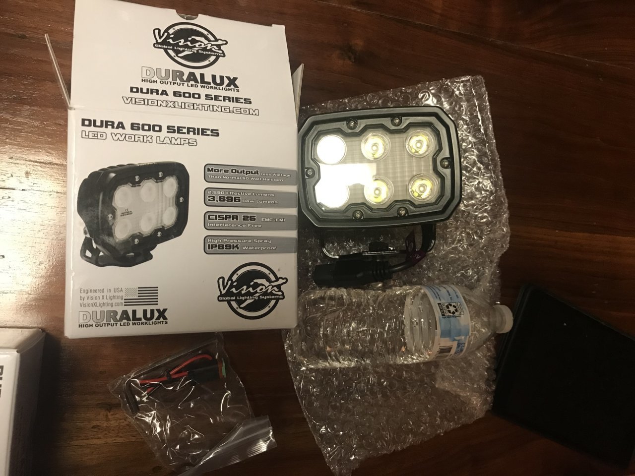

    Happened upon a pair of these. Where do I put them? They’re pretty big. Water bottle for size reference.

    I bought some lights to put behind the cab facing backwards and to the side. I cant see shit night wheeling when backing up, this was to mitigate that. They are in a box because I'm too dumb to figure out how to wire them up without melting the wires.
    That would be my recommendation. Putting them up front just turns you into that asshole guy on the trail blinding everyone at night unless you are the trail leader. Around here at least it's too urban and too many people to use them on the street.

    Mount em on your lawn mower.
    Seriously. It's awesome having bright lights for yard work.

    Put them on the Runner so you see the deer next time :boink:

    Yea. That was my first thought, but I don’t know where I’d put them. If they hang outboard at all they’ll get ripped off.
    That would be handy toward the end of the mowing season when the days get short. I always have a hard time getting all my yards done before dark late in the year.

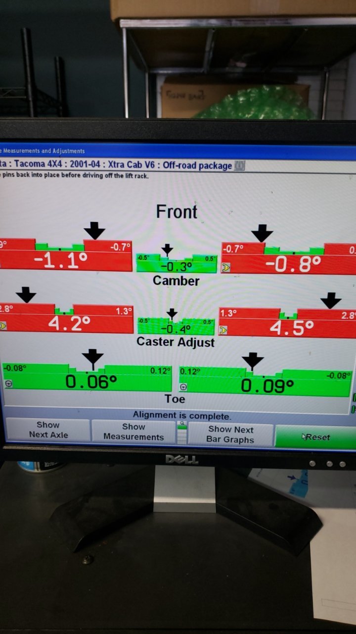

    How did you get that much caster?!

    By allowing negative camber. I need that much caster to get the tires out of th firewall.

    Toe could be much better.
    .1 toe in or out is quite a bit for a non race truck. Or is it #becauseracetruck ....

    Obviously racetruck. :facepalm:
