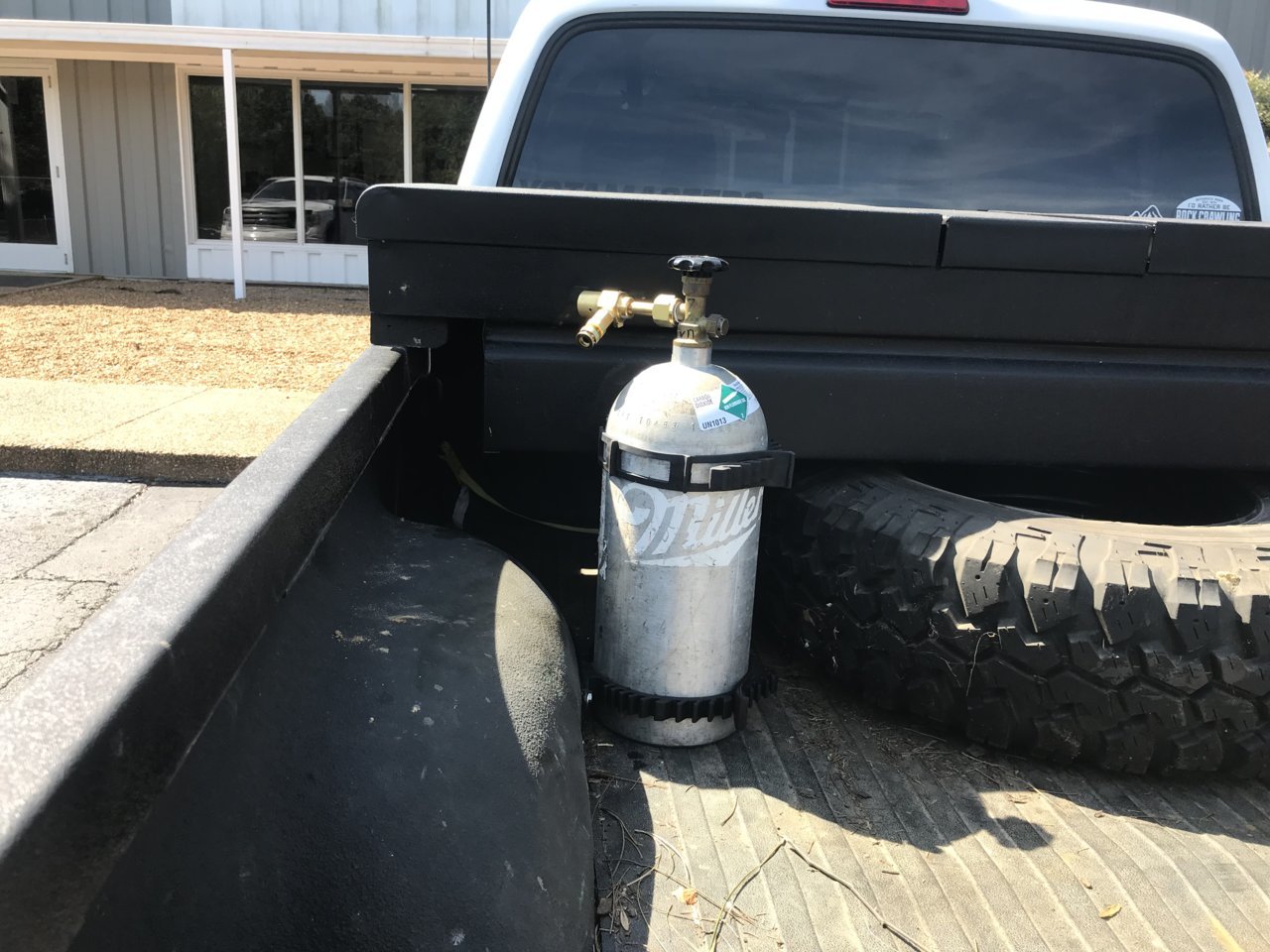

  4. Sep 8, 2019 at 9:32 AM
    #2944
    rngr
    rngr [OP] Aix sponsa
    Jan 13, 2015
    #146258
    9,244
    01 SR5 4x4 2.7L
    Finished my Co2 project. 10# tank. 150psi fixed regulator from poly performance. Quick coupler from the auto parts store. $120 all in.
    I’ll use my ARB hose and chuck.
    I’ve had these two big quick fists for years I got for free. Decided to give them a try. They secure it surprisingly well.
    BYJOSHCOOK and dirty deeds like this.

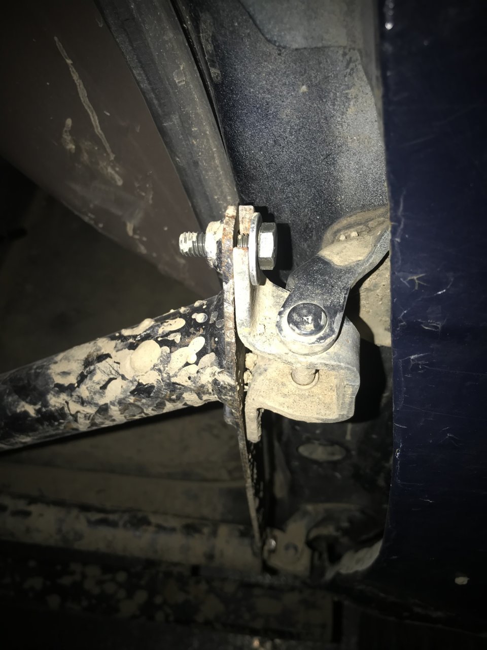

  5. Sep 8, 2019 at 10:27 AM
    #2945
    rngr
    Jan 13, 2015
    #146258
    9,244
    01 SR5 4x4 2.7L
    @Snowy
    How did you modify your hinges?
    I saw where some people were cutting the hinge pins out and replacing them with a clevis pin. I don't think that was how yours were done, but I can't remember.
  6. Sep 8, 2019 at 10:31 AM
    #2946
    rngr
    Jan 13, 2015
    #146258
    9,244
    01 SR5 4x4 2.7L
    I'm thinking pretty hard about redoing this already.
    I might cut a hole the diameter of the tank in the bottom of my toolbox and slide the tank down in it. It'd be a little more out of the way and the fittings out of the weather. Would only cost me a little storage space. Hmmm...
  7. Sep 8, 2019 at 11:00 AM
    #2947
    Snowy
    Snowy Is neither here nor there
    Feb 5, 2014
    #122349
    3,465
    Connor
    Winnebago, IL
    3 linked 98 Xtra cab
    Stock-ish
    I just slotted the top hole and run only top bolts so all you have to do is loosen them and lift the door on or off
    rngr[QUOTED][OP] likes this.
  8. Sep 8, 2019 at 11:28 AM
    #2948
    rngr
    Jan 13, 2015
    #146258
    9,244
    01 SR5 4x4 2.7L
    Gotcha! Think I'll do the same.

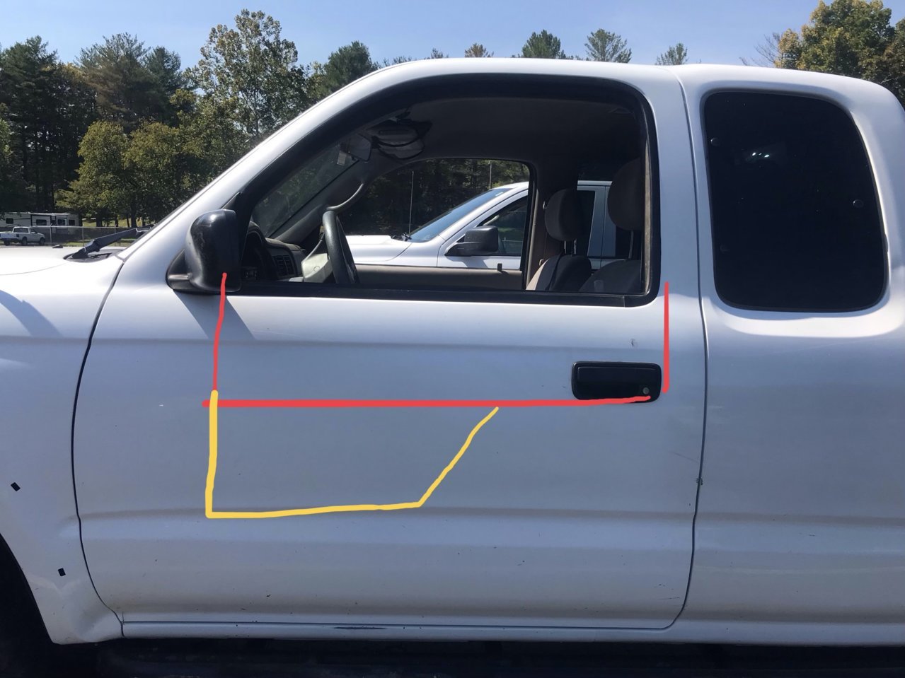

  9. Sep 8, 2019 at 12:14 PM
    #2949
    rngr
    Jan 13, 2015
    #146258
    9,244
    01 SR5 4x4 2.7L
    Kicking around s couple idea for the half doors. Leaning toward this. I want to retain enough door to keep mud and shit off me. Judging by the usual pattern of mud spray, I think this is the best compromise between visibility and keeping stuff out.
  10. Sep 8, 2019 at 12:47 PM
    #2950
    Snowy
    Feb 5, 2014
    #122349
    3,465
    Connor
    Winnebago, IL
    Stock-ish
    I’d go lower towards the body line. You’ll gain a ton of visibility by going that low and you’ll be incentivized to stay away from mud

    9,244
    01 SR5 4x4 2.7L
    There’s no staying away from mud all the time. Going to make that cut first. If I need more vision, I’ll add this one to it.

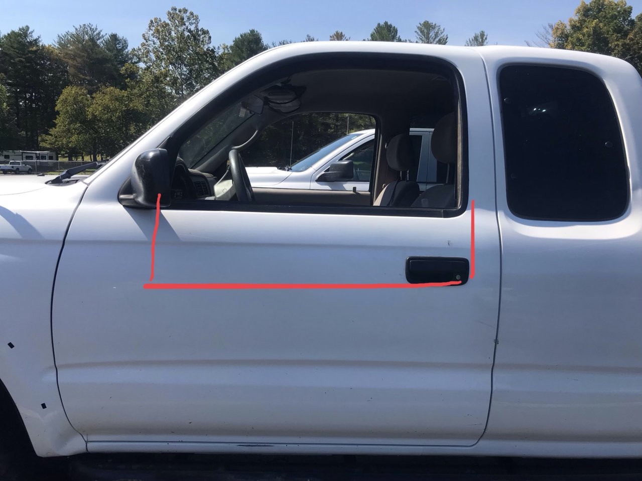

  20. Sep 8, 2019 at 5:30 PM
    #2960
    rngr
    Jan 13, 2015
    #146258
    9,244
    01 SR5 4x4 2.7L
    Got one cut. Ran out of daylight. Going to bolt this one up and see how I like it before I start on the other. 7783BC0D-EDC0-471D-9269-99FC0E79B040.jpg
