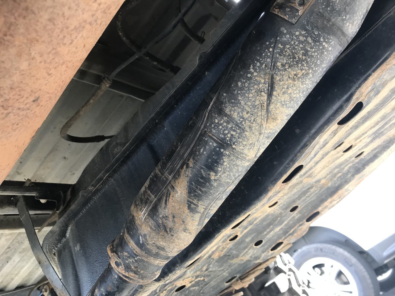

    Sounds like flat spotted swampers that finally broke in to me. Driveshaft would be more predominant at higher speeds than lower.
    If you're willing to pull the driveshaft though, go ahead and you'll know for sure.

    Gonna have to get a new drive shaft anyways. Pull it and see if it goes away

    For some reason, pulling a driveshaft is my least favorite thing to do on the Tacoma. The inability to get an impact or ratcheting wrench on any of the nuts or bolts is maddening to me. It's just far enough above your head too that your shoulders are on fire by the end from just turning a wrench 81553753 times to get all eight bolts out.

    It's easy to get one on there: use a deep well 14mm and a short extension and you can get an impact on there. Jack up the rear of the truck up you can rotate the shaft so the bolts are on the bottom. After you get the axle end off, it's easy to then get the impact on the center flange bolts. Gotta be smarter than the truck yo!
    Duct tape the teloscopeing section of the shaft so it doesn't come apart on you.

    Socket with extension works for me.
    You might be able to see it if you chock the front wheels and lift the rear off the ground and put it in 1st.

    I'm typically too lazy to jack the truck up to spin the shaft. And it's not the third member flange that's tough, its the carrier bearing side that you don't get any room to get an impact on it.

    That's why you take the axle end off first or drop the carrier bearing.

    At least it won’t be on the side of a mountain like when we pulled Tim’s Friday.
    also, found the problem. Huuuuge chunk of a root stuck in the inner bead of my rear tire. It was in there good. Had to drop tire to 3lbs to get it out.

    My driveshaft is bent and I feel it at random speeds. It's fine at 75 mph but death shake at 77 mph. Haha so you probably feel it but may be hard to differentiate between that and the tires at random speeds.
