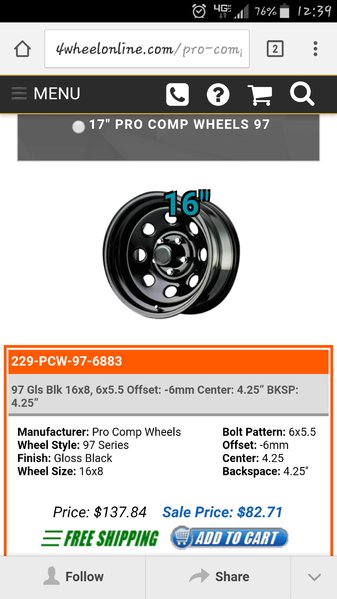

    I have no idea why the previous owner changed them out, but I wish he hadn't. The 4.5 BS 1st gen wheels plus my spacers would let my tires clear the frame. These 5.25 BS wheels leave me rubbing the frame at full lock under compression, even with the spacers. It is very minimal, but it's there.

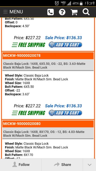

    They do look good. Cheap too! I assume they're steel?
    They would have me more in the frame than I am now unless I left the spacers on. 5.25 on my current wheels minus 1.25 spacers is the equivalent of 4.0 BS. Need 3.5" to run without spacers.
    I'm not worried with it though. The rubbing is very very minor.
  14. Jan 8, 2017 at 11:27 AM
    #414
    11TRDTX
    11TRDTX bruh
    Mar 15, 2012
    #74980
    7,826
    Memphis, TN
    2011 TRD TX 4x4 MGM DCSB
    Lift, 285's, mud, and scratches
    I think Mickey Thompson makes the classic locks in 3.5 bs. I looked at those before

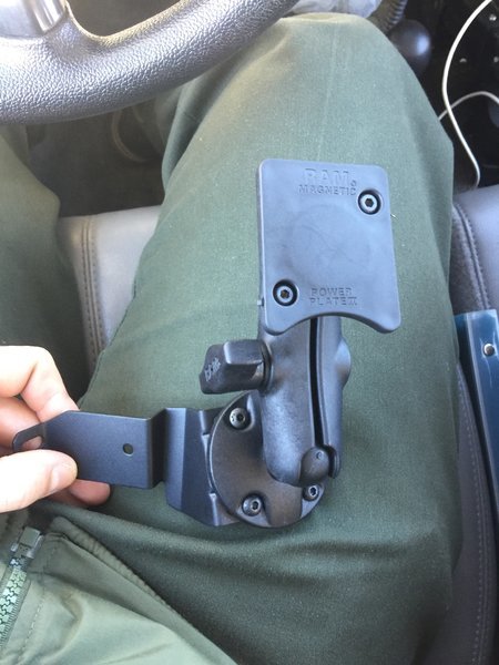

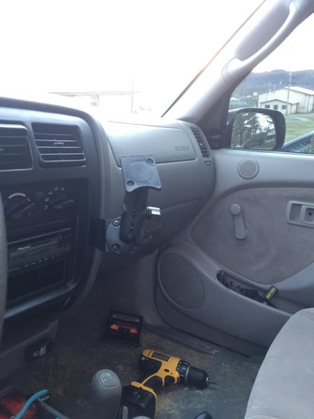

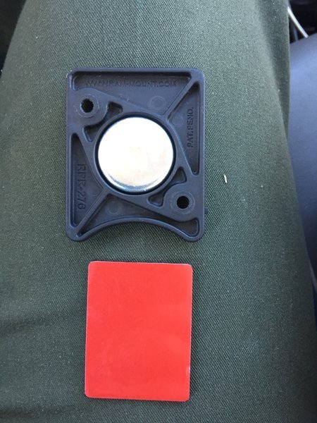

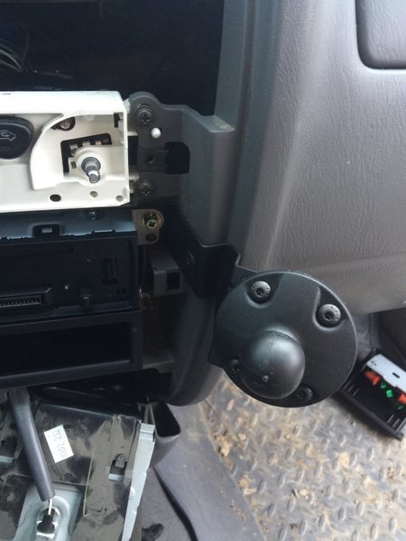

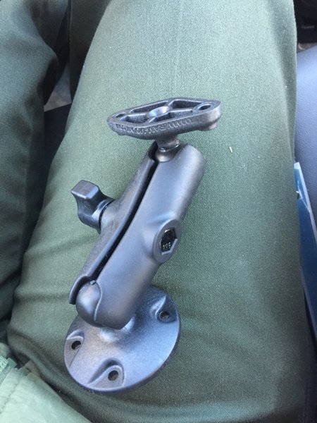

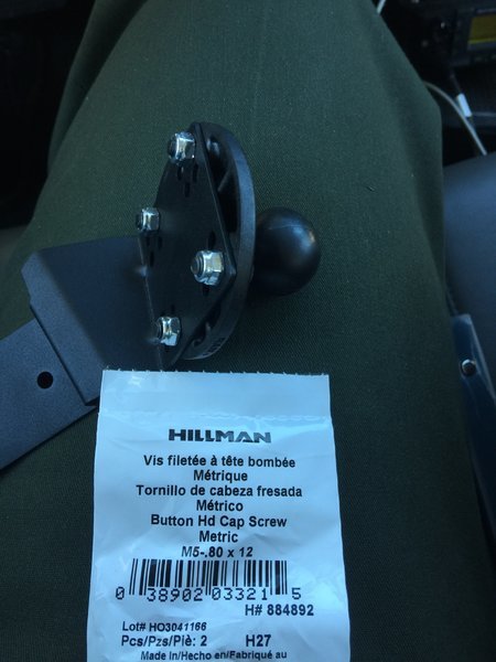

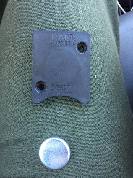

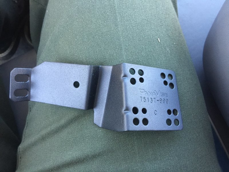

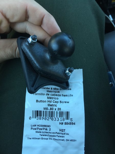

    Phone mount complete.
    Parts
    RAM gps mount from Bass Pro
    Ram magnetic plate and metal adhesive plate that goes on the back of your phone
    PanaVise dash mount
    Install
    And done.
