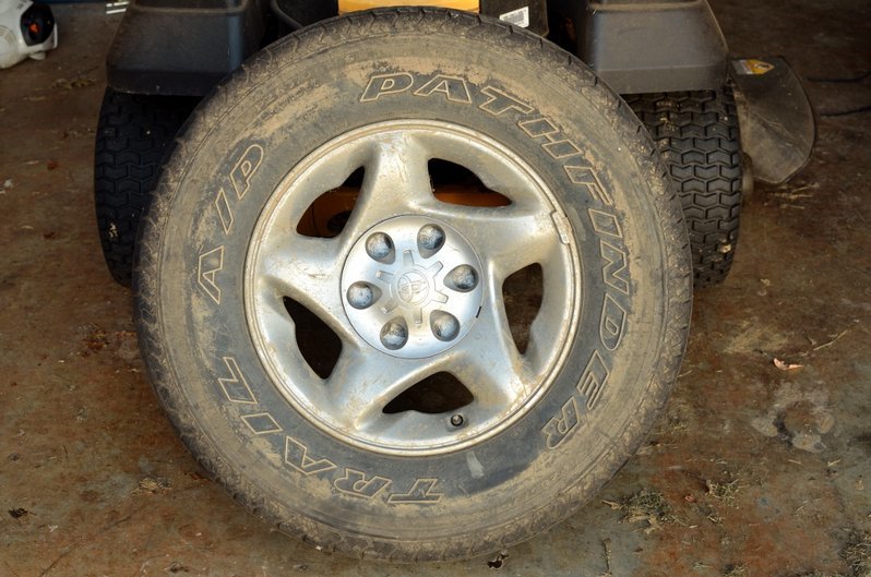

    How many pesos would take them home?
  5. Jan 13, 2017 at 7:03 PM
    #445
    Breezy
    Breezy vaping in my subaru
    Apr 22, 2012
    #77444
    3,528
    @breezy.images
    Bardstown, KY
    Ferd Fuckus
    I think I had them listed on Craigslist for ~ $4000 MXN but you would get a TW rate for sure. I'm intrigued by those 2nd gen wheels but the rubbing turns me off :sawzall:

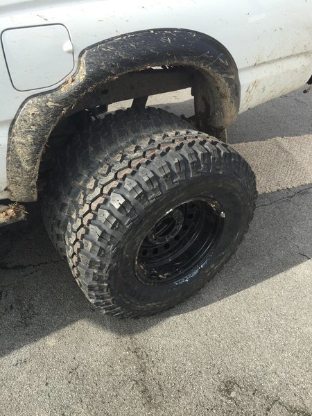

    Sooo, $186.23 USD?
    I think I am just going to run these until I decide to buy some wheels with the correct BS so I can ditch the spacers. The frame rub is so slight, I bet you would all laugh if I had a pic. It's there nonetheless though.

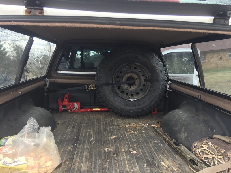

    Got my spare mounted up. It's a maxis bighorn. Not a bad looking tire at all. I was hoping to be able to fit it under the bed, but it's just too big. I think my aftermarket hitch it the problem. I also think that if I had an aftermarket bumper with a built in hitch (like the trail gear I had on the other truck) it would fit.
    In the mean time it'll ride here.

    Would it fit if you deflated it? You have oba, so that shouldn't be an issue.
  13. Jan 15, 2017 at 3:32 AM
    #453
    rngr
    rngr [OP] Aix sponsa
    Jan 13, 2015
    #146258
    9,244
    01 SR5 4x4 2.7L
    Hmm, never crossed my mind, but I doubt it. It's a lot too big. I'll check it nonetheless.

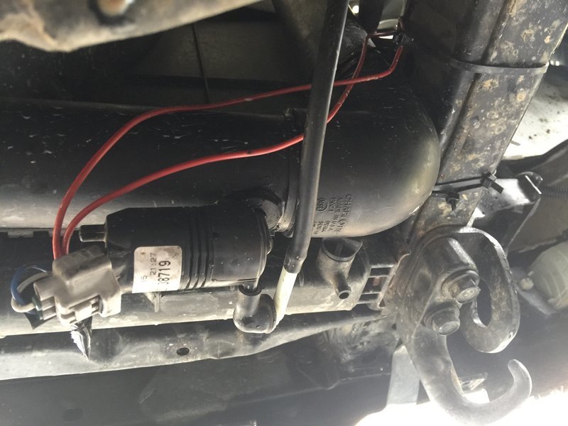

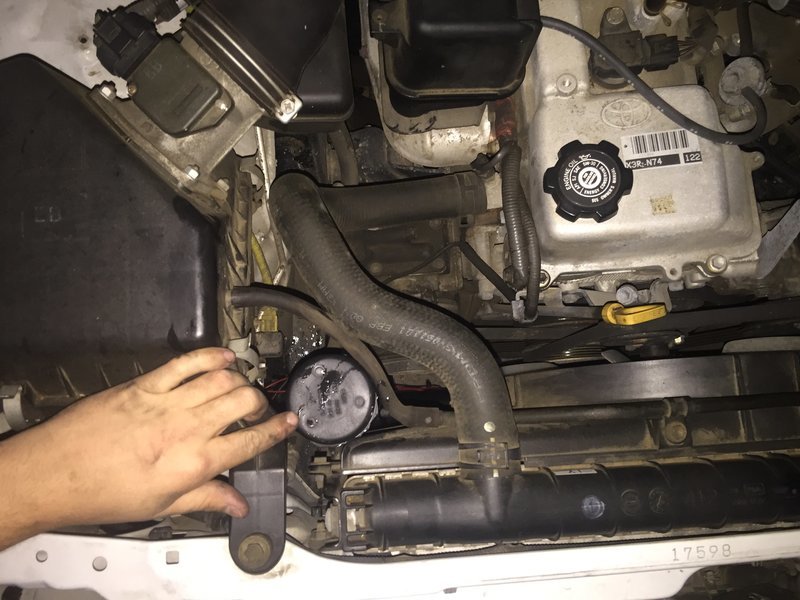

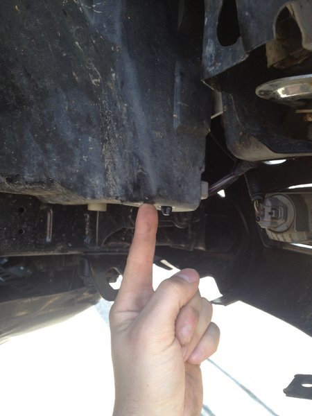

    Washer fluid reservoir relocation.
    I am hoping this is the end of my tire rubbing. It was rubbing the reservoir here.
    So I made this from PVC
    Write-up here.
    http://www.tacomaworld.com/forum/1s...ild-lt-expo-trail-rig-bs-407.html#post8802626
    And mounted it here by getting really crafty with zip ties. Also had to extend the wires and hose for the pump.
    It's very solid, works great, hidden by my "skid plate", and cost me less than $3. I'm happy.

    Now that I think on it, couldn't it warp the tire out of round if it stayed up there with its shape distorted for long periods of time?
  16. Jan 15, 2017 at 8:35 AM
    #456
    allmotorrex
    allmotorrex Grove St. Fab
    Aug 29, 2010
    #42441
    16,746
    Gideon
    Memphis 901
    08 SR5 4wd 2.7
    NWF crawlbox, 5.29s, rear Detriot, front Harrop, 37" SXIIs, 17x9" KMC Grenade Crawl beadlocks, Dirt King 3.5" LT kit with King shocks, Fox 12" smooth body RR, BAMF shock kit, AP 3" springs, ext. brake lines, custom 1 piece driveshaft with .135 wall tubeing, GSF front rock crawling bumper, GSF rear bumper, Relentless Fab ifs skid, BAMF k/o sliders, X2O 10K comp. winch, TP glass fenders, OKled 20"bar, EBS dimpled/slotted rotors, EBS green pads, custom K&N CAI, LCE headers, FM Super 44 w/h turn down, URD MAF, Spec clutch, LCE heavy flywheel, URD short shifter, TMPer M1 Abrams shift knob, Amsoil oil, Cobra 75wxst w/h 4' firestix, Grillcraft, FXR TRS, T1 eyelids, custom ADV Monster 60 lights, bed lights, speedo light mod, Glow Shift volt/oil pres gauges, Glow shift 2g column pod, Optima yellow tops dual battery setup w/h IBS system, Pioneer DEH-P7200HD head unit, Pioneer 600W 4ch & 350w 2ch amps for doors and sub, Wet Oakle covers
    Maybe but if that's your theory then it's much worse to leave a truck sitting on its tires in the driveway for extended periods of time considering the load they hold

    Hey Carter, I got that measurement for you:
    22" from forward edge the bed crossmember to the forward face of the built-in hitch on the TG bumper. I'd consider going with 21-1/2 or 21-3/4 just to be safe, as my bed may be shifted relative to the frame compared to yours. There is also a bit of parallax there, since the two locations aren't on the same plane, so to speak.
    I'd be happy to measure again from the frame crossmember if you'd like, but that should get you pretty close. Good luck!
