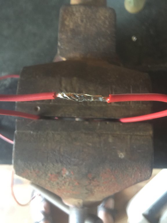

    Finished up my CB project. Took a quick crash course in soldering on YouTube. Simple enough. Practiced a little on some scrap.

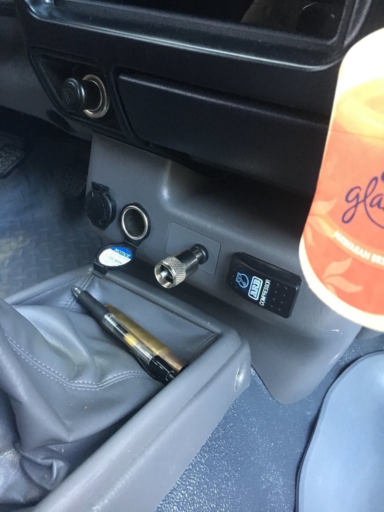

    Then I soldered the connection into the end of my coax. Routed it to here, where I'll hook up my hand held when in use.

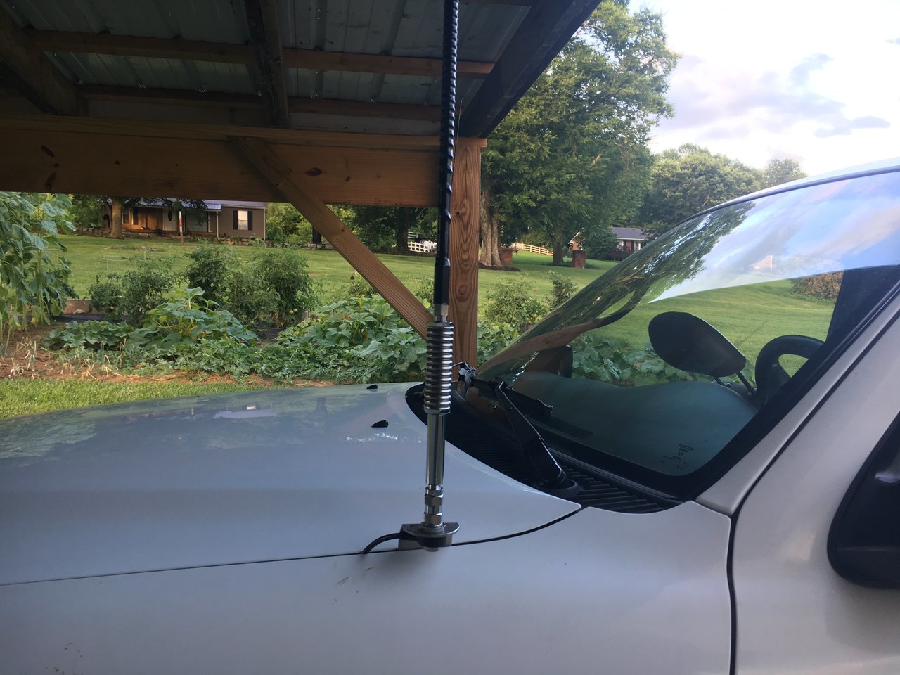

    Final antenna setup includes a spring and a quick disconnect. Won't have the antenna up until it's trail time.
    I was very surprised at how little movement the antenna has in the road. Very pleased. :)

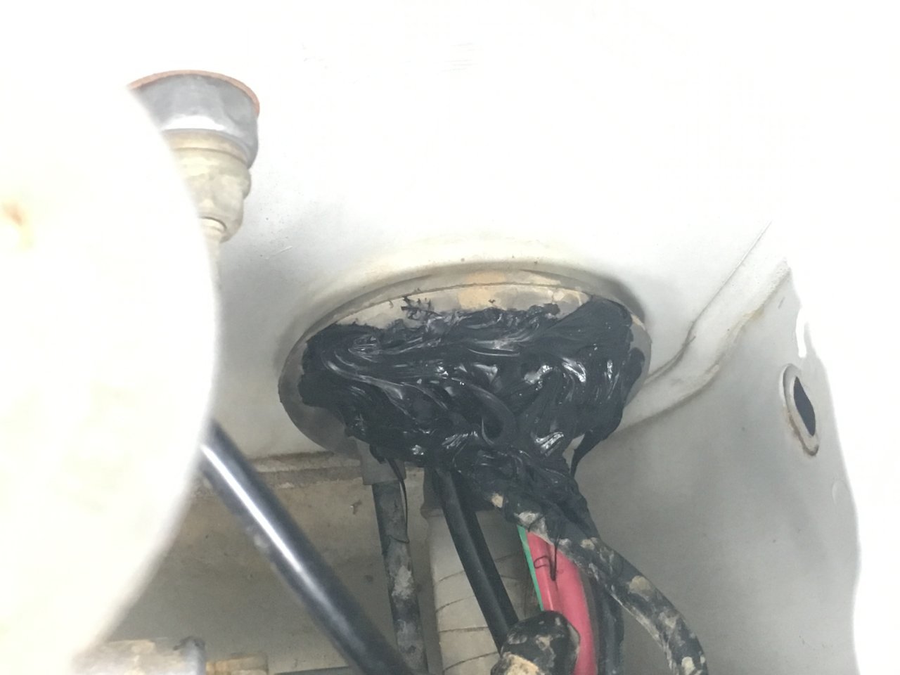

    Found the source of my cab leak. It's entering through the driver side firewall grommet. Plan to build some sort of hat or roof to shield it. Not sure what that means yet, but I assure you all it will be ghetto fabulous.

    Just smear some silicone caulk stuff all over it. That's what Toyota says in their instructions for running bedlight wires out of the cab floor grommet and that all I did for my CB antenna wire going out of the cab.

    There's so many wires going through though. It looks like a recipe for a giant mess. May be worth a shot.

    I drilled a 1" hole in my cab to run antenna wire (connector and all) right where I wanted it then just globbed on the silicone to seal it. Not pretty but no leaks.

    Went your route.
    Didn't leak last night. :fingerscrossed:
