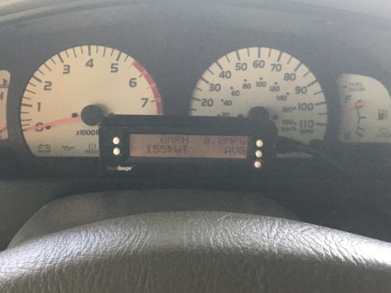

    01 SR5 4x4 2.7L
    Plan on measuring things and stuff
    Not where it's going to live permanently, but I want to play with it on this weekend's trip so I stuck it there temporarily with some Velcro.

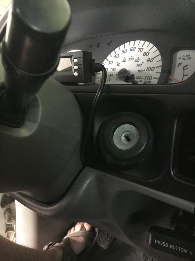

    Decided I liked the scangauge where I had it after all. So I fished the cable through the steering column.
    Need to use a gps to set the speedometer function. I'm pretty sure doing it by percentage of tire size increase is not giving an accurate reading.

    Nice! That's where my UltraGauge is gonna live. Does the SG not have a distance calibration?

    What do you mean by distance calibration?
    The SG has a percentage function for adjusting the speedometer. I currently have it set on +17% because 255/85/16 is 16.9% larger in diameter than the stock 225/75/15.
    Almost positive the SG is reading too fast. Generally, when driving 80 on the interstate here you are passing the majority of the traffic. Diving at 80 by the SG, I'm getting passed by lots of cars.
    Maybe the speedo was slow from the factory.
