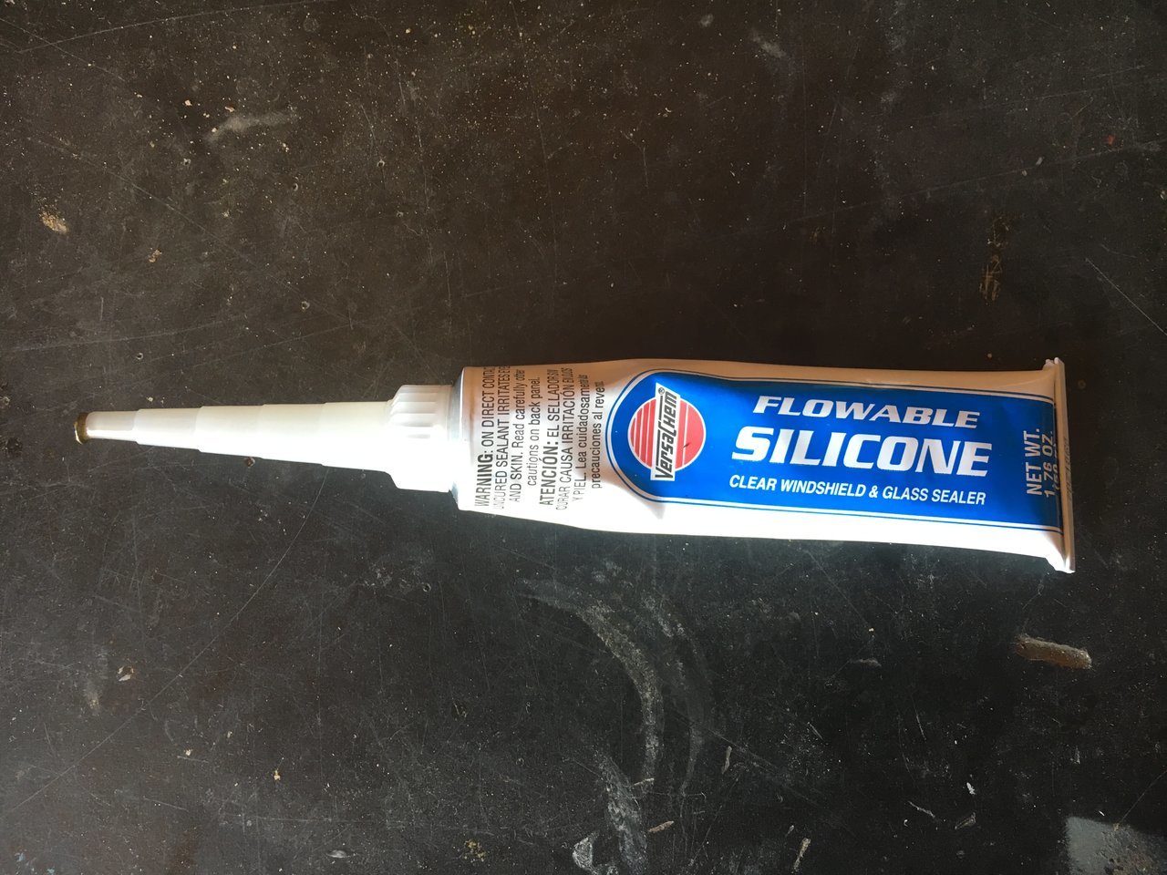

    Had no idea this existed. Worked awesome for sealing my corner lights without getting silicone all over the lens. It's thinner than regular silicone and runs right down in the crack you're trying to seal. Win.

    You can also thin silicone with mineral spirits to any consistency you like. For future reference.

    Did not know that. Interesting. i see myself making a huge mess trying that. Hell, I cane keep it off me using a caulk gun.

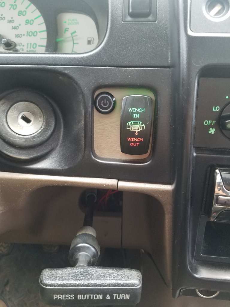

    During my research of how I'm going to turn my fogs on/off I discovered that apparently "bitches love switches", or at least that's what I read. :notsure: So I ordered this.
    https://www.paranoidfabrications.co...ma/products/1st-gen-tacoma-clock-switch-panel
    It replaces the clock. That might sound like a dumb idea if you've never driven a first gen. However, if you have you'll understand why I won't miss having to do some kind of effed up yoga pose while driving to see the clock. My head unit shows time anyway.
    Then TW convinced me that you're pretty much a loser if your switches aren't from OTRATTW. Nobody wants to be a loser so...

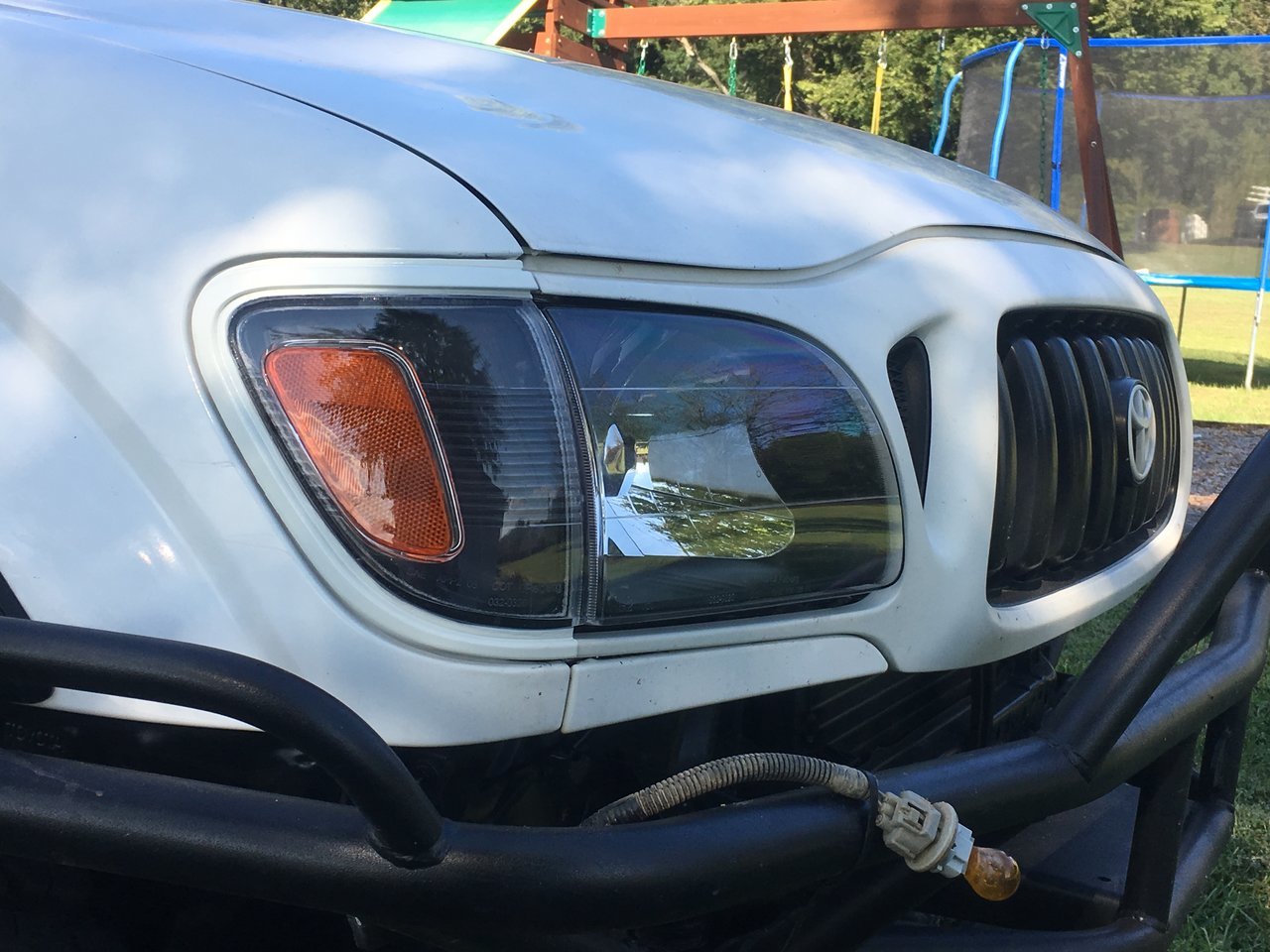

    No. Didn't try. Just used silicone for an extra layer of protection where the lens meets the housing. On the front, there is a small crack between the two. I used this to drip a bead into the crack all the way around.

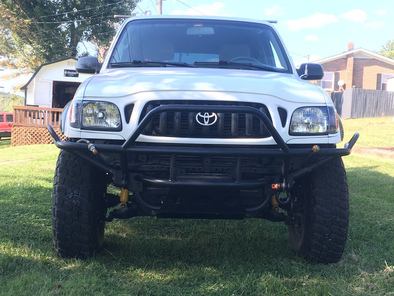

    When you want to gusset that bumper??

    Yessir
    Where are you gusseting?

    I'm not sure really. Been really unmotivated to work on the truck cause there's so much stuff that needs to be bought and worked on.
    The brackets on the bottom of the bumper that have the two mounting holes needs to be cut off and a new bracket made. Currently the brackets are about 1/2 a hole off and you can't get a bolt started. Tried to expand the frame horns with a floor jack but no go.
