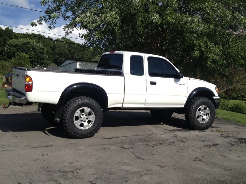

    I need to see that thing flexed out on a curb or blade of grass or something.

    Going to take her out for a few minutes after supper to get some witness marks for fender well trimming. I'll snap one just for you, buddy.

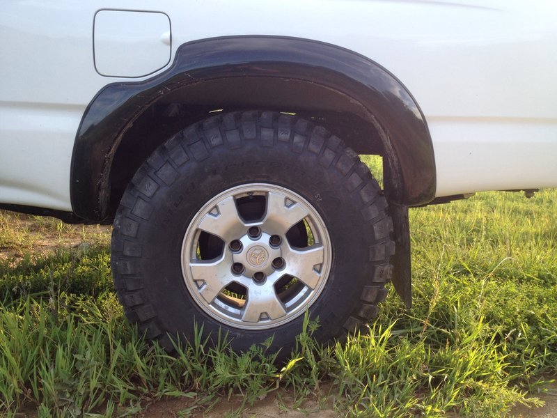

    01 SR5 4x4 2.7L
    The all-pro axle relocate plates did a fine job of centering the wheel in the well. I used them in the 3/4" position. Thanks for the info @Delta00

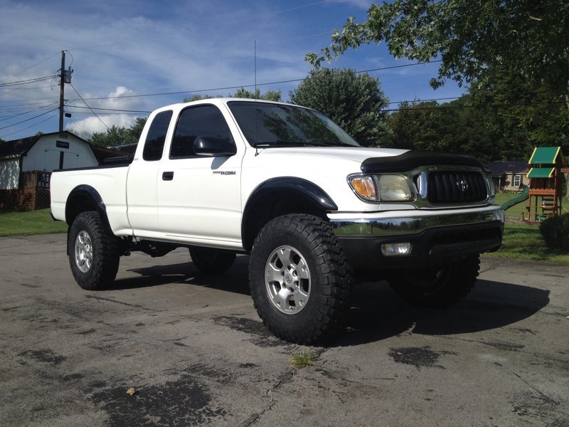

  16. Aug 25, 2016 at 11:38 AM
    #116
    rngr
    rngr [OP] Aix sponsa
    Jan 13, 2015
    #146258
    9,244
    01 SR5 4x4 2.7L

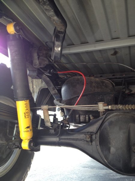

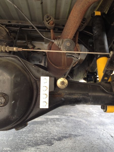

    Wheelers brake proportion bracket. My brakes feel like they did before, so i guess it's doing its job.
    Extended brake line. I was thankful the install went smoothly. I soaked the fittings in PB blaster in the days leading up to install and bought some flare nut wrenches. They came off without any issues. I borrowed a power bleeder from a friend. It worked great.
    Issues...
    My parking brake cable is resting on the dakars. There isn't a lot of tension on it, and the brake still works just fine, but I don't like it at all. I need to do a little research for a fix.

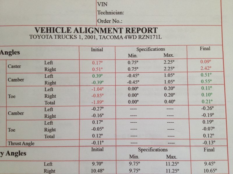

    My alignment didn't go as I had hoped. Holy cross caster. :eek: I'm set up for some serious road crown. Ha ha.
    I'm not sure what's going on here. My instructions were to set the camber at 0.5 and max out the caster. The man said he couldnt get any more caster on the driver side. Any ideas here?
    I plan to take it to another shop and get another opinion. I'm not too terribly worried because the camber and toe look good. I can live with the left hand drift for the time being.
