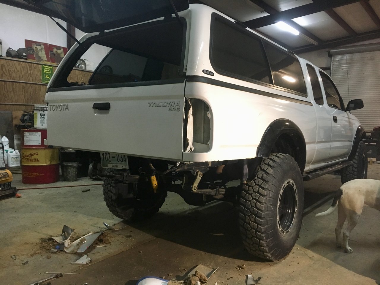

  2. Dec 14, 2017 at 8:51 AM

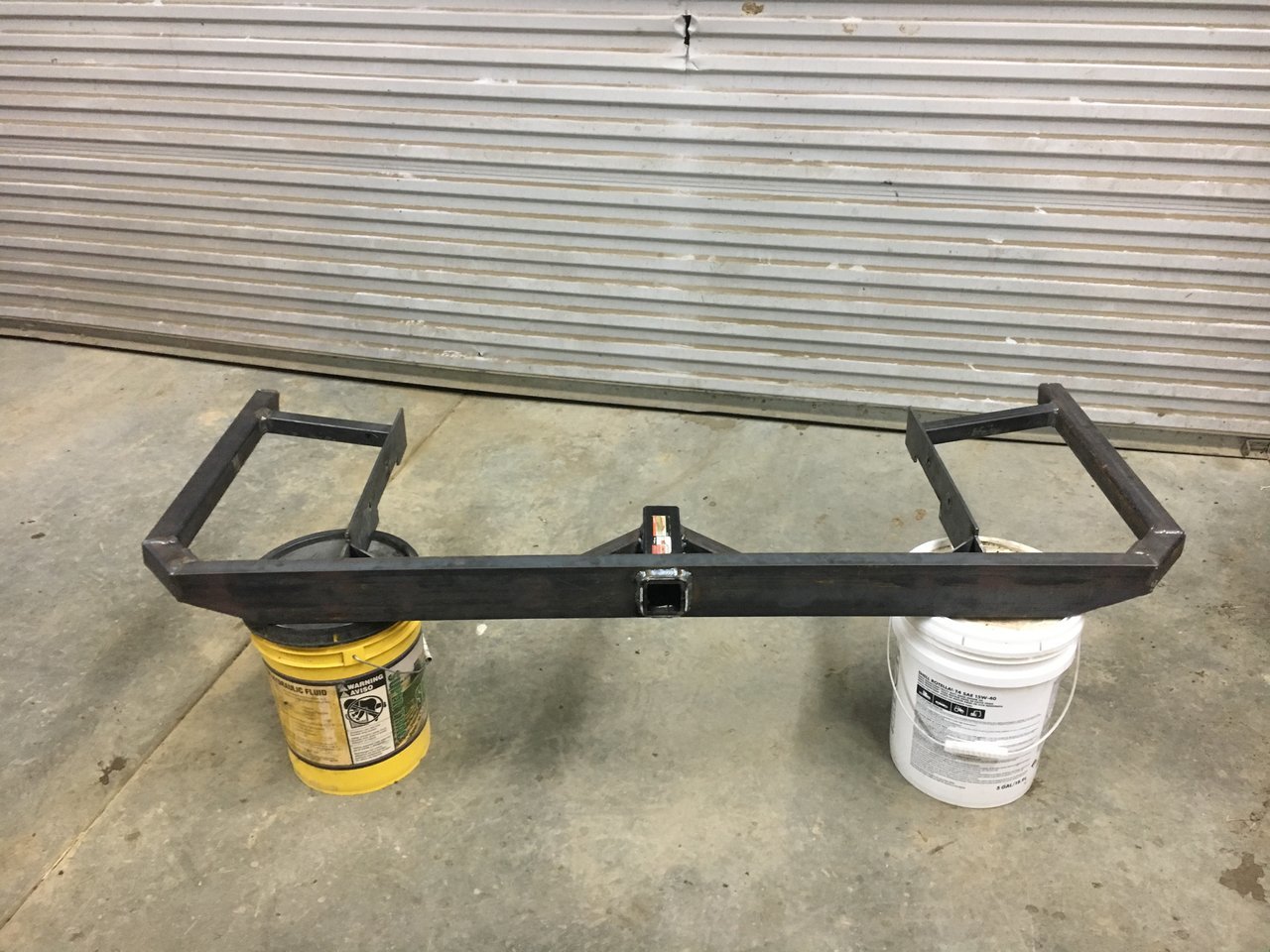

  13. Dec 14, 2017 at 5:35 PM
    #1433
    rngr
    rngr [OP] Aix sponsa
    Jan 13, 2015
    #146258
    9,244
    01 SR5 4x4 2.7L

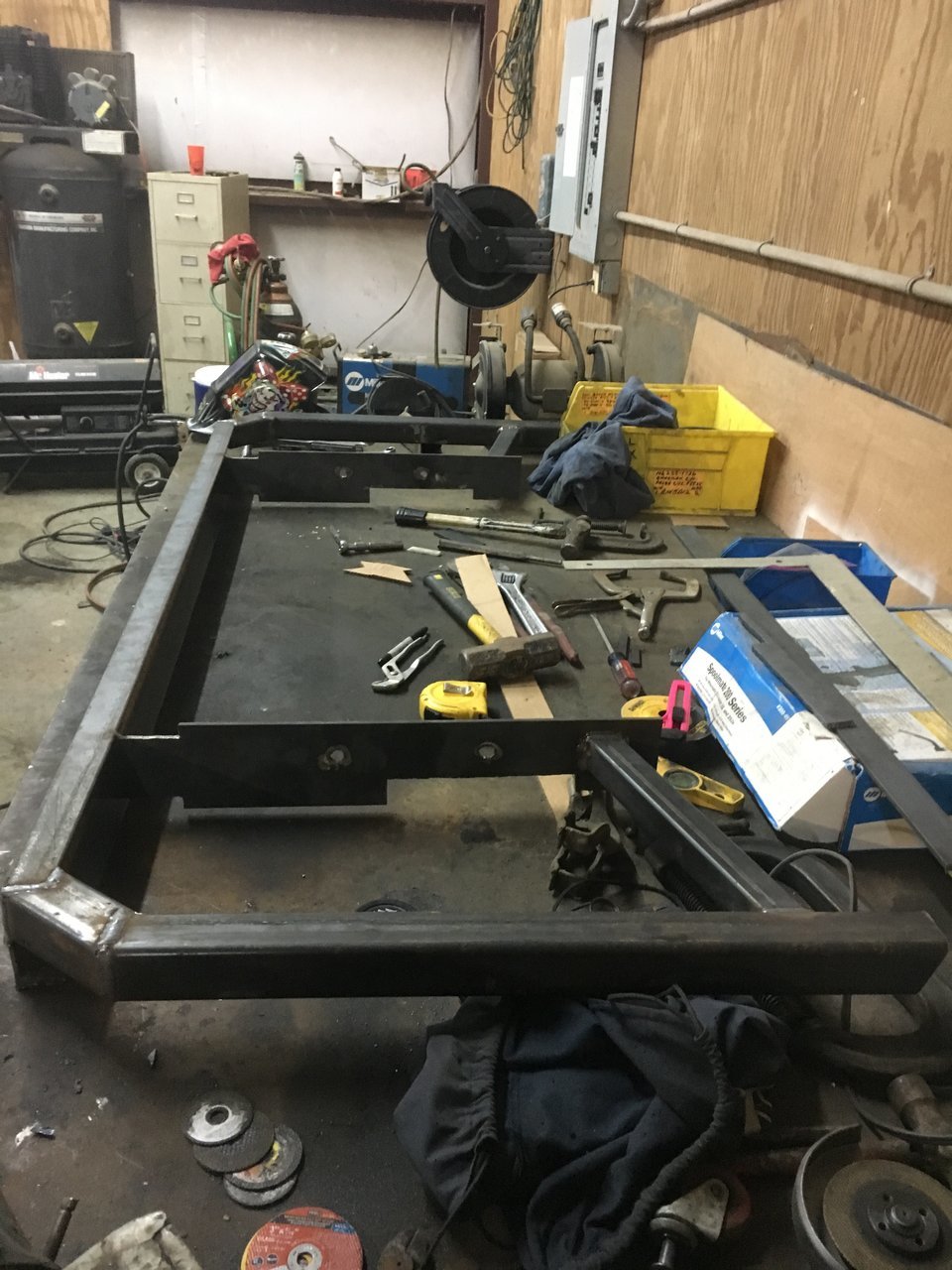

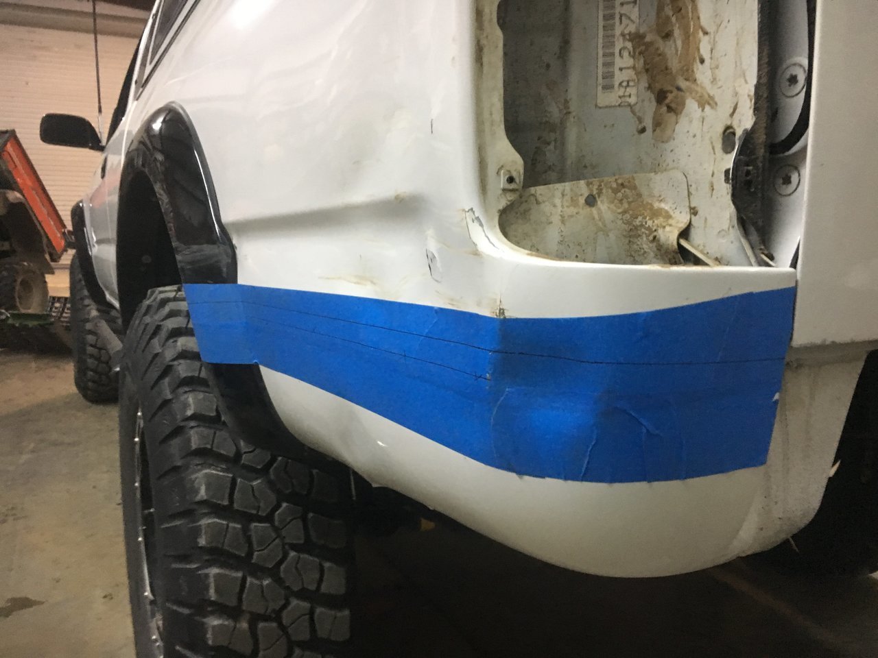

    Spent some time with a heat gun and a suction cup “fixing” the dent. Much better.

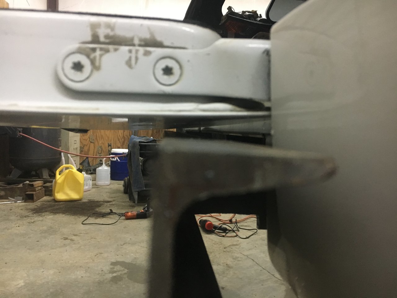

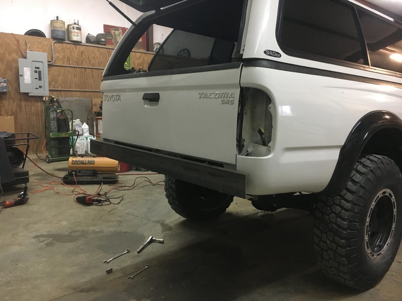

    Main channel in place to measure for cutting bedsides.

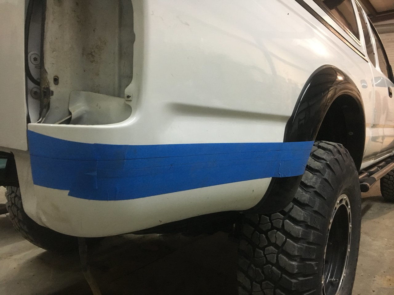

    Tailgate clearance
    Lots of guessing measuring.
    And done. The cuts look good, but the grinder was hard on the paint at the cut. Will put some kind of trim over it to hide it.

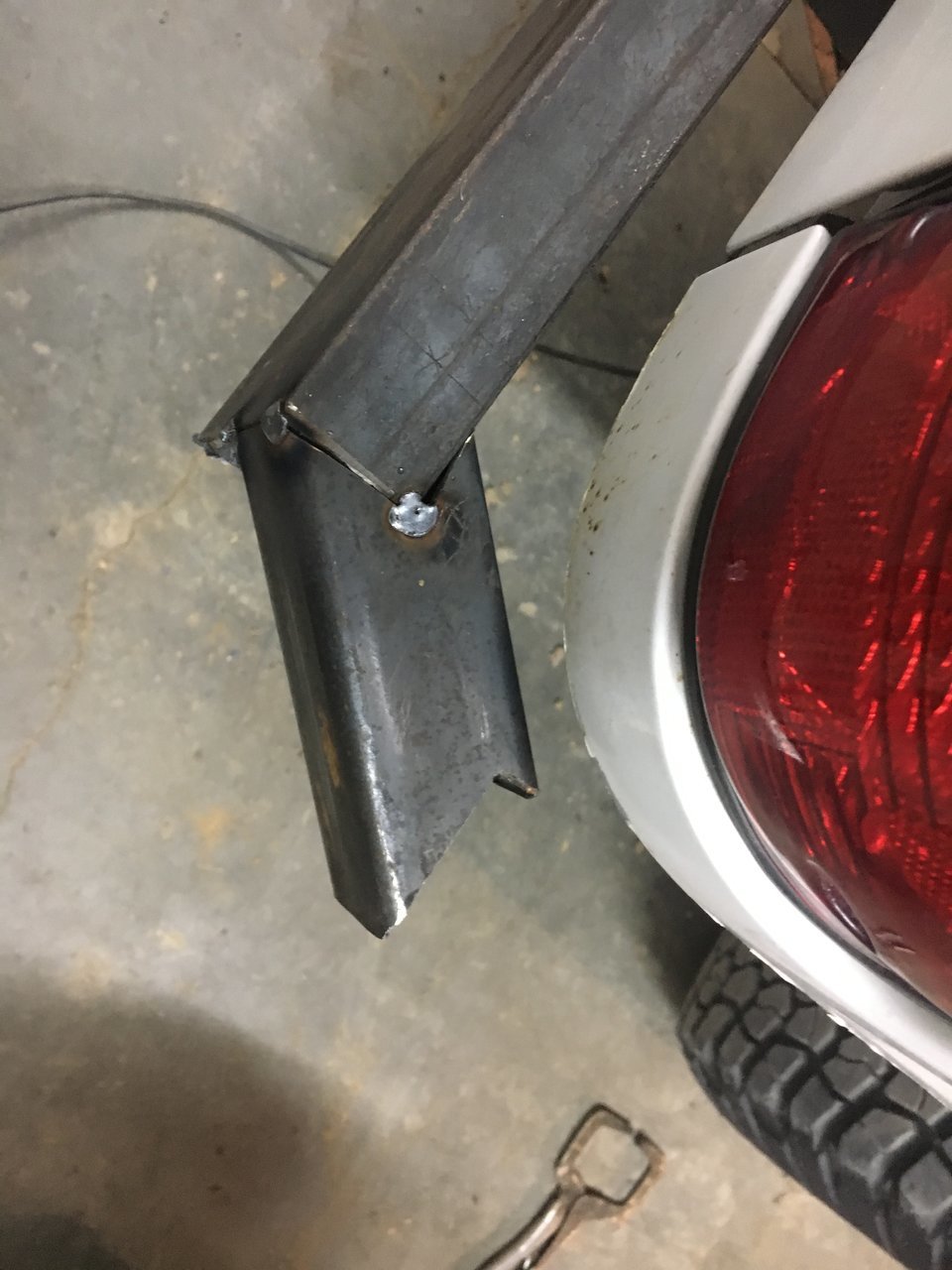

    Holyshit there is a lot of sheet metal in the corners. Took way longer than I thought. With that out of the way, I’ll cut the main piece down to length and start on the wings.
    Really thankful for my friend letting me use his shop/welder/plasma/and the list goes on. He’s also helping me with the fab and making sure I don’t mess it up. Haha. Good stuff.

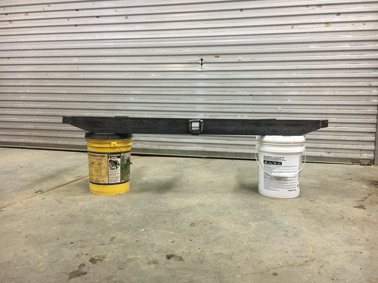

  15. Dec 15, 2017 at 7:10 PM
    #1435
    rngr
    Jan 13, 2015
    #146258
    9,244
    01 SR5 4x4 2.7L

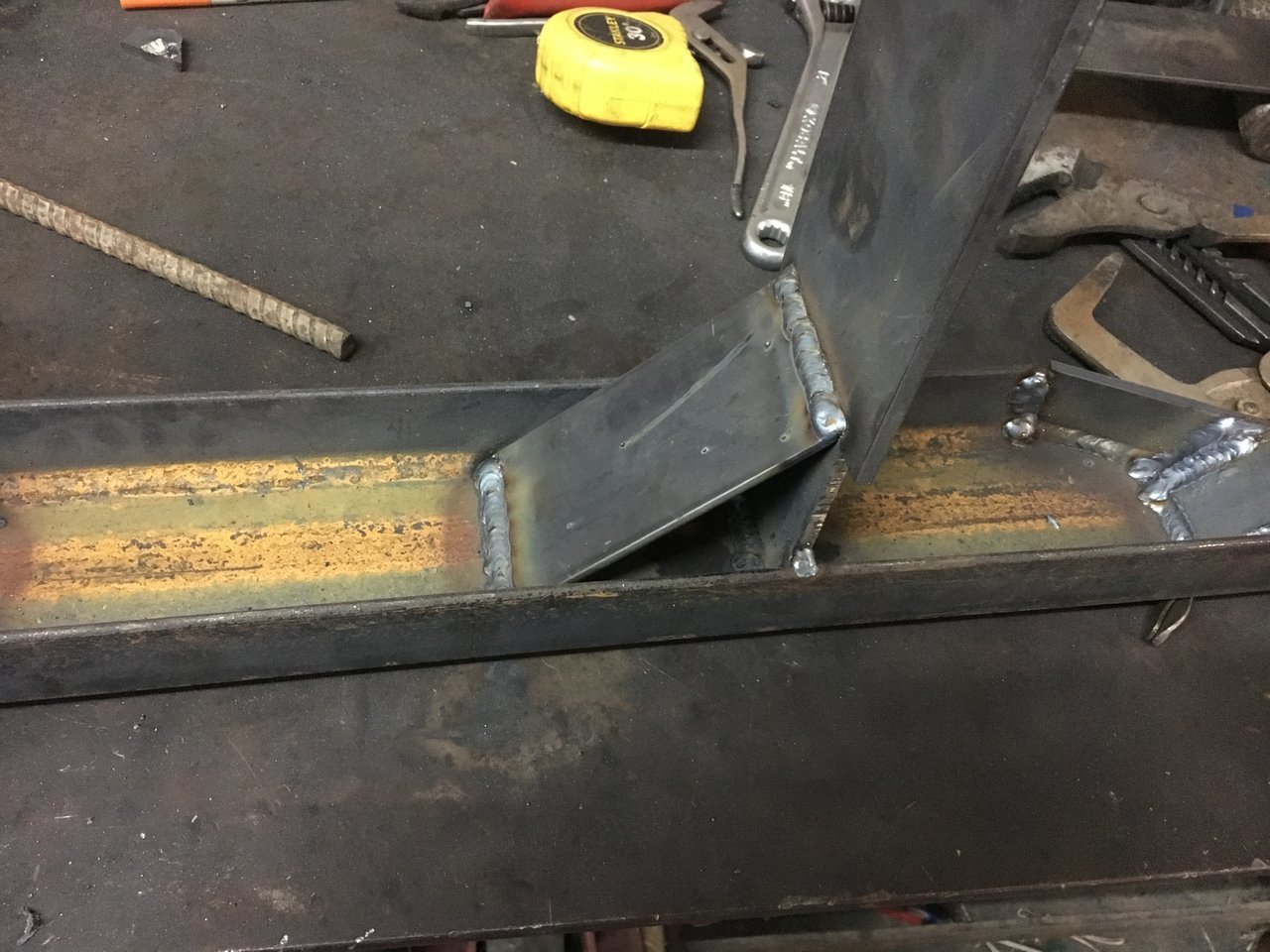

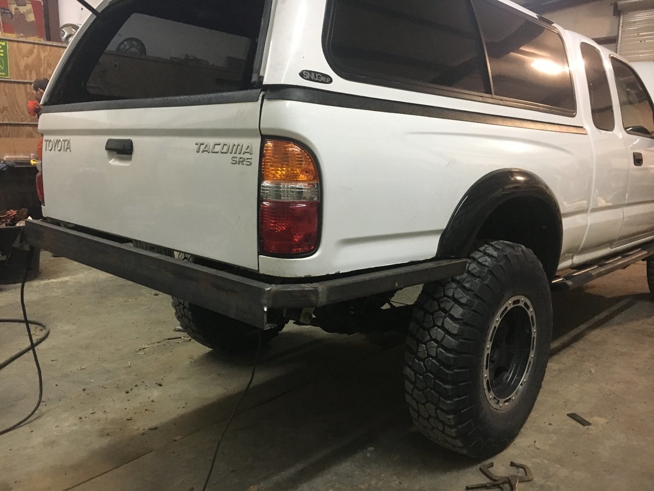

    Progress. Finished the wings and their supports this evening.
    Tomorrow’s venture will be tapering the channel iron down to from 4” to 2” where it meets the wings. Looks pretty stupid like it is now.
    Pretty excited about how it’s coming along. :woot:

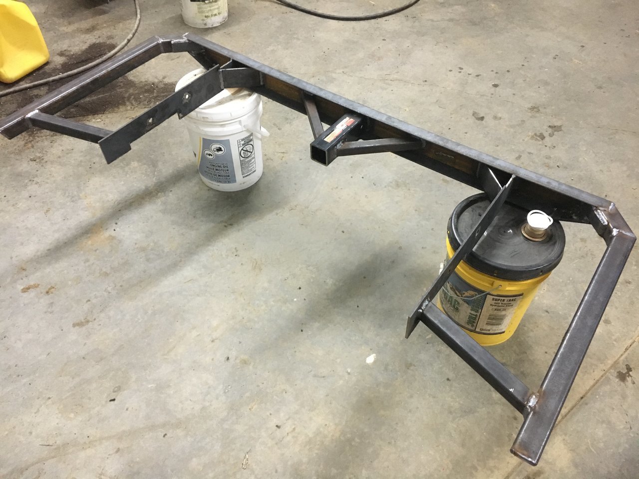

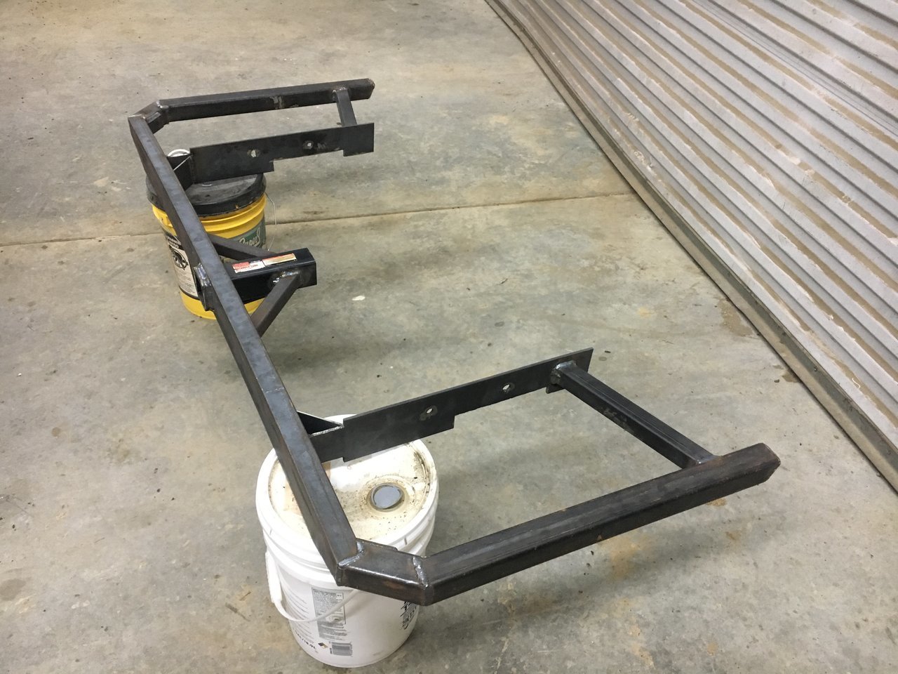

  17. Dec 16, 2017 at 7:12 PM
    #1437
    rngr
    Jan 13, 2015
    #146258
    9,244
    01 SR5 4x4 2.7L

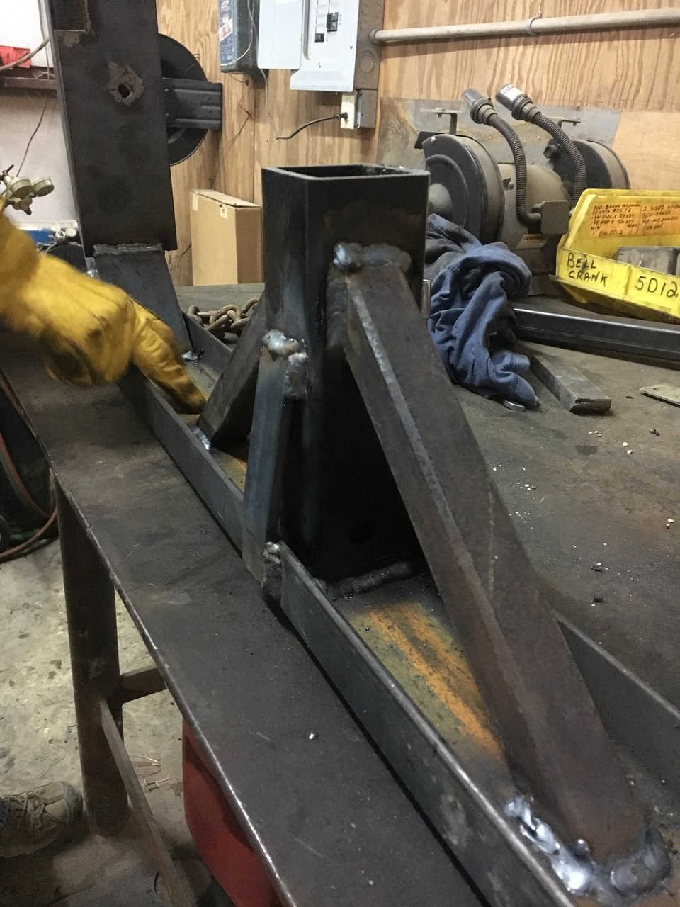

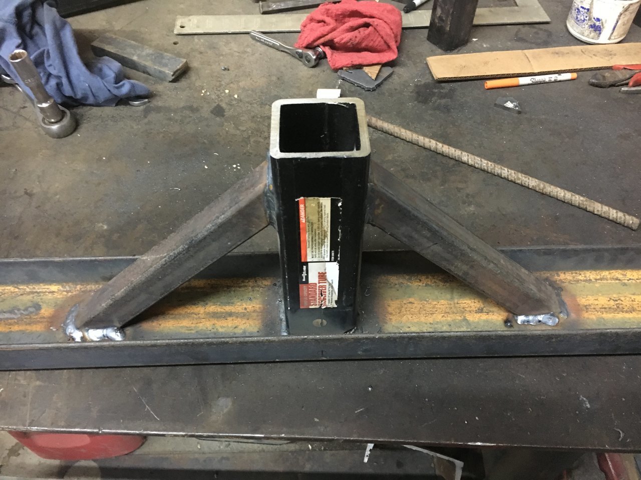

    Getting there!
    Having a local dude make a couple 1” thick x 2” wide shackle mounts this week.
    Also need to figure out the bedside hoops and find someone with a bender.
    Lots of grinding
    More grinding.
    Make a couple loops for trailer safety chains.
    Prime and paint.
