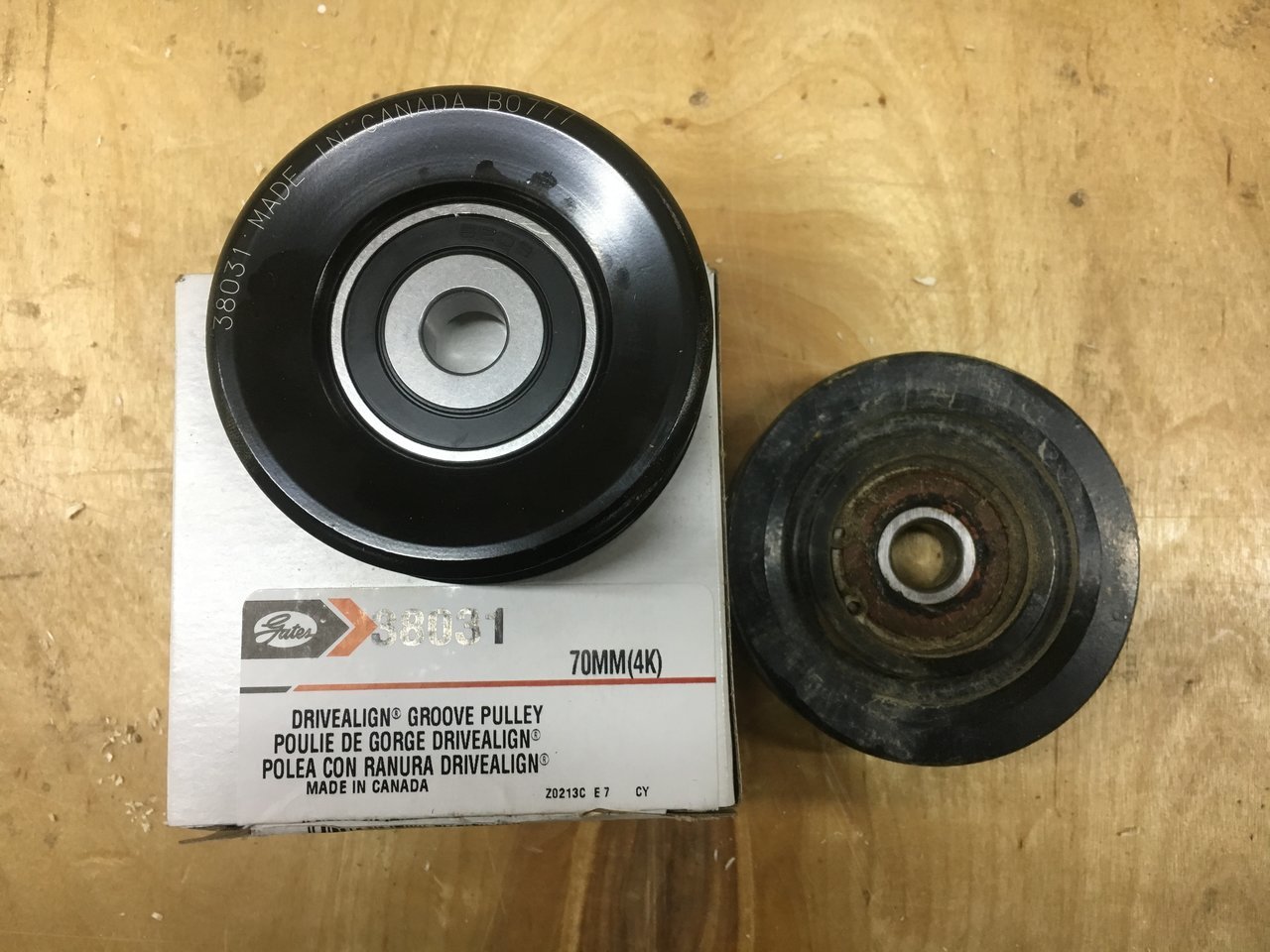

    Also changed my AC tensioner pulley and the PS tensioner. Same part for both. No more whine!
    Was actually the PS tensioner whining, but the AC had all kinds of slop.
