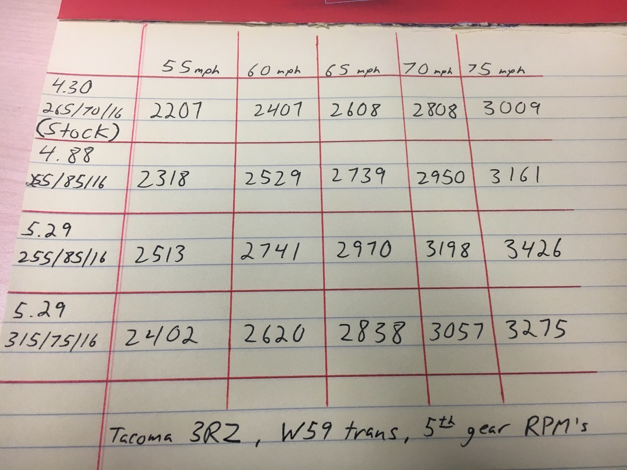

    I would not go to 5.29's on 33's. 5.29's is slightly over geared for 35's, and it's amazing offroad. However I sit at 3500 rpm's on 35's doing 75 and it jumps close to 4k doing 85-90. I can't even imagine trying to drive at 75 on 33's and 5.29's. 4.88's will likely get you to where I am at with my 5.29's. Great offroad but still can do highways with relatively no issues aside from raised RPM's.

    That’s what I read everywhere I look, but it is always on 6 cyl trucks so I’m not sure how it will translate to me.
    Also, no way in hell im driving my truck 90. Haha. I’m a 65-70 type

    Okay.
    So, i can tell you this.
    if you were an auto, id say 5.29s if you want it to be more of a toy truck. 4.88s for a good all around.
    As you are a manual and you are pretty dead set on 33s and the likelyhood of 35s is so low...4.88 is your mark. Now 5.29s would be cool, but holy crap your gears would be so short with 33s. And you probably wouldn't love it on the highway at all anymore.
    My vote is 4.88s. It'll still be overgeared and really help driving and crawling with the 2.7.
    If you still require a lower gear for crawling. Two things to go from there. 1) a ceramic clutch that will take lots of abuse from riding it. Ceramic clutches don't overheat nearly as bad. I can hold Frank in place on a steep hill, with just my clutch, and not kill the motor, by riding it just right. 2) get a crawl box. Nothing will give you more control then that.
    I know that blows up the budget a bit. But...well thats the name of the game :p
    I think with 33s and 4.88s you will be very pleasantly surprised and happy for a long while...if fact you'll probably have the same thing that happened to me. Lots of low end torque, not enough pure power though. Thus why I added the blower. Now my truck just..flat out hauls ass when i want too.
    4.88s and 33s are almost the exact same as 5.29s and 35s. This is with the r150 tranny mind you which has slightly different ratios. Considering your 1st gear is lower, i think you'll be good with the 4.88s provided you stay with 33s. It'll be great in the rocks and still pretty good on the highway, you likely won't have to down shift much if ever.
    Also, for what its worth about the grimm jeeper calculater. It was only half right for me.
    So it would tell me the rpms for a speed, like yours for instance at 70mph is 2950 with 4.88s. And that is true....in the sense that that is what your speed will indicate at that rpms. Your ACTUAL speed though, will be lower. My speedo for instance is almost 10mph off at 70mph. So I have to indicate 80mph to actually be going 70mph per GPS. So i can promise your RPMS will be higher than what the calulator is saying.
    So if you got 5.29s...your rpms would be insanely high just cruising around.

    Lots of good info. Thank you. That’s especially good to know about that calculator being off. Yea, if the actual rpms would be higher that that is showing that would be way too much

    I had an epiphany this morning. Something to the effect of "Stop being a bitch, Carter"
    5.29s it is. 35's when these wear out. I'm building a trail rig, not a DD/weekend warrior/overland bullshitter. 4.88/33s would be awesome, but I would end up wanting more. So there's that.
