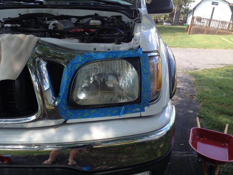

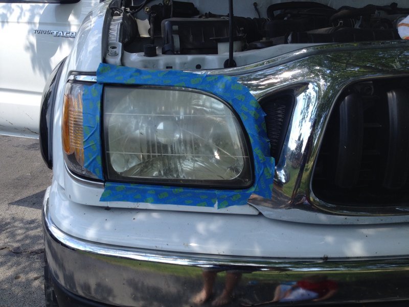

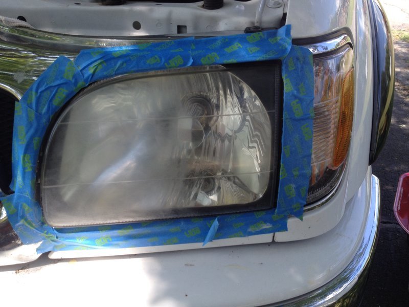

    My headlights were looking pretty hazy and yellow, so I cleaned them up. I used Meguires PlastX. I am very impressed.
    I taped off the lens so I didn't scratch my paint, sprayed the lens with water, and sanded it with 800 grit wet/dry sandpaper, followed by 2000 grit. Then, you simply polish the lens with the PlastX.
    Before
    During. Notice the difference between the left and right side of the lens.
    After
