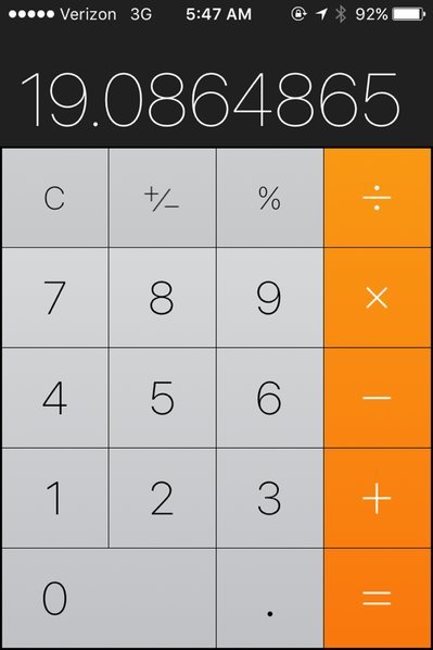

    I measured my mileage on the first tank of gas with the 255's. 19 mpg adjusted for the effect of the larger diameter tires on the odometer. I couldn't believe it. Ha Ha. 4 banger FTMFW!

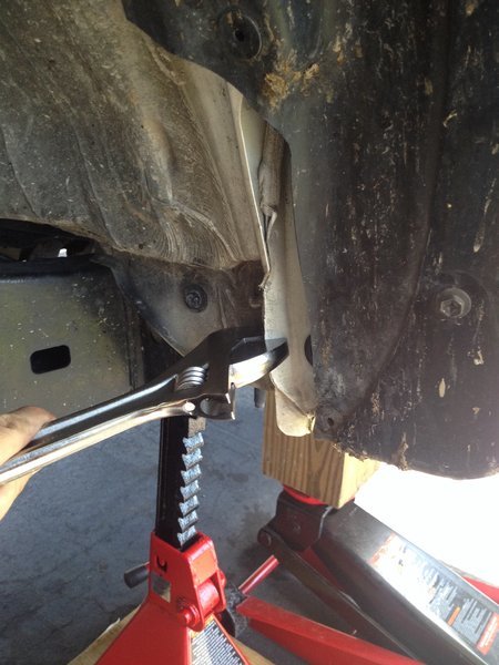

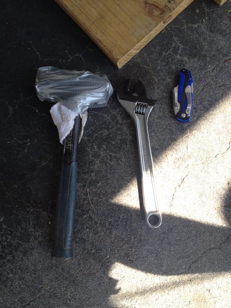

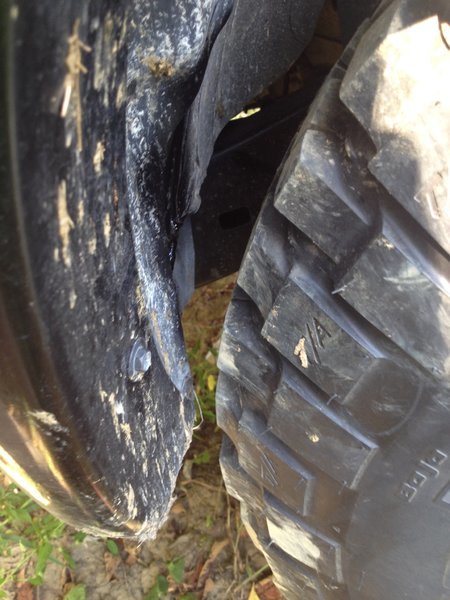

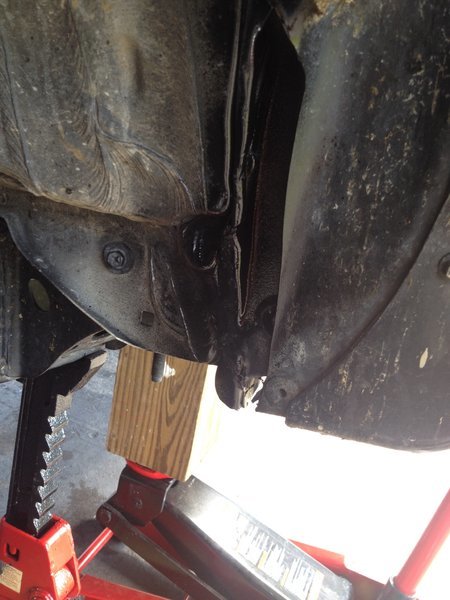

    Pinch weld mod time.
    This was a very simple task. Maybe 30 minutes start to finish. I used a razor knife, big adjustable wrench, and a BFH.
    Cut the plastic fender liner to reveal the pinch weld.
    Bend the weld over with the big wrench.
    Flatten it out with the hammer. I taped a rag around the hammer so it didn't mess up the paint so bad.
    Despite my efforts, I boogered up the paint a little so I hit it with a rattle can.
    aeok18109, Crom and BYJOSHCOOK like this.

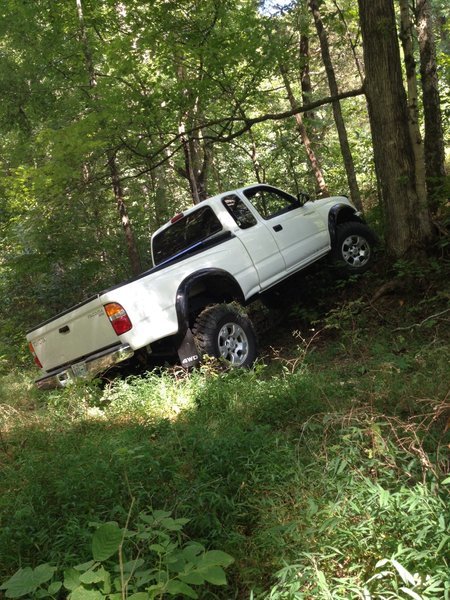

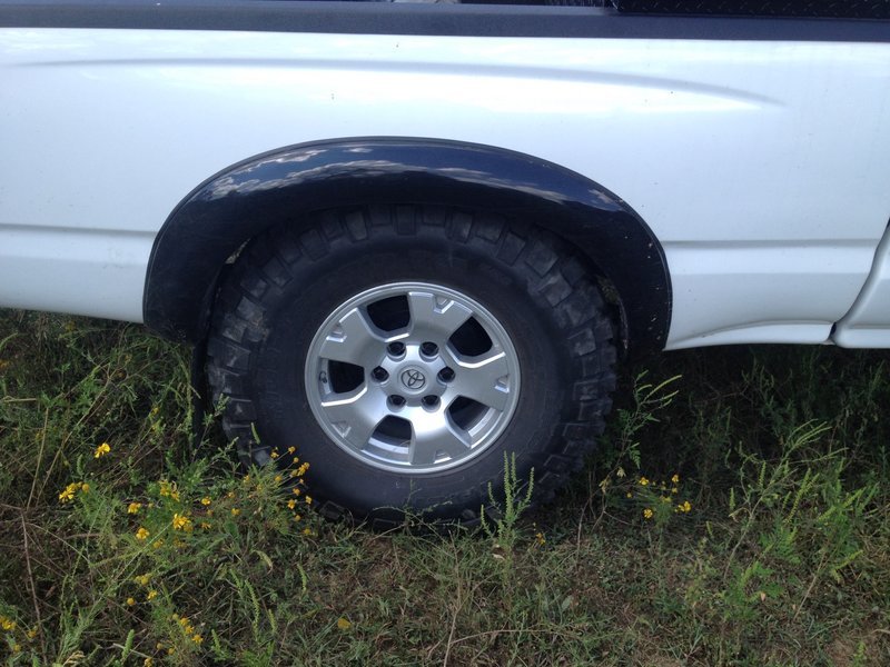

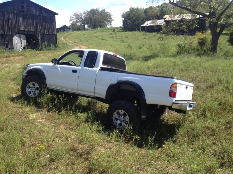

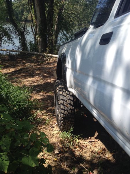

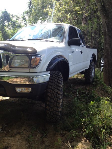

    Went out and played around a little to see if I have the rubbing issues fixed.
    The fronts clear beautifully except a very minor frame rub at full lock. Not worried about it. The rears will rub the flare bolts when completely stuffed. I'll replace them with flat head screws.
    Crom, Dave41079 and BYJOSHCOOK like this.
  18. Sep 10, 2016 at 3:40 PM
    #178
    rngr
    rngr [OP] Aix sponsa
    Jan 13, 2015
    #146258
    9,244
    01 SR5 4x4 2.7L

  19. Sep 10, 2016 at 3:41 PM
    #179
    rngr
    Jan 13, 2015
    #146258
    9,244
    01 SR5 4x4 2.7L

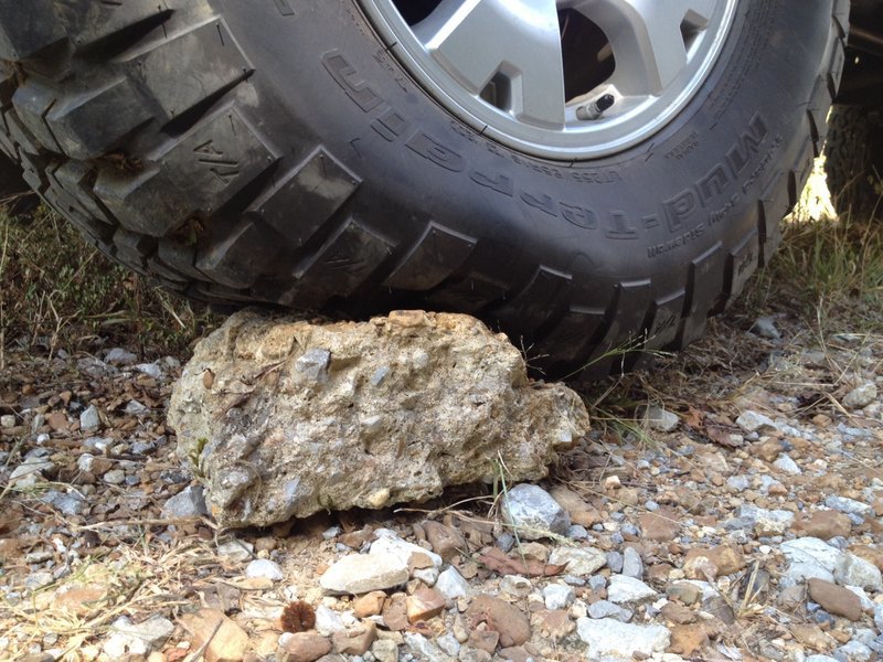

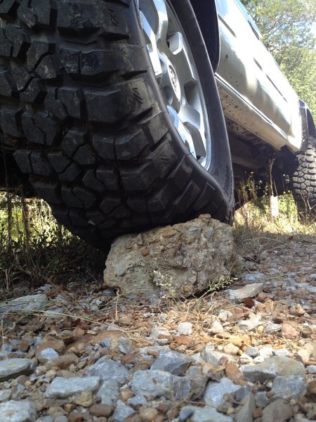

    Little flex
    ^^That departure angle :rolleyes:
    jubei, Dave41079, BYJOSHCOOK and 2 others like this.
