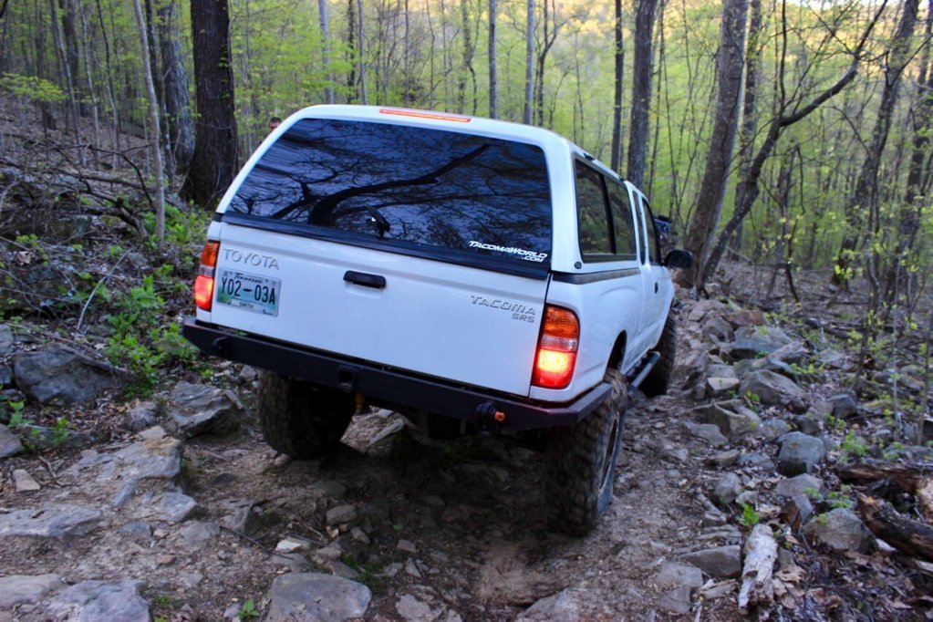

    AOP was awesome this weekend. Had a ball with old friends and made some new ones. The weather was perfect, the truck did awesome and came home in one piece.
    I dropped down from my usual 15psi to 12. Felt fantastic.

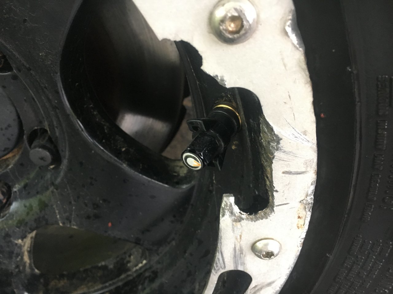

    I did shred a valve stem on George Winter Trail. @JBTacoma had one of these, thankfully. Installs from the outside. 5 minute job. I’ll definitely be adding these to my trail repair supply. Thanks, Jeff!
    My bedside got intimate with a tree at one point, but it’s just a flesh wound.
    Stand by for wheeling pics...

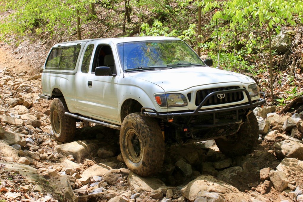

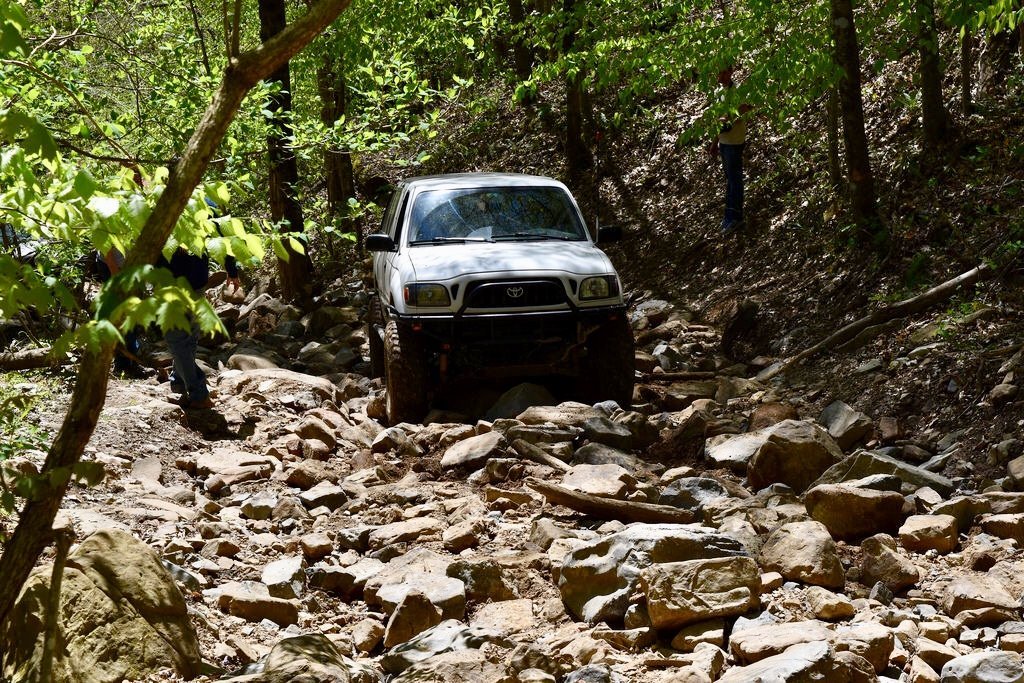

    And another shout out to @PvilleJohn For some photo skills.
    Thanks again.

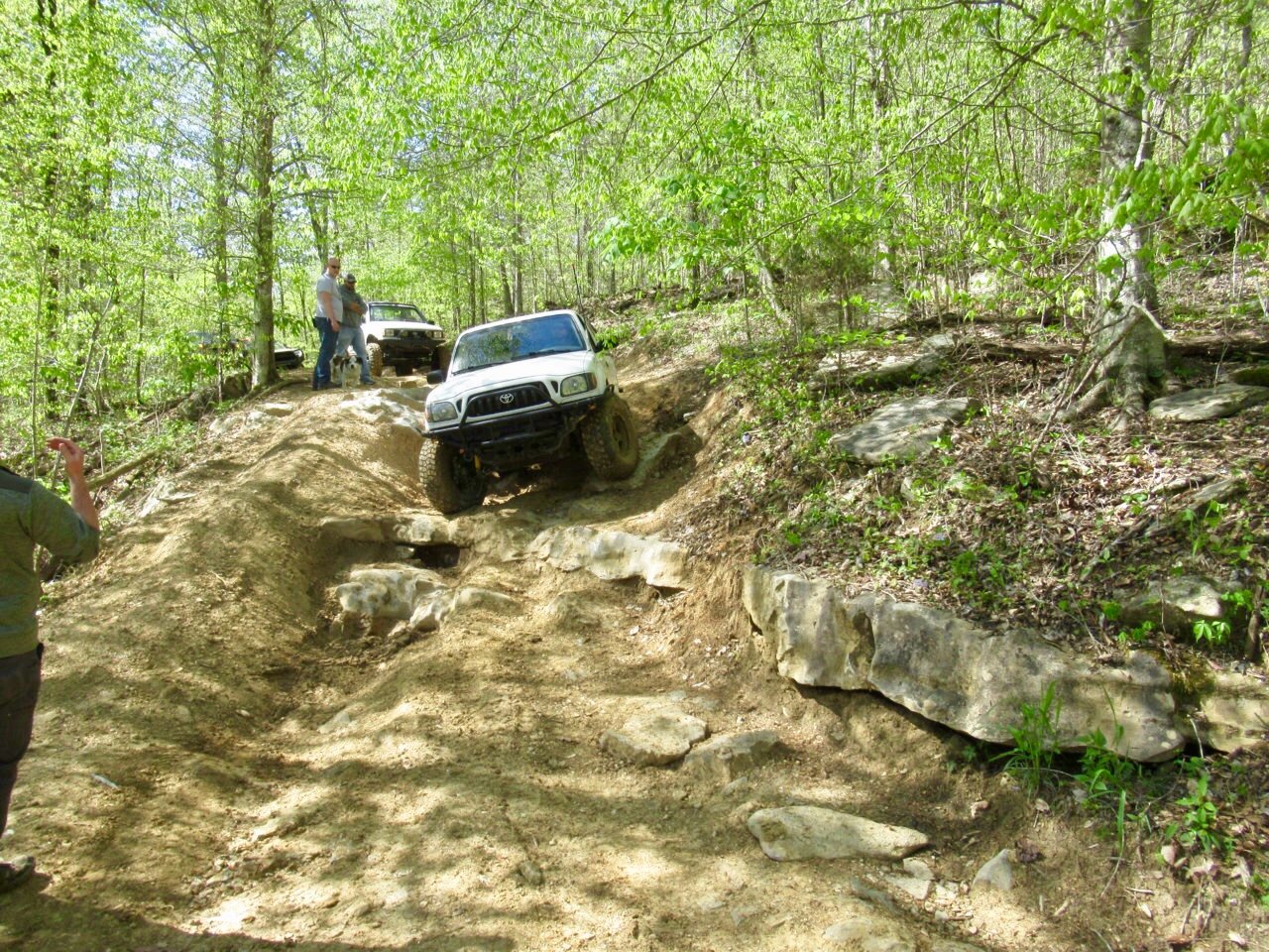

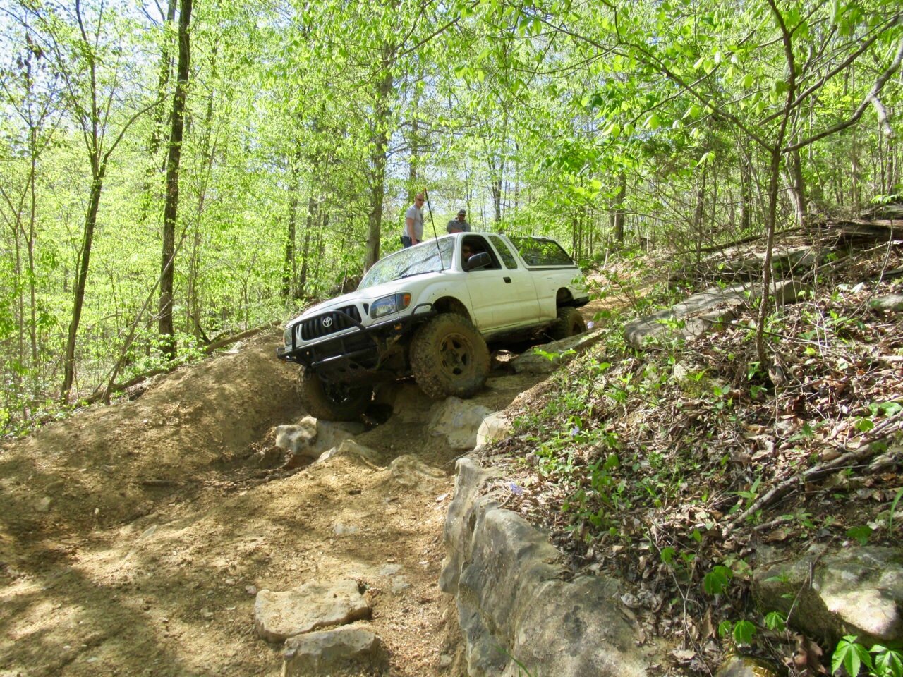

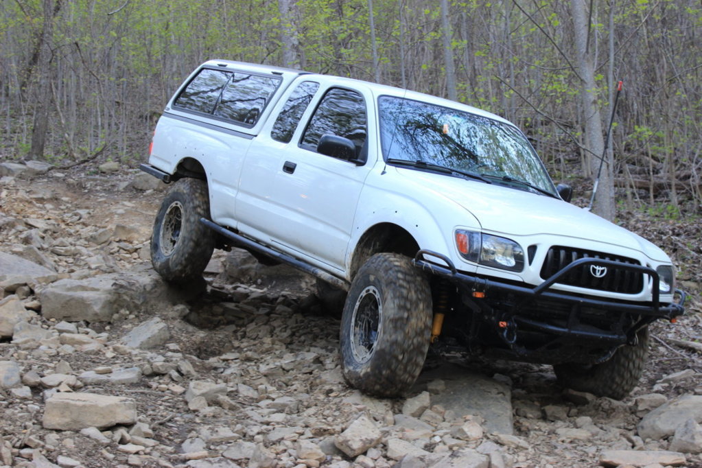

    @JimboAnz captured the big drop-in of trail 41. That was a good one. It was good to meet you! Hope you get your rear end nursed back to health soon. o_O :cheers:

    How much tubing did you end up using for your rear bumper? Got a friend that is going to get me a deal on some steel so I can build mine

    To be honest, I don’t exactly remember. I’ll grab some measurements off the truck and try to give you a better idea. It wasn’t a lot though. Everything I used is in the bed here.
    Also used some 3/16 plate I had laying around for gussets.

    @Justinogo
    Have 62” of the 2x2 tube total between both wings.
    The 4” channel iron across the back is 62” as well.
    48” of 4”x1/4” plate for the frame plates
    2’ of 1.5”x1.5” tube for the wing supports
    2’ of 1.25x1.25” tune for the hitch supports
    About 1’ of 3/16” plate for the frame plate gussets
    These are measurements from the truck. Buy al little extra.

    The metal won’t be expensive. I have $56 in steel in mine.
    I HIGHLY recommend finding access to a plasma cutter and bandsaw if you can. Can’t imagine doing it all with a cutoff wheel.

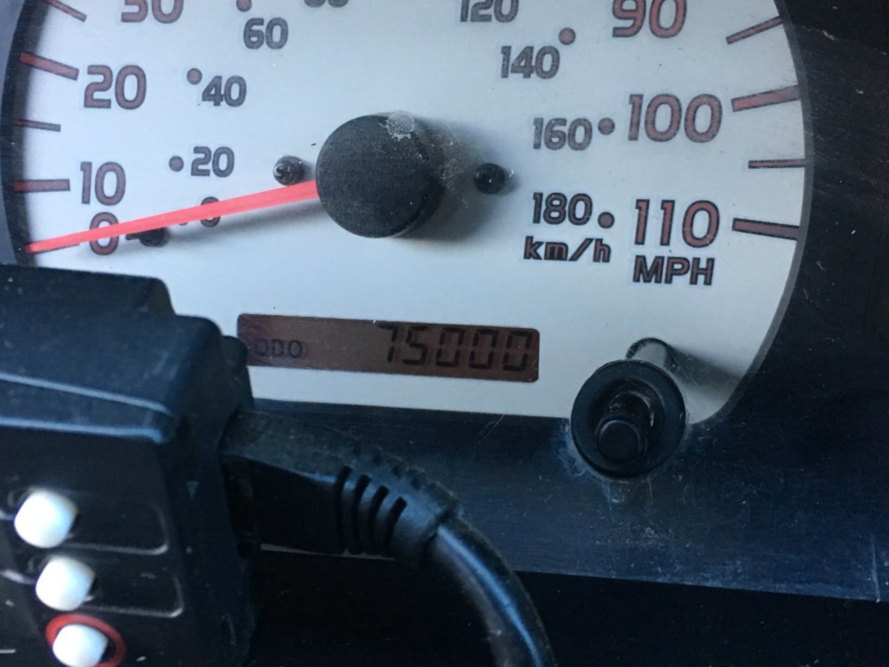

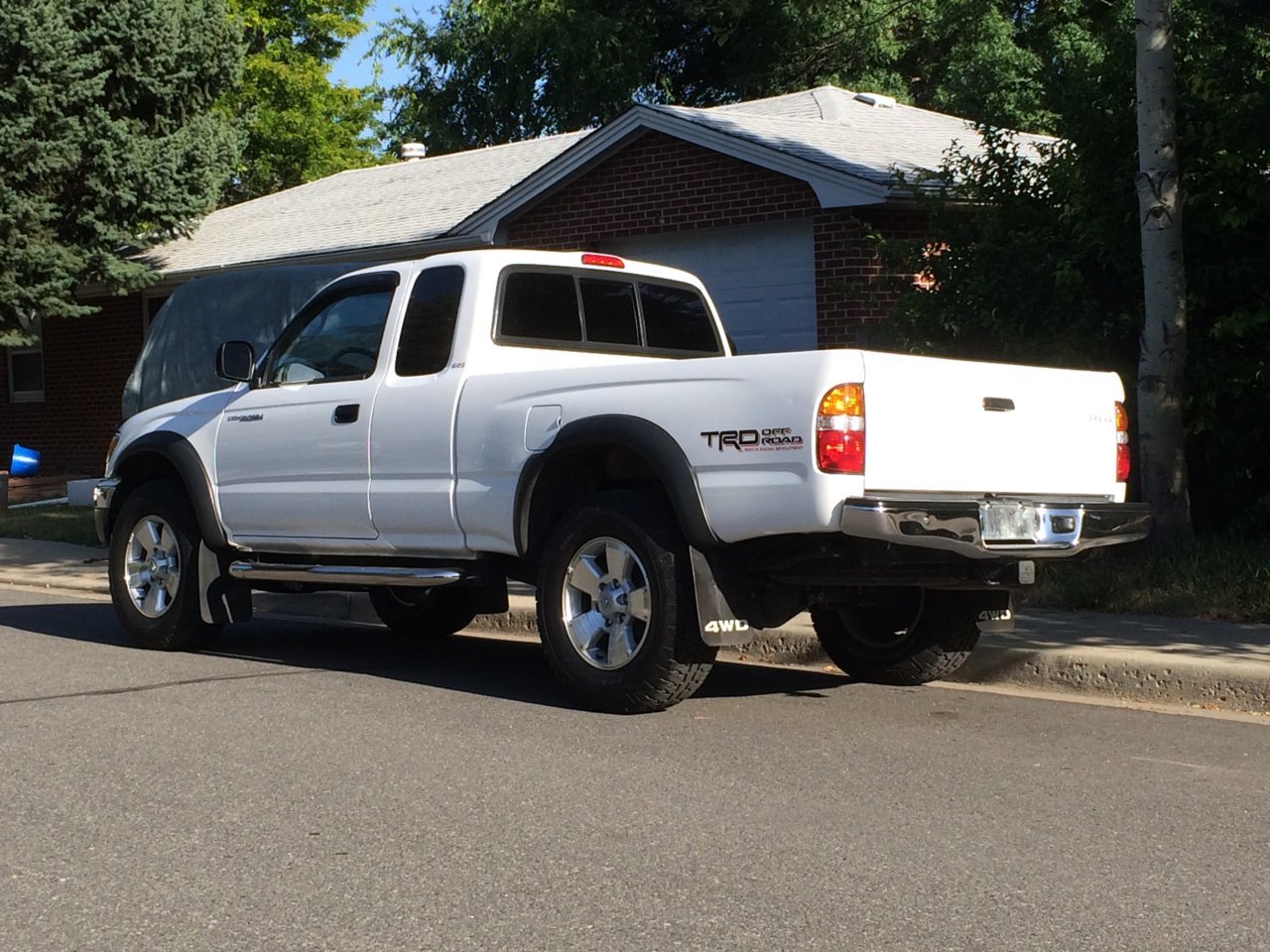

    :eek: Holy shit! That's low
  18. Jul 21, 2018 at 5:30 PM
    #1878
    rngr
    rngr [OP] Aix sponsa
    Jan 13, 2015
    #146258
    9,244
    01 SR5 4x4 2.7L
    Shoulda seen it when I got it 2 years ago. 54k miles and immaculate. She was a beauty.

    Goddamn, that’s half the mileage of anything in my crusty fleet.

    Hell yeah!
    Mine had 55k on it when I picked her up! Sitting at 72.5k now.
