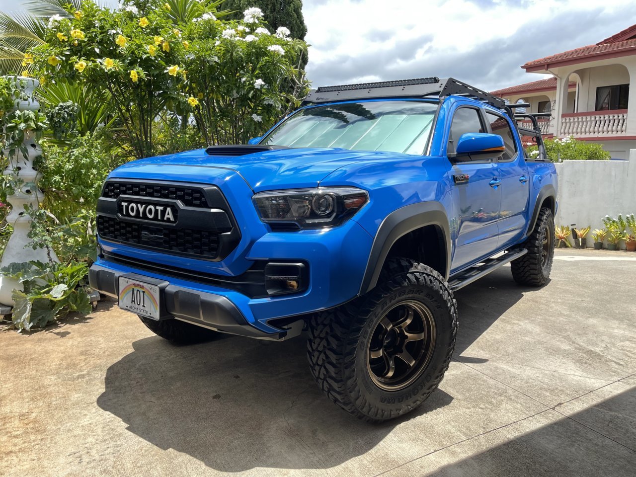

    Was able to work on the truck this weekend. Because the truck is a pro and wanted to use the OEM Fox shocks it came with, I went with and Installed Westcott Designs lift in the front and Icon Progressive AAL in the rear. Also went this route because if I go any higher, I wouldn’t be able to park in the garage at work. Did the install over 2 days, 10 hours total
    Here’s the front and rear lift I used
    Started with the rear on Saturday.
    Had to cut rear clip and grind off the rivet since it was in the way of the AAL. Sorry forgot to take a photo of the AAL installed, but I was able to complete it.
    *Note - I ended up trimming the ubolts about 1/2” because my deep socket couldn’t reach to torque it down. Instructions called for 120Ft/lb to be torqued but i had such a hard time, even doing it progressively. Got as high as 105ft/lb and called it a night.
    Installed the Front on Sunday...
    No press or bench vise? No problem! Improvise with CMU blocks.
    Spring compressed to put back top hat..
    Cleaned up and strut back in the truck!
    This was height before....
    This is height After....Monday out for alignment!

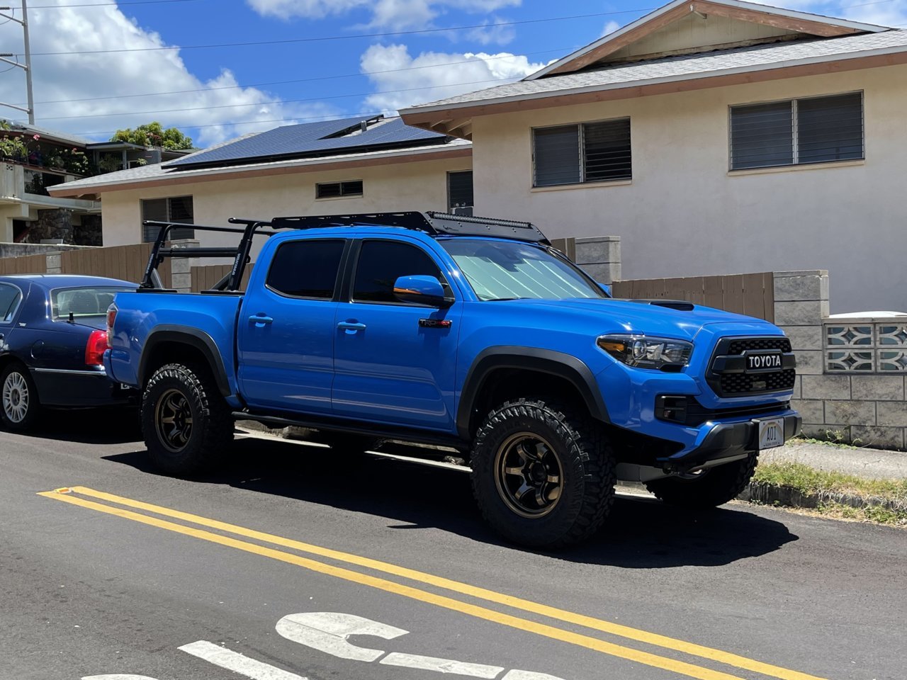

    Over all I am pleased with this set up. Truck seems more planted and I can even hang turns and the body roll has been minimized a lot with this lift. I gained exactly 1.5” all around front and rear. Had the caster set to 2.6-2.7 since ill be going with bigger tires.

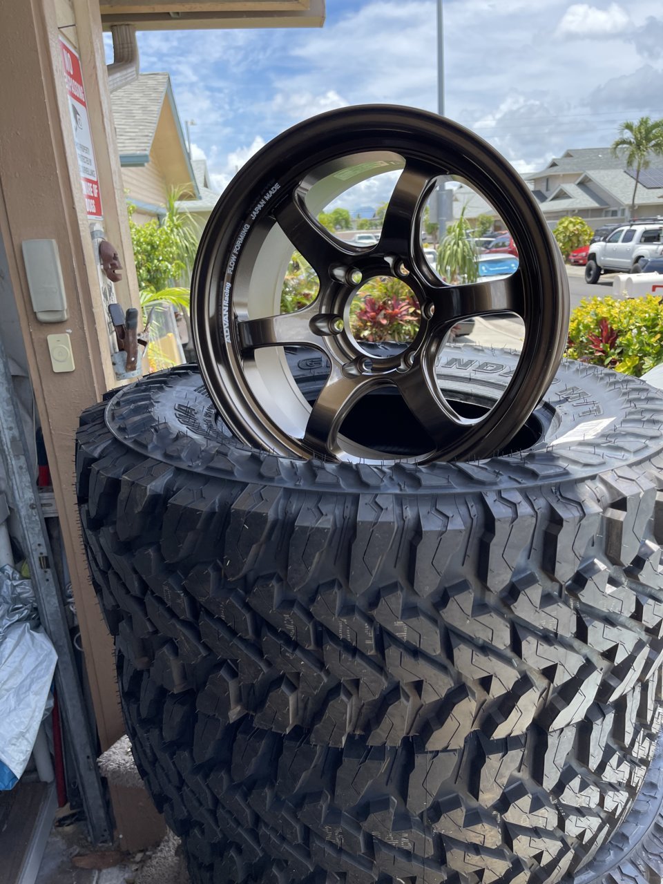

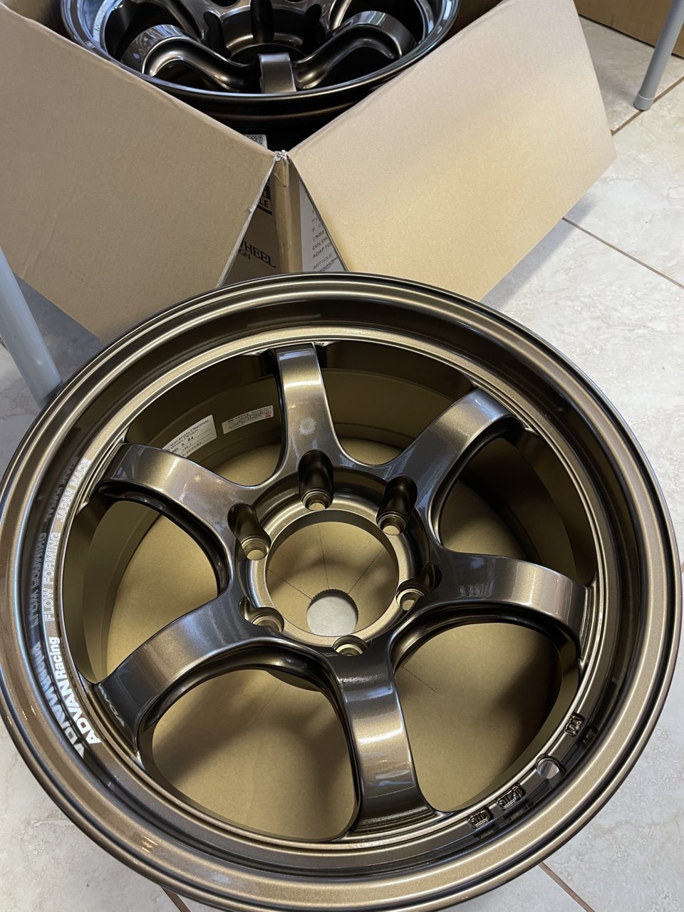

    Been awhile since I’ve updated this. Turbo wise, got news it’s being prepared to get get shipped. still waiting for confirmation.

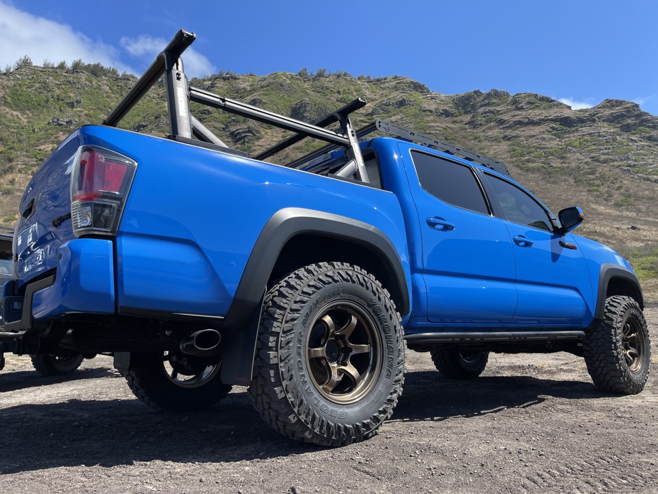

    Wheels finally came in that I ordered back in December, Advan RGD2 in Umber Bronze wrapped In Yokohama Geolandar g003 295/70r17. No rubbing with my setup. Turned out better than I envisioned. Truck sittin pretty!
    next on my list will probably be a BBK. Any suggestions @Torspd?

    Those wheels look so mean. With top notch quality behind them. I just wish they did more 6 lug sizes. Perfect contrast with the blue.
    Cannot go wrong with Stop Tech or Wilwood.

    Yea I love these wheels. Im so glad I went with these. Everyone on the island is running TE37x.

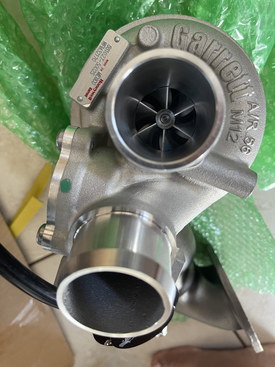

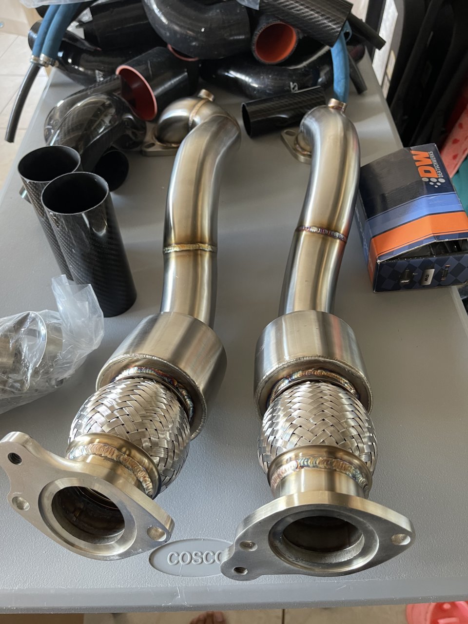

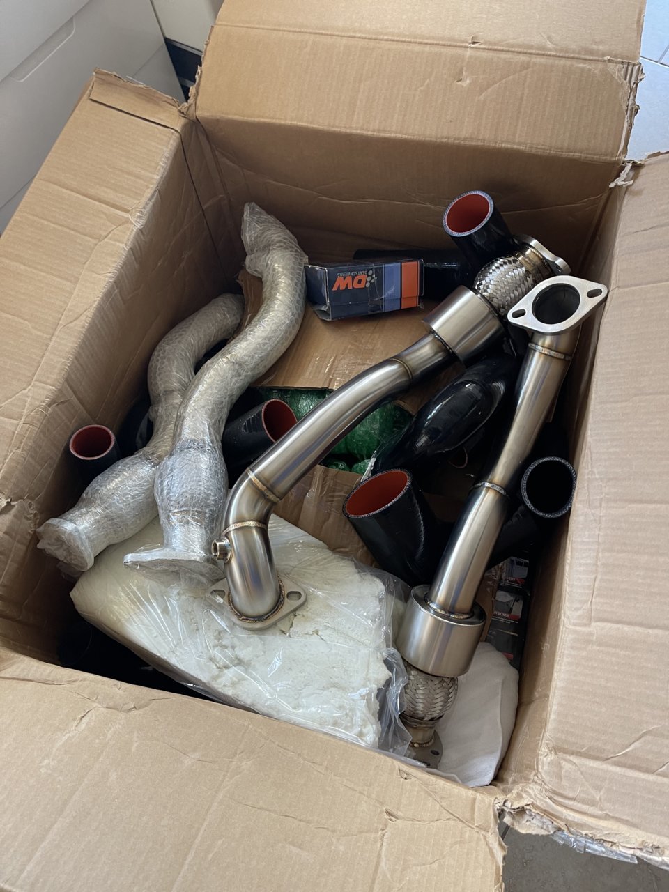

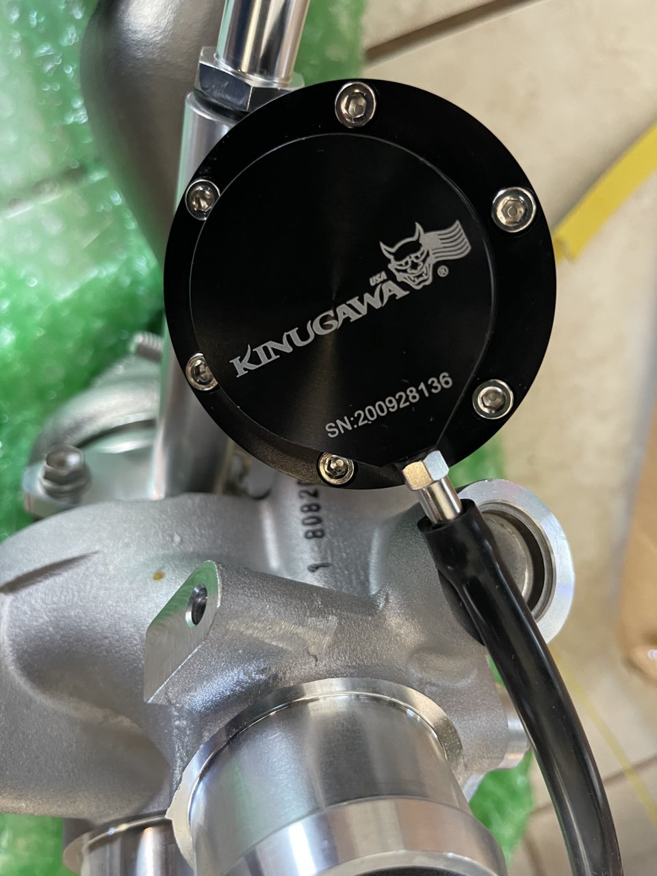

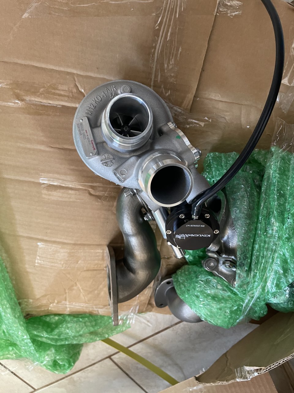

    Things just got real!! My TT kit showed up last week. Some photos here. I won’t install til I have base tune file since truck is my daily. Will have to plan accordingly.
    It Came with catted and decatted downpipes.
    Formidable, Impoy47 and Torspd like this.

    Mmm goodness! I bet it is a little hard to maintain your excitement from installing it.
    RedLantern[OP] likes this.

    Congratulations! Looks like high quality parts. Hope all goes well and you enjoy some Boost real soon.
