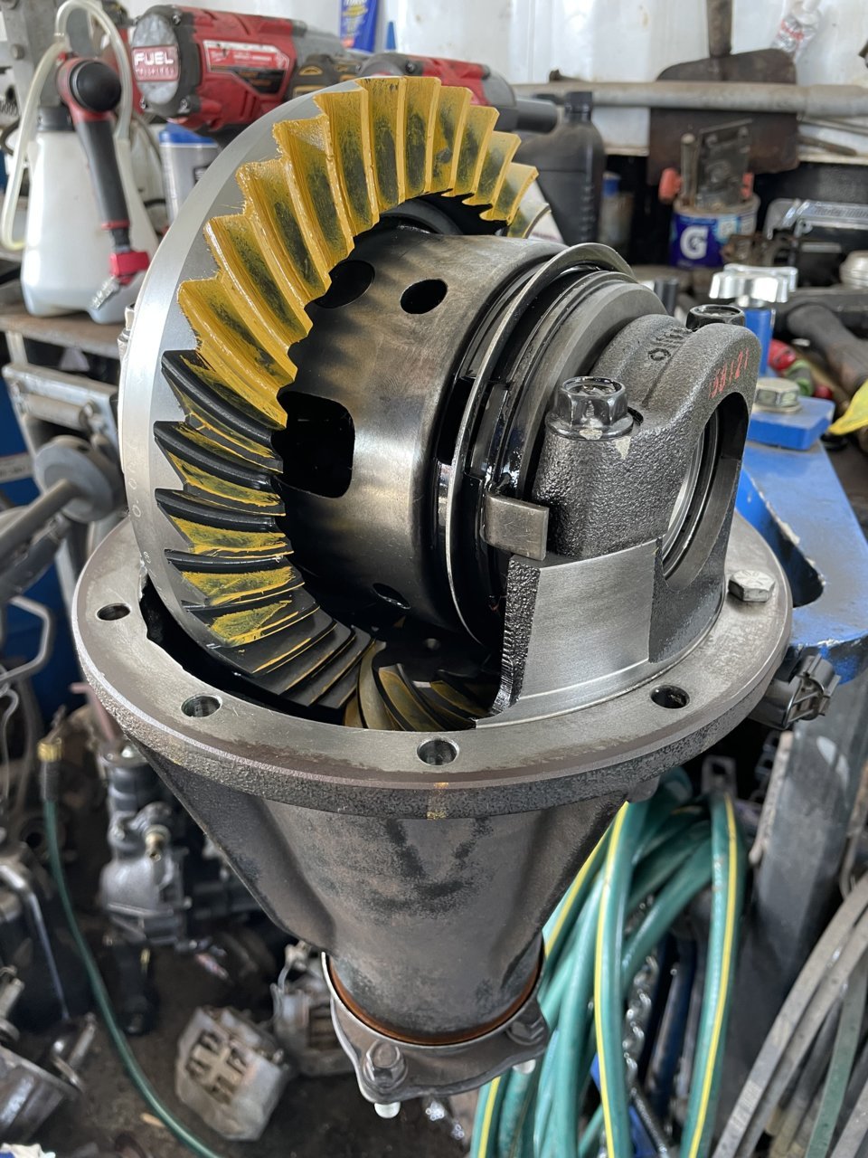

    Not much updates other than finally getting some gears done! Went with Revolution Gears 5.29s. Such a difference!

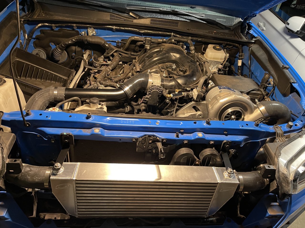

    2019 TRD Pro Tacoma - Voodoo Blue / 06 double cab PreRunner Turbocharged (sold)
    Just started my install today on my truck. Prior to install I did a quick overview on the parts by bag and all the labeled bags were there. But during the install as I got up to the point of mounting the bracket /blower to the motor, I noticed I was missing a 3/8 x2 1/2” bolt that went into the sub bracket to help support the main bracket. I swear I checked like 10 times for that bolt but it was no where to be found as I’d open each bag systematically according to the instructions and laid out on a table and magnetic pan so I know I wasn’t going crazy. So Took the sub-bracket off and went to auto parts store and nothing fit as the pitch was different. So my solution was to buy a tap and retapped the sun-bracket to the proper pitch bolt that they had in stock. Took my time and worked like a charm to fixed my issue. Wasted 2 hours over that hiccup and should have been done with the install. Got as far as the plumbing done. Just need to wrap up intake side, battery relocation, fuel pump booster, and spark plugs.

    Woot woot! That looks good in there! Hurry up and take it for a rip!

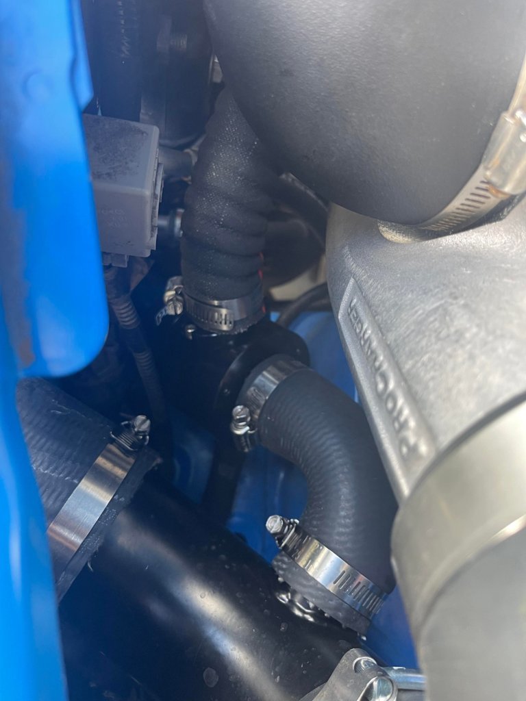

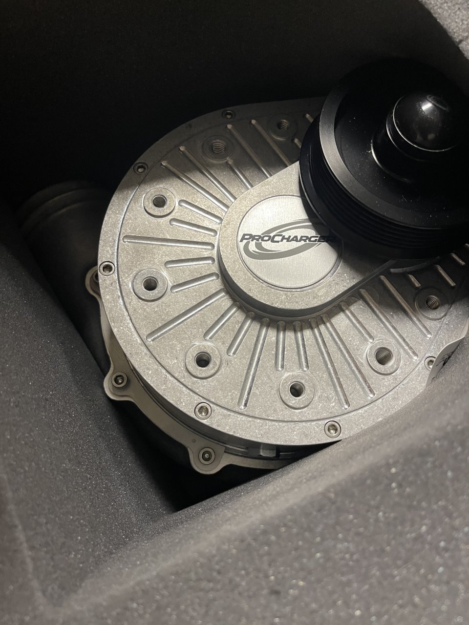

    Any pics of your surge valve placement or close ups straight down above the procharger?

    1,777
    Honolulu, Hi
    Torspd likes this.
  18. Dec 16, 2024 at 11:45 PM
    #98
    RedLantern
    RedLantern [OP] Well-Known Member
    Dec 7, 2012
    #92641
    1,777
    Honolulu, Hi
    let me take a look. need to find it
  19. Dec 17, 2024 at 8:17 AM
    #99
    Frontierfreak
    Frontierfreak Well-Known Member
    Jul 27, 2016
    #193045
    134
    Awesome thank you!

    1,777
    Honolulu, Hi
    here you go. Sent it to your IG also.
