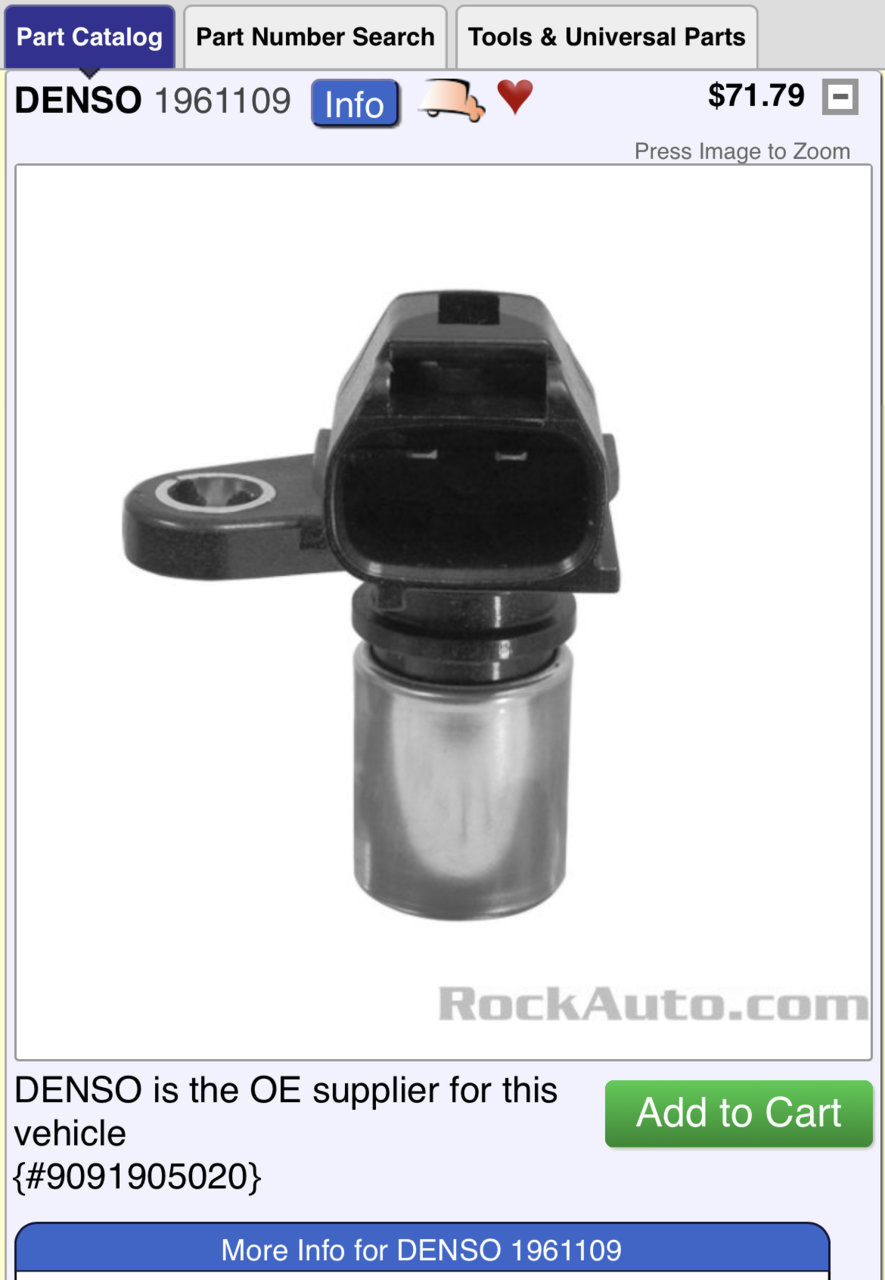

    Is this the one you’d get?

    Can the same sensor be used for cam and crank sensor??

    denso yes. the cam sensor is different.

    I’m not finding a denso camshaft sensor? On rock auto or the denso website

    why are you buying a camshaft sensor? just do the crank.

    I was going to have them sent at same time and send cam sensor back if crank worked. But I’ll try the crankshaft since I can’t find the camshaft sensor.
