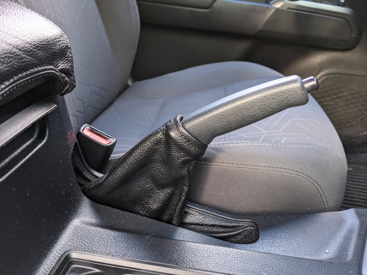

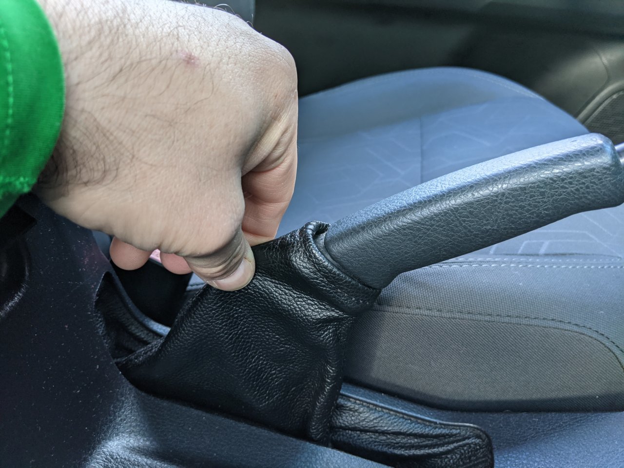

    Sorry for the delay. Here's the pics.

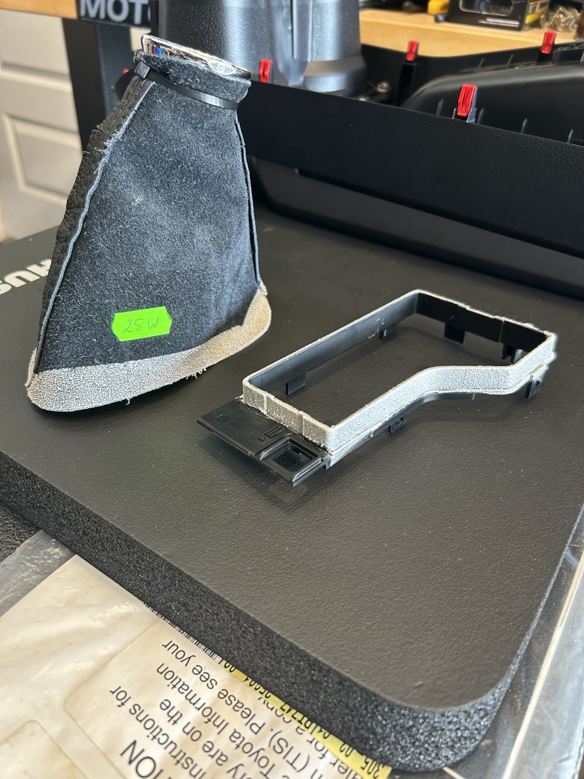

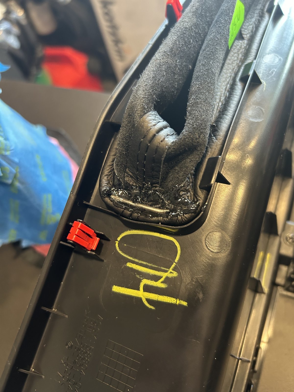

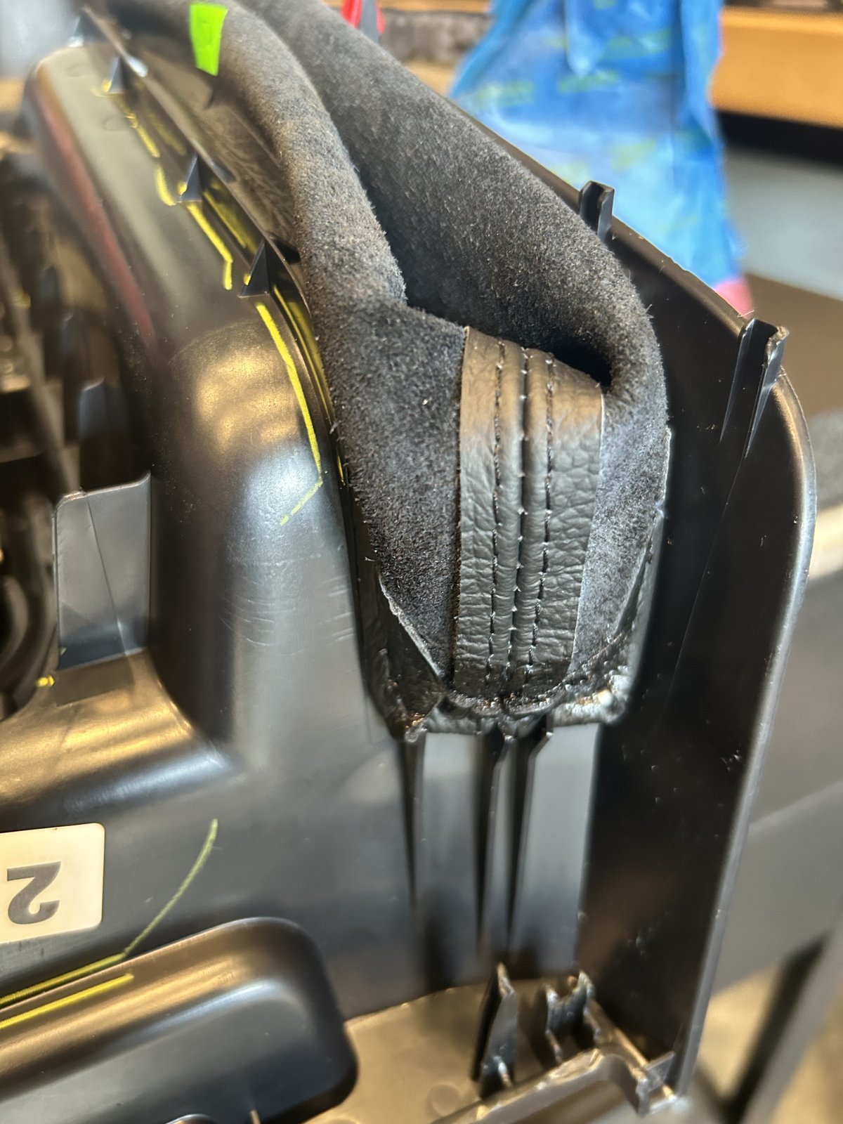

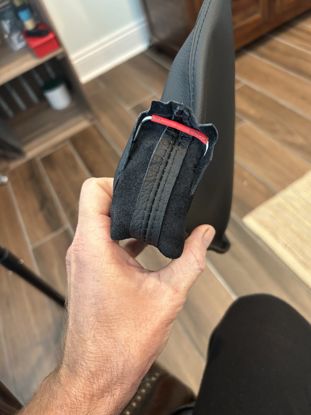

    So I had got in the habit to buy shit and put it in a cabinet to get to later- this is 2-3 yrs later.
    i did not get the add on bracket with my boot and I think I got good results with the stock wire. I cut the wire at the rear in the middle and bent the ends to about a 45 degree. Fished each end through the hem at the front shimming it down to the end. Cut the threads holding the rear seam to expose the fished wire bracket and bend the ends back to 90 degrees. Used adhesive shrink wrap to join ends and sew the end flaps over the wire bracket. Not the best sewing but it held down tight enough and I added dabs of multi purpose adhesive to the flaps to aid my sewing. I did not opt to cut the threads on the front to sew in the bracket in- there was enough pressure when installed to hold in place (I did add a glob of the same adhesive when in place).

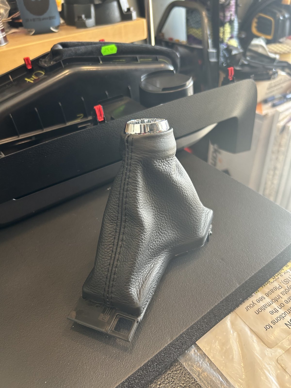

    Good thing I still had a can of 3m 77 spray adhesive because I didn’t quite plan it out. This was pretty simple to do but I did the opposite of the instructions to attach- it says after spraying the adhesive to let dry, remove tape and pull the boot right side out. I left it inside out and folded the edges over the plastic bracket (make sure you visualize the stock boot inside out to compare to make sure it’s the right side). I think I left it for 20 mins before attaching together.

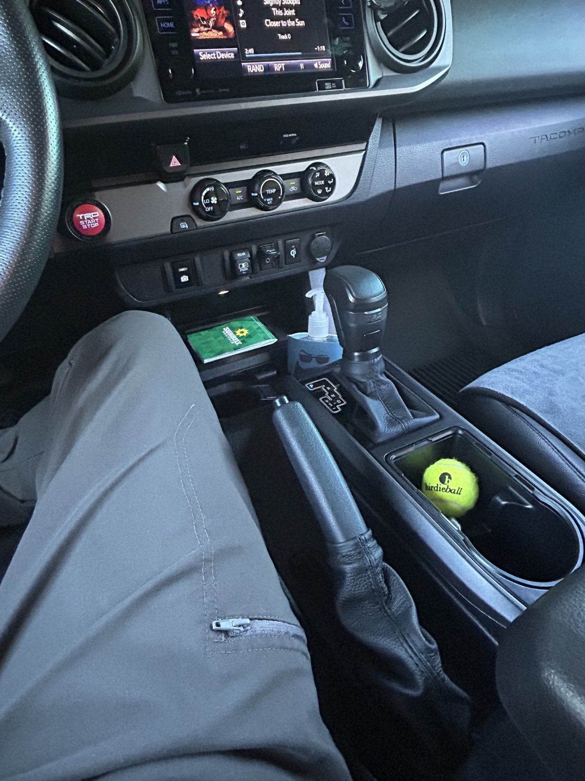

    Got the shifter switches wired back up and fully installed.
