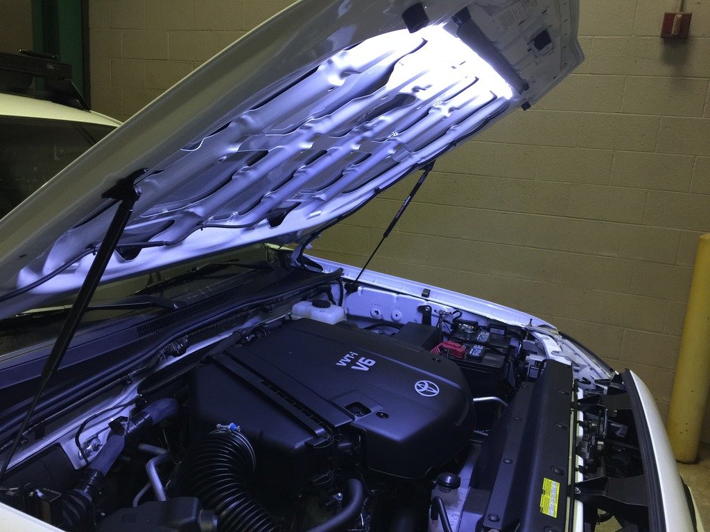

    I need help im installing my redlinetuning hoodstruts but the only problem I have is that I have a volant intake and it's hitting it on the down here is a picture

    Looks like you're out of luck with that unless you can trim the intake or just use one strut.
    Got them on mine and I love them

    Going use the driver side

    IMG_20160420_165111.jpg Riding with one hoodstrut volant intake won't me run the other one

    Not sure. But one strut should hold the hood up fine. They are strong. The main difference is (IMO) is the hood will most likely not lift itself as it does with two struts mounted. I just open the hood and it raises by itself the rest of the way.
