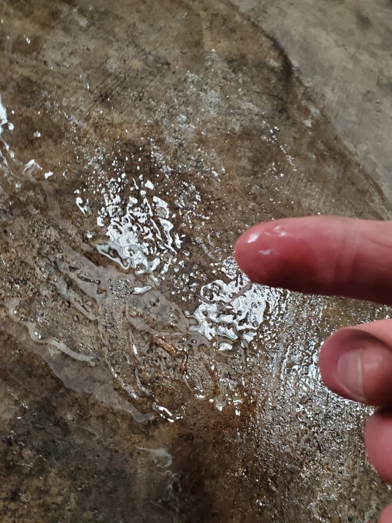

    After all the rave reviews here about Redline MT-90 in their manual gearboxes, I thought I would try some.
    I bought some online and it's been sitting for a few months in my non-insulated shop (read: cold ass shop). Finally had a nice day today where I felt warm enough to feel like changing it.
    Long story, the majority came out like gear oil, but the bottom of the bottle had separated into this gelatinous goo. The goo didn't make it into the tranny but I'm worried part of the additive package is bad or at least didn't go where it was supposed to. Is this going to be an issue? What would you all do?
    Notice the boogie coming off the bottom of my finger when cleaning up. Yuck!

    My first thought was, if it did that in the bottle, it will probably do that in the transmission; and it probably shouldn't do that. Does it matter? Not sure. I'd contact Redline and see what they think. Where did it come from?
    FWIW, I used the well regarded Motorcraft fluid in mine when I first got the truck and it was better than whatever the PO's shop put in; and switched to MT-90 just for kicks and to scratch an itch of curiosity after my clutch replacement. I like the MT-90 quite a lot better..much smoother.

    Thanks for posting. As per your good recommendation, I reached out to Redline just now. They're on CST so it went to voicemail. I left a message and also sent an email via their website.
    Oil was purchased from Redline's Amazon store (tried to buy local and even drove to Portland but no one had it at the AutoZones, Napas or O'Reillys I checked)

    Redline was quick to respond. The customer service guy called me on his private phone after hours, gave me his personal email to show pictures of the goo and requested the receipt and batch number. They're sending me 4 fresh quarts of MT-90. They eluded to a recall having occurred in 2022 and this may have been leftovers from that.
    Thanks for the advice, @moon22. Now to get the bad oil out of my gearboxes.

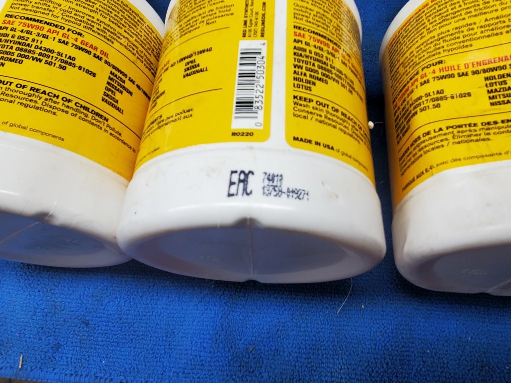

    The batch # is 74012 if that's helpful.

    Thanks, I’ll check for the bottle, hopefully I had some left so I wouldnt have tossed it
