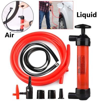

    You can pump out of the 1Qt Redline bottles, the intake end of the hand pump usually has a thin hose that’ll fit in.
    Something like this, I wouldn’t use it for air but it works for oil transfer

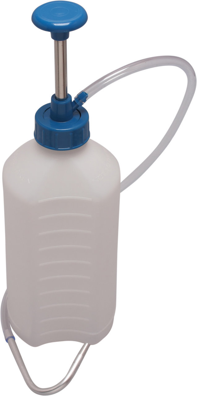

    Yeah, I was gonna pick up a new (clean) pump like this. The one I have is old and feels like it has worn seals, probably from pumping gasoline.
    Then I thought maybe I could get a screw on pump that would avoid spilling/wasting/making a mess. No big deal, though.

    Just go to your nearest outboard motor shop as they will sell the pumps like in your picture. They go into 1 quart jugs and used to fill the outboard legs with gear oil.
