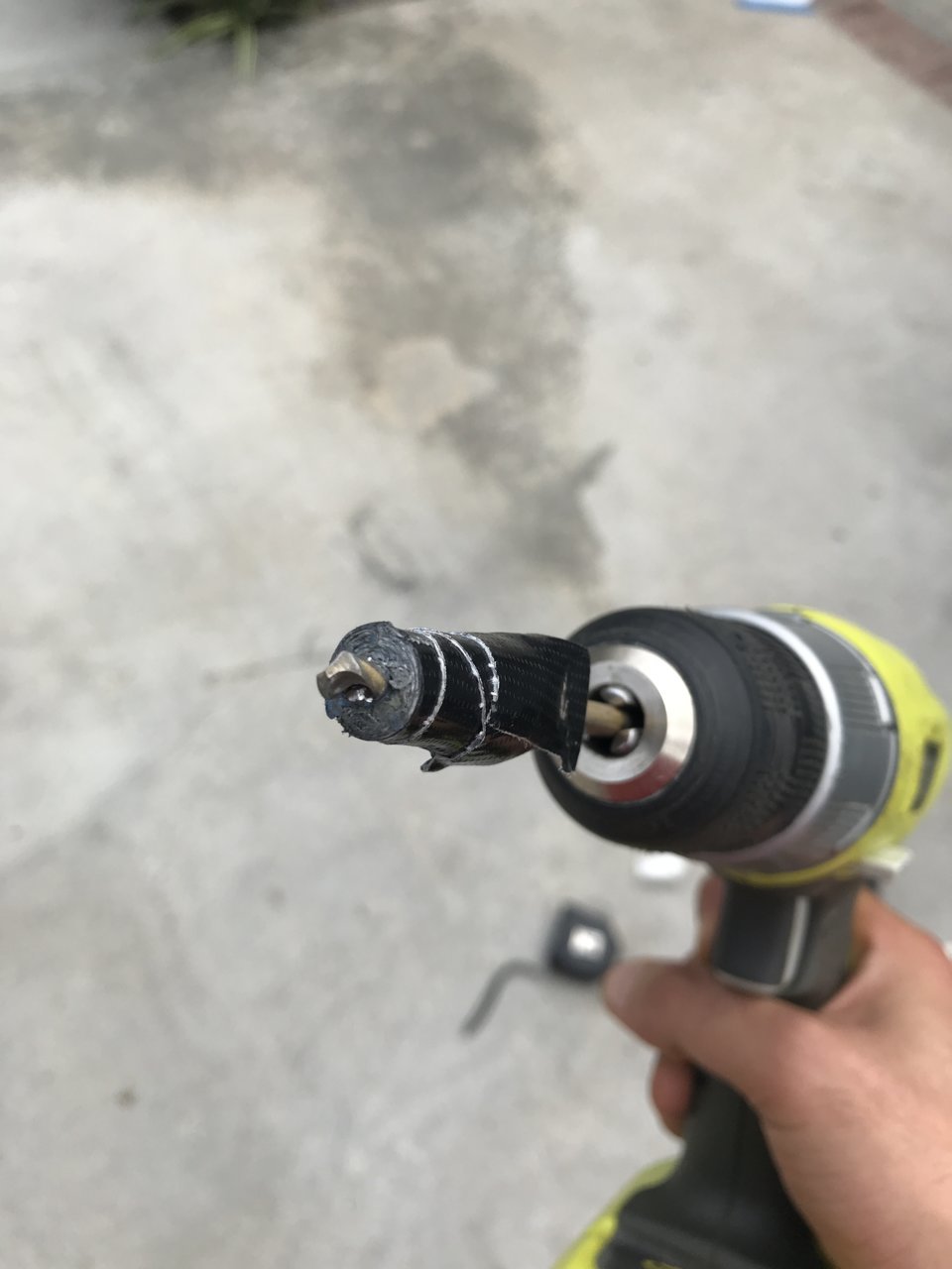

    Are they rubber coated? If not? Yes they’ll work but you’ll mare the crap out of the surface area it kisses once the hole is bored...if it’s metal, then imagine a circular mare, that’s the same diameter as the drill stop. I actually am glad I used the thick gorilla tap. Held on just fine, did all 4, and it probably only mashed about 1/32 of the tape...pretty much worked perfectly. However, a centerpunch tool is highly recommended, I’d almost say mandatory to get this right. I center punch each hole mark before drilling about 3 times to make sure the drill bit never wanders..don’t even try it without it. Maybe a couple small taps with a sharp nail and hammer (very light taps as to not bend any sheet metal) may also work if it can put a tiny dimple on your mark..

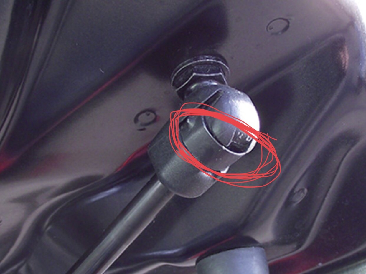

    So there is a little more clarity, you tried to tap the rivet into the hole with a hammer? Or you did what the guy in the video did and used a flat head to tap the rivet on the flanged collar part to get it into the hole? I expected them to be tight but not that tight! I mean, no one should be reaming the holes out to make them fit easier because rivets are all about tight tolerances but damn. Oh, I know what I wanted to ask, did you prep the holes with paint or anything? I have some touch up paint I was going to use. Or silicone.

    Think he means the little metal collar that is on the shock parts top and bottom. These collars are what hold the shocks to the little balls you just riveted on the truck. Generic photo I found online showing the metal collar/clip I was talking about. It will clamp onto the metal balls. You can see a little slot where you can put a screwdriver in and pull it back a little so that it goes on the ball easier then you can release it to let it clamp on.

    Ok, that makes more sense now. I thought there was a clip retainer or something that locked onto the ball. Cool, thanks!

    Bingo, that’s exactly what I was talking about, don’t try to pop them in, you need to use a flat head to pry the clamp collar then insert in, then release the flat head.

    That’s a whole different issue that I experienced. The tolerance on some of the rivets versus the holes on the bracket hardware is too tight in some cases to insert by hand, let alone the drilled hole, so yes, I used a flat head and hammer to tap the rivet surface (black part) into the holes on half of them. For those new at this, do not hammer them in using the steel pin on top of the rivet. To me that part was common sense but not be to non engineers/technical people. In the video posted earlier in this thread, the guy even makes that clear.

    Yea I can't believe @RedlineTuning totally forgot to mention that in the second to last step...I'm not sure how many others made this mistake as well and potentially boched their install...I mean I was nearly at the finish line and then spent the same amount of time measure, drilling, painting, letting paint dry, riveting as I did trying to rebend the collar clamp...I was VERY pissed.
    So advice to all, look at the last step, that is also how YOU INSTALL THEM, NOT ONLY REMOVE them. I was under the impression they pop on, but to remove, you would use a flat head. WRONG. Flat head required to PUT THEM ON and TO REMOVE THEM...am I the only idiot here that experienced this? I don't know about others but I normally follow instructions VERY WELL, to a TEE, and unfortunately in this case, I followed it TOO WELL.
