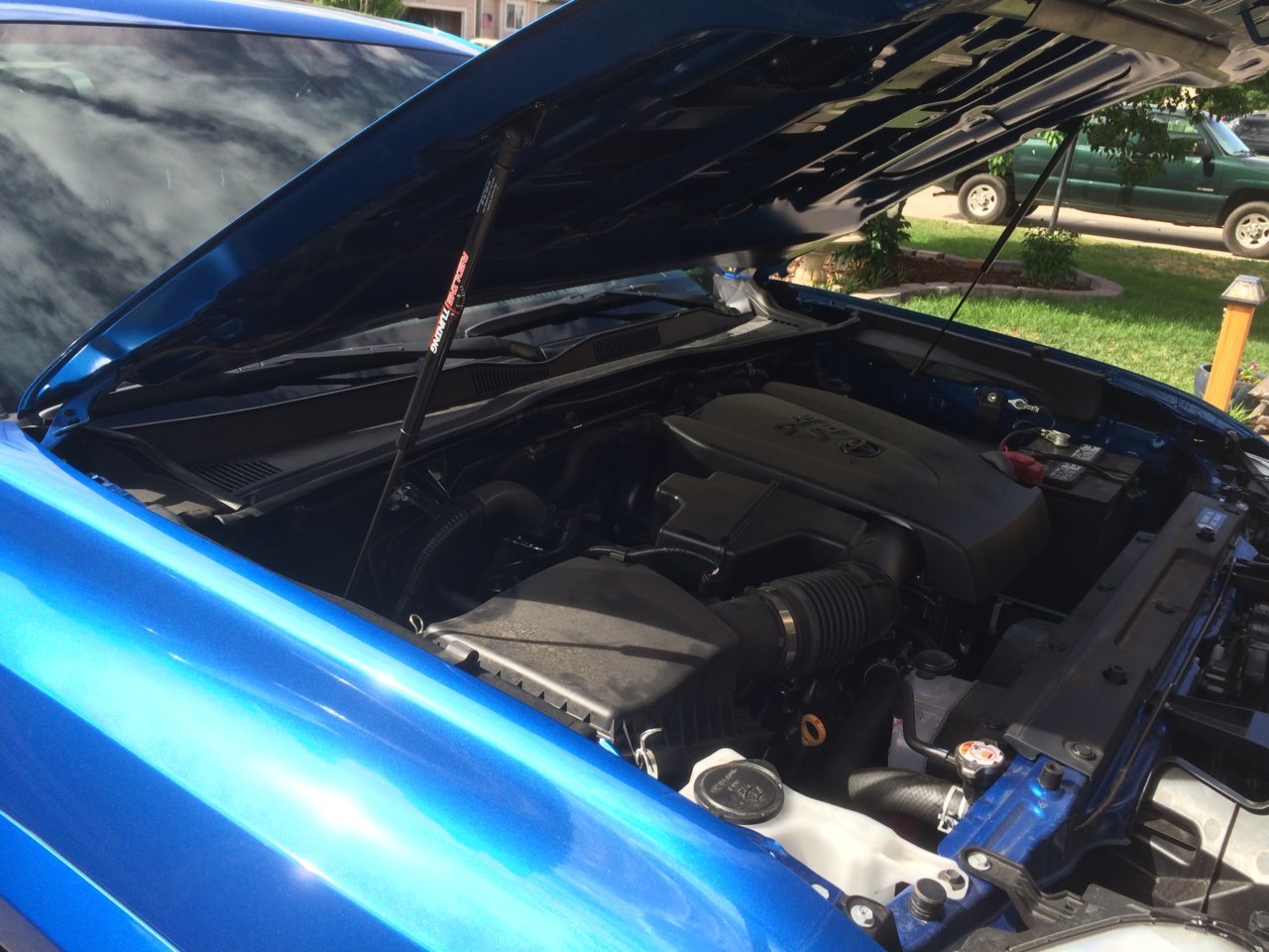

    0wise1 2013 TRD Sport
    Apr 26, 2018
    #251779
    89
    Jason
    Cincinnati
    '13 TRD Sport
    [​IMG] before
    After
    Easy install.
    RobP62 and DubfromGA like this.

    Do these require drilling?
  8. May 24, 2018 at 7:02 PM
    #148
    0wise1
    Apr 26, 2018
    #251779
    89
    Jason
    Cincinnati
    '13 TRD Sport
    Yes, you have to drill 8 holes. 2 for each bracket.
