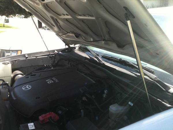

    Delivered yesterday, installed today. Had the same issue with the silicone inside the engine compartment, but nothing a razor blade couldn't fix.... Only took about a half hour, nice easy install.. Very satisfied with the results...

    can someone shoot a pic of the silicone part they are talking about?? my truck is at the dealer... and the hood struts arent with me yet.. LOL

    I will if noone has posted by morning, no flash on my phone... It's really not a big issue to deal with. If you look close at the far bottom mount in my pic you can see the silicone line that comes down below the right side of the bracket. Thst line comes up under where the bracket sits. if you just trim it flush with a razor before you mark your drill holes you can't even see it once the bracket is on.
