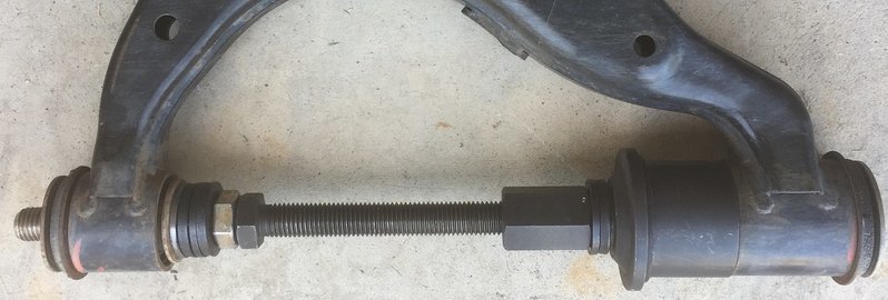

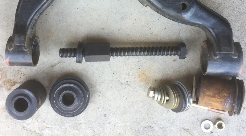

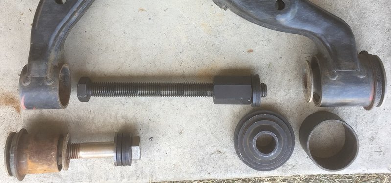

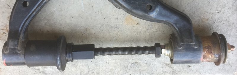

    Here is a variation of the Redneck and bottle jack methods. Essentially, I used a bolt and a coupling nut to press out the bushings.
    For the larger bushing, you need a set of washers with 2 1/8" OD because the OEM washer on the bushing is not wide enough. 2 1/4" & 2 1/2" cups came from a BJ Service kit from Harbor Freight, #60827. 9-inch bolt (grade 8 $18) and coupling nut ($8)is a 3/4"-10 - got them on Zoro. Also get an assortment of 3/4" std and extra wide washers. Need a crescent wrench that opens 2.25". A propane torch may be needed to break the bushings free. Did't take much heat to remove mine; less than a minute for the small one and about 2 min for the large bushing. The large bushing has a smaller ID; so, you need a M12 bolt and assorted washers to press out that bushing (bottom 2 pics). The smaller bushing can accommodate a 3/4" bolt.
    Installing the bushings required a 2.5" ID cup for the large bushing. I'm using a customized cup - It's a standard 2.5" ID 2" long pipe but the inside was smooth out with a lathe to remove the seam. Same pipe is used to remove Moog ball joints, which are wider than OEM.
