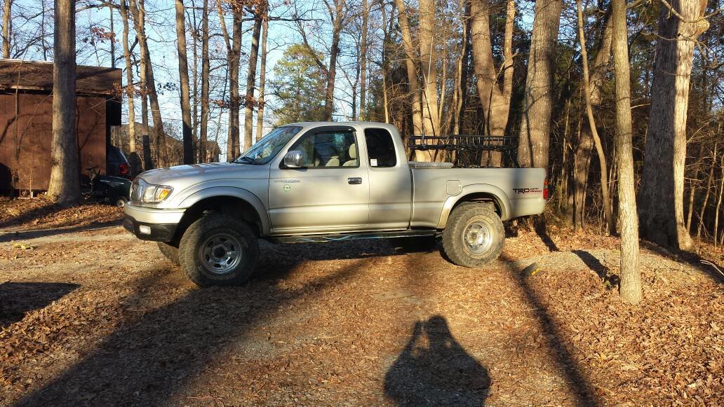

    Just the norm skids, sliders, & 35's
    How she sits currently

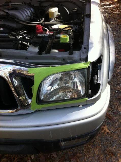

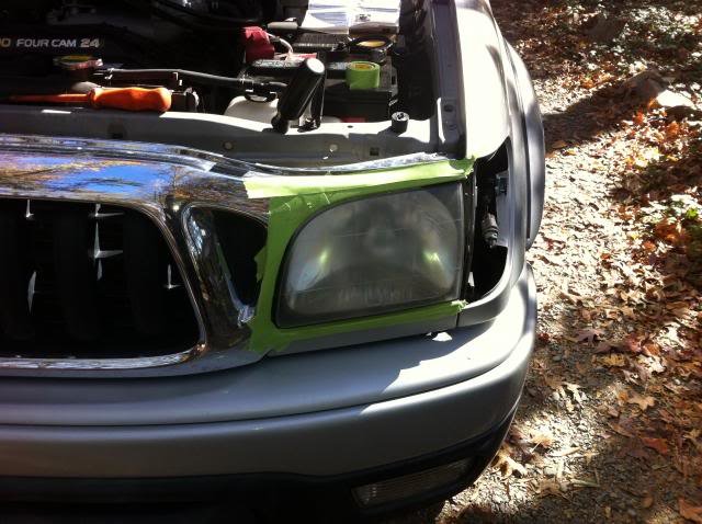

    Did mess around with a few things for the first year though. Cleaned the headlights up.

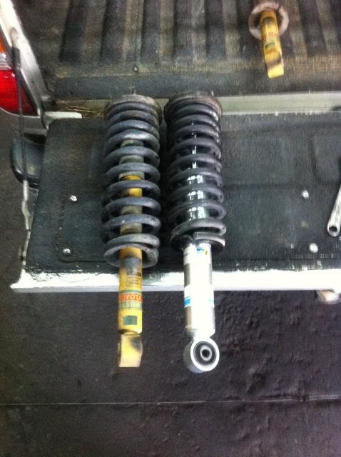

    Suspension I went with 5100 billys set at 2.5 and daystar 1.25 shackle. I will be adding 882 and building a bastard aal for the rear.

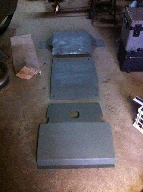

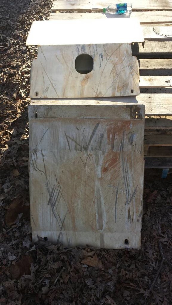

    For armor I went with a set of Ryno Offroad skids.
    Haven't had a chance to try these out much on the rock but they will be bounced off of plenty of rocks this wheeling season. I will be building a rear bumper and sliders here soon, school and work have got me busy.

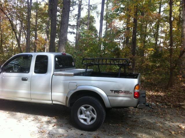

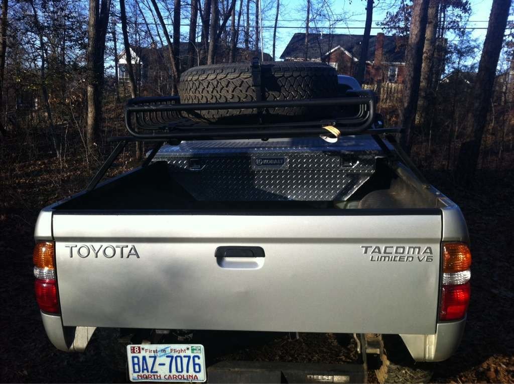

    Since I do camp alot I decided to build some sort of rack. Got bored one morning since I didn't have work and came up with this. The rack is off my dads subby he never uses. Good thing because I like it to much to give it back.
    I frequently find my truck having shit in the bed for camping or hauling random stuff so the aal will be an extra 3 leafs to make a 6 leaf pack. Hopefully my current pack isn't too far gone. This stuff doesn't help at all.

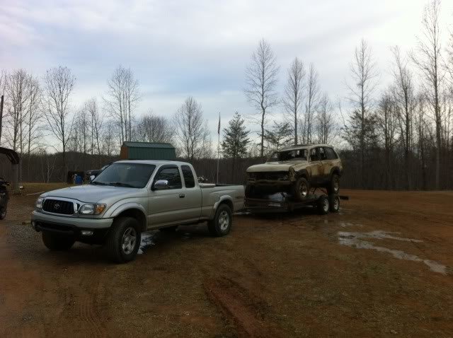

    Me stuck at Harlan messin around

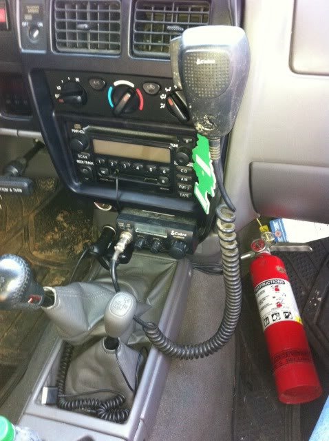

    CB mounted

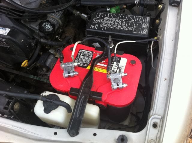

    New marine batt. terminals and 34-78 red top. Will be working on a different mount for it here soon.

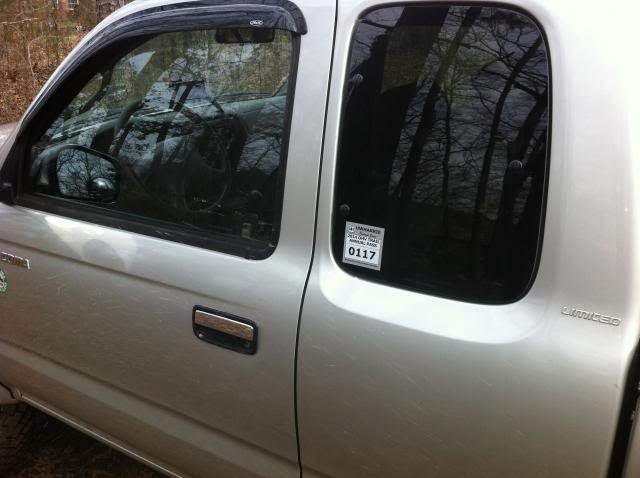

    STICKERS!!!

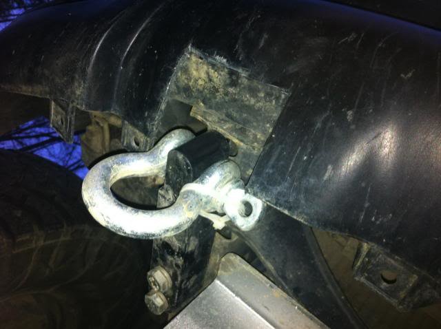

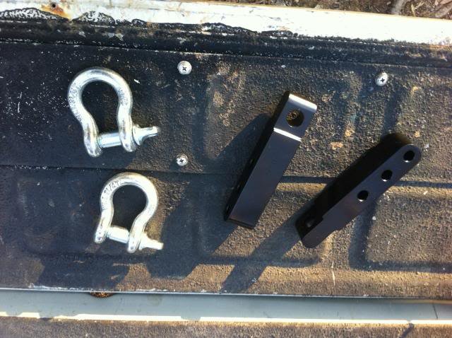

    Added some tow points up front from a Jeep made by Rampage.

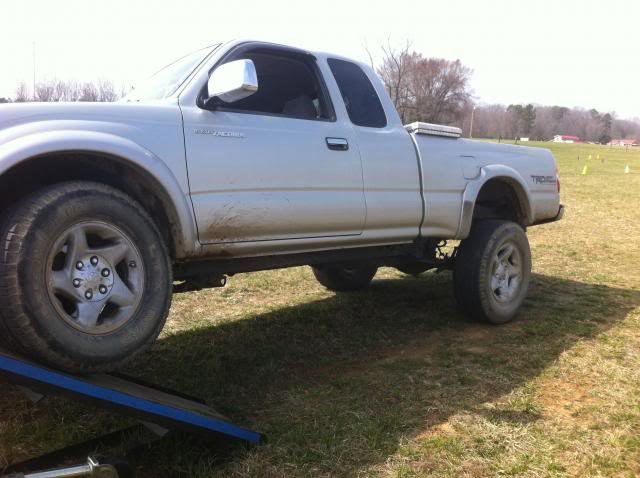

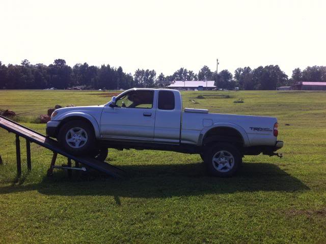

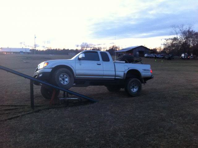

    Random rti ramp pics. Order is stock, then stock no sway bar and billys and shackle with no bar.

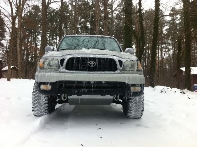

    Most recent pic from today, been snowing and sleeting most of the day.

    Sprayed the top rail of my tailgate with some bedliner. Turned out ok for how quick I did it.
    Anybody have some ideas of mounting the hi-lift to the rack. Planned to drill a through hole and run a bolt through with a jam nut then a washer and wing nut to hold the hi-lift on. Need to find a way to lock it to the truck so it doesn't grow legs and run away.

    Back when I had a rack on my taco, I used a u-bolt to attach it to the rack along with a simple gun cable lock from Walmart to secure it. Should be a few pic's of it in my build thread.

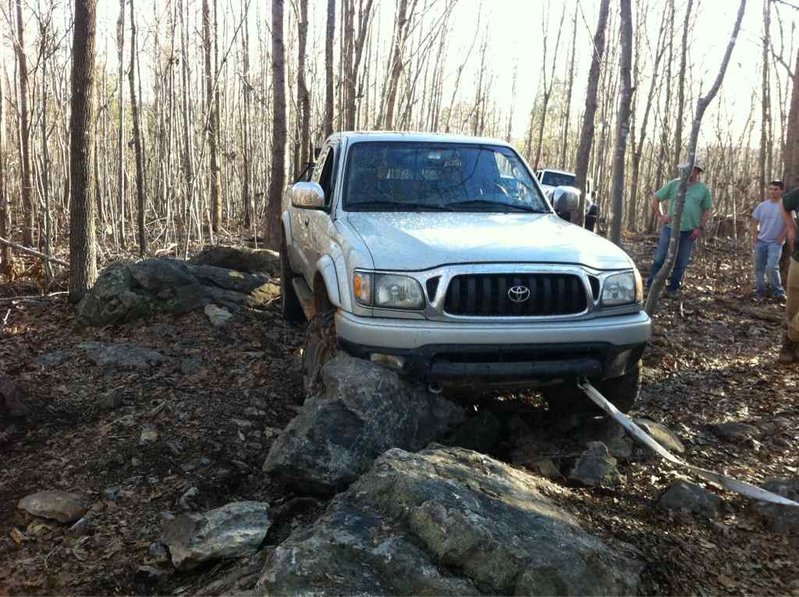

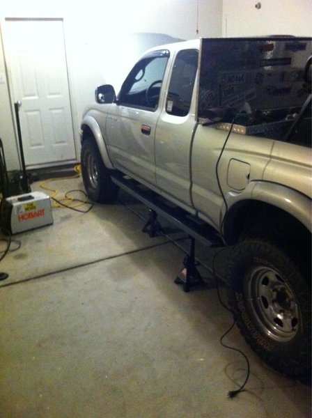

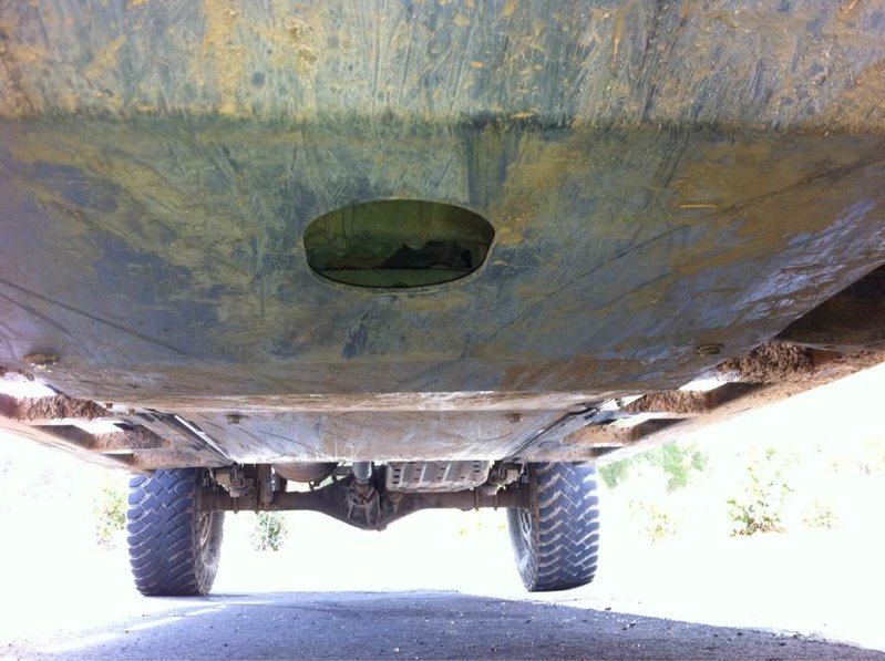

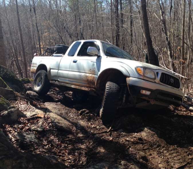

    Finally built my sliders and welded them on Friday night. Was up till 3 to get them done for my Saturday club ride. Also did a ubolt flip and shock mounts.
    Then on Saturday wheeled the piss out of the truck at Big Creek near Uwharrie. I had a blast. It's amazing how well these trucks will do with some driver training and simple mods.
    Only have pics of when I got hung up on some rock. The skids plates from rhino offroad held up great. Very happy with them. They really got a hard work out yesterday for sure.

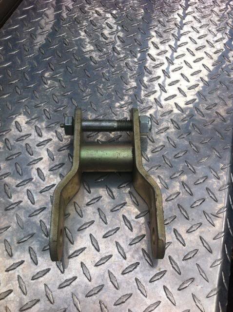

    BAMF kick out sliders, SkidRow skids,Pro Comp 7069, Kelly Safari TSR 285's, Elite front bumpa, OME 883 & Dakars w/ D6XL AAL, Nitro sport shocks, Eddie209 Soft topper, Satoshi, k&n fipk, Clarion vx400, Ultra Gauge, Debadgination mod
    Did you do anything to your rear shock top mounts? Or did you just weld on new lower shock mounts/ Also, what lower shock mounts did you use?

    Stock upper mount and used Barnes 4x4 lower mounts. Need to source some shock bolt sleeves before I trash the bushing in the shocks if I haven't already.

    Something like these ones? here

    Those are what I should have used but I had these laying around in the shop so I made them work.

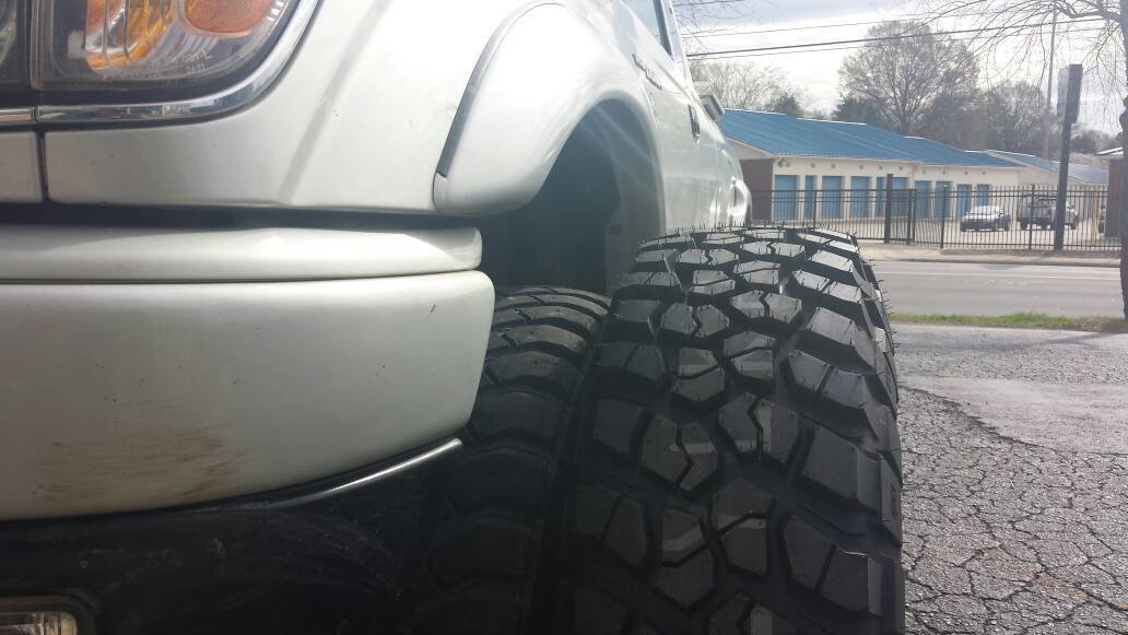

    TIRES ARE IN! :goingcrazy: but I can't get them till Tuesday. Got an appointment for an alignment on Tuesday at 8:30 so between now and then have to put these on that came today.
    Wheelers shipped fast, very happy they got here as quick as they did. Also have to drop the skids and put my bastard aal in.

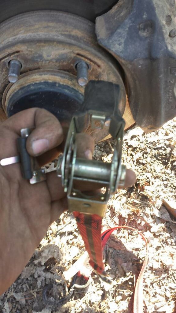

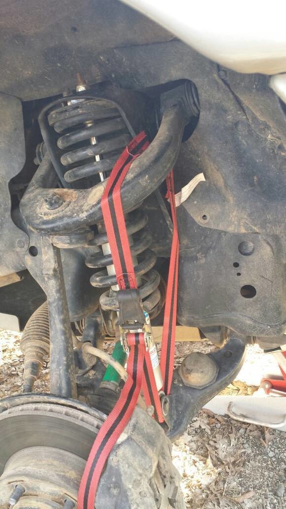

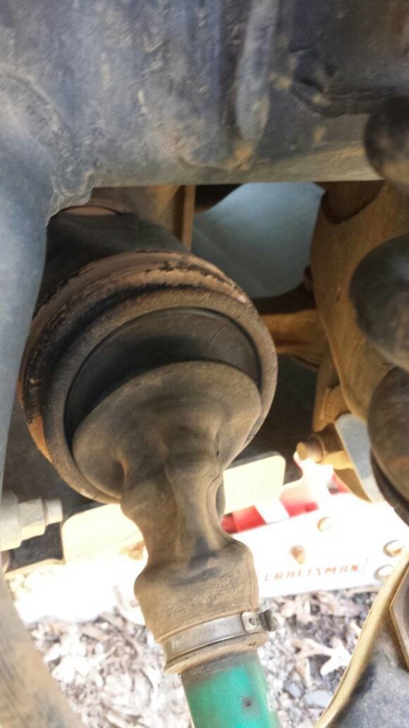

    Wheel got my spacers put in. That was a utter bitch. The knuckle kinda tries to occupy the space space as the spring at full droop. Not to bad of contact though. Gonna have to stay that way for a while till I get upper control arms. I had to come up with an interesting way to get the bolt back in on the passenger side.
    It did sacrifice the strap though.
    Also had to take the skids off so I can get it aligned on Tuesday. They have gotten a little use so far.

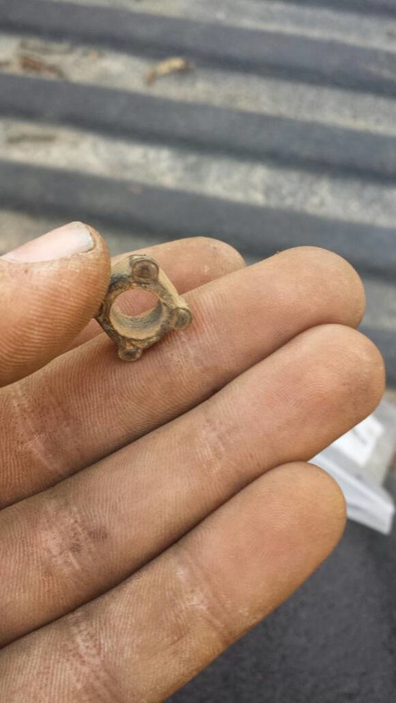

    Also figured out why one of the bolts wanted to run away. No threads at all.
    Going to have to fix this issue here soon as well. Both sides are the same.
    Truck has a little bro lean now. Gonna have to break out the flat bill hat till Thursday when the aal goes in.

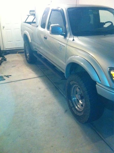

    Got a alignment done this morning. Actually got it back into spec but the front adjusters are maxed out so no more castor for either side but it drives way better now compared to what it did.
    Then went and picked up my tires from 4 Wheel Parts in Charlotte. Little size difference.
    Then went and had them mount at a local tire shop. I'm overall very happy with the look of these. They look like everything will clear too.
